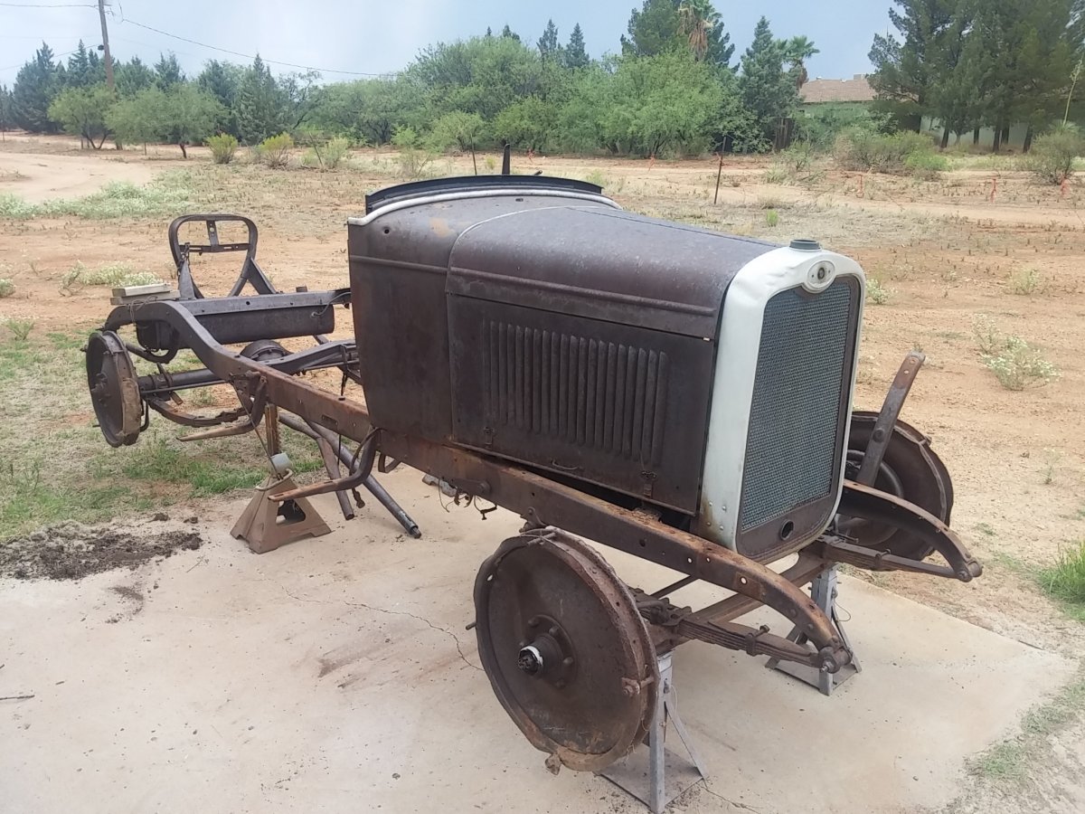

  8. bchctybob
    Joined: Sep 18, 2011
    Posts: 6,624
    bchctybob
    Studying the photos I see seven cylindrical objects in the engine compartment. I recognize a starter and generator, maybe a heat exchanger on the down pipe from the exhaust manifold but what are all the rest of them?

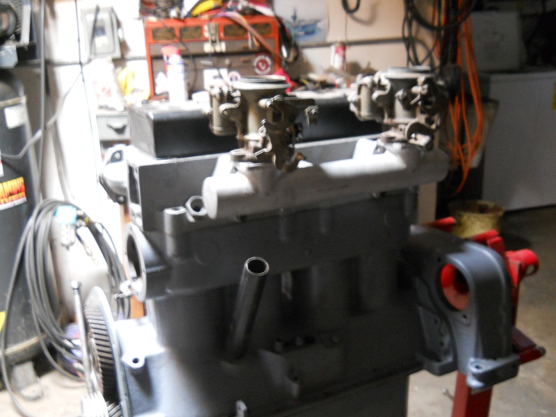

  12. bct
    Joined: Apr 4, 2005
    Posts: 3,199
    bct
    When mine is up and racing im going to search for an olds head. downloadfile-2.jpg
    kiwijeff, Tim and Moondog13 like this.
  13. squirrel
    Joined: Sep 23, 2004
    Posts: 61,005
    squirrel
    The cans in the engine compartment...there is a vacuum powered fuel pump, high up on the firewall. There is a starter, and a generator. There is a heat exchanger on the exhaust pipe, and right in front of it is the air cleaner. There is an igition coil, which sits atop a gizmo that I haven't explored yet, but it has oil lines going to it, so it is probably something to do with the oil system, which apparently uses the pump to transfer oil to other reservoirs, rather than push it under pressure into bearings.
    So much to learn...fun fun fun!
    els, kiwijeff and bct like this.
  14. bchctybob
    Posts: 6,624
    bchctybob
    I'm learning right along with you. So that little horizontal can that seems to be attached to the heat exchanger is the air cleaner? Whoda thought, the carb's in the other side..
    Glad water didn't seize the trans. Rear end looks good in the picture. I forget, does the engine turn?
    zbuickman likes this.
  15. squirrel
    Posts: 61,005
    squirrel
    It looks like the air is preheated by the exhaust pipe, that's why the air cleaner is right by the pipe and that heat exchanger can.
    I have not got the engine to turn yet, the cluster gear in the trans may be holding the engine? or the engine itself could be stuck, which is pretty likely, as pistons tend to get stuck pretty easily when a car sits for a long long time.
    I'll eventually take it all apart, and see if I can make it work, I guess.
    els and chevytruck1954 like this.

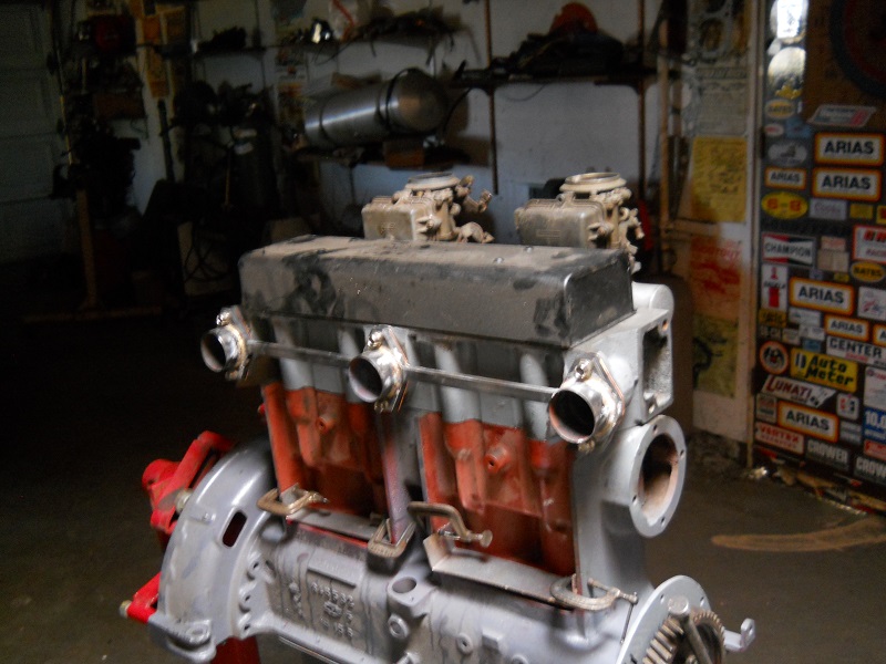

  20. Squirrel,
    Congrats on the '28 find! Couple thoughts-
    • do NOT use the rear end, as they are the weakest part of the drivetrain (I have a '46 truck rear, including the brakes so that I can run the hydraulics on my build).
    • Also, you do want to find a '28 head, as the '27 and earlier are prone to cracking.
    • Don't know if anyone's mentioned it yet, but take a look at the early Chevy 4 banger thread- LOTS of good info
    Also, there's been an Olds 3 port head on Ebay for a couple of weeks now :D

  23. Looks like the 3 port listing got pulled- sorry for the bad info :(
    Squirrel, the earlier heads had cooling issues that lead to them cracking, plus the rockers on everything other than the '28 head are 1:1, where the '28 is 1.5:1. Will keep my eyes out for a '28 head for you!
