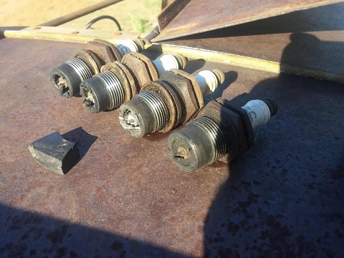

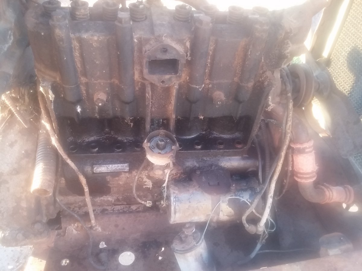

    I got the clutch out. It was kind of stuck from the rodent rust. And I got the engine to spin over freely. The lifters were mostly stuck, once I got them all "up" it turns pretty easily. I've been working them up and down, and got 5 of them out and lubed. The faces look ok, mostly shiny still, so I'm not too worried about rust scale on the cam. I also disconnected the oil line to the filter, hoping that oil will eventually squirt out of it....no luck so far. And under the distributor cap was the rotor...but only one point...the other is MIA. The first part I know I'll need to buy to get it running.
    oh yeah...the little chunk of carbon in front of the spark plugs is part of the throwout bearing. Oops. 20160707_185323.jpg 20160707_180626.jpg 20160707_170217.jpg

    I don't know what the car hit, but the left front fender and running board were missing, the right side stuff was sill on the car. I guess it might be related. Looks like the axle is bent just inboard of the spring, and also might be twisted outboard of the spring. Might need a replacement, if I get that far.
    I piddled with the engine some more...got all the lifters out, cleaned, lubed, and back in. Freed up the rockers and lubed them, and put them back on, and adjusted the valves. Some of the lifters even spin! when I crank the engine.
    Also I pulled the distributor, and spun the oil pump with a drill, and got it pumping.
    Time to investigate the carb, and maybe order some points.

    A little more progress, I had been squirting a bit of PB blaster and oil into the cylinders....hoping to get the rings to do their job. After I got done with just about everything else I could do, I decide to see if there was any compression, by holding my thumb over the spark plug hole while cranking the engine (by hand). #1 didn't seem too hopeful, but #2 and 3 had some action. 4 is kind of hard to reach. So, I added some more PB and some ATF, and cranked some more, then put the spark plugs back in, one at a time. And it acts like it's getting compression. # 1 seemed to come to life, then as I put the rest of the plugs in it got more difficult to crank. Now it gets hard to turn every 180 degrees, like it should.
    I ordered a set of NOS delco points on ebay, it helps to get a good deal if you know the part numbers better than the seller knows the application...$8 vs $25.

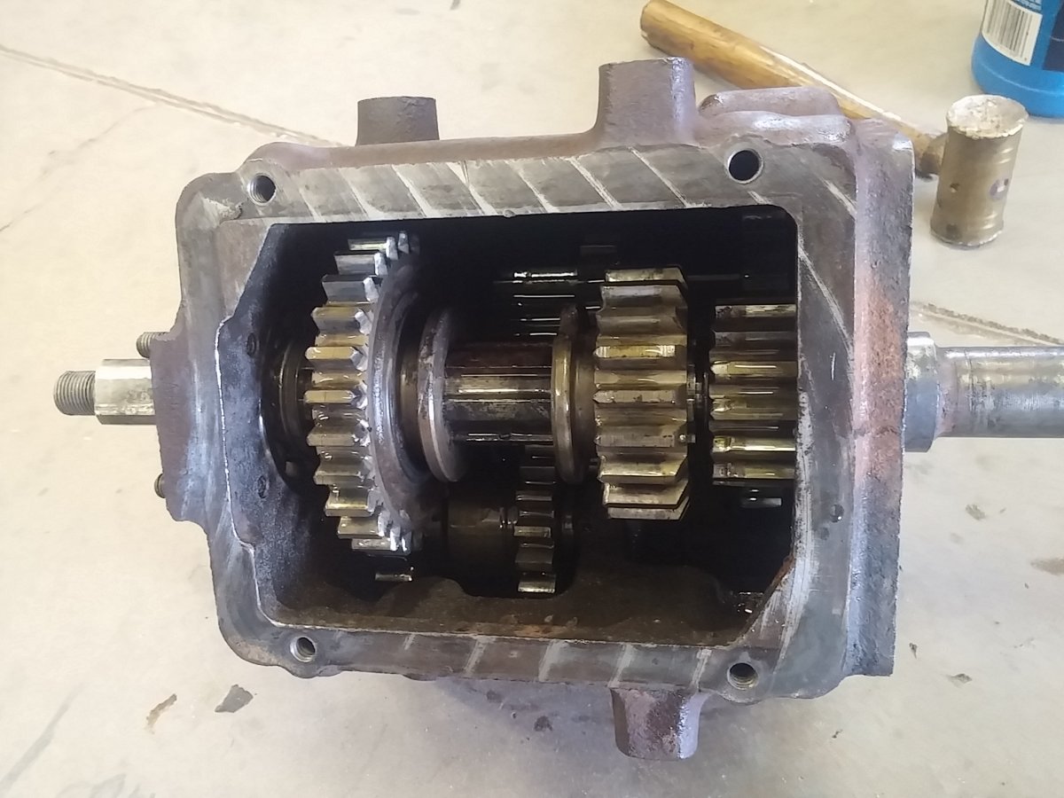

    I poked around in the transmission today. When I got the car, the trans was full of water, and stuck in gear. I pulled off the top cover, and pried the gear into neutral, and the wheels were then free to turn. I also drained the water, and what little heavy oil there was in it. When I removed the transmission, I was able to turn the input shaft, which surprised me. Today, I took it apart, and cleaned the parts in solvent, and s****ed off the few chunks of rust on the gears. I put it back together, it seems to be in reasonably good condition. I expect it will make some noise, and it might want to jump out of 3rd, there is quite a bit of wear on the splines where it engages (inside of 2nd gear, and the input shaft gear, aka main drive gear).
    A few pictures.
    20160703_101051.jpg 20160710_100720.jpg 20160710_115603.jpg 20160710_124322.jpg

    Little bigger version of a Crosley trans, it will be fun shifting..
