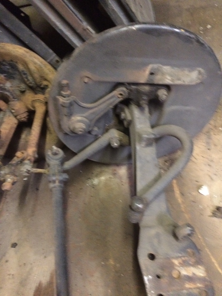

    ImageUploadedByH.A.M.B.1468450022.974640.jpg ImageUploadedByH.A.M.B.1468450045.942345.jpg ImageUploadedByH.A.M.B.1468450060.230338.jpg
    Here is a couple pics of the '30 axle I have. If you can't straighten the one you have maybe you can use a later one.

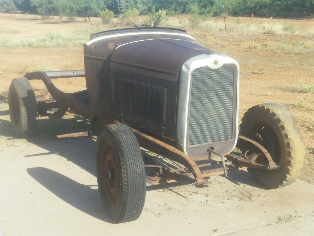

  7. squirrel
    Joined: Sep 23, 2004
    Posts: 61,026
    squirrel
    Thanks, I'll see what happens. The brakes are quite different on those...

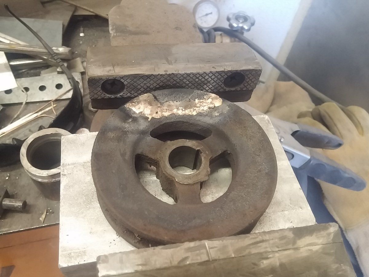

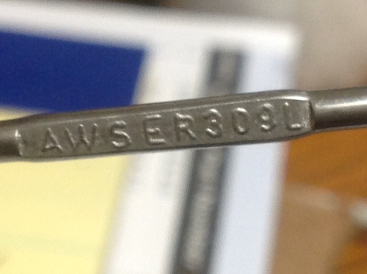

    View attachment 3271762 image.jpeg image.jpeg FYI You can Tig cast iron and use AWS ER 309L . You need to tap it with a hammer to stress relieve it every inch. I use it to put ears on cast iron blocks. But it is hard to drill or tap. You need a carbide bit and when you tap it you only go about 1/4 turn and back up or you will break tap off and cutting oil. I learned this from a welding lnstructor. Frank
