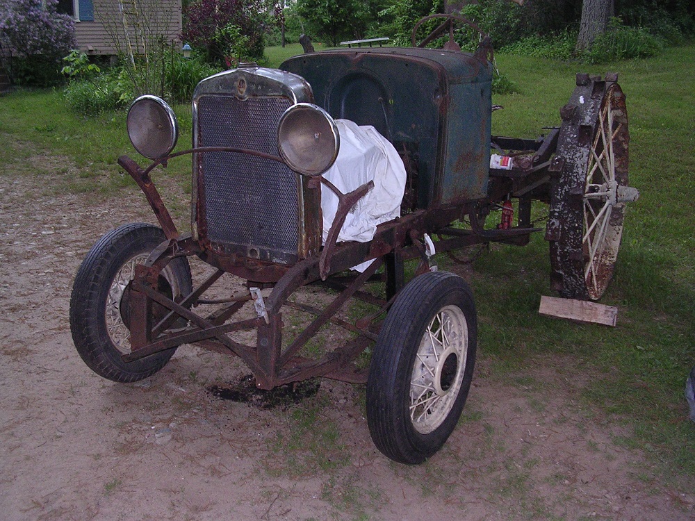

    Just a cheap solution to the "$60+shipping" carbon insert: If that repro carbon is the same listing as my 1929 six cylinder: I was able to pry the actual ball bearing insert from a 71-79 VW beetle TOB ***embly. It has to be 71-up that has a pressed steel bearing housing, 70-and older won't work. If your pickapart has engineless bugs, the easy way to spot the correct TOB style is that the 71-79 bearing rides on a 3 bolt steel guide tube. The 70-down does not use a guide tube. Anyways, pry out the bearing from the pressed steel housing, then cut a 1/4" wide strip of 18 or 19 gauge? sheetmetal, about 7-1/4" long, wrap that around the VW bearing, and it will fit right into the Chevy carbon clamp.
    Unfortunately some aftermarket 71-79 TOB housings have a different looking bearing that may be wrong OD. And, with the OEM VW, you would need to glue a felt gasket on the back to keep clutch dust out. (but only as a road driver, not a field car)
    Yes, it sure is the same. My cutdown 29 roadster with a Montgomery Ward tractor conversion from the depression, came from the s****yard with modern 4x4 wide white-spoke wheels. I had two unknown make 18" wire wheels, so I cut the modern centers from the 4x4 wheels and welded into the wires.:

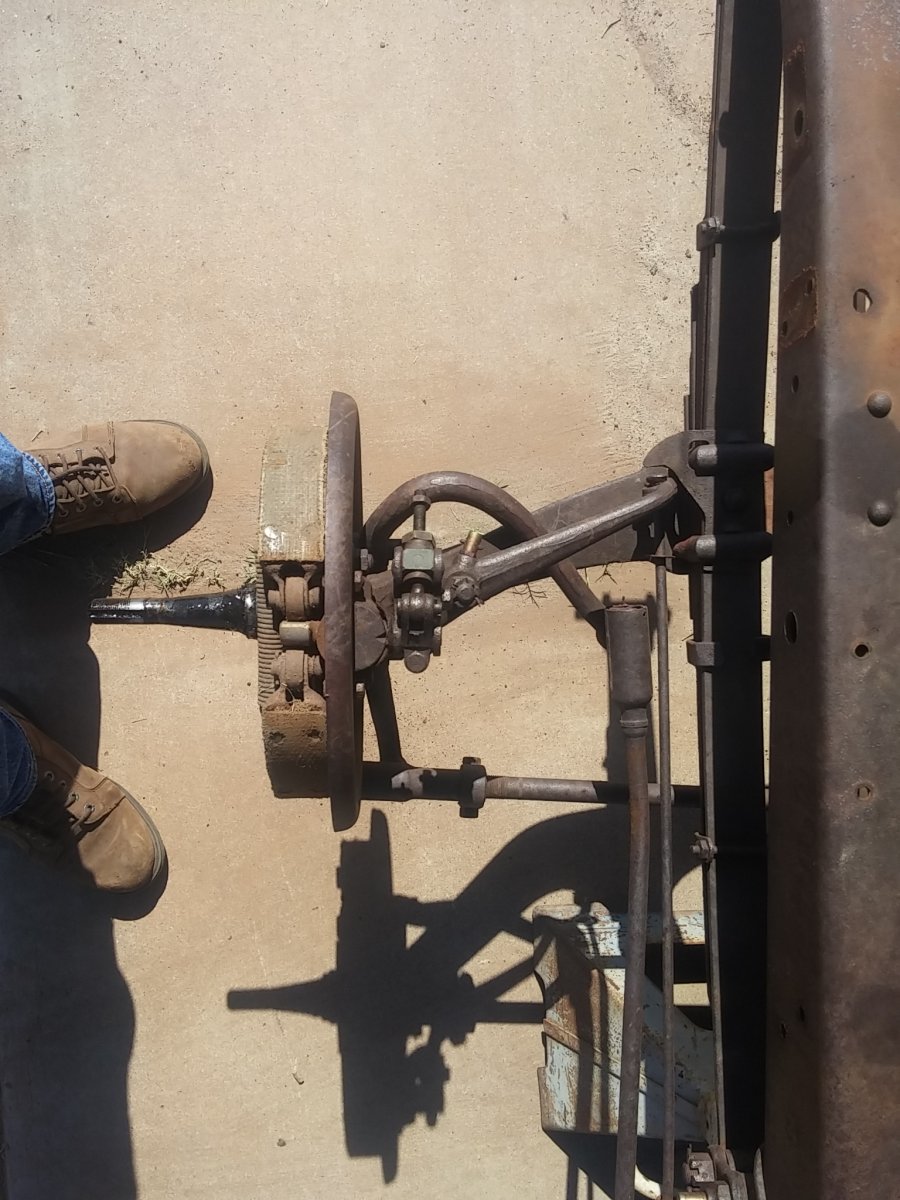

    I decided to see about getting the front axle a little closer to straight. It was bent back about 3" on the driver side, now it's closer to 1", I think. Hard to tell a lot from the pics, but it looks better...

    Way to go, Jim! Glad you tried, after all. I do a lot of these...some guys have given me bent Mor Drops, they didn't want to straighten bent axles, because of the 'danger' (!??!)
    I generally spread out a little further between points, (on my 10 ton) but Foster Farms has a 30 ton air-over that I've used for some.
    'Twists', though challenging, merely take a piece of cold rolled round shaft, right thru the king pin bore. Place axle diagonally, with 'hard plate' support at 2 stations, then chain the axle beam down to the press beam. (same with the now 'high end' of the cold rolled 'pin'.) A simple press downward (or 2) and you should be in shape.
    A second cold rolled pin in the other end (12" protruding on both) and you can gunsight the caster. ('no twist')
    Final check can be done on a LEVEL table, tilt the axle from a level setting, turn it over and watch the protruding pins. (simple eyeball op)
    Final op is axle straight up, on matching blocks under the spring pads. (or upside down, whichever is easiest)
    Take an angle finder (Sears magnetic) and check the king pin angles (with your cold rolled pins) and they should be the same as indicated in the old Motors/Chilton's under "King Pin Inclination".
    I get 'em right to dead nerts. (according to specs)

    The axle looks better but I believe I would try at least one more go at it.

    I'm finding a lot of other things I'm going to have to fix, so I plan to deal with the axle more at that time. It's straight enough to be able to putt around the yard...which is the short term goal.
    I've been playing with the drag link and tie rod, the drag link was kind of bound up, the ball joints were quite rusty. I have a spare late 50s truck tie rod that uses the same size ends, so I plan to use the truck ends on the 28 tie rod, and use the old tie rod end parts to fix the drag link. We'll see if it works. I still haven't got one of the threaded plugs out of the end of the drag link...using heat, oil, vise, hammer, patience, etc. The first one took a while, the second one is taking a long while. I'll get it, though.

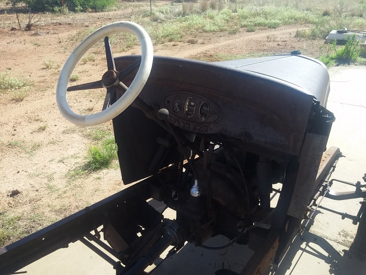

    Meantime...I got the steering linkage working, so I decided it's time to build a steering wheel. Fortunately we have the internet to show us the right way to do it, and also fortunately we don't have to do it the right way, we can do it however we want. I'm not good at waiting for glue to dry, and I didn't want to go shopping, so I used what I had laying around. S**** pine and wood screws, and a few power tools.

    Nice job on the steering wheel!

    You continue to amaze me, hand hewn steering wheels no less.
    If I may, I see a wood frame body with plenty of slats going fore and aft to a boat tail rear also. Only covered with fabric and dope ala a vintage bi-plane.

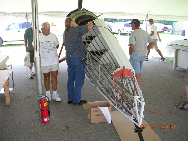

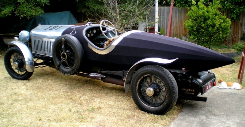

    I've wanted to do this for years. An airframe under construction and a '26 Minerva. There's a thread on here somewhere about this particular car being redone.
