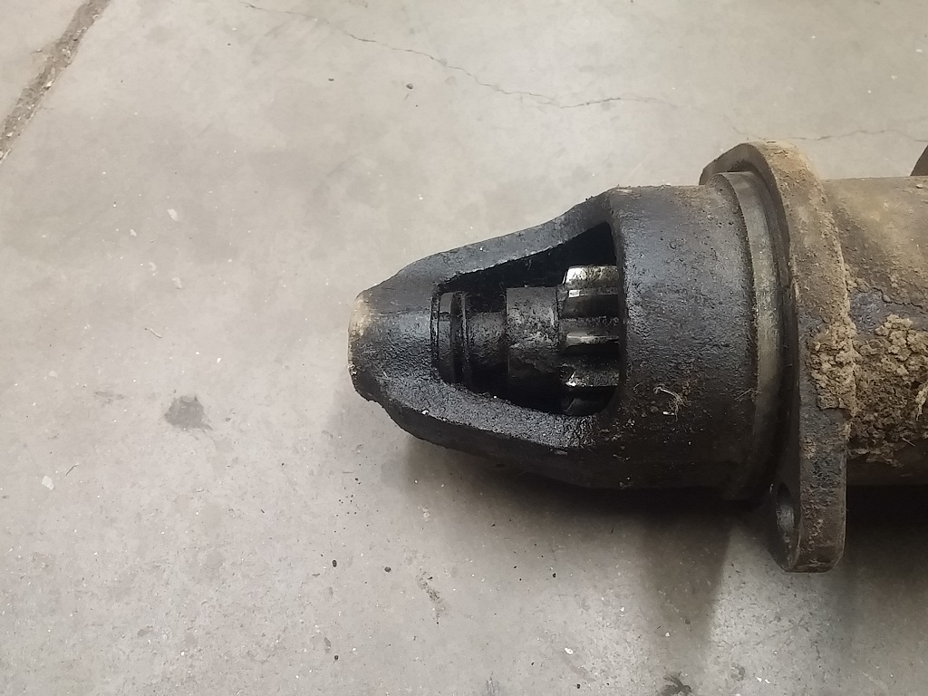

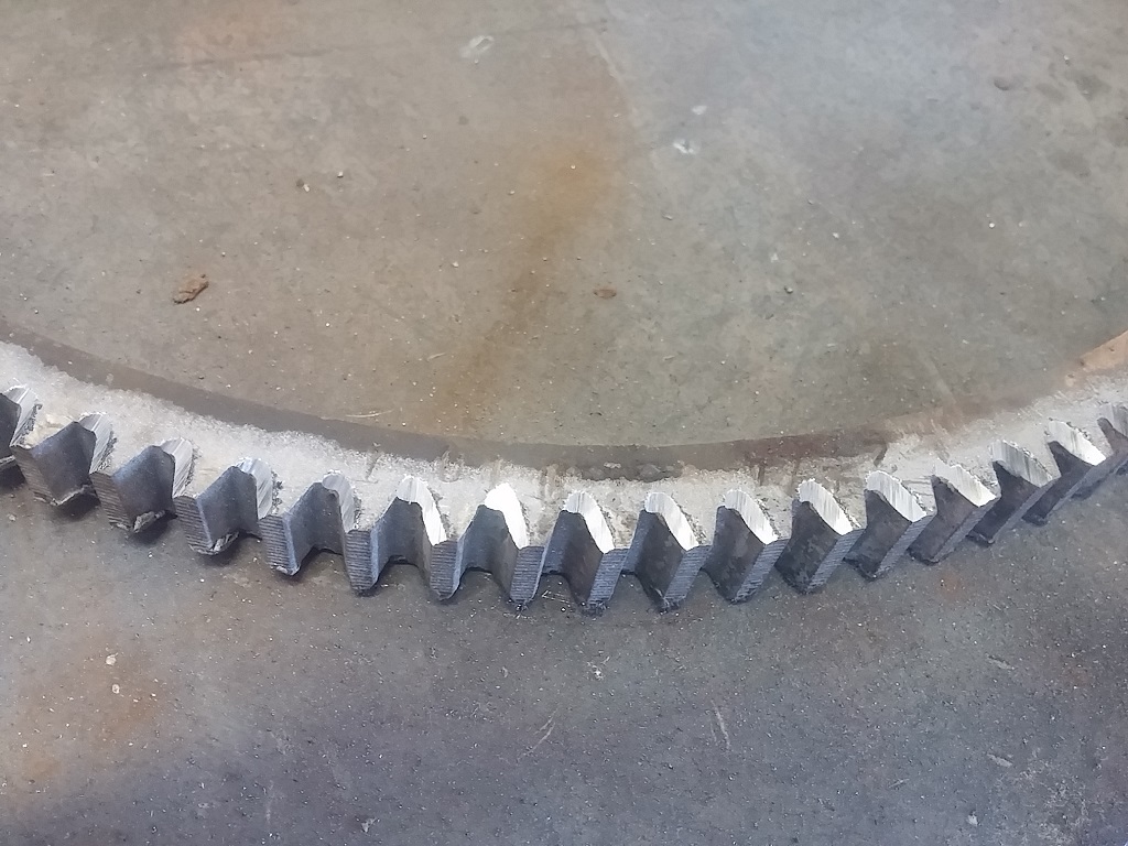

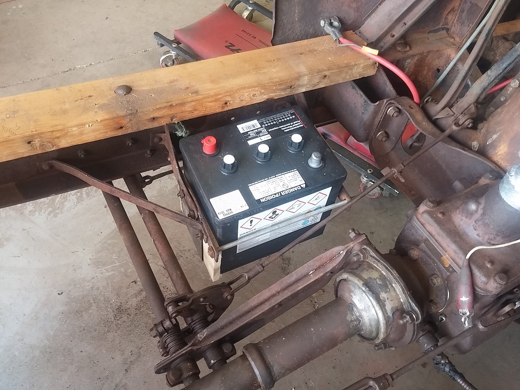

    I decided it's time to get the starter working...so I bought a 6v battery (big expense, $100 with core charge and tax) and got the battery tray back to working condition. The starter switch didn't work, so I took it apart and cleaned the contacts. The starter just spun, no Bendix action. I took the starter out and fiddled with the Bendix, put it back in, and it tried to engage, but it acts like the teeth on the ring gear are too worn out. I noticed they were in bad shape, but didn't do anything about when I had the flywheel off. Oh well...take it all back apart again, which only took half an hour. I popped the ring gear off, and modified the teeth so they are now beveled on the other end. The flywheel and ring gear are now in the kitchen, getting a temperature differential, so they'll be easier to ***emble.

    How did you do that??? With a 4" grinder???
    squirrel likes this.

    I have never flipped a ring gear over myself but knew of guys doing it. I don't know if the ones they did had to get beveled, of course they were later models though or maybe they didn't and just got by with it???

    I flipped the one in my Ford and no beveling was required. The "bad" side never had it done either. Flywheel is out of a C20 Chevy pick up.

    The teeth on these old ring gears are really thick, they have a bevel on the end to help the starter gear engage. Not needed on more modern ones with finer pitch gears. I used a 4" angle grinder, of course. I got good at it after about a dozen teeth.
    Oh...it works! although the starter is cranking slowly, as someone mentioned I have really skimpy battery cables, it needs heavy ones.

    yes, you can flip the gear, sometimes you can also just rotate the gear 180 degrees.
    ever notice how a ring gear is (almost) always worn in only one area?

    I thought about rotating it, but since it would already disengage when it got to the worn part, I figured that wouldn't help me much! (I had tested it by rotating the flywheel to an unworn part, the starter would engage then, but pop out when it hit the worn part)

    I've repositioned the ring gear many times on old tractor engines. It's a common maintenance task on old engines.

    oh...if I did want to rotate it instead of flipping it, I would have gone 90 degrees...it was well worn on both sides, 180 degrees apart. And barely worn 90 degrees from there.

    Anyways, the starter is working fine now, I put thicker battery cables on it. Still was running rough and would die frequently. There's an idle mixture screw, it was not doing anything. I took the carb back off, and took it part way apart...the idle screw seems to be fed by a tube, and the tube has a slot head and was stuck. I worked it for quite a while, and eventually got it to move, before stripping the slot all the way. yay! So I got the tube out, cleaned the **** out of it, cleaned out the hole it goes in, and put it back together. Still runs kinda rough, but it keeps idling now. And the mixture screw seems to do something.
