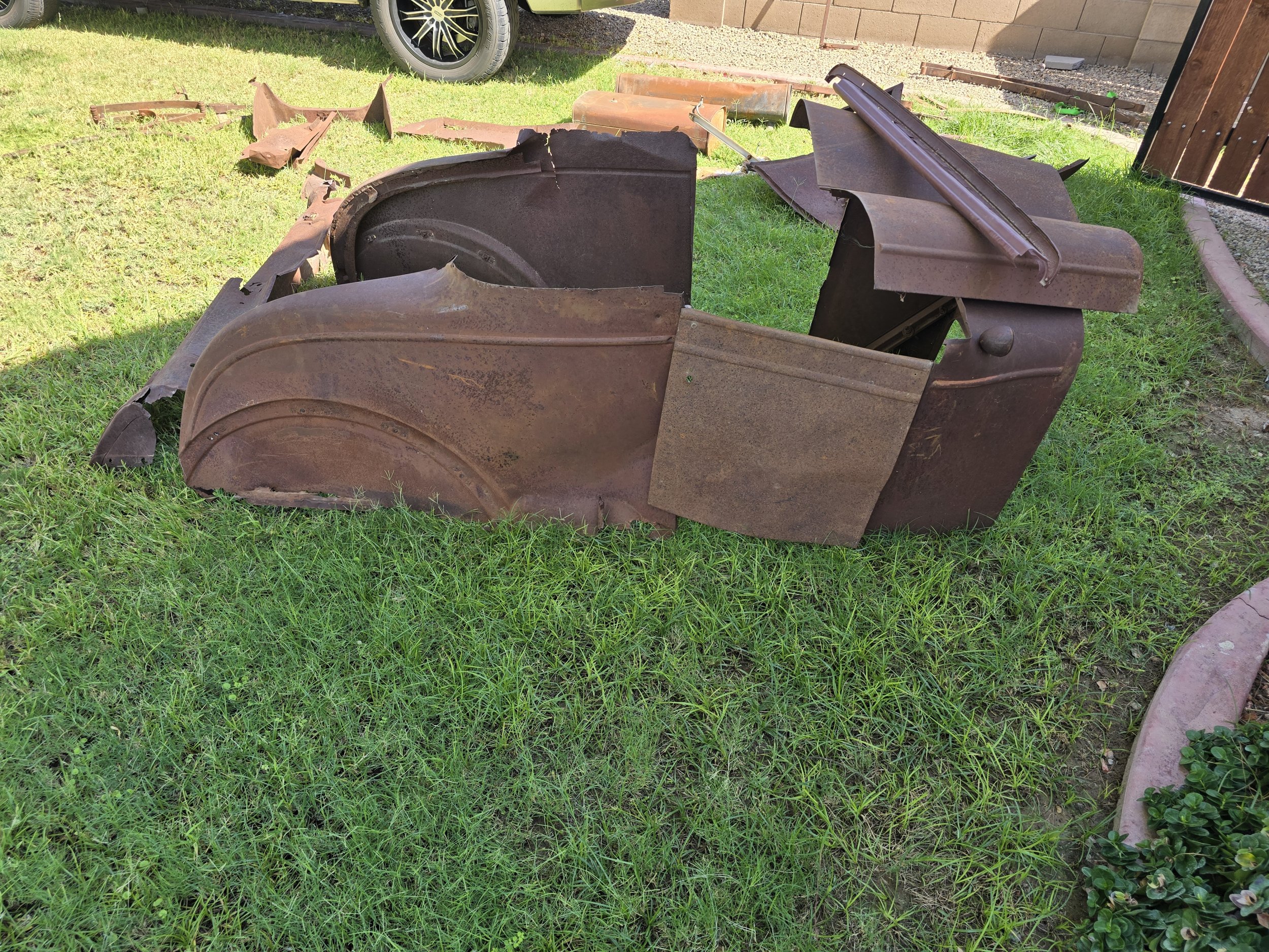

    So I recently got a 28 chevy roadster... puzzle. And I don't see them really at all out here. Not a whole lot online ether, everything is pretty much ford.
    Does anyone have pictures for build inspiration?
    I have a 28 frame i got my hands on.
    The puzzle body.
    I have a 350 chevy engine already.
    Picked up a chevy 10bolt rear axle.

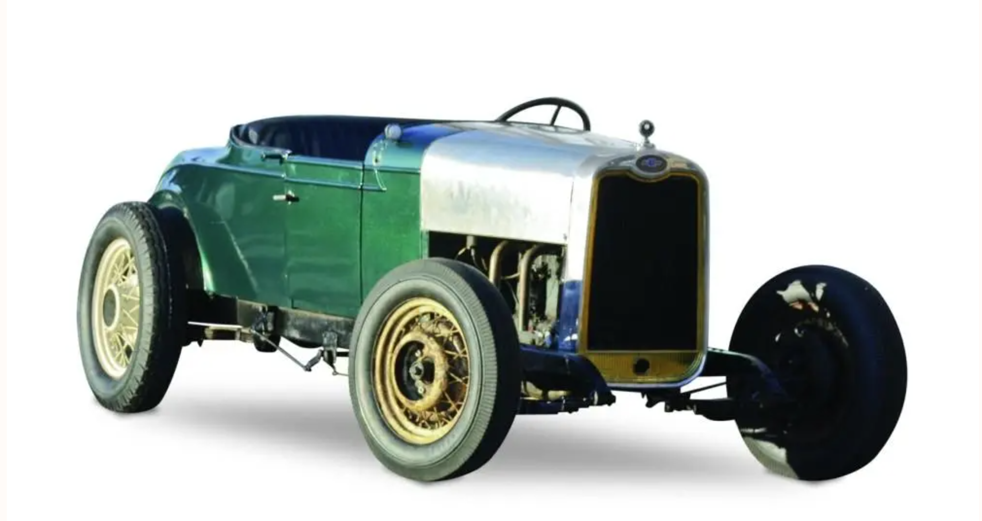

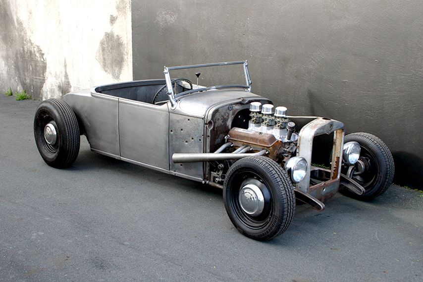

    Saw this over on Hemmings. Running a banger but it'd look good with any power.
  4. This thing is just oober cool, do you have a link to that Hemmings post?

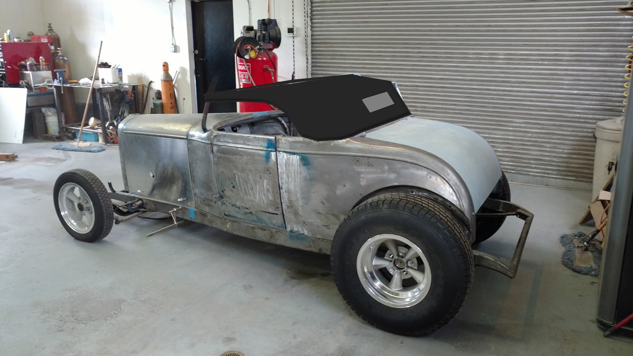

    Glad to see another Chevy project, but that is a coupe body. They look like a roadster when the wood structure is taken out, because the top portion was all wood. flyin t shows a Chevy 27-28 roadster . Not to say you can't build one out of that as I did. Older picture, I redid the top rails. 27 top lr.jpg

    out of curiosity how can you tell it was a coupe? ill prob built it as a roadster

    Crenninger 27-28 Chev roadster have a longer trunk along with the body bead is different. If you look at flyin-t post you.ll see the difference along with cowl is rounded. Your cowl has a straight edge at the back and that was the lower windshield channel. I have had several of these both coupes and roadsters. I hope you do build it as a roadster and if you need help with anything let me know.... Ron
