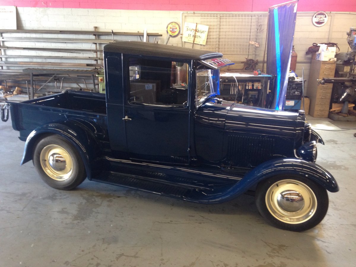

    I got my roof and all the cab side wood finished and done now.
    Made/modified my own door latches so there is a striker to keep the paint from scratching from the latch. also I recessed screws in all the wood instead of nails to make everything removable for paint, etc.
    And the seat is now modified, at pretty much made the back straight up and down, i will contour the foam to get a little back support, needed my *** as far back in the cab as possible for some leg room!
    Now I gotta build the seat frame/mount and then off to building the visor.
    -Gary

  7. I am building the same truck. Is that a 4.3 chev v6? I am thinking the same so I don't touch the firewall and can still get condenser in front of rad.
    Are you going to run air?
    What is the front crossmember and is it 4 inch dropped axle? I want mine to sit like that.
    Front tire wheel size?
    Thanks
    Gordon

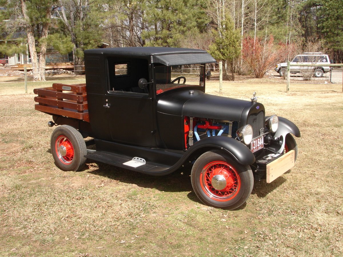

    I really like your top treatment. Here's my '29 CCPU extended cap. Some what of an illusion of a chop by flatening the roof DSC00006.JPG

    Yes its a 4.3 Chevy, and yes I have air on it. I had just enough room to make everything fit without cutting the firewall other than to make room for the distributor.
    It has a stock crossmember with a 4" drop axle, the front wheels are 15x5 with 145r15 tires.
    - Gary

    It's been awhile since I posted anything, been busy working on the truck! Got a lot done, ch***is is done, I've fired the engine, the body and a few misc parts are painted.
    -Gary

    Great color choice, the stance is spot on too. What size/brand are the rear tires?

    The rears are just roll arounds, they are oooold tires lol. They are 15x7 wheels and 235r15 tires.
    The ones I'm going to use are 15x8 wheels with 255/70 r15 tires.
