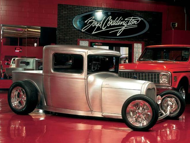

    Looks a little like this pick up

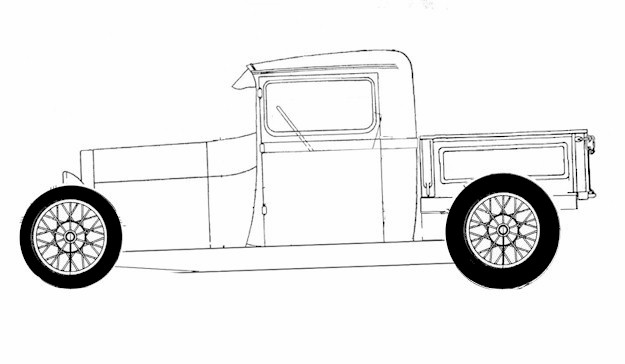

    I have been looking for a while for pieces to build a metal body. In my search I came across the Bruiser Body website.
    This company has changed hands and the molds were moved to Texas along with the name. I contacted them to see about getting parts so that I could put this together. It turned out they had molds for a Tudor, A Coupe and a 1931 pickup. The drawing is a photoshop but is essentially the front of a coupe that is stretched behind the doors and then the back of the 1931 pickup is brought into place. We are piecing together out of fibergl*** what was originally conceived on paper.
    I am working on a perimeter frame to match a 1932 frame, but will use 2 x 4 rectangular tubing. I am waiting on the body for final frame construction as I want to ensure a tight fit. It will utilize a spring behind front end. I still have not decided on the engine as I want it to all fit under a stock hood.
    We are working at being able to sell this cab. I also have the lead on a 40 inch fibergl*** pickup bed as well

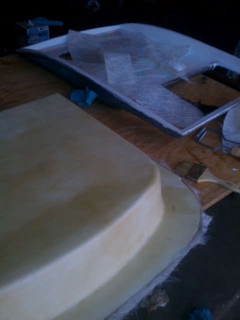

    Finally getting out of the mold
    I am also starting on the framework with my ac***ulation of parts
    Using a Superbell with split wishbones

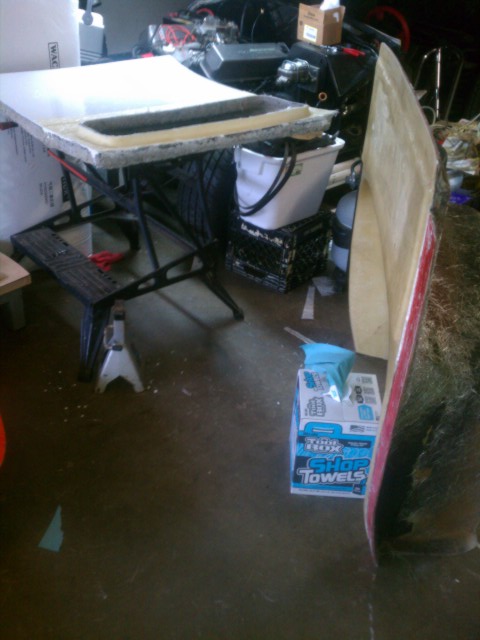

    The floor is now installed and it is out of the mold. We now will attach and mold on the back from a 1931 pickup as well as a flattened roofline to finish it all off.
    1927graham likes this.

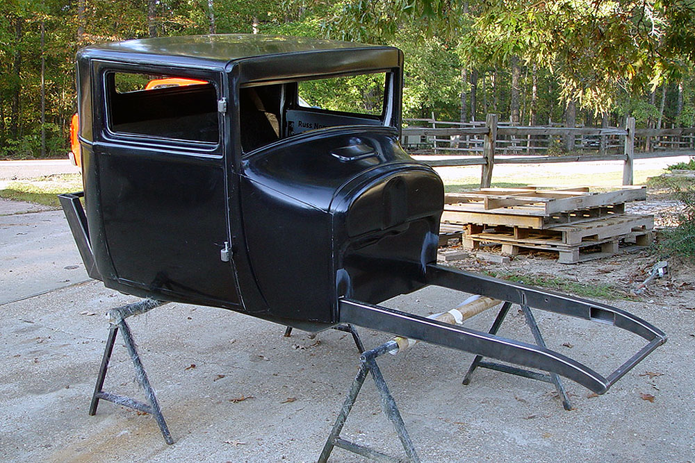

    Nice job on the body build!!! FYI, I got mine commercially (by Russ-no-more, but I believe they are no longer being made). As you can see, it's very similar to your masterpiece. Love these kinds of bodies, they look so good they appear stock (except the chop). Gary

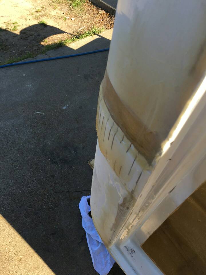

    Gary, they would not build another body for me. I was also looking at the larger size available in the Model a.
    Here are a couple more as we start to mount the door. I am also planning on not channeling this, but bringing the suspension down low.
    The hinges being installed
    This shows the inner bracing.
