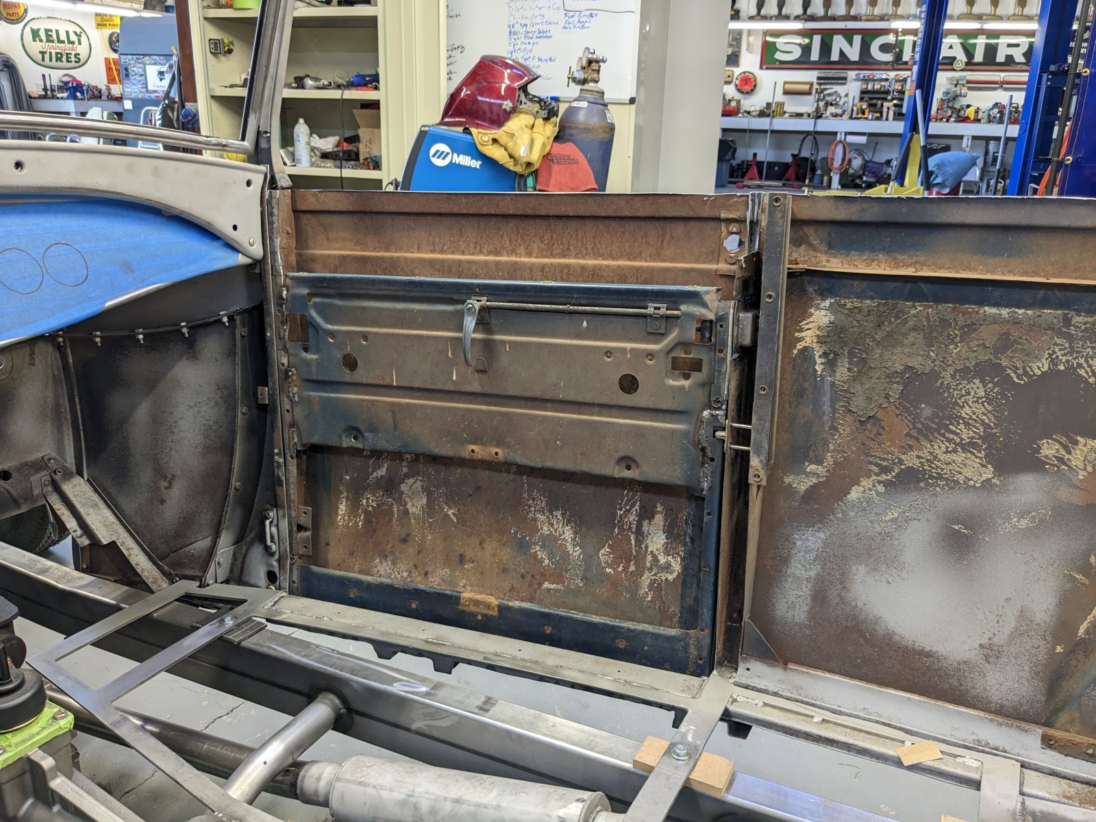

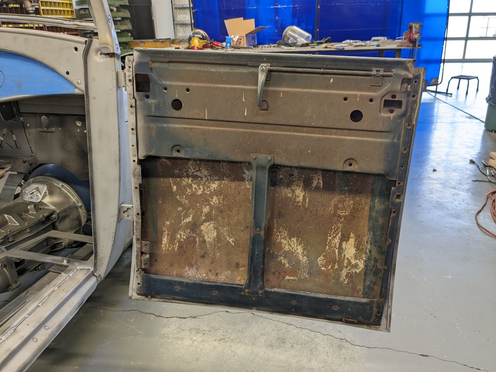

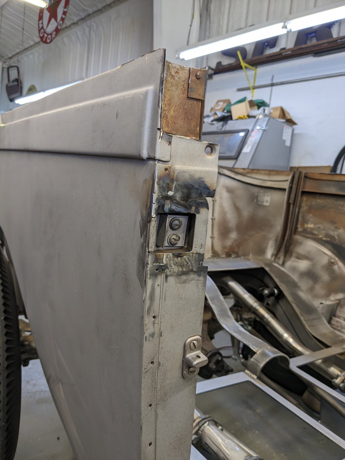

    So here's step one in getting the new body line capped off. Since the original lock ***embly is rather wide, it's impossible to keep the factory latch mechanism and also slim up the door thickness to fill in the gap where the window used to be.
    But then I realized I could just lower the latch mechanism down closer to the door dovetail snubber, and this would not only move that thick mechanism down and out of sight, but would also allow for a more centralized latch location, since the door is now much shorter.
    So I moved the entire inner door structure down 5"
    PXL_20230320_175959328.jpg PXL_20230320_180007667.jpg PXL_20230320_180012311.jpg PXL_20230320_181151719.jpg PXL_20230320_185234445.jpg
    And then moved the catch ***embly on the B pillar down as well:
    Door gap didn't change at all, so still pretty happy with that at the moment.
    So the plan is to do a 1.75" wide upper rail, instead of the 2.375" that it would've been otherwise. Then have the inner door panel taper in to the original Model A structure that I moved down. Maybe it's hard to imagine, but I got it all up in my head. :rolleyes:
    So the exterior door handle holes will be filled in and I'll just run the Original Ford inside door pulls. Since this is a roadster, the security literally went out the window, and a battery isolator and kill switches will be more than enough anti-theft prevention.
    So that's one door modified, I'm gonna be on the road for the rest of the week, but I'll get the driver's side matching and then I'll start on that new upper body rail.

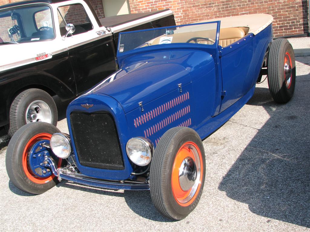

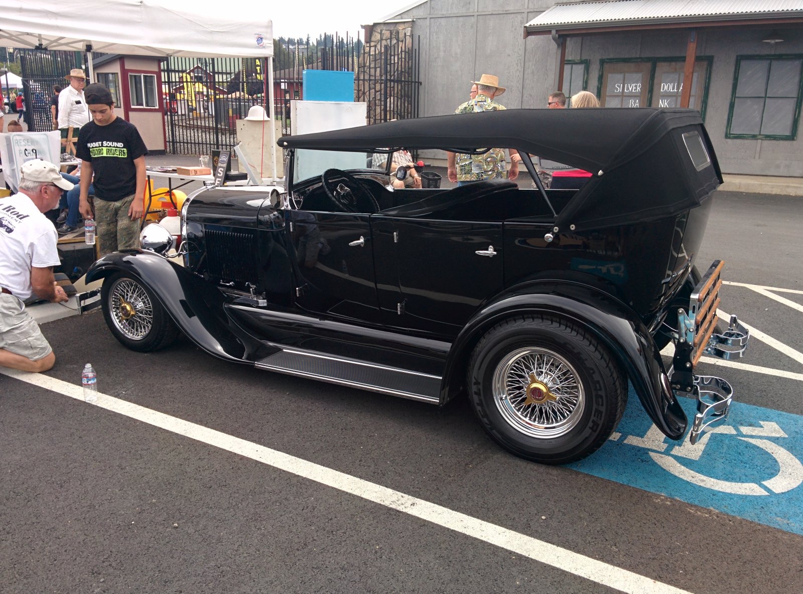

  11. A Boner
    Joined: Dec 25, 2004
    Posts: 8,187
    A Boner
    Here’s a pic for inspiration!

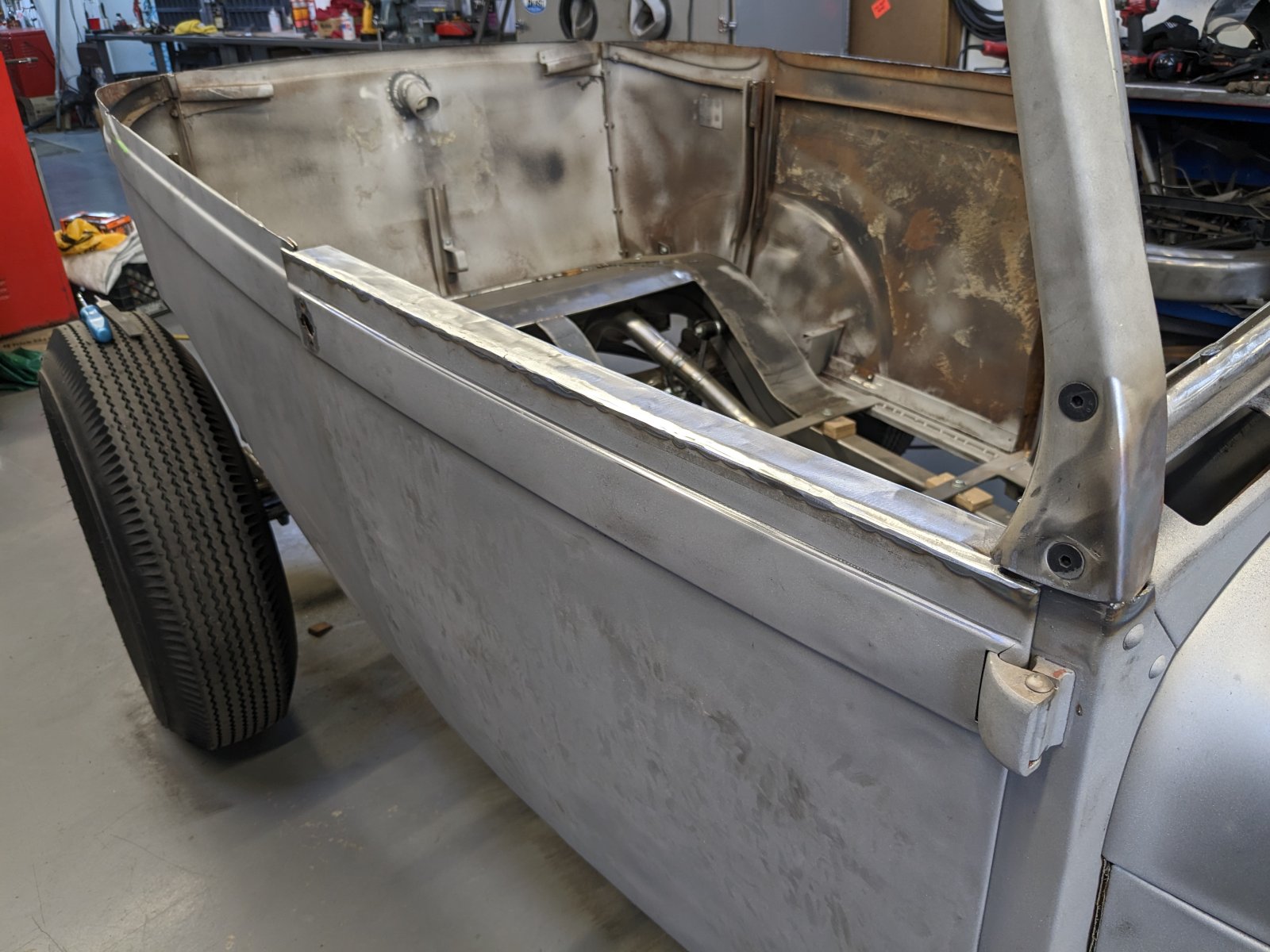

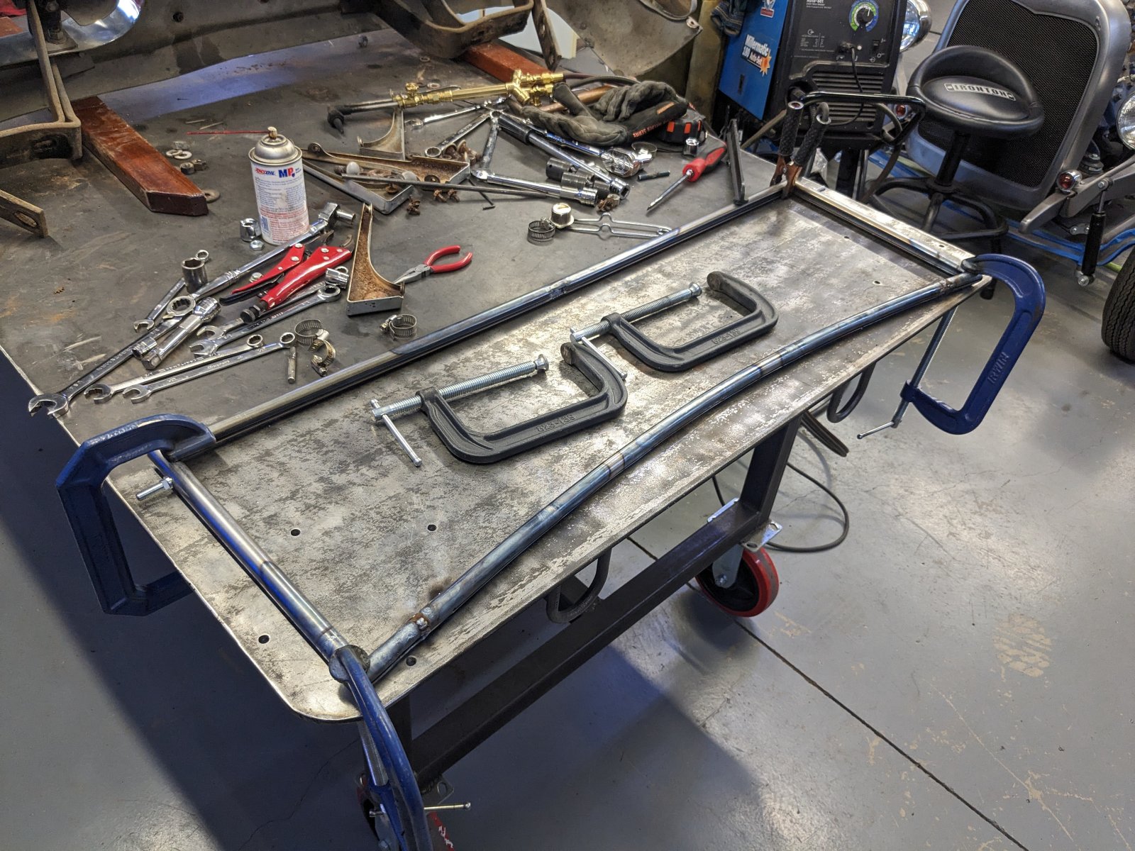

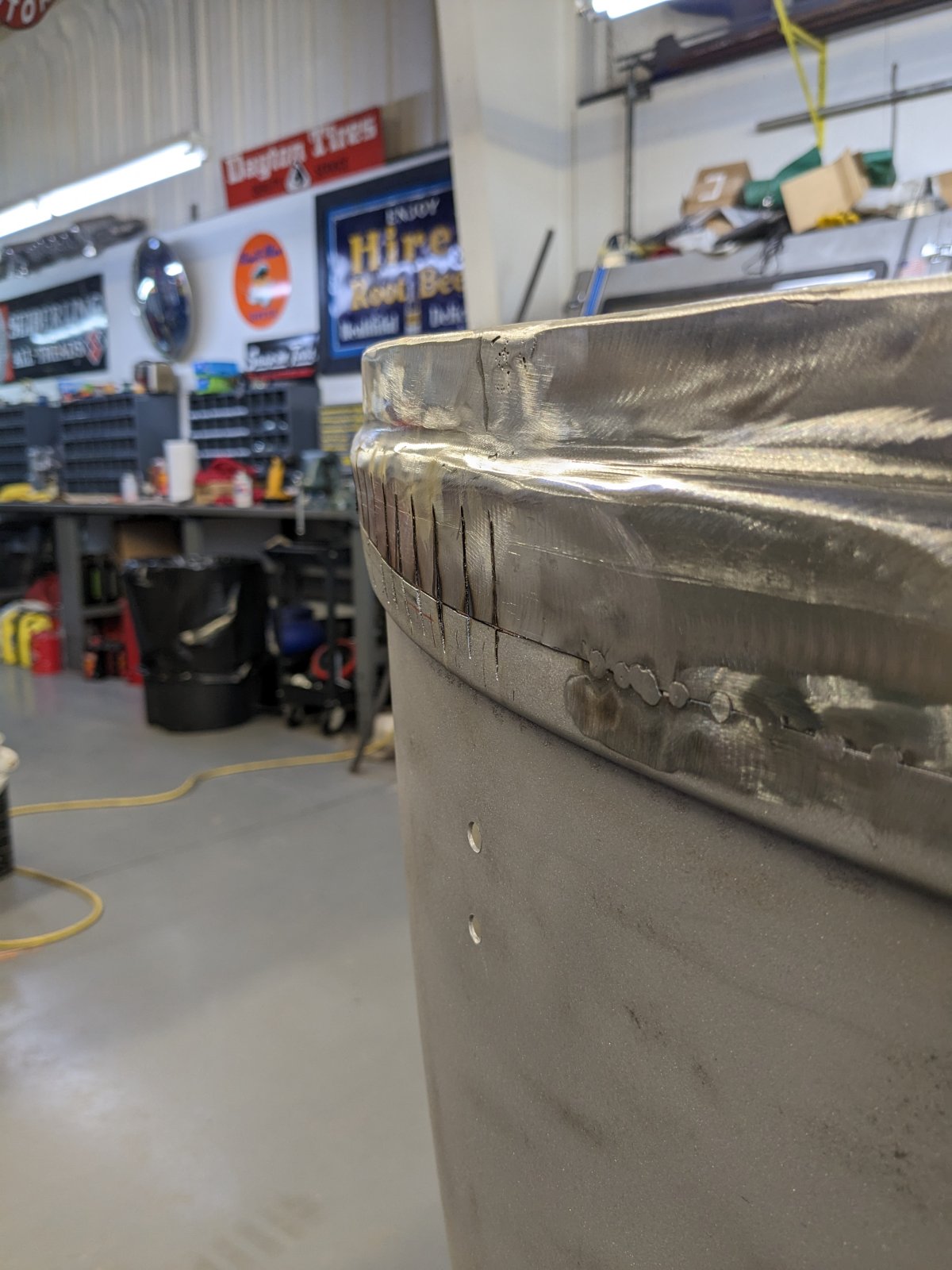

    Finally back from my trip and got in some more time on the Tub.
    I got 1.5" square tubing with .120 wall to use for the upper body edge all the way around. Obviously, these bodies aren't straight anywhere, so there will be a lot of pie cuts and tweaking as it wraps it's way around, but that's why I chose the thicker wall.
    You can see in that pic especially^ that the upper door is beginning to look more similar to a Roadster:
    Thicker, but not as thick and unsightly as the original door uppers.
    I'm still workshopping a few ideas for an arc to transition to the dash:
    I'll tidy up the A pillar areas once I have that transition worked out. In the meantime, moving on to the p***enger rear upper body piece. I decided to do all my R&D on the p***enger side, and then apply what I learned to the driver's side where I'll be spending more of my ownership.
    More to come, just wanted to throw an update on here.

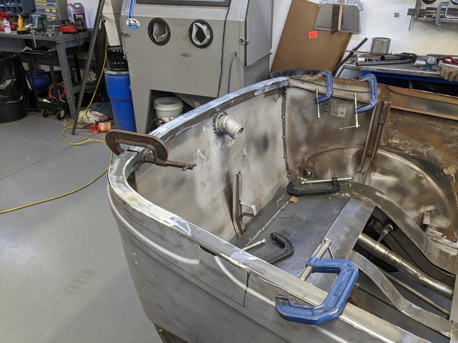

    Wound up getting called to do another 1500miles roadtrip this week. So just now getting back on this. Getting the 1.5" tubing pie cut and bent to match the new body-lines.
    In that pic^ you can see how the body actually wants to spread out and away from the tubing in the corner, that's because the roof on a Tudor is wider than the beltline. I'll be reversing that and the body will actually transition inward to the new tubing.
    There will be some creativity involved to bridge the gap between the two pieces of tubing and also tie in that factory body welting between the two panels.
    The rear piece is pie cut both up and down but also fore-aft to get the Phaeton style arching rear.
    Got my cut area marked, now time to slice it out and start metal shaping a new piece.
    ^There you can get an idea of how the body lines are going to flow. The lower is the stock Ford and the upper will follow it back and then flow up into the upper corner area.
  18. caprockfabshop
    Joined: Dec 5, 2019
    Posts: 698
    caprockfabshop

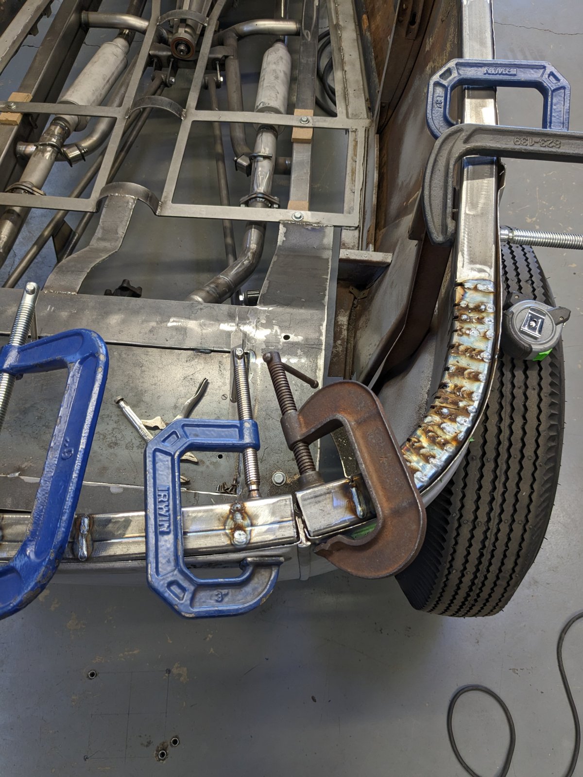

    Borrowed a buddy's bead roller to get the majority of the new panel worked out.
    PXL_20230403_235236081.jpg PXL_20230403_235241746.jpg PXL_20230403_235246766.jpg PXL_20230403_235250982.jpg
    Not my first rodeo, but definitely learning everyday! The upper portion is 85% there, still some low spots to cleanup, but I was able to do it all in one patch panel.
    You can see here ^ how the new panel sticks out further from the old metal, I'm going to do some relief cuts to shrink the upper piece in and transition smoothly into the old metal.
    Like this:
    Overall I'm very happy with how it's flowing and the body is starting to really get rigid with that .120 wall tubing around the perimeter. I still need to tie it into the B pillar and there's an old brace in the C pillar area that I'm going to tie into as well. Curious if I can get away without a brace behind the front seats....
    shortypu, Gotgas, Jeff34 and 5 others like this.

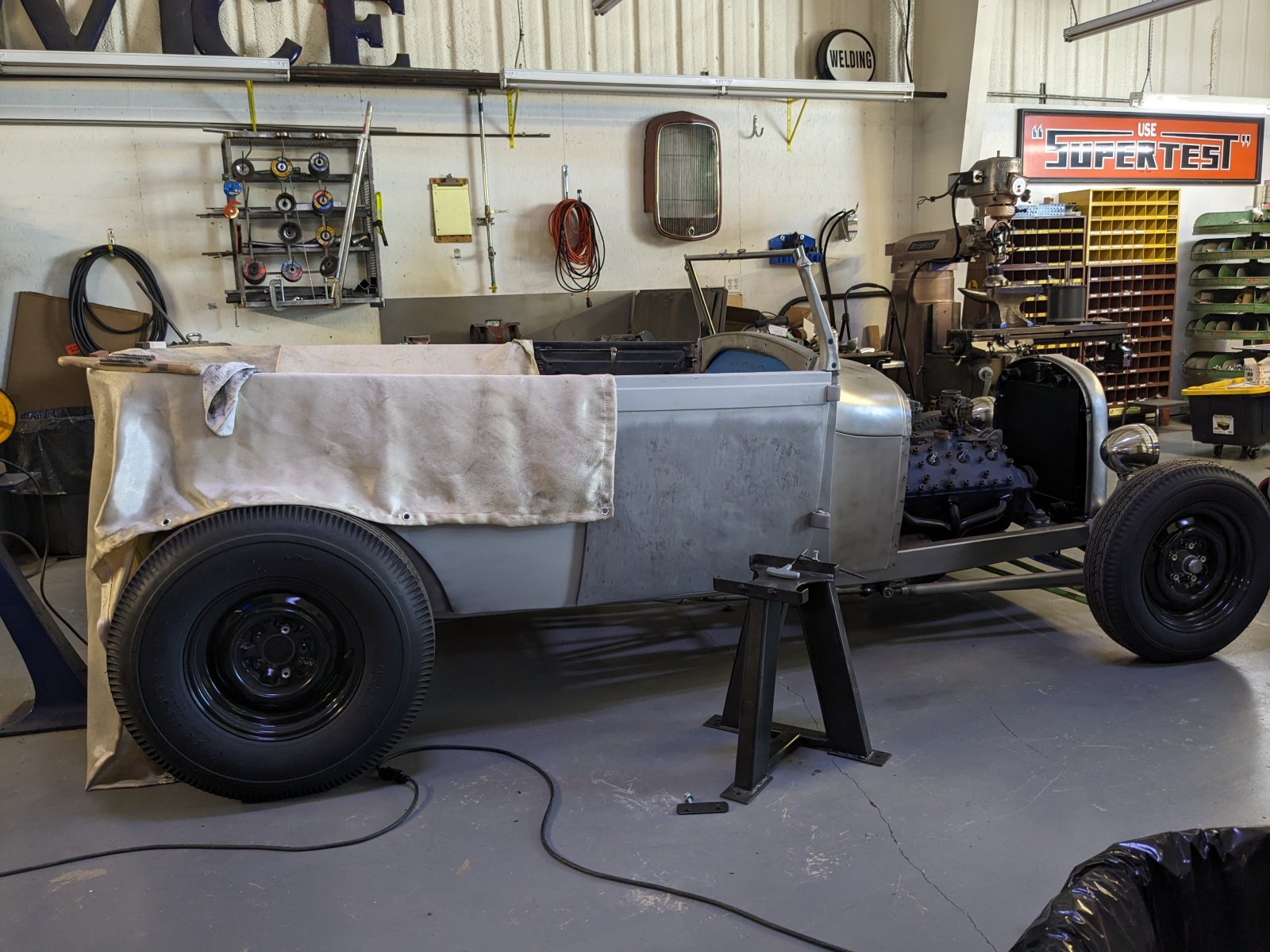

  23. caprockfabshop
    Joined: Dec 5, 2019
    Posts: 698
    caprockfabshop

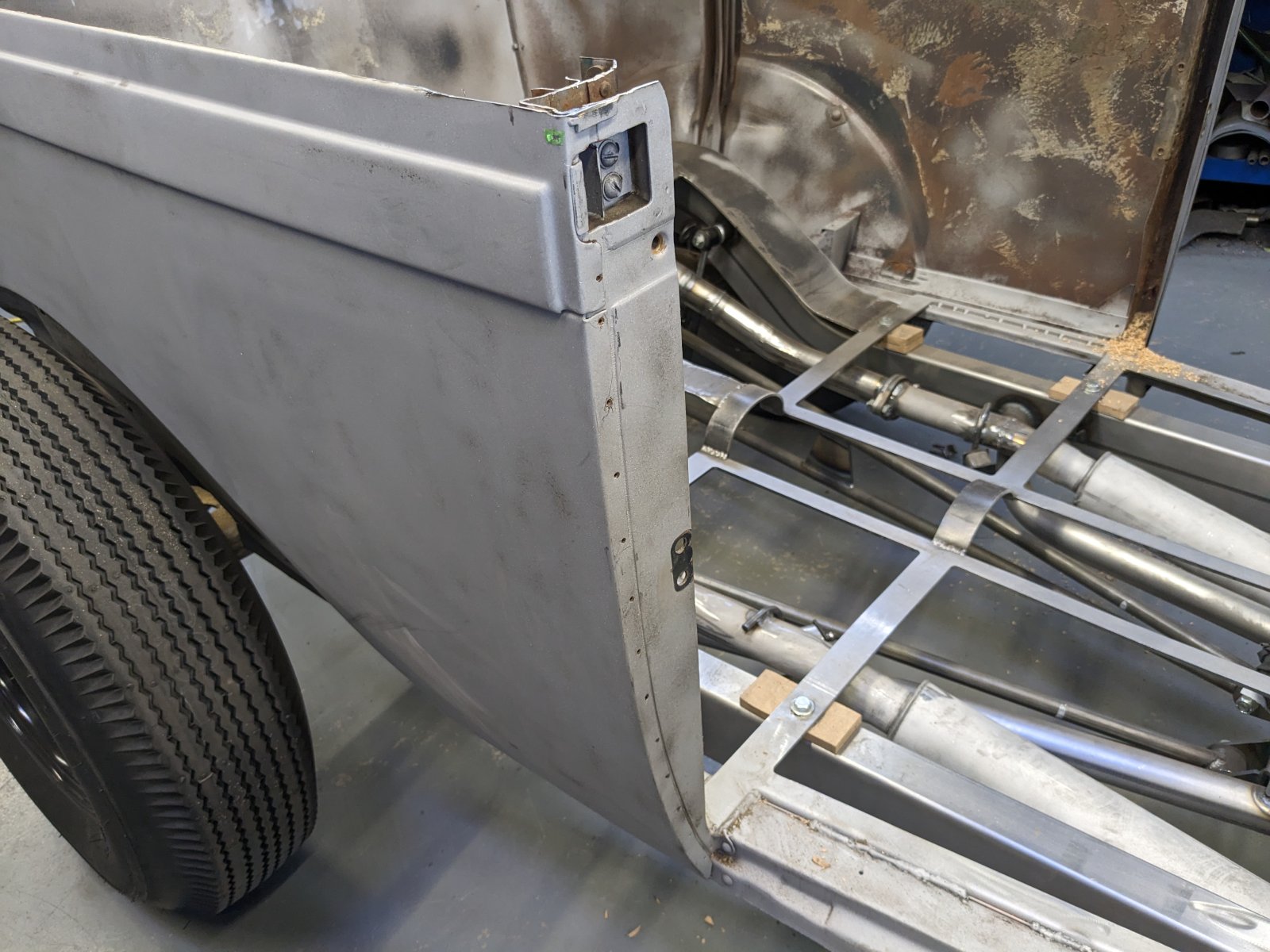

    Finished up the majority of the p***enger side metalwork. Epoxy primed in the meantime, until I get to overall bodywork and paint prep.
    Here's how those relief cuts worked:
    And outside for primer, 70°+ today here in Lubbock.
    PXL_20230409_180948570.jpg PXL_20230409_181013413.jpg PXL_20230409_181108257.jpg
    Now to make the driver's side match...

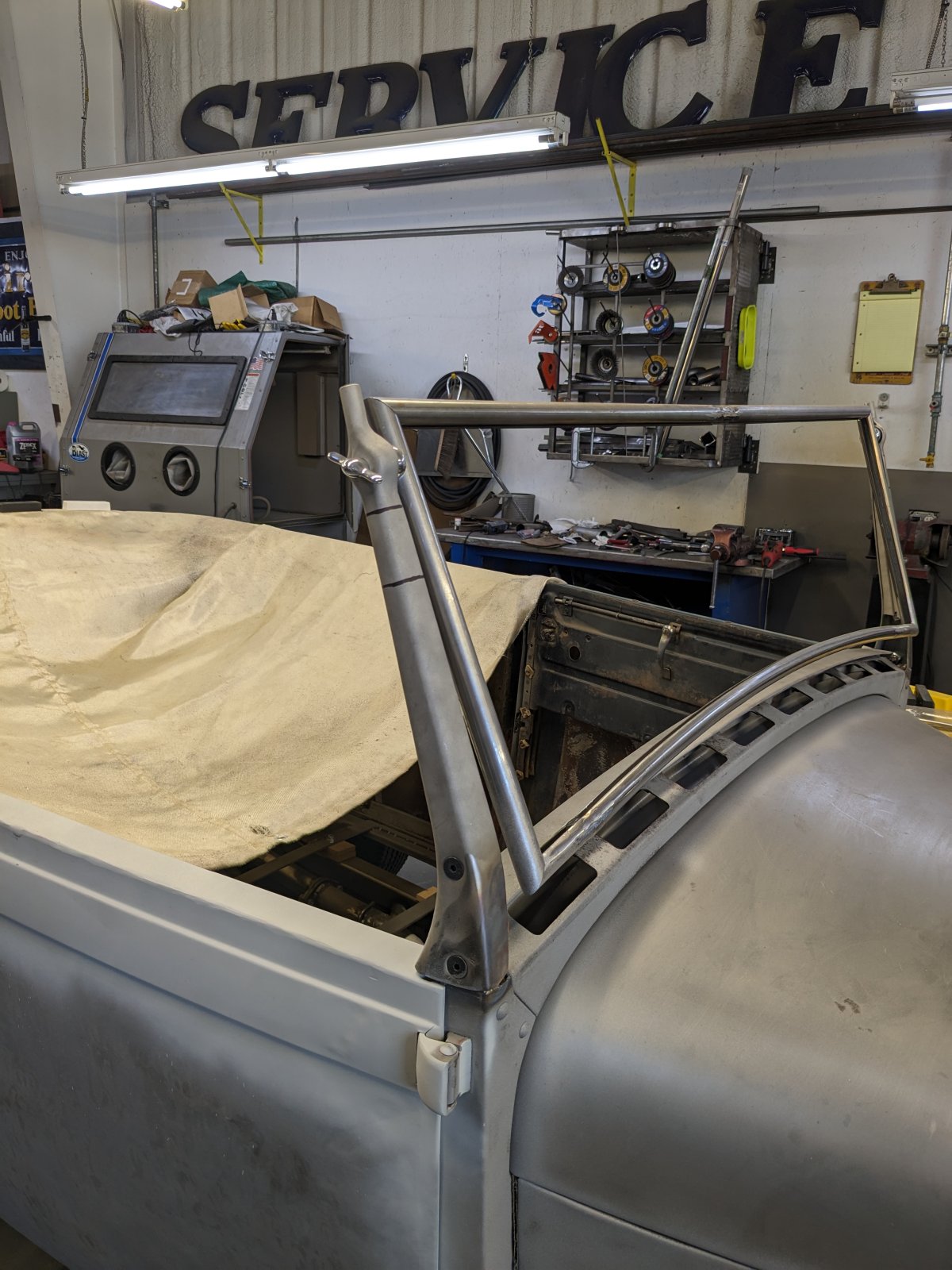

    It's been a tough few months. Pulled in all directions on many projects, trips, crisis, etc... All the while this car is just eating away at my mind. Finally got time last week to get some more work done.
    Despite the stainless Windshield Posts being made with 2" chopped out already, I found that I needed another 2" removed.
    Of course I also realized that my initial work on the windshield frame was flawed, so then I had to start re-doing that:
    This is a widened but stock height 28-29 frame, and the arc of the cowl is different as well, which required multiple tweaks.
    Got a much better windshield height and angle now. Really loving the profile view!
