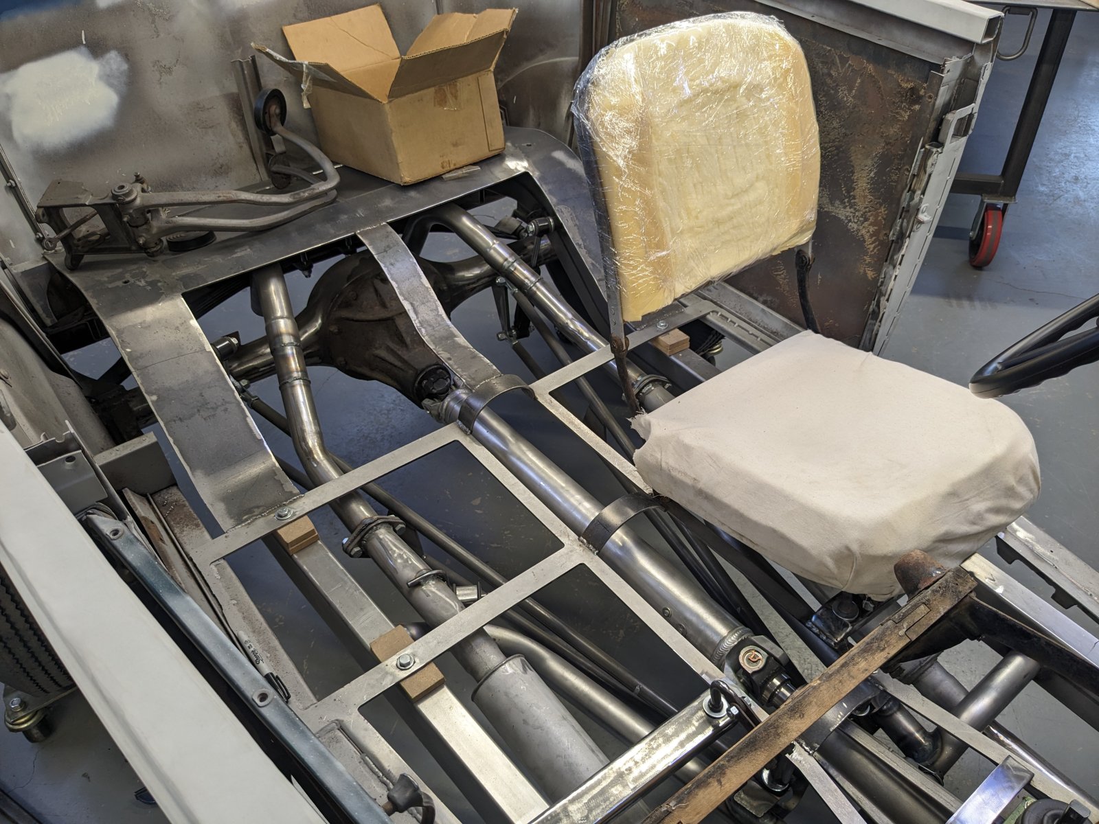

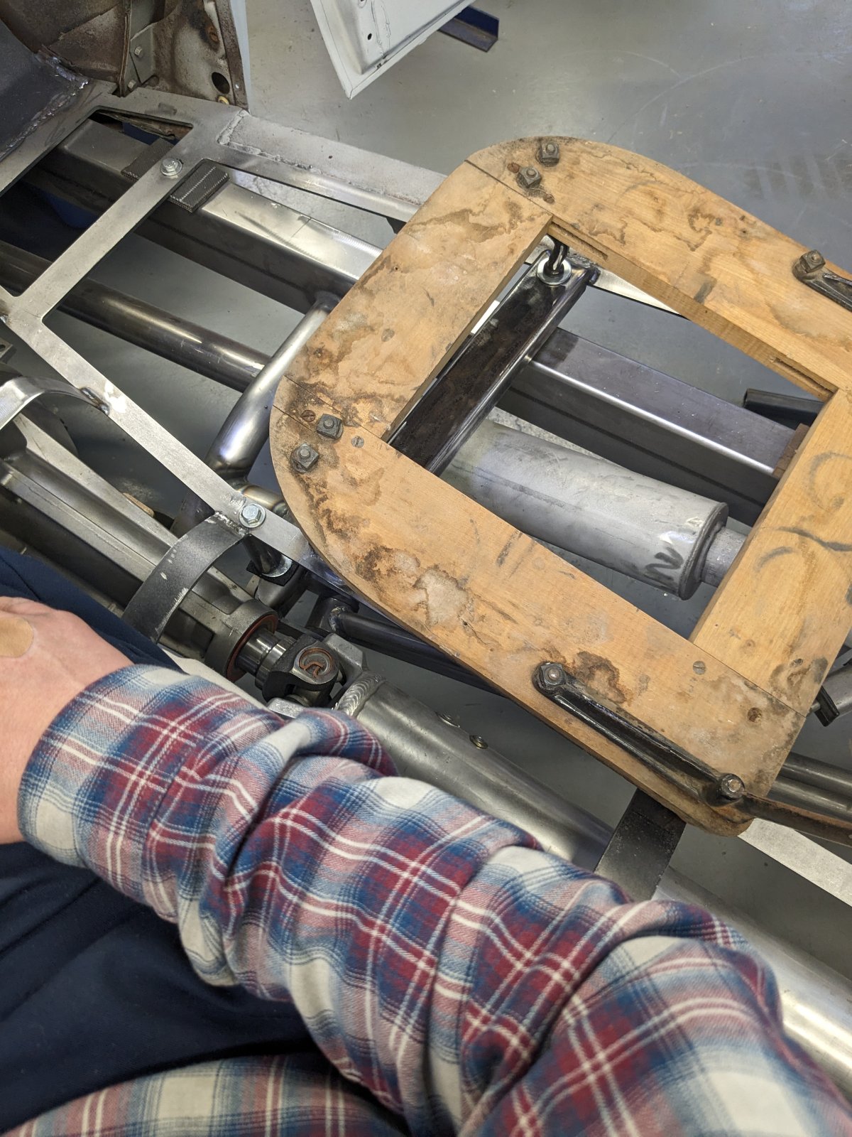

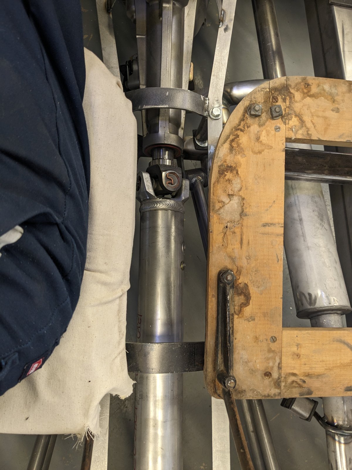

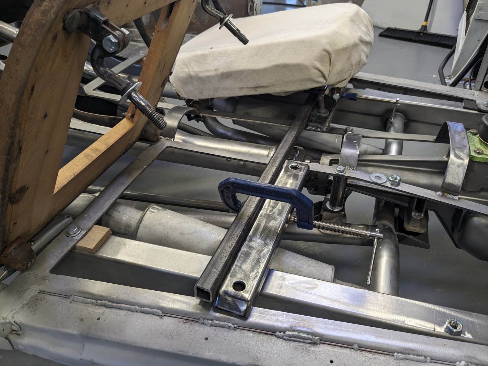

    2 months late(r), finally got the p***enger seat mounted.
    Aligned the two rails, and welded it in.
    Got all the seat mounts to match, that's rewarding:
    And of course, the big question, does the seat fold forward?
    PXL_20240317_214936756.jpg PXL_20240317_214941745.jpg PXL_20240317_214946115.jpg
    YEP!
    PXL_20240317_215034982.jpg PXL_20240317_215046786.jpg PXL_20240317_215052886.jpg PXL_20240317_215116043.jpg
    Elbow room is tight, but not bad at all:
    Now onto Gas Pedal Bracket, finish the floors, and start on the plumbing.

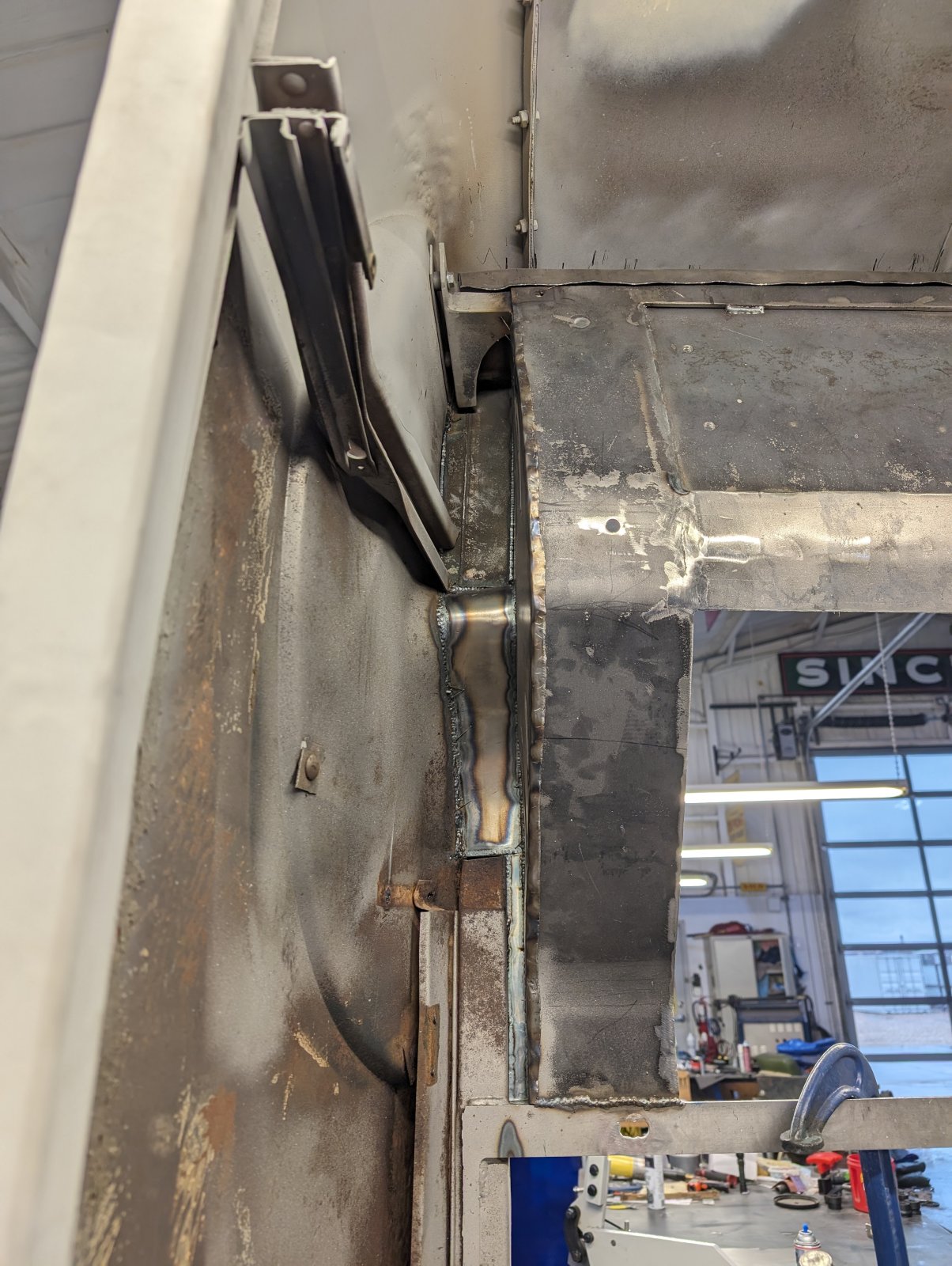

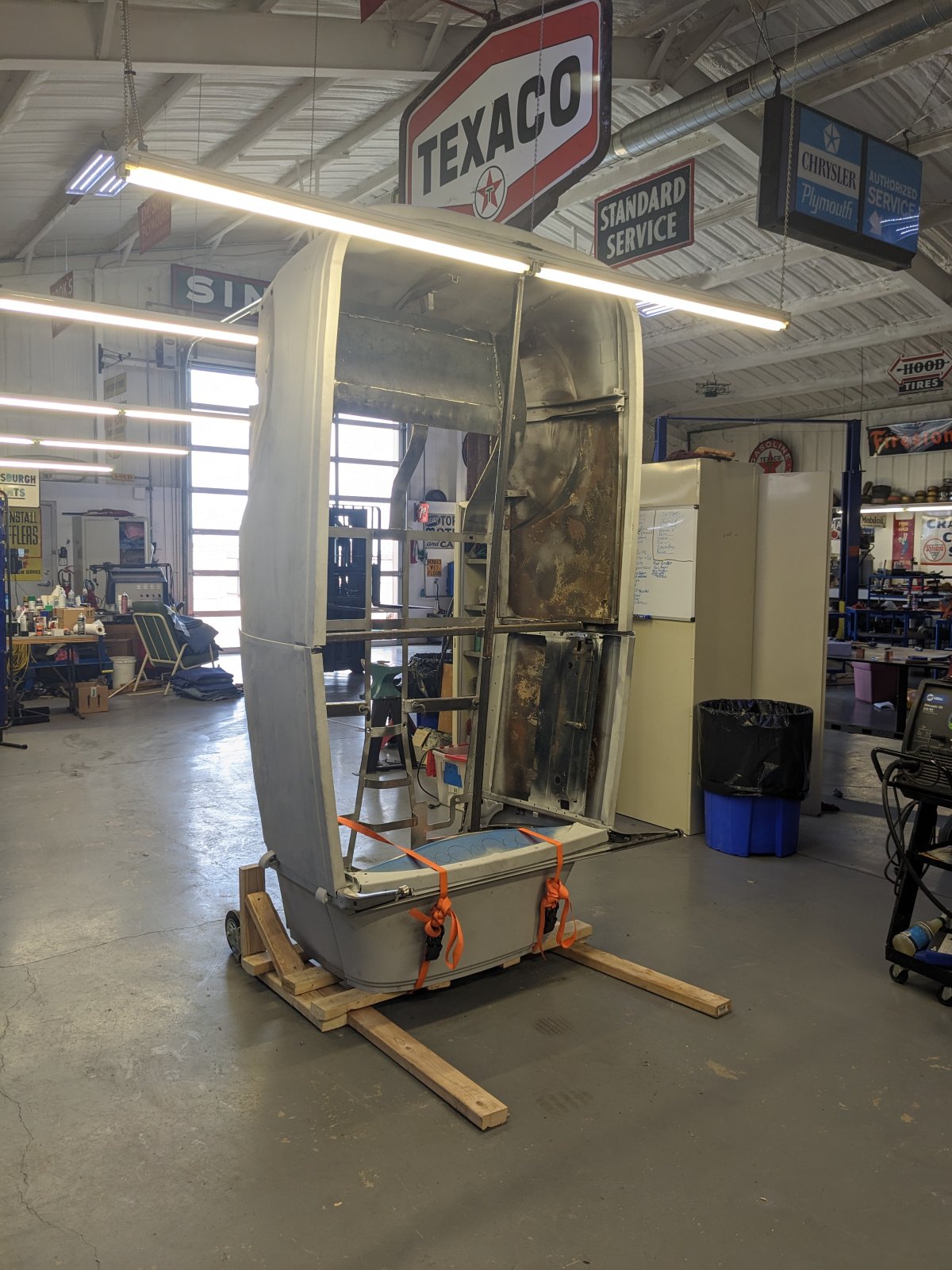

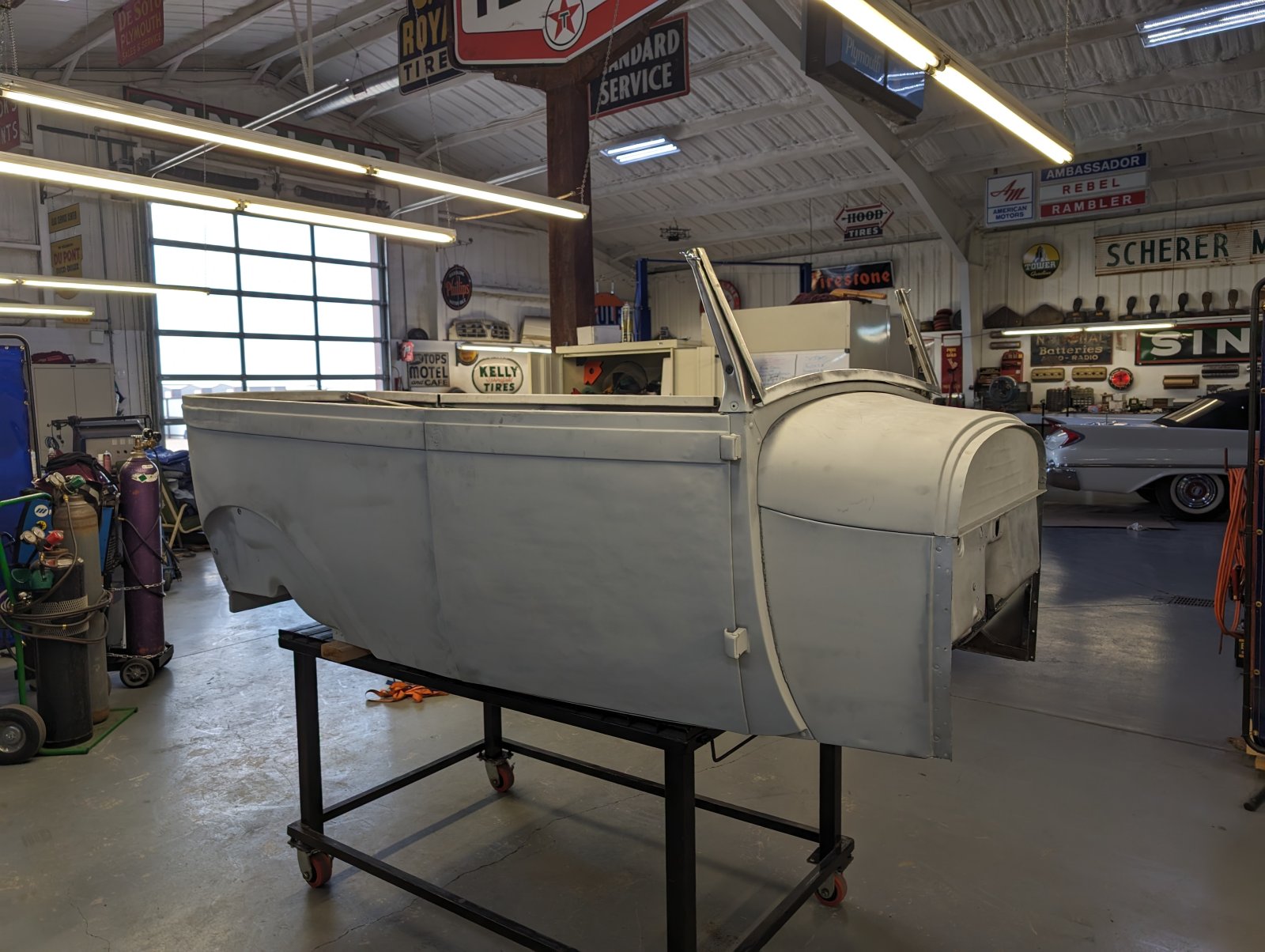

    Decided that the body needs to come off to do the floors properly, since I need access to the bottom, especially in the rear section. So it's getting lifted off today, and then I'll build a fixture to support it on it's firewall so I can stand it up on end and work on the bottom. Short of a rotisserie, which I don't have, this is the best way to get access.
    PXL_20240320_153758963.jpg PXL_20240320_153808886.jpg PXL_20240320_153815597.jpg
    Fore to aft bracing to allow the weight to be transmitted evenly through the body once on it's firewall, and sideways just to add a little support to the B pillars. All can be cut out once floors are done and the body is once again installed.

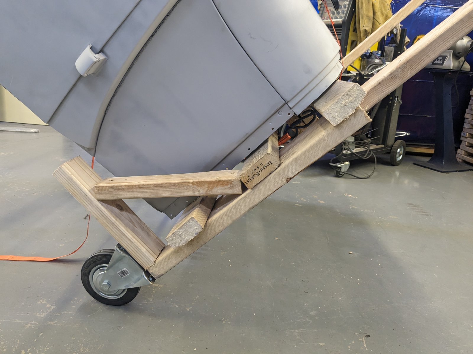

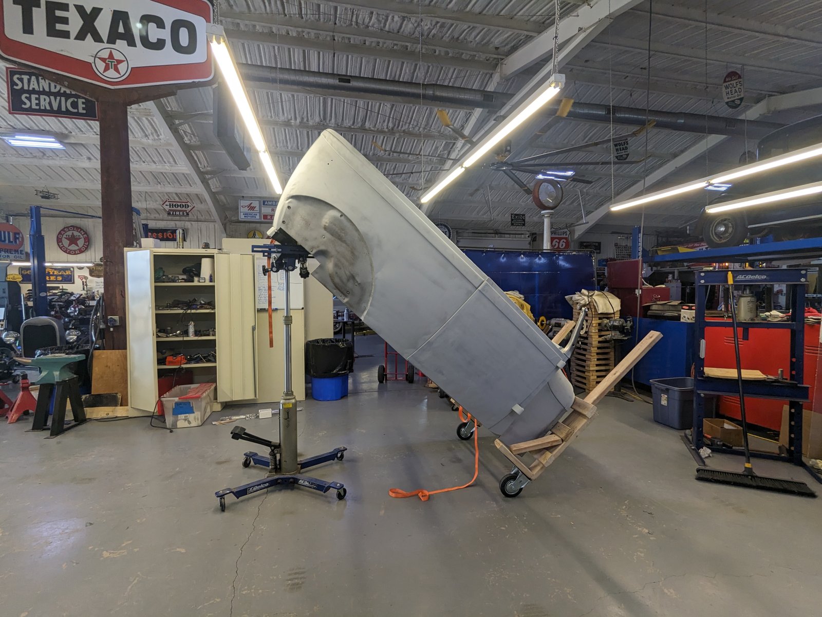

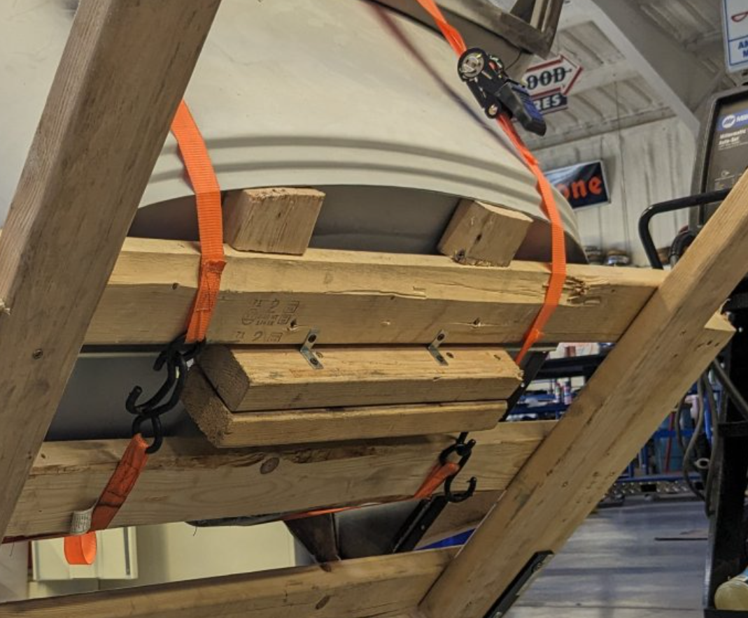

    I started out building a quick but strong framework for the firewall. It's clamped onto the horizontal seam and braced off the lips, so it's not deforming any metal.
    After getting it 3ft in the air with the forklift, I switched to a transmission jack for a more precise lift:
    The wheels in the corner of the firewall brace allows for an easy and smooth transition. From here it was just getting a couple guys under it to tip it to 90°
    PXL_20240320_191006055.MP.jpg PXL_20240320_191017141.jpg PXL_20240320_191022778.jpg
    Lot of access on both sides to the floor now, and I can create all my filler pieces and get them fully welded in. Also finishing out the rockers and wheel wells.
    PXL_20240320_191025762.jpg PXL_20240320_191029143.jpg PXL_20240320_191052137.jpg
    And the bracing I installed this morning meant that nothing flexed or shifted. All body gaps remain the same and doors open and close perfectly.
    So yeah, the ch***is will get rolled next door for storage for awhile until this floor is 90% done, then I'll finish weld/grind everything underneath, and epoxy prime it before re-installing back on the ch***is for plumbing.

  4. burger
    Joined: Sep 19, 2002
    Posts: 2,383
    burger

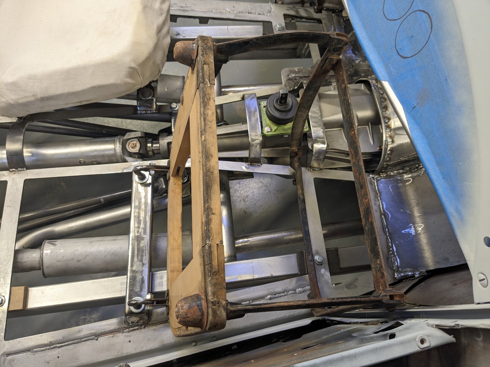

    Excellent idea on the dolly to safely tip the body over! As another non-rotisserie owning guy, I will have to borrow that one!

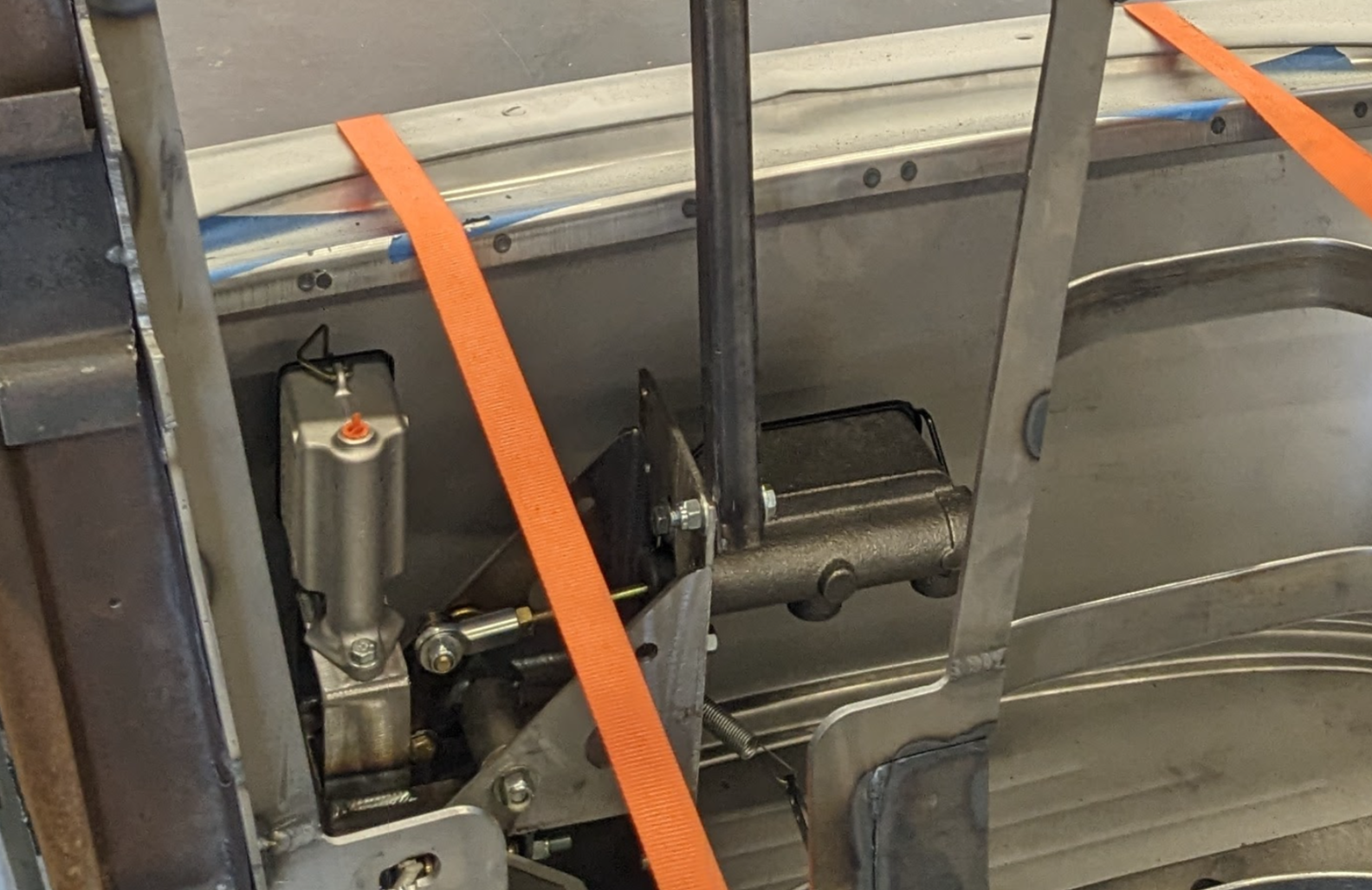

    Where does the front bracing attach?

  5. caprockfabshop
    Joined: Dec 5, 2019
    Posts: 698
    caprockfabshop
    The 2 horizontal 2x4s are pinching onto the cowl seam, this is very strong by itself, but then I added the 2 beveled blocks on top to transfer more weight into the upper cowl seam. Obviously, the ratchet straps are doing the heavy lifting here, and once the floor is done I'll have to re do how the straps attach, but this method required no drilling into the body, and so far hasn't caused any damage or stress to the body.
    Keep in mind though that a Model A body is 8' tall, so ceiling/light clearance should be taken into account.

  6. AmishMike
    Joined: Mar 27, 2014
    Posts: 1,455
    AmishMike
    Like how you have body standing but will it stay in that position when you undo to relocate straps? Also you will be adding weight with floor, are straps strong enough? I have straps like those. Wonder what body weights. Love your build.

    I’m wondering what the metal front to back brace to attached to at the front?

    It's bolted to the master cylinder bracket. Screenshot 2024-03-21 135211.png

    oh, and thanks for the extra brace photo :)

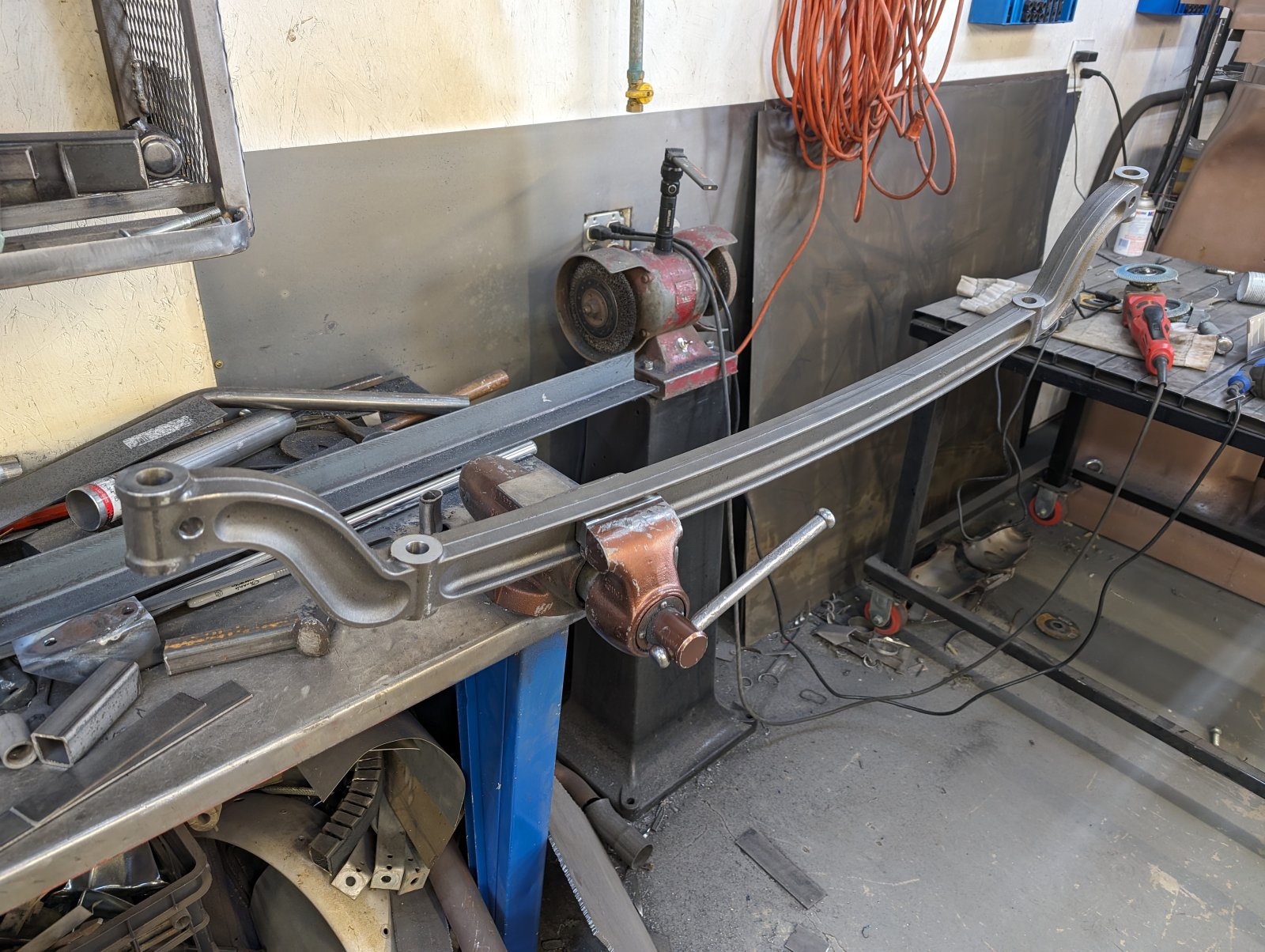

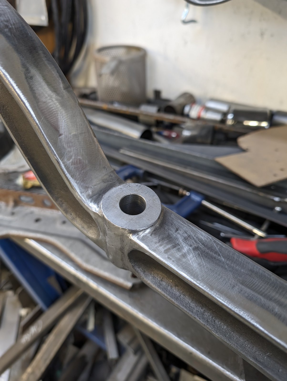

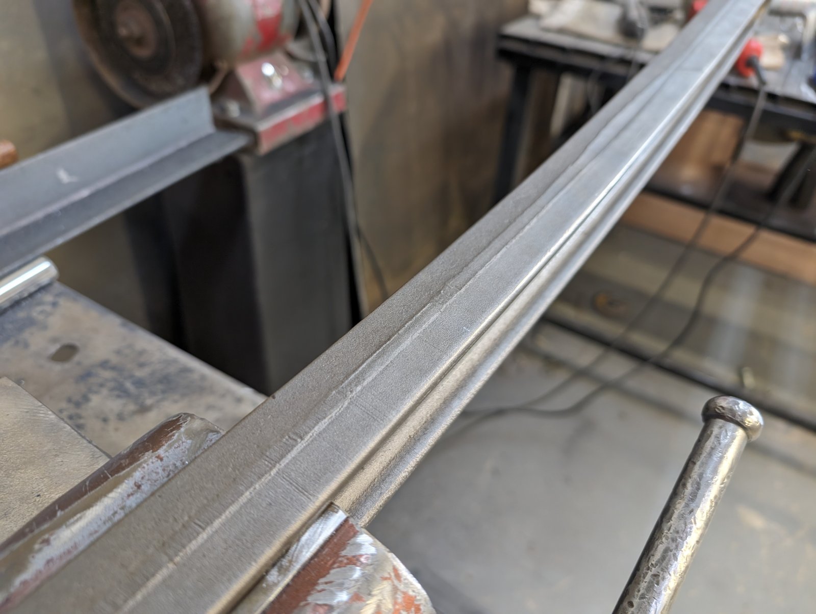

    Well, got some free time this afternoon, and thought I'd take a look at the So-Cal Speed Shop 4" dropped Forged front axle. You might remember I abandoned my old-chrome axle when discovering that not only was it giving way too much positive camber, but also was a cast item...
    PXL_20240329_180155511.jpg PXL_20240329_180159395.jpg PXL_20240329_180202902.jpg PXL_20240329_180205558.jpg
    Very nice looking, heavier than I'd expect, but it's also stronger than the factory axles too.

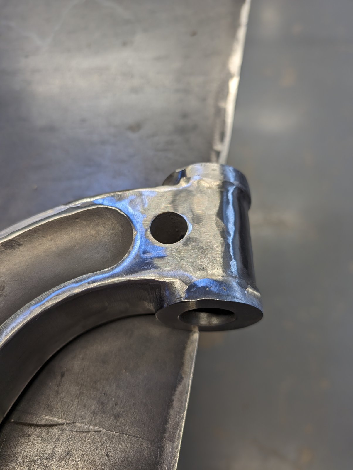

    I figured I'd go ahead and clean it up a bit, taking off that ugly spine from the forging process, and maybe see if I want to paint it or chrome it.
    PXL_20240330_013957149.jpg PXL_20240330_014017398.MP.jpg PXL_20240330_014023897.MP.jpg
    Then I started cleaning up porosities and browsing several fascinating threads on here about smoothing and polishing these things, and now it's getting outta hand.
    I'm thinking I'm going to get this roughed out to 220grit, and then see what I think, but I'm inclined to have it and the rest of the front end chromed. I have a shop I use that does really nice work, but not over the top, and that would definitely keep with my period-look; since even back in the mid 50's they weren't shy about tossing some bling on their rides. :)
    And before some here might chime in, I have considered Peaking the axle, but that may be far more labor than I'd like for a minor detail only a few would notice. Definitely consider filling until I saw how ugly that can quickly become. So I suspect I'll just smooth and polish all the exposed bits, leaving the inner portion as-cast and then mock it up on the car and ensure fitment prior to plating.

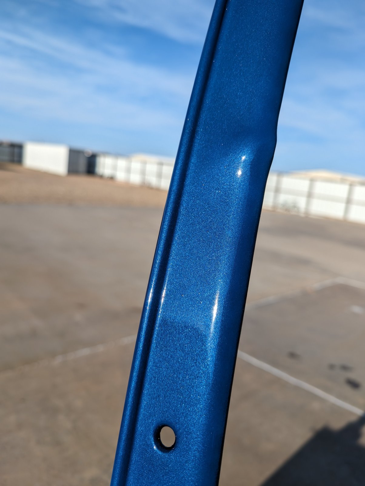

    Also finally found the color I'd been looking for. I was always wanted a Blue, but wanted to avoid the stereotypical Washington and other Darker Blues. Since my build era is 1956, I started looking at my vintage paint books and this one just jumped out at me:
    1956 Ford Truck Nocturne Blue Iridescent, Code B. One of Ford's earliest metallics, and just the right shade I was looking for. Going to look great with the Vanilla Cream Firewall and Ruby Red Engine!

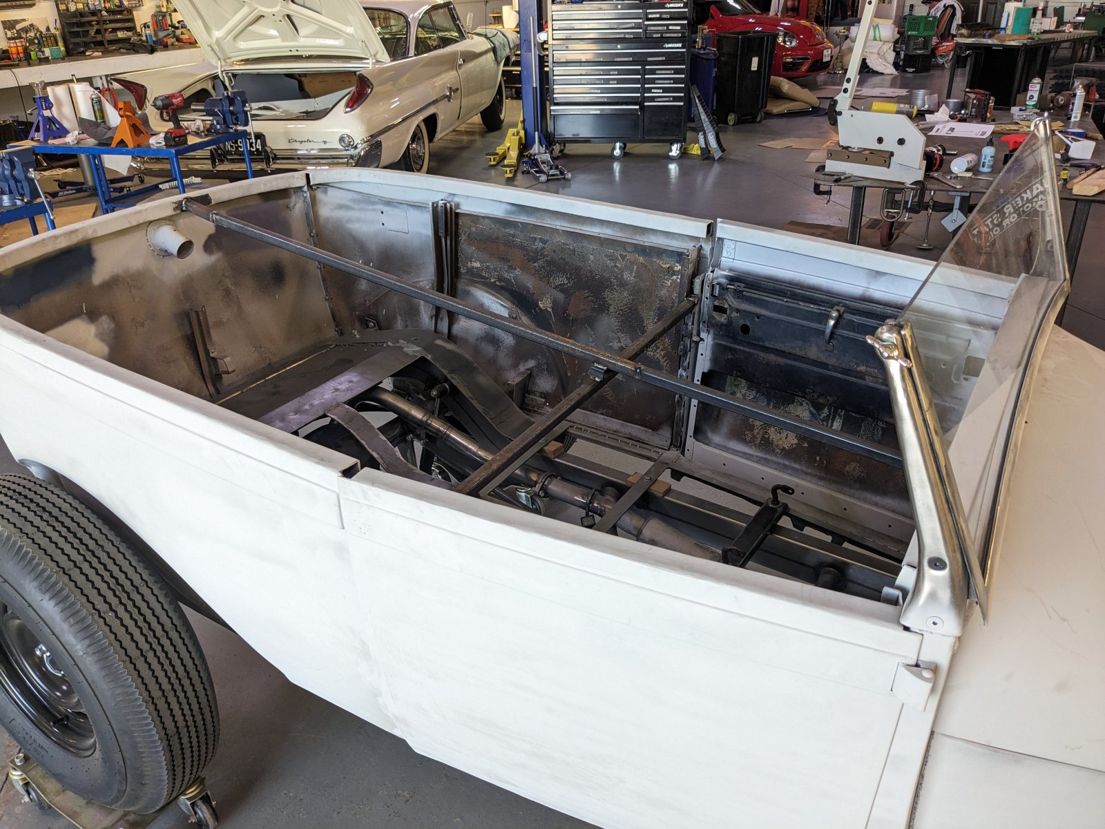

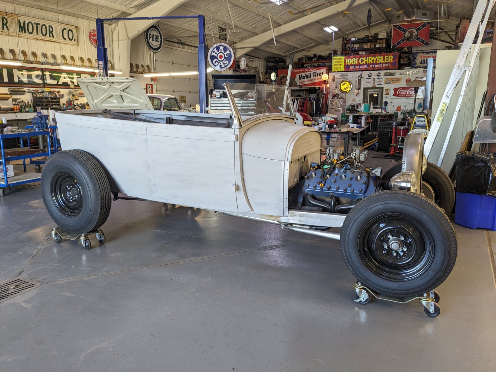

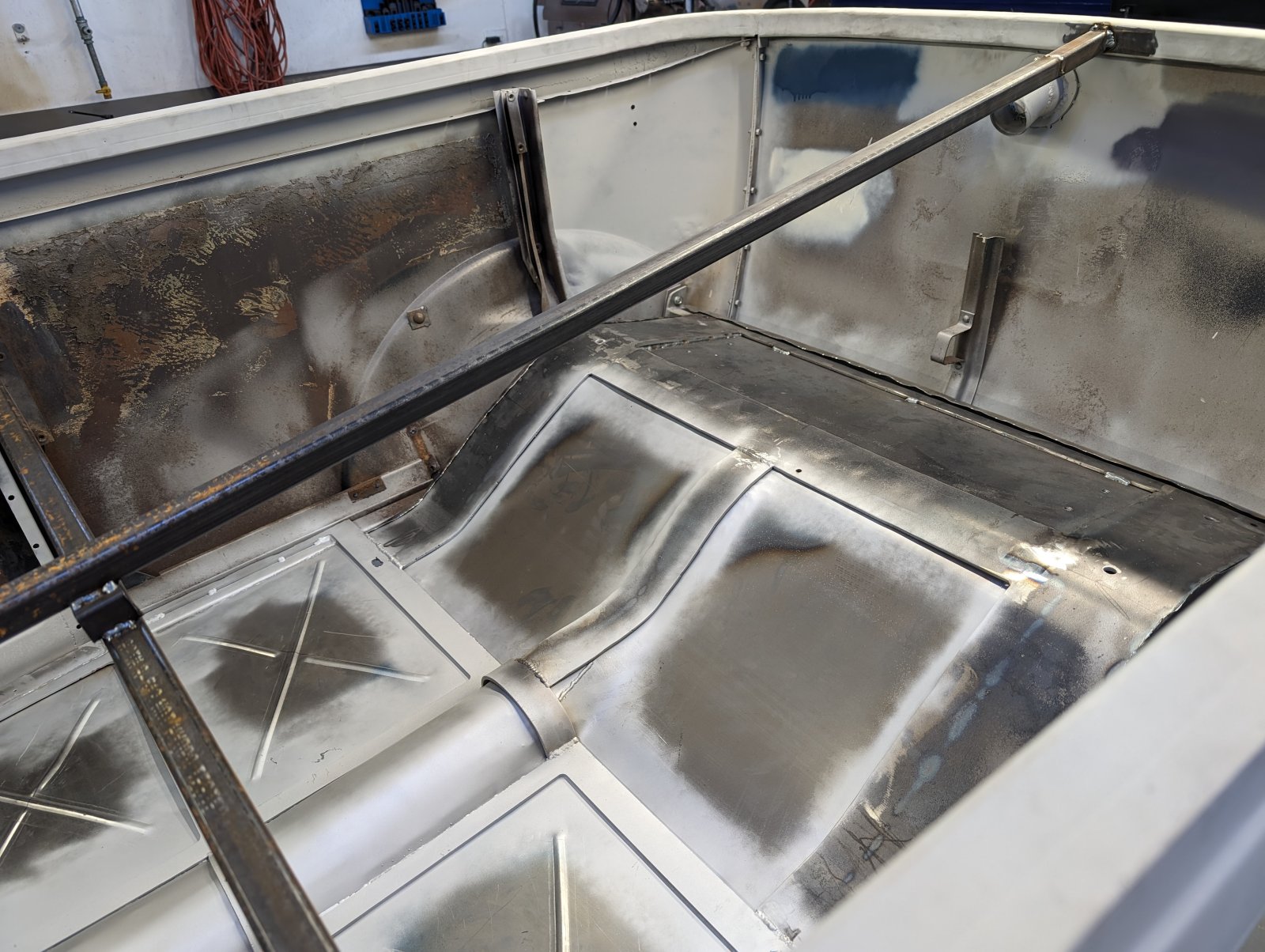

    Nice milestone, got the rear portion of the floors finished and the body back horizontal on the bench. Time to attack the firewall and cowl area before it goes on the ch***is for the trans cover.
    PXL_20240502_214555218.jpg PXL_20240502_214602843.jpg PXL_20240502_214617846.jpg
    Really happy with how the wheel arches follow the factory stamping.
