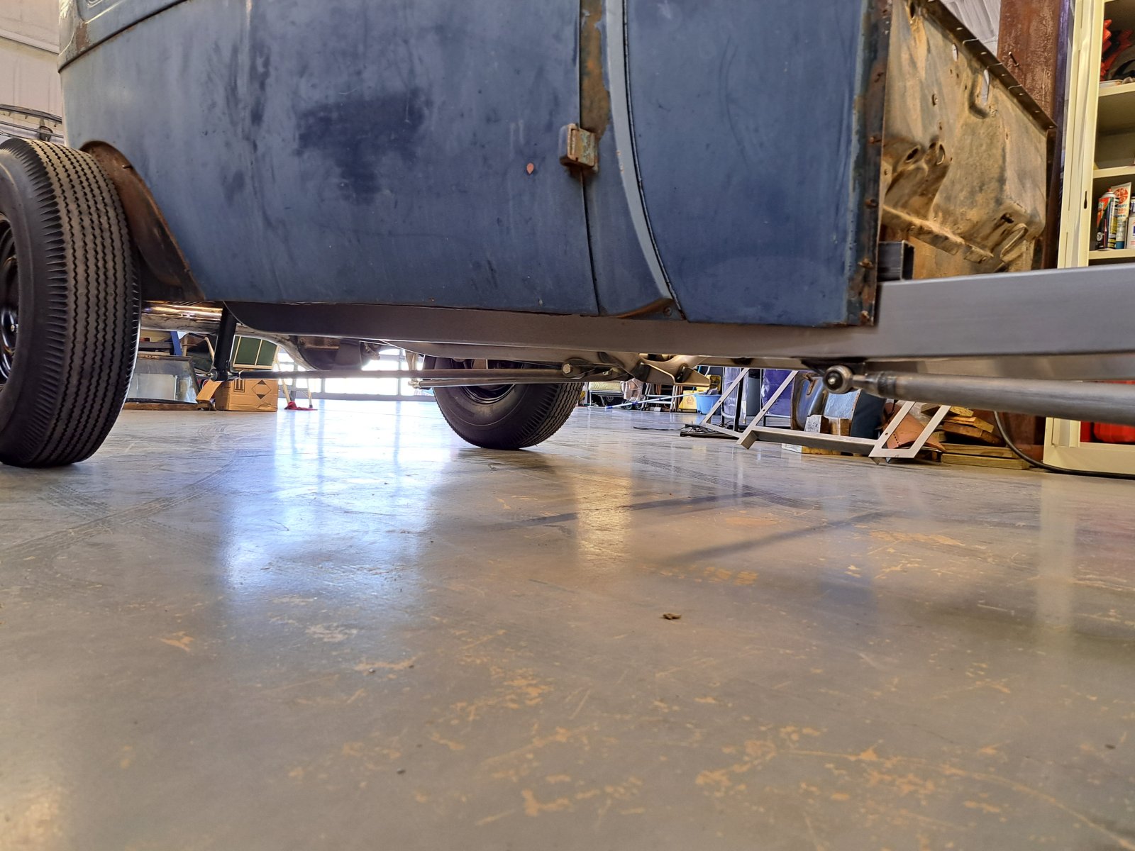

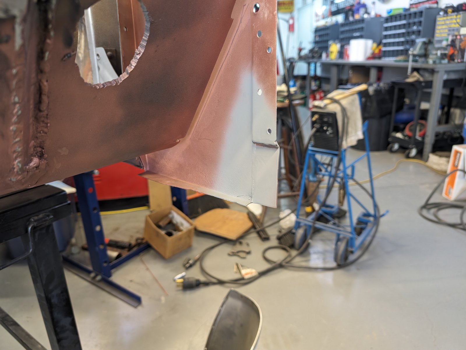

    Alright gang, needing some input. I'm considering how to do the lower cowl area, in particular where it sits over the frame. Since the frame was pre-***embled, I didn't have any input as to how pinched to make it, and the fitment is rather tight between the leading edge of the cowl and the rails:
    Now, the body and frame will be the same color, so I'm not too worried about that aspect, but I would like to have more room to install and fit the body without scratching the frame or if the body shifts while driving I'm not having it banging on the frame.
    So I'm proposing to relieve the body up to the black line as shown here:
    That's ^ the tightest area, and would give far more room to drop the body over the frame without banging into it.
    However, I'm not a fan of the firewall just having a corner missing, so I'm thinking about cutting the lower area on a curve mimicking the upper firewall line, and ending on a straight cut exactly like I need at the leading edge.
    Give me your thoughts, it does mimic that line where the fuel tank upper meets the firewall sides, and does continue the lower body line at the base of A pillar. So wouldn't be too radically departed from the original Ford design, I'm going to push forward with the rest of the firewall in the meantime.

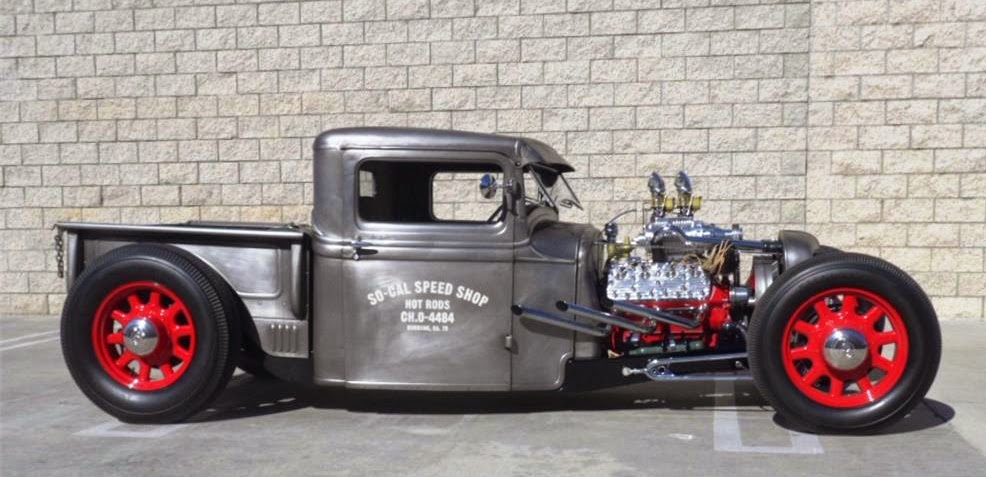

    Edit: Alternative is like Shine did on his 34 Truck:
    ~Peter

  3. wstory
    Joined: Jul 4, 2008
    Posts: 1,984
    wstory
    Hope I can clearly articulate my idea.
    Looking at your first photo, I see an offset between the flange and the body of the cowl of about 3/8 inch. How bout moving that surface (the small rectangle) shown in the second pic "out" to be flush with the cowl surface, making a little "step out" to accommodate frame clearance?
    brEad likes this.

  5. caprockfabshop
    Joined: Dec 5, 2019
    Posts: 698
    caprockfabshop
    I like that idea, though it would only give an 1/8" or so combined, that might be all I need.

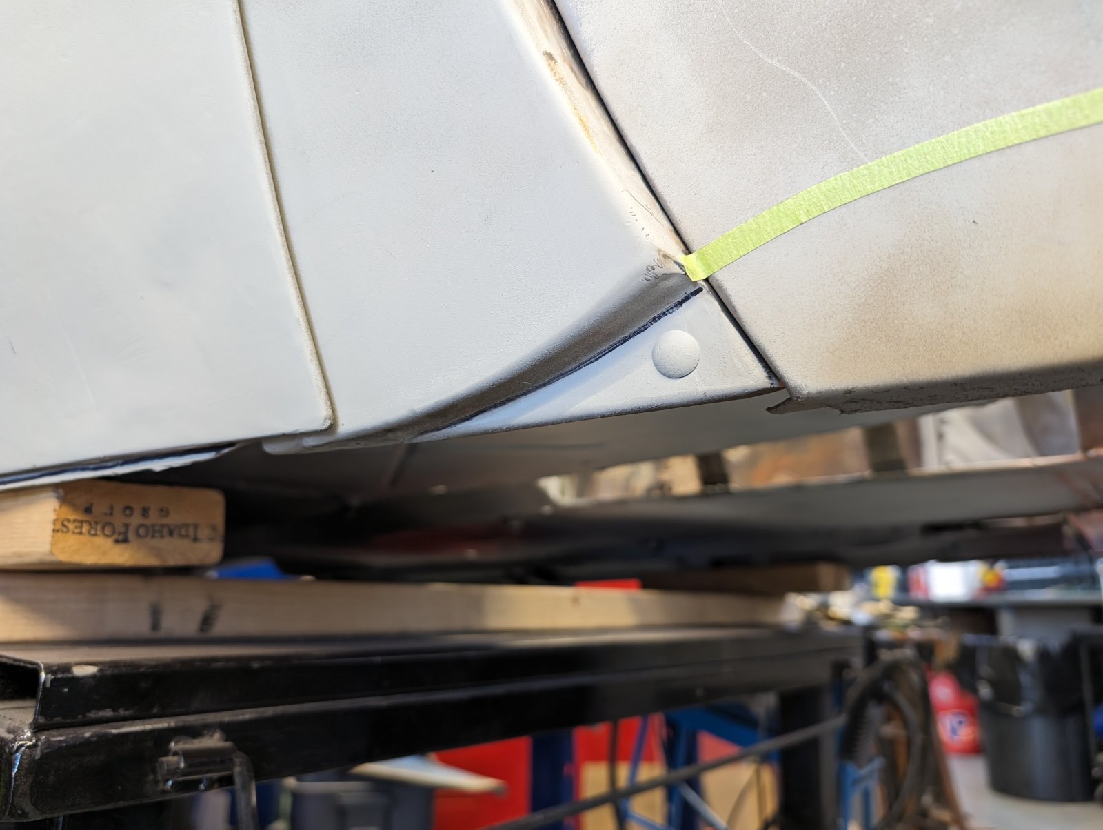

  10. caprockfabshop
    Joined: Dec 5, 2019
    Posts: 698
    caprockfabshop
    You're the man! That solved my troubles without compromising the appearance. Here's with a quick skim coat of filler for the interim, but that's exactly what I needed! PXL_20240527_231006280.jpg
