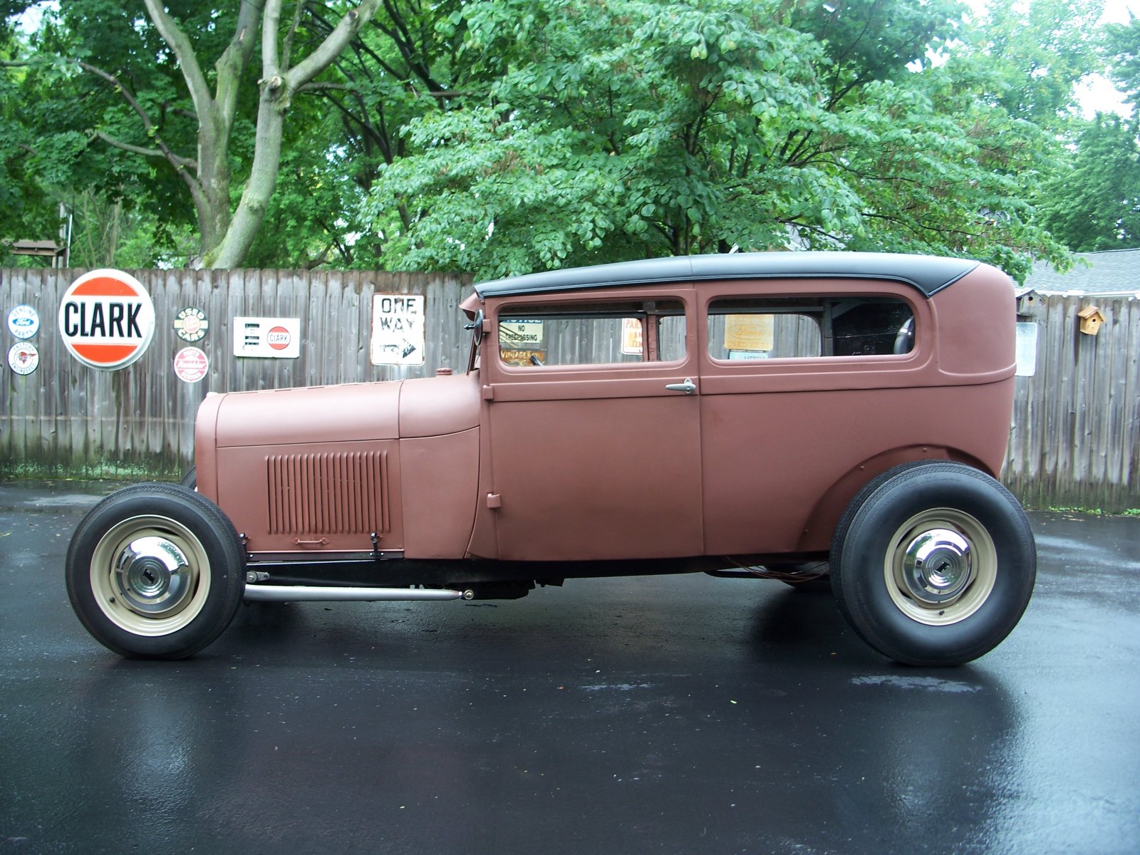

    Sure thing. Right on. You have a good plan. I just dig that teal sedan you posted too.

    Wow, that's a great looking sedan! Is that the 2-8 highboy ch***is? I'm doing the 2-8 with their channel kit. If you have any pics or a build thread, I'd love to see more!

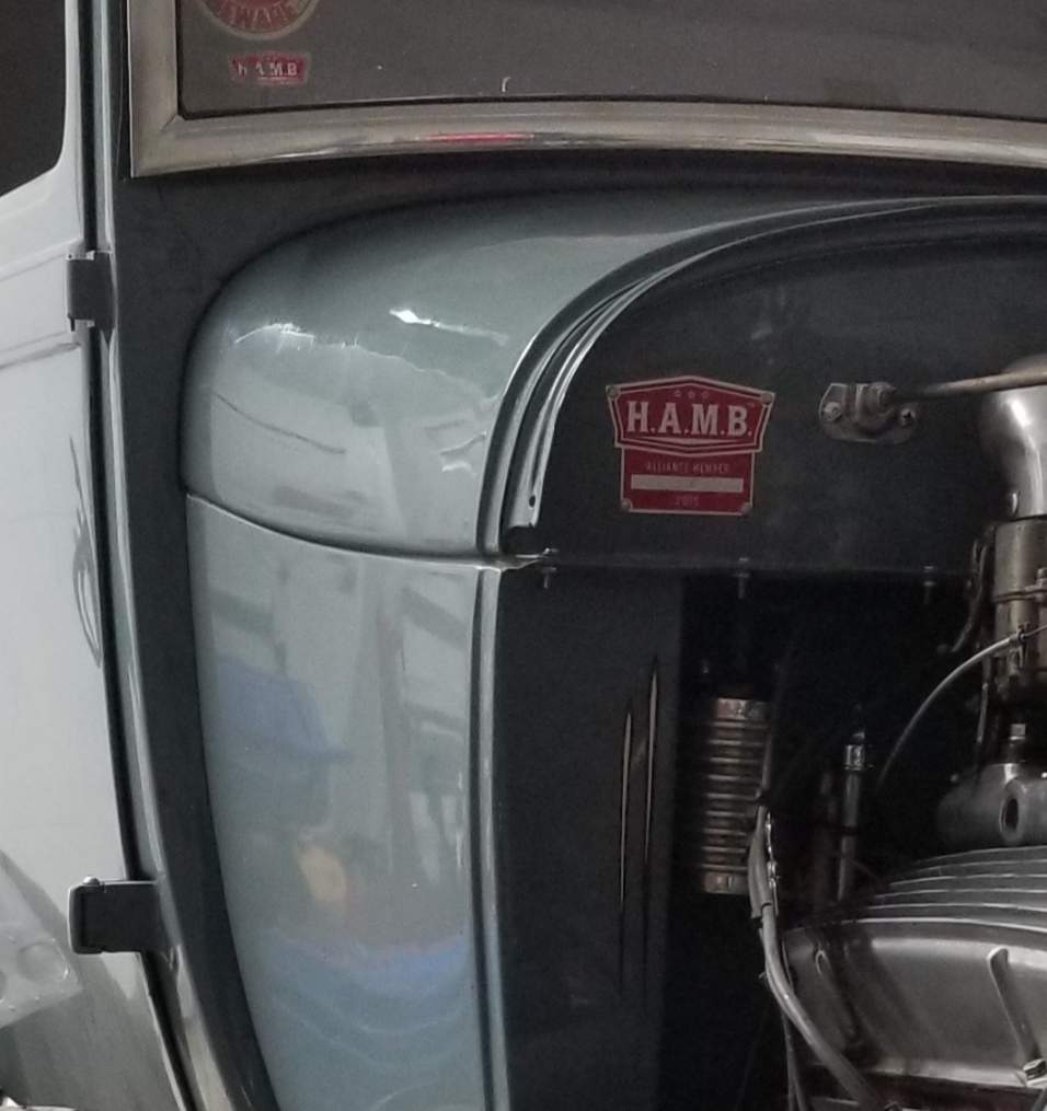

    @caprockfabshop it is admirable that you chose to move the original ch***is on to someone looking for such.
    You may have not had an ownership with the car...but I just want to mention a major vin identification is on the original frame left side under the cowl...so its all good if your going with a new build with new number but I always think of this when I see things being swapped out with something else that was no big deal in the good ole days.
    Look forward to your vision coming together...;)

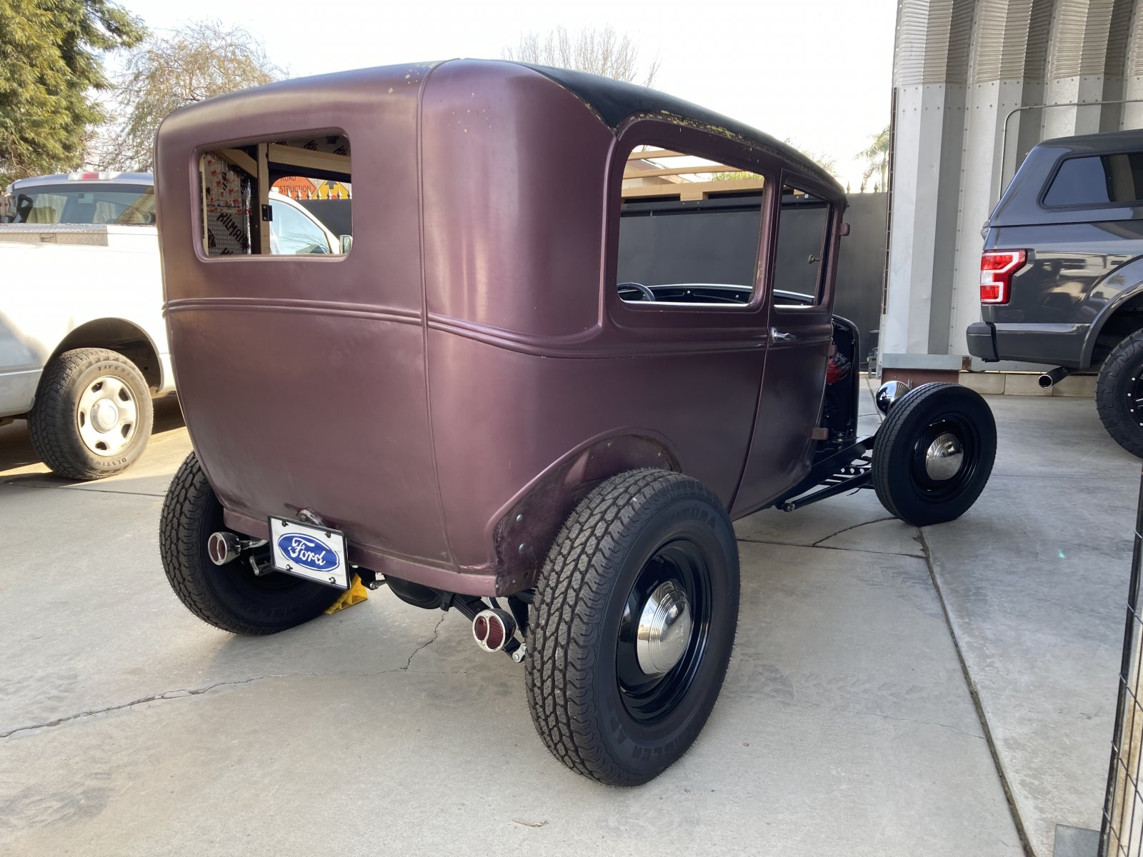

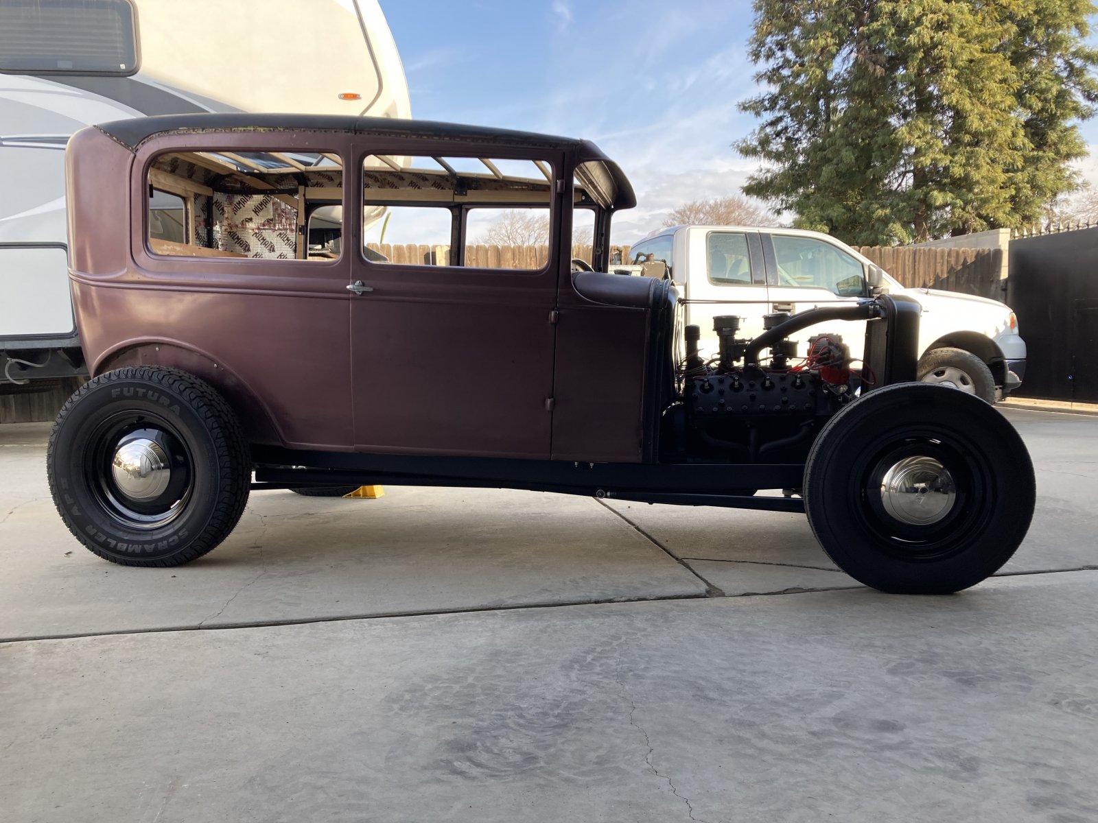

    Got a few presents from Brookville Roadster today!
    Got the smooth 28-29 Cowl Top and Upper Firewall insert clamped in place with practically no fiddling required! Very impressed with the fit and finish. Need to drill all the holes for bolting but I'm tempted to weld it instead. Any input on that?
    Lots of room for gauges and wiring up under the cowl now!
    I also bought one of their 32 Ford style dashes, but I need to make some modifications before it fits the dash the way I want it to.
    With the Visor on it, I like the chop where it's at. 2.5" seems to my eye to work well with the original lines and it'll mean that if I ever want to sell the car down the road (no plans to, but you know how it goes) I can market it to taller gents too.
    Going to work on getting all the welding and body finishing done on the chop next, and then start prepping for getting the car stripped to bare metal for more panel-work and paint prep. Thanks to the great advice on this thread: https://www.jalopyjournal.com/forum/threads/brush-painting-model-a.1271883/ I've decided to brush paint this after applying a primer coat. This whole build is meant to be an homage to the early 50's and that should be a fun experience. :)

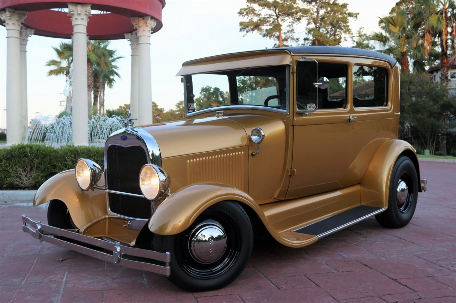

    Agreed keep it honest or a better word would be consistent to the rest of the build...a filled cowl is something that was done but it was followed by other things filled such as the wheelwells...
    That copper colored A is a pretty nice build...I think removing the cowl lights and windwings might have complimented the look but not mine...did they make gl*** 29 Tudors?
    The second one is a Hambers, is it @s**** metal 48's...I think...

    Yeah, Spirit does. Though the picture shows a 30-31ish cowl.

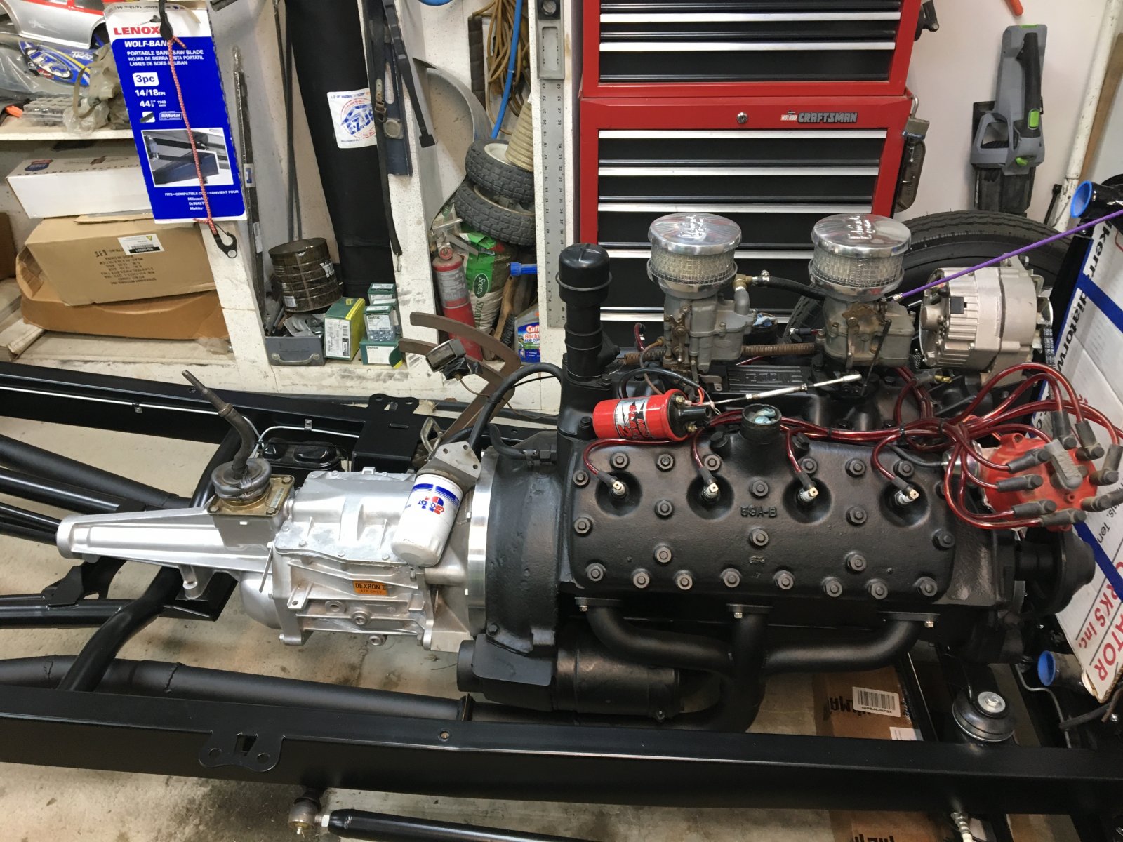

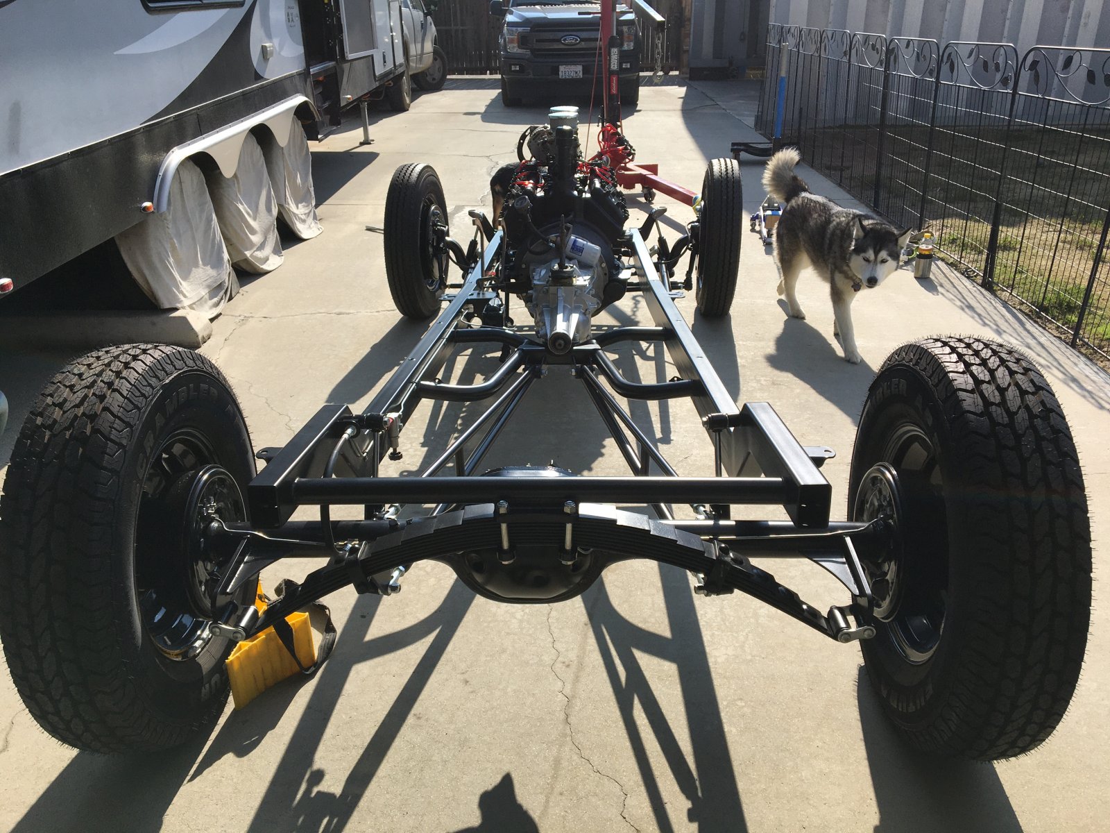

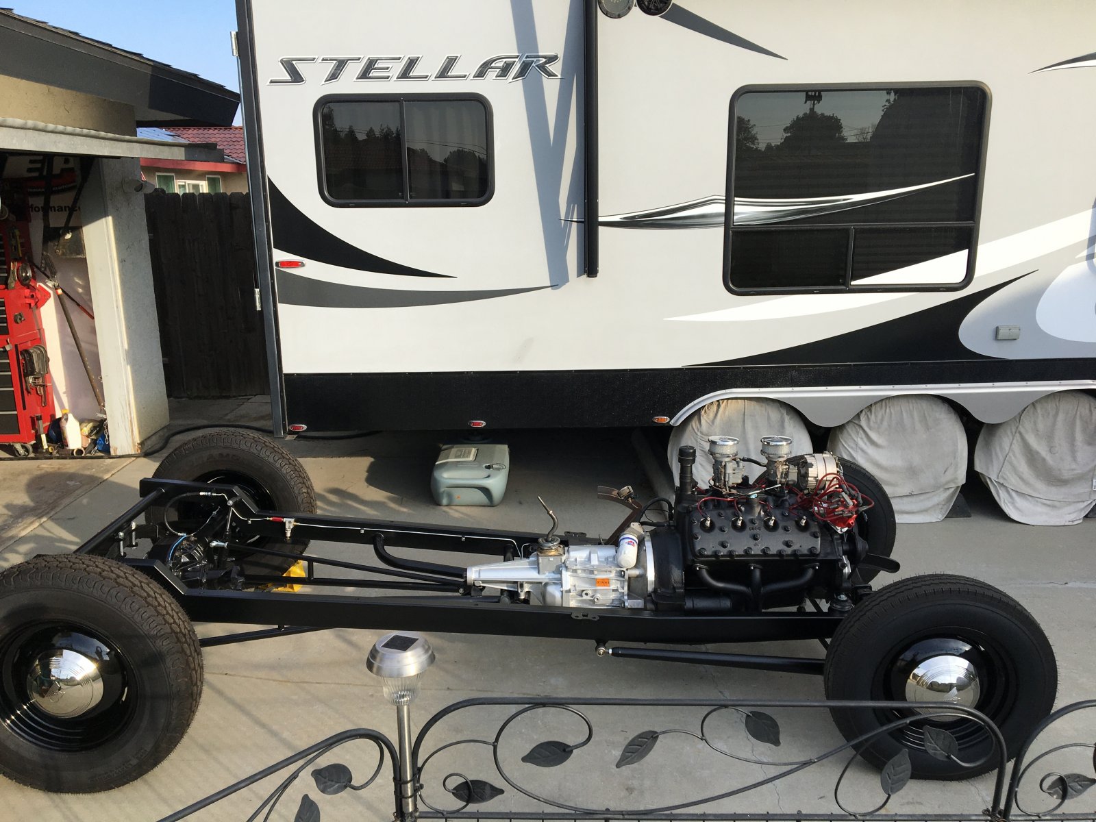

    Picked up the best candidate for rear axle today from Poco here on the HAMB.
    Jan 11, 1957 casting date Chevrolet 8.2" 10-bolt - Came out of his 1939/40 Ford Tudor street rod. So it has a little hot rod background already. ;)
    A little newer than I was looking for, but the right width, good looking center section visually, and very easy to get parts for.
    These things can easily handle 350+ hp, so no matter what this model A ends up with, the rear axle is good to go. I'll tear it down and do a full rebuild in addition to stripping it and installing the ladderbar and transverse leaf mounts.
    In other news, Boling Bros called today to inform me that my ch***is is already done and ready for pickup! I was pleasantly surprised since the initial 6-8 week build time was more than reasonable for something custom built to my specs, but they came through big time!
    So there will be a little Lindsay, CA roadtrip next week, should be a good time!
    Got my Flathead engine stand mount so I can teardown the '40 Flathead and send it to the machine shop for testing. Busy days!
