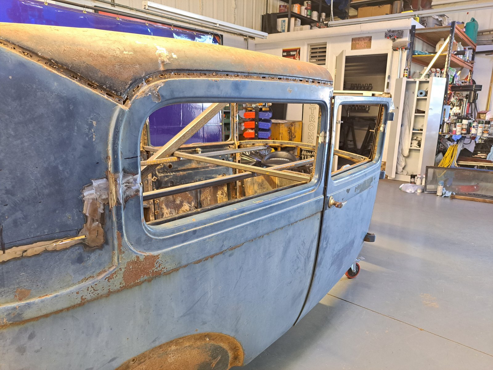

    Got most of the cutting and grinding finished on the A and B pillars. Was a big chore to get all my door gaps and body lines where I wanted them. Ended up "squishing" the roof together .25" on the front A pillars and .125" at the B pillars. This allowed me to get a nice arching door to body gap. Shortened and welded the windshield header bar in place.
    Much more finishing work needed on the chop lines, but very happy with the progress so far.

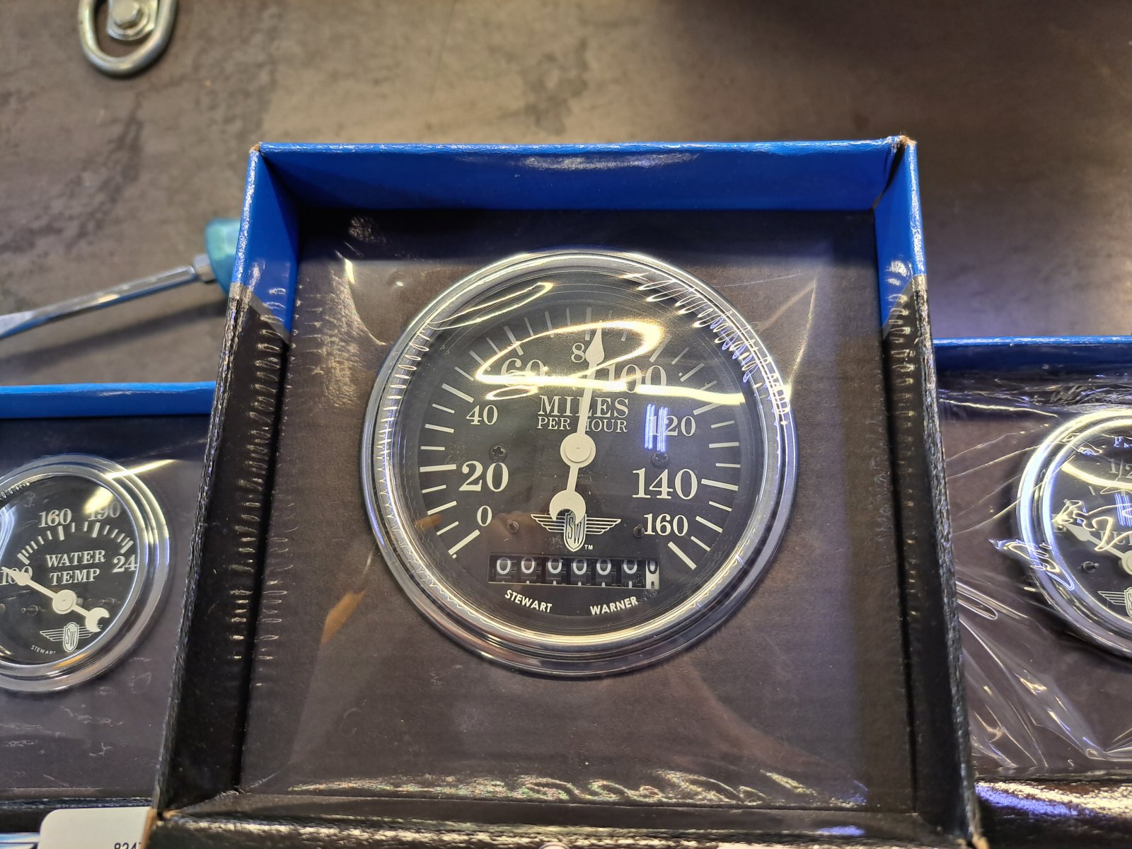

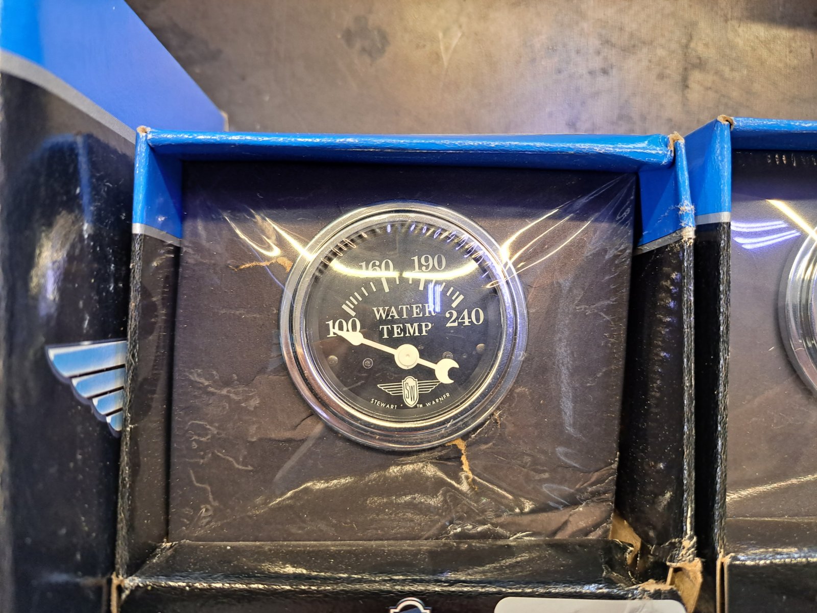

    Ever since I was a kid, I've loved hot rods with gauges across the entire dash. Like this one:
    Decided to go with the Stewart Warner Wings series. I wanted to do Green-lines, but they're too 60's in my opinion. I see mixed reviews on the Stewart Warner products nowadays, but I'm willing to give it a shot.
    I'll probably space them out a little more than the initial drawing, try and fill as much dash as possible.
    5 auxiliary gauges because I'm going to run a water sending unit from each head of the Flathead. But the dash will have to wait until after the body is on the Boling Bros ch***is, since my cross braces are welded to the lower windshield rail.

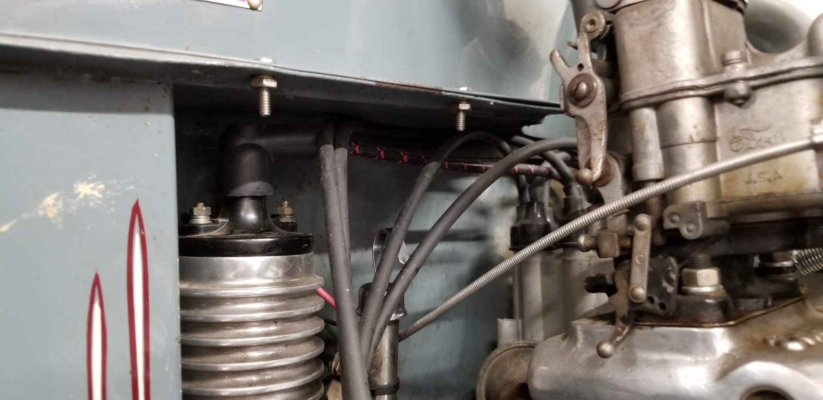

  6. Stogy
    Joined: Feb 10, 2007
    Posts: 27,523
    Stogy

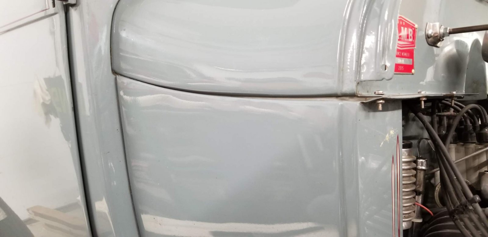

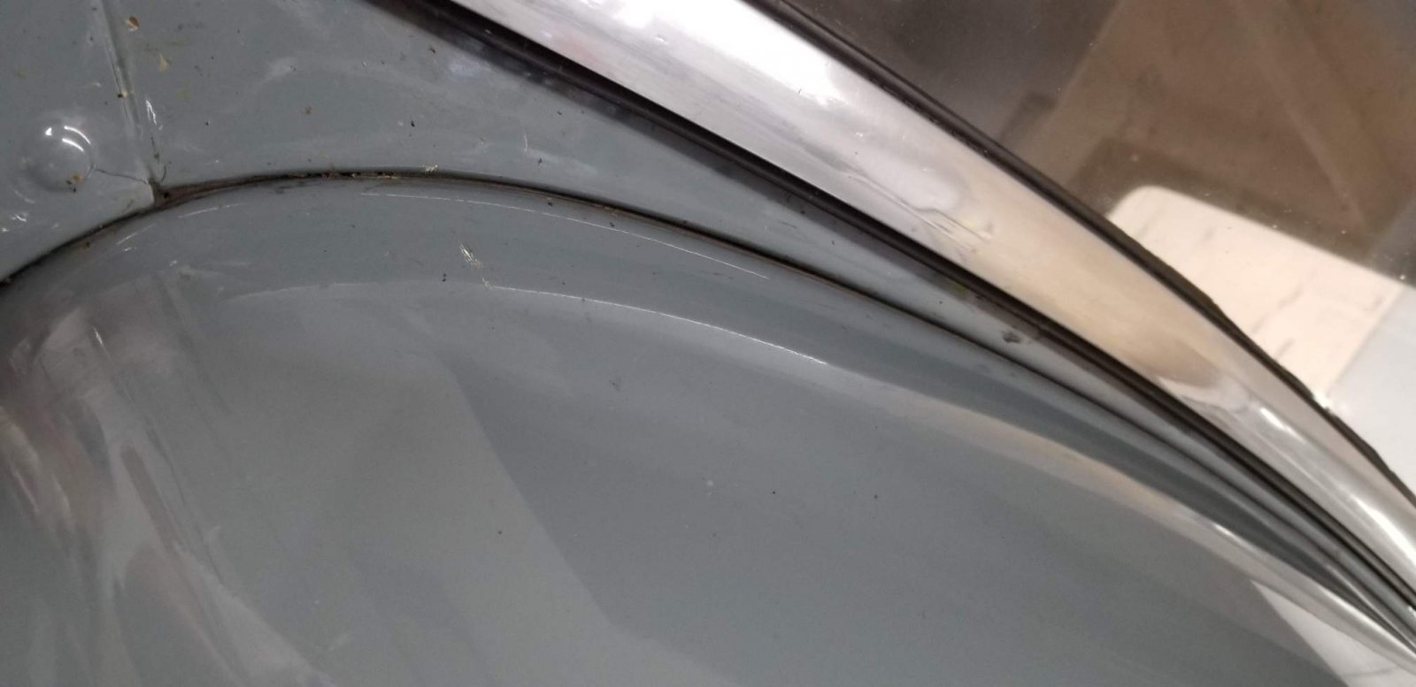

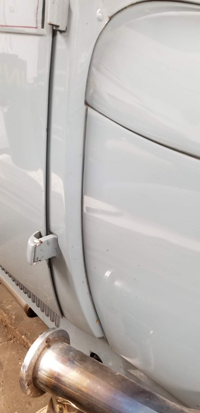

    dynaflex-230-premium-elastomeric-sealant-gray-300-ml-000abb0c-e29f-4483-8481-b659e868d62c.jpeg
    :rolleyes:...Again I am well aware 29 cowls and tanks and other related seams were smoothed in Hotrod...but I had open season on fumes and didn't want to tear apart the whole cowl for gaskets or fill them flush so I caulked most gaps and wiped away with a damp paper towel...you can't really see it as its hidden in shadow but the lines are as Henry made them...just sealed...cheaply
    I hope these help...I even see I missed some...My ride is a work in progress but every little detail helps pacify the monster within...
    The second pic shows some spot like welds or tacks to the original tank with the lower flange bolted...I should find a more period bolt for those...Model A's had a lot of 1/4" slots with square nuts...
    Maybe chrome ones as the engine area is a focal point for that shiny...it makes it faster don't you know...:p
    At a minimum I should straighten the crooked one...:)

    Pete, are you going to separate the cowl side panels to the pillar to remove the old gasket...I guess its gasketed, sealed or filled...I just ran with what I got and took easy street really with the caulk...
    You are at a stage where obviously you have more options...

    Yeah, plan is to replace the gasket with something that mimics the original. Definitely planning on making the upper cowl bolt on. Once I get the metalwork done I plan on getting the body either acid dipped or media blasted. Lots of old filler and paint that will be a nightmare to strip off otherwise. Not doing full bodywork and paint, just down to bare metal and then a basic prime and color coat. Not set on color yet, I have time for that.
    Thanks for the pics above, very helpful!

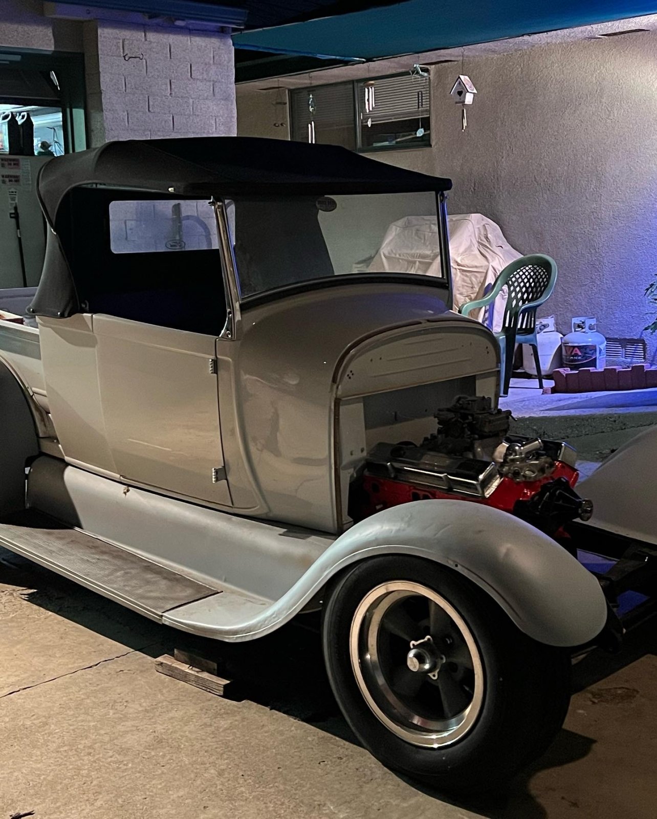

    8DEE5B57-0236-4095-9CD5-A4FD728A435D.jpeg B0B69598-4C26-4C78-84A7-14A8F3BD34A4.jpeg This is a steel RPU that I’m building for a buddy of mine. I sourced every part on this hot rod. Lots from my own stash. Yup the cowl is filled much like the WASKE Effect 29 roadster that’s no more than 10 feet behind it here.

    I'm aiming for a 1955-57 Era build.

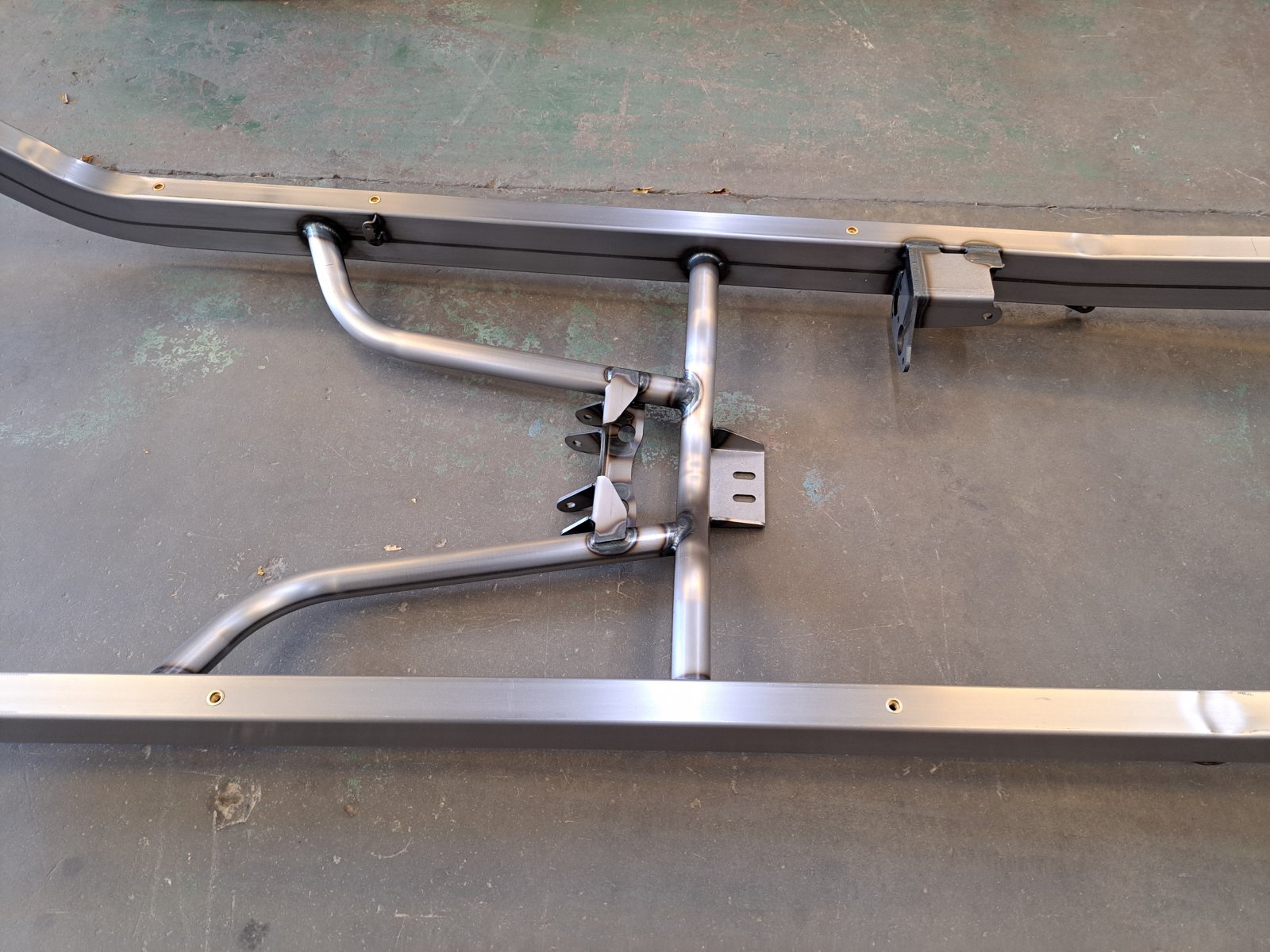

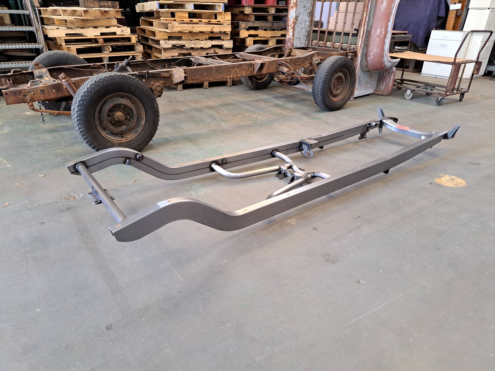

  21. caprockfabshop
    Joined: Dec 5, 2019
    Posts: 708
    caprockfabshop

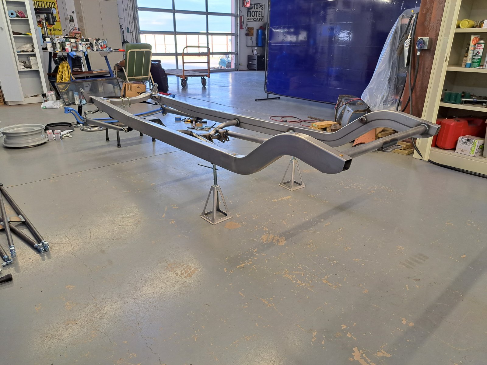

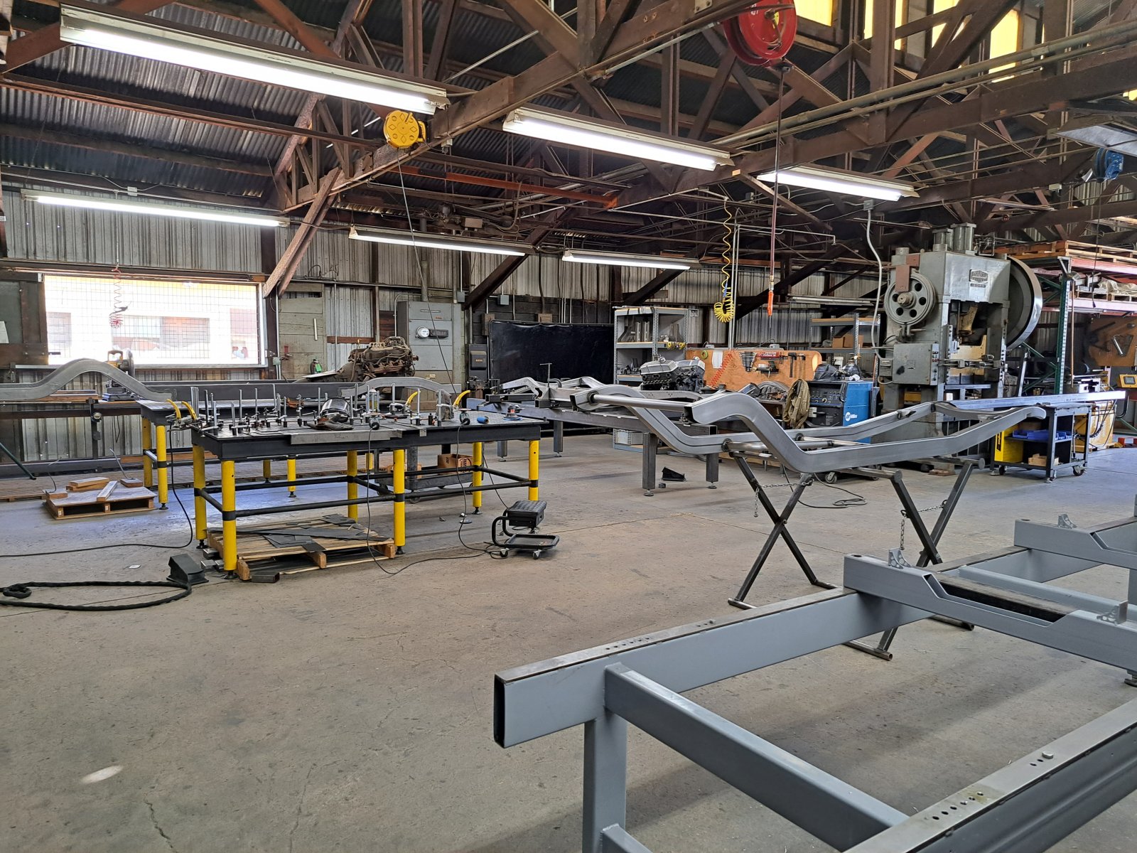

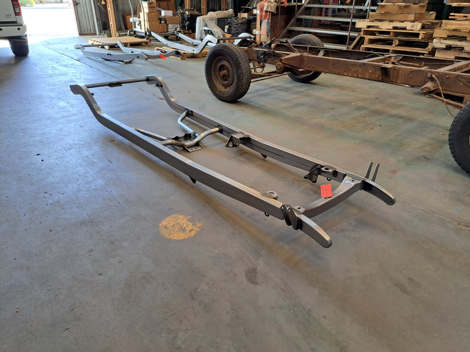

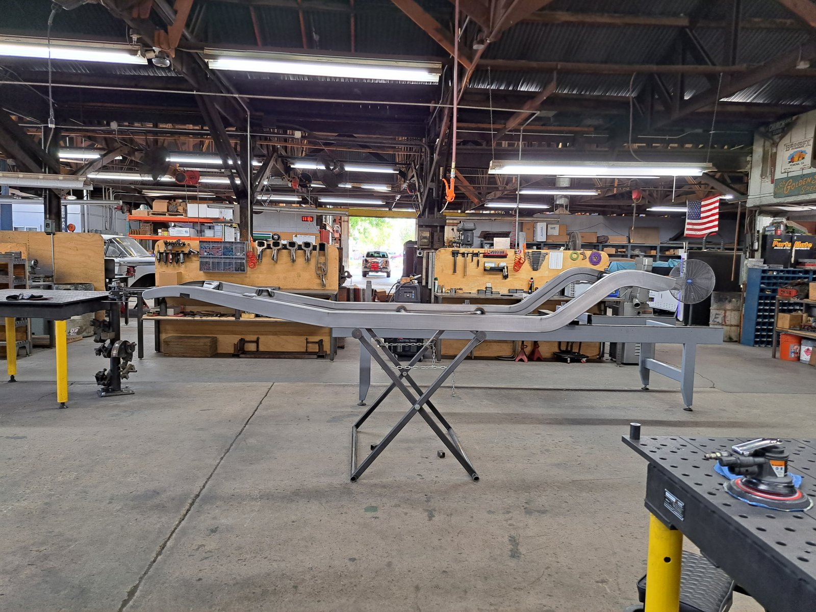

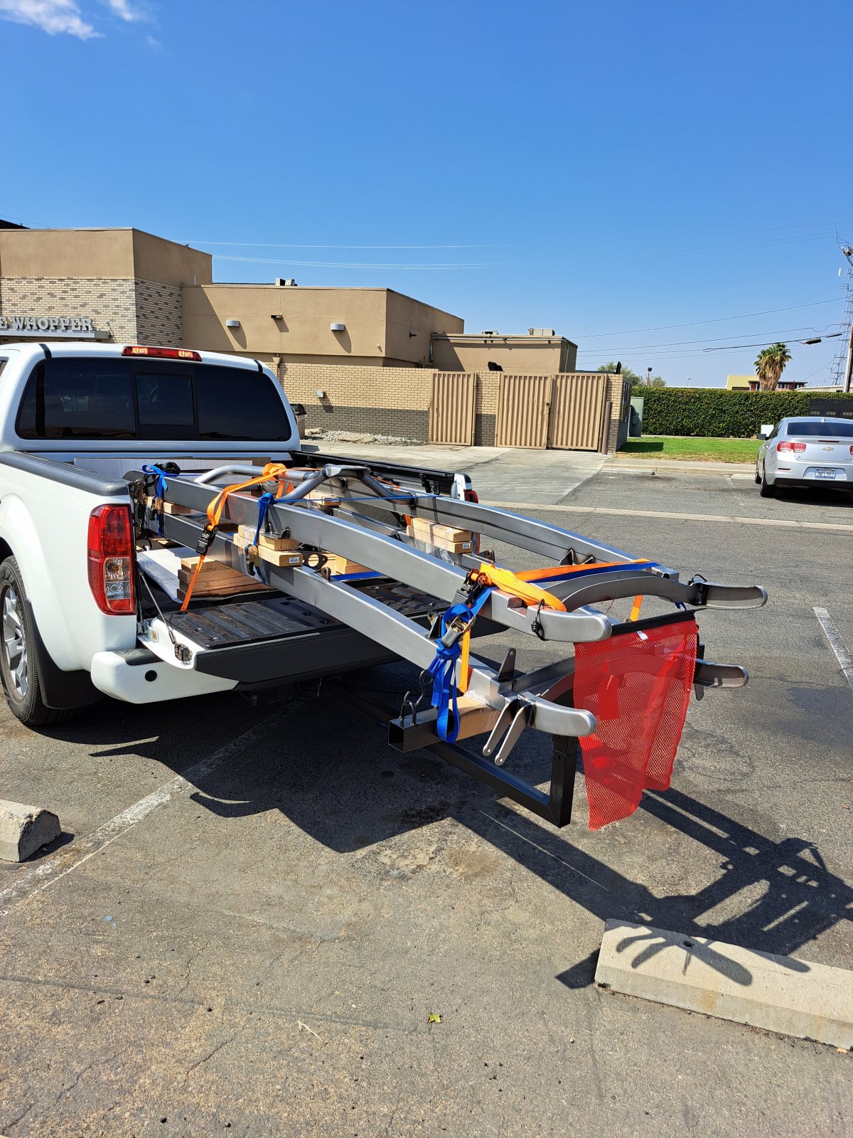

    Trip went great, three 14hr days of driving roundtrip, 2500 miles in total; but it saved me a lot of expense vs shipping and it arrived safely.

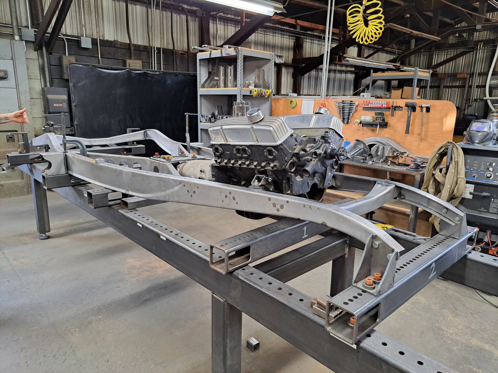

    Top frame is a standard Highboy Perimeter I delivered for a guy in Amarillo. He helped cover some of the travel expenses. The weight of both frames is supported by the wood blocks in the bed, the hitch support is just there to add ***istance and keep the bears off my back. :D
    Build quality is outstanding. Definitely a cleaner and straighter frame than I could've made. Took a bunch of pics of their operation. Very impressive setup. I'll post a few here, but I'm tempted to post a full gallery and review somewhere here on the site for all members to see. Definitely getting my full endor*****t.
    Here's a special preview of their next release:
    They will soon be offering 32 Ford frames as well as the existing ones for Ts & As. They source the outer rails, and then install their own X member and crossmembers. The rear kickup has proprietary step box inserts to add strength but keep the stock looking inner rails. 20220908_112010.jpg
    One of their 5-12 frames, a little too much sweep for a traditional rod, but certainly gets the car low without sacrificing suspension travel. Mine is only a 2-8 in comparison.
    I'll probably do some initial parts layout and mockup here in the next few days, but I want to get some more of the chop finished before I get distracted by the rolling ch***is.
    ~Peter

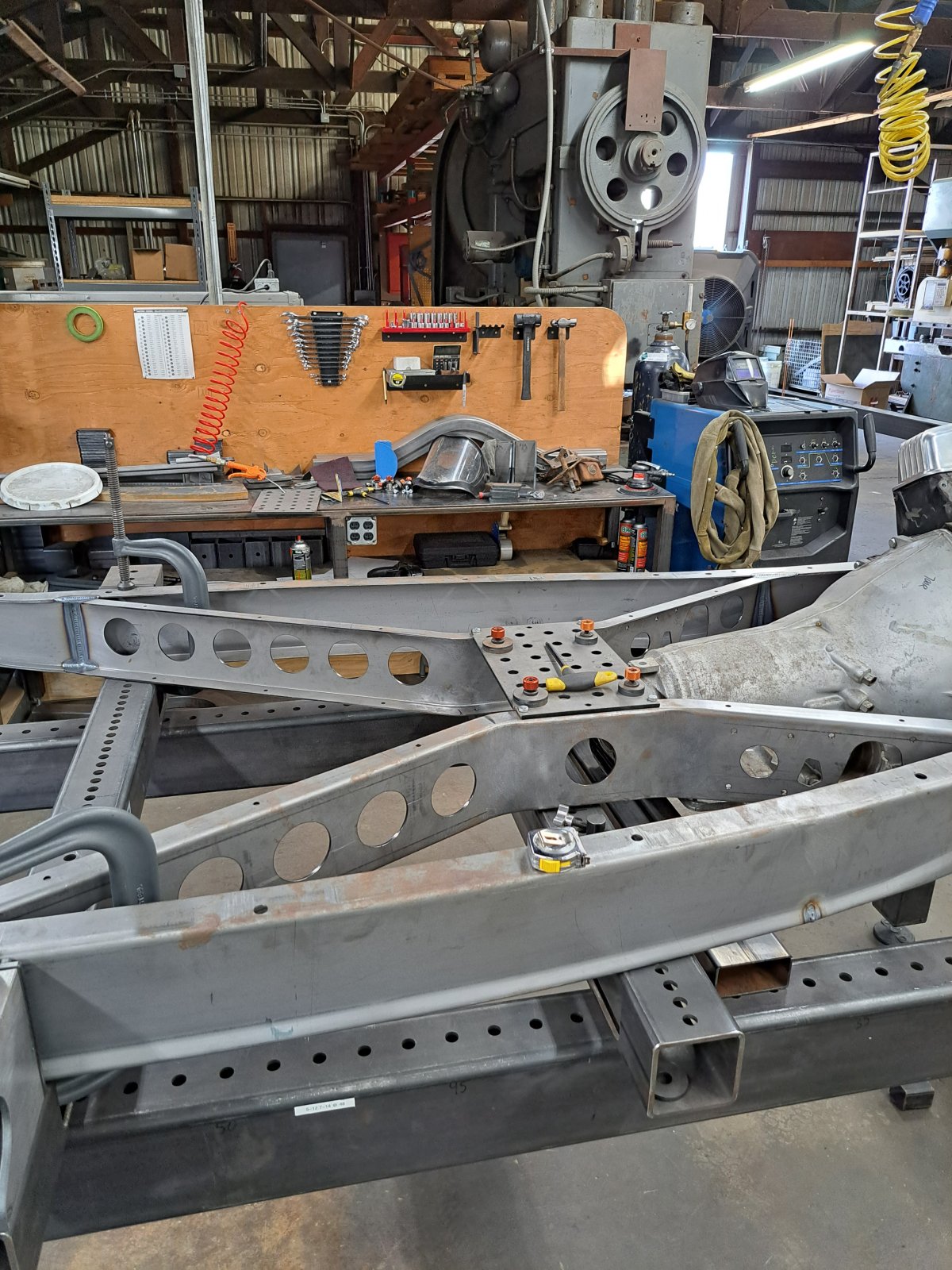

    Welded up some more of the chop, trying to get everything structurally sound enough to cut the floor out and install on the new Ch***is.
    ^The rear curve isn't done yet, just the C Pillar.
    Got everything in the back symmetrical and welded. Going to do the hardest part next, the back curved corners. That's going to take some creative slices to get it all rounded and flowing.

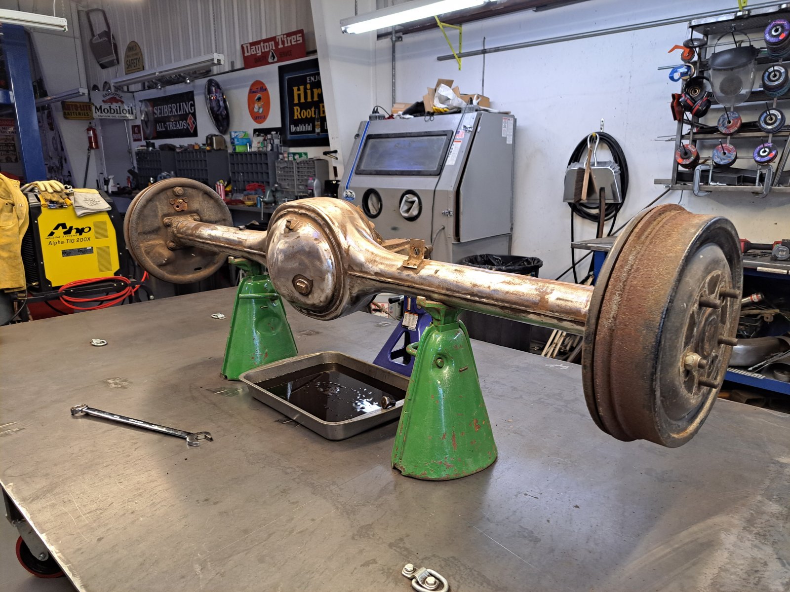

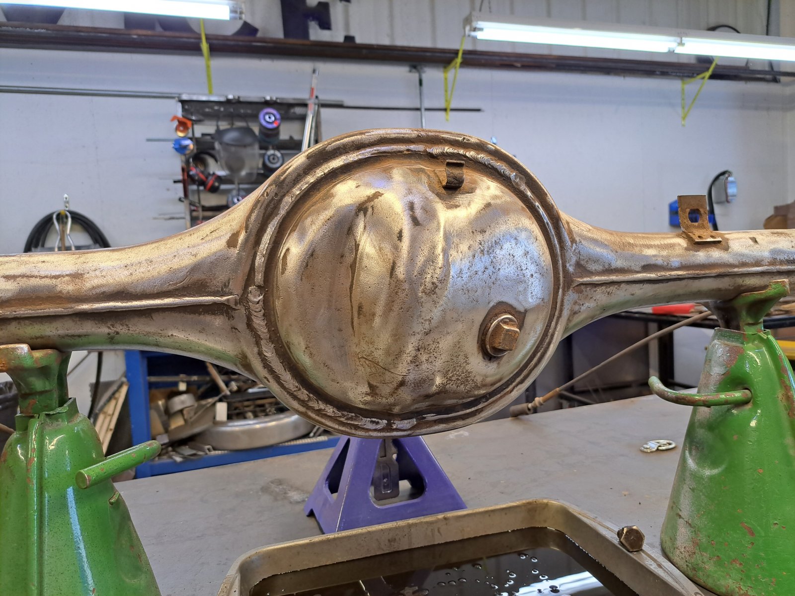

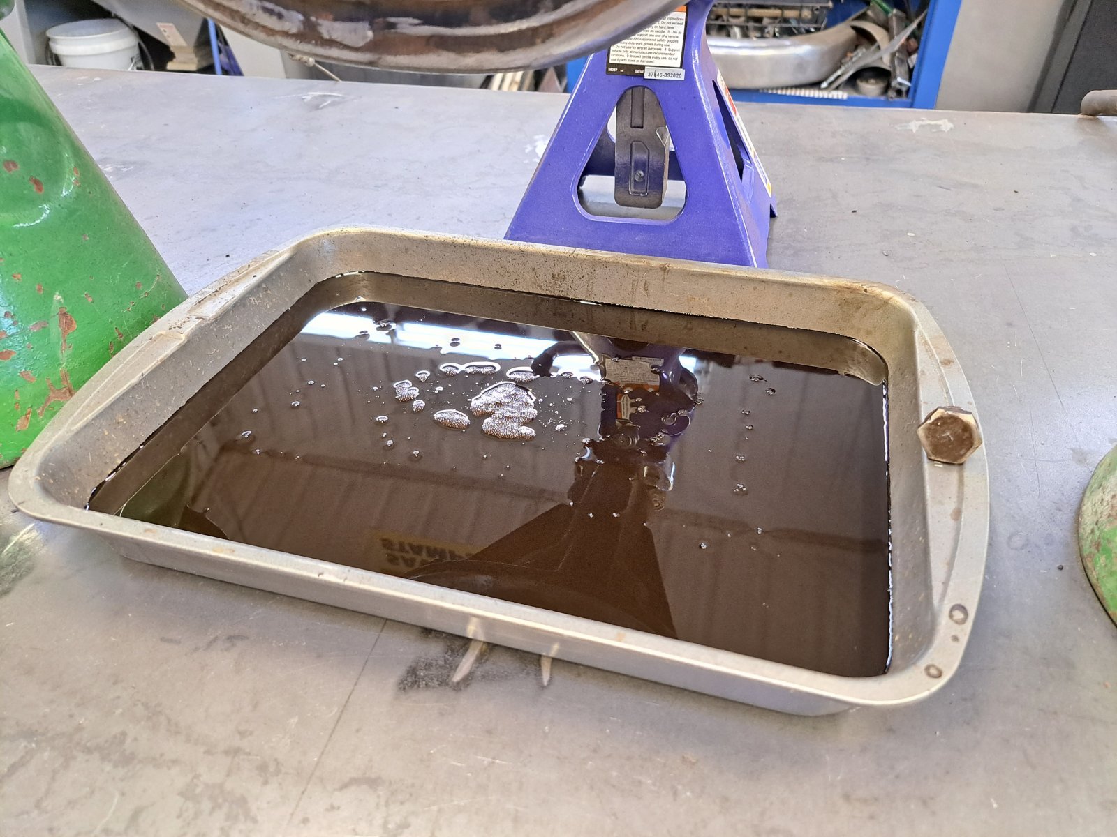

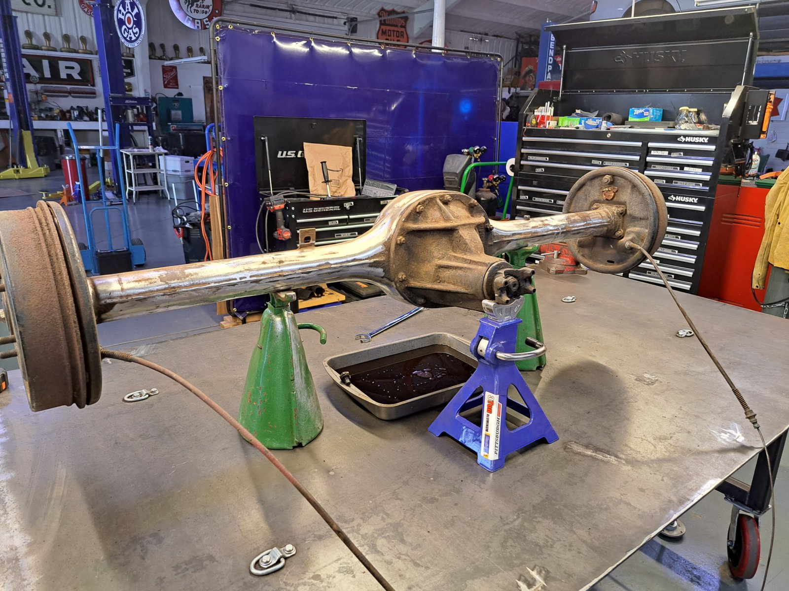

    Since my Ch***is is complete sans rear axle, I brought in the 1957 Chevrolet 8.2" I got in Tulsa last week, and got all the old leaf spring and traction bar brackets removed. Then I smoothed and scoured the rest of the housing.
    20220911_173944.jpg 20220911_173949.jpg 20220911_173953.jpg 20220911_173957.jpg
    Was totally full of fluid, no metal shavings and no signs of water! Great indication of health, but I'll still fully recondition the differential once the car is blown apart for final paint and ***embly.
    Determined the rear axle ratio to be 3.36=1 which is perfect in combination with my .83 T5 transmission and the 30" diameter tires. Highway speeds should be between 2100-2450rpm.

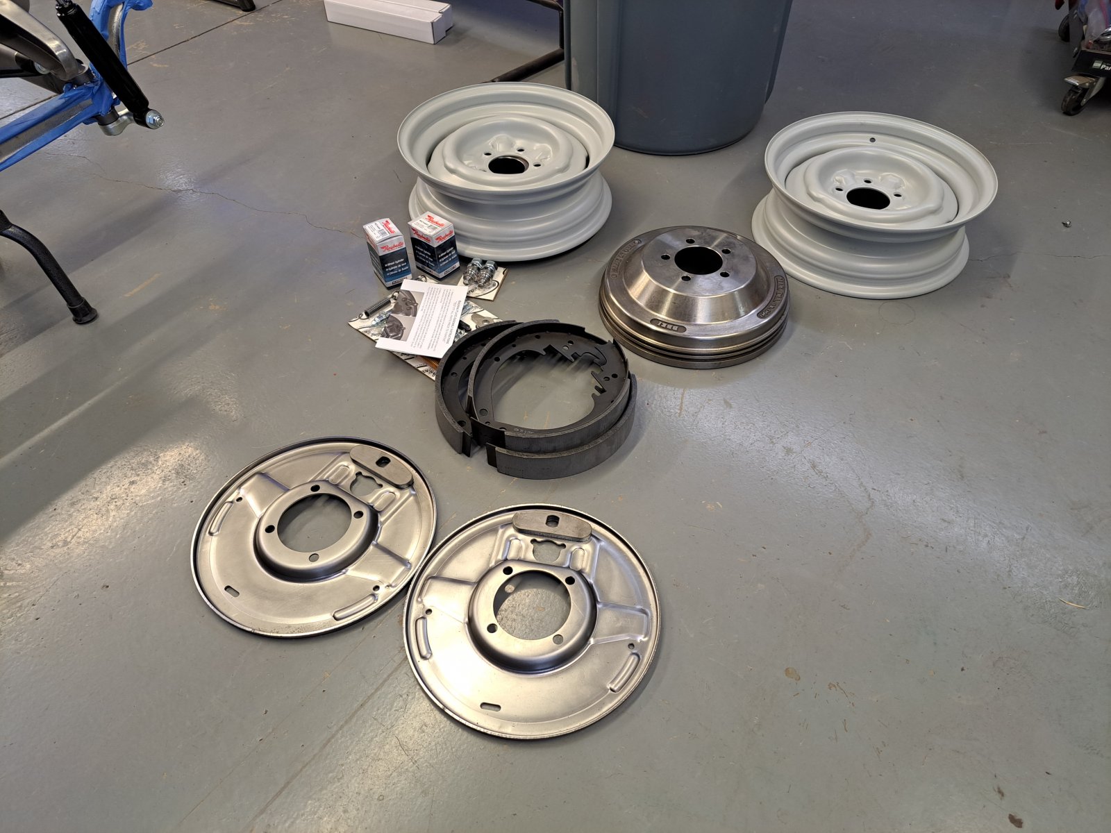

    Gonna tear down the rear brakes to get those cables unhooked and so the drums turn more easily. Then it's time to bring in the new Ch***is and start getting things ***embled and onto the next step.

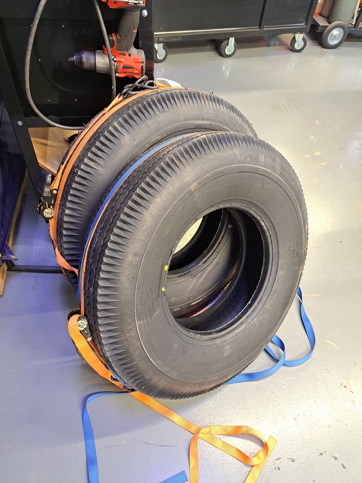

    Decided to go with blackwalls, so I got my 15" rims ordered as well as some 820-15 Firestones for the rear. I was inspired by how well they looked on @joeybsyc 's 32.
    I happen to have 6.70-15 Firestones for the front that were from a previous restoration, so saving a little money there. No idea if I'm going to run dog dish or full caps at this time. Nor is paint color for the rims decided.

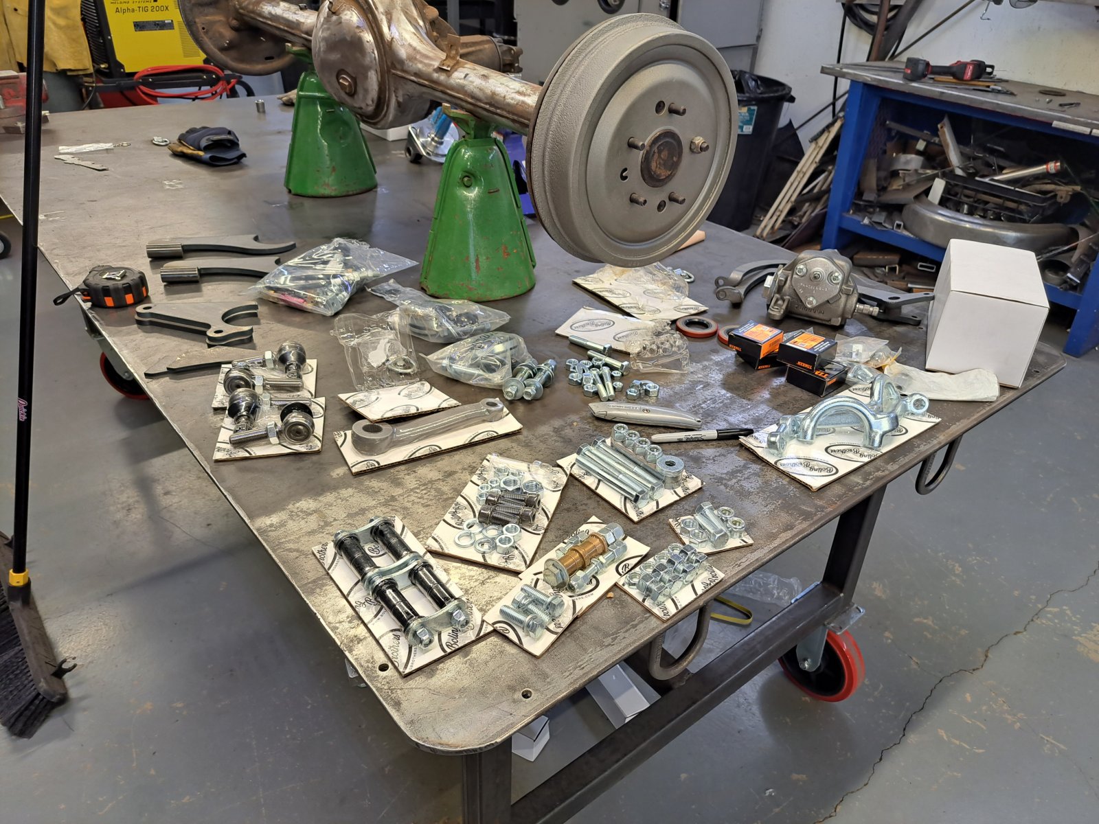

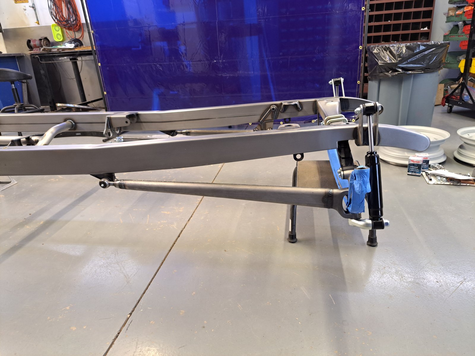

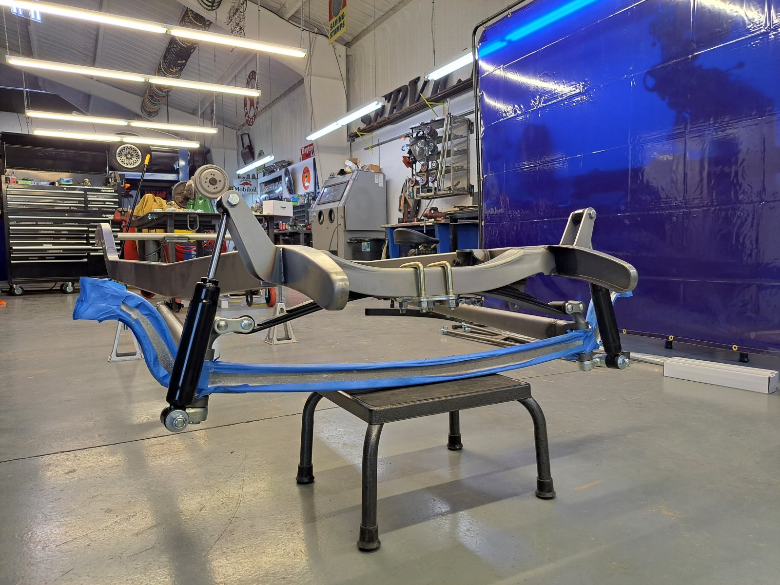

    Started on frame ***embly today. I'm using an older Chrome drop axle that I bought at the Pate Swap Meet 10yrs ago, not sure on what brand but it looks like the first ones Speedway started selling.
    Got all the boxes unpacked, and I'm very happy with the quality thus far. Here's their front Brake Kit:
    Keen eyes will spot my new front wheels, they're 15x4 Wheel Vintiques. Going to run 15x6 in the rear.
    Lots of parts:

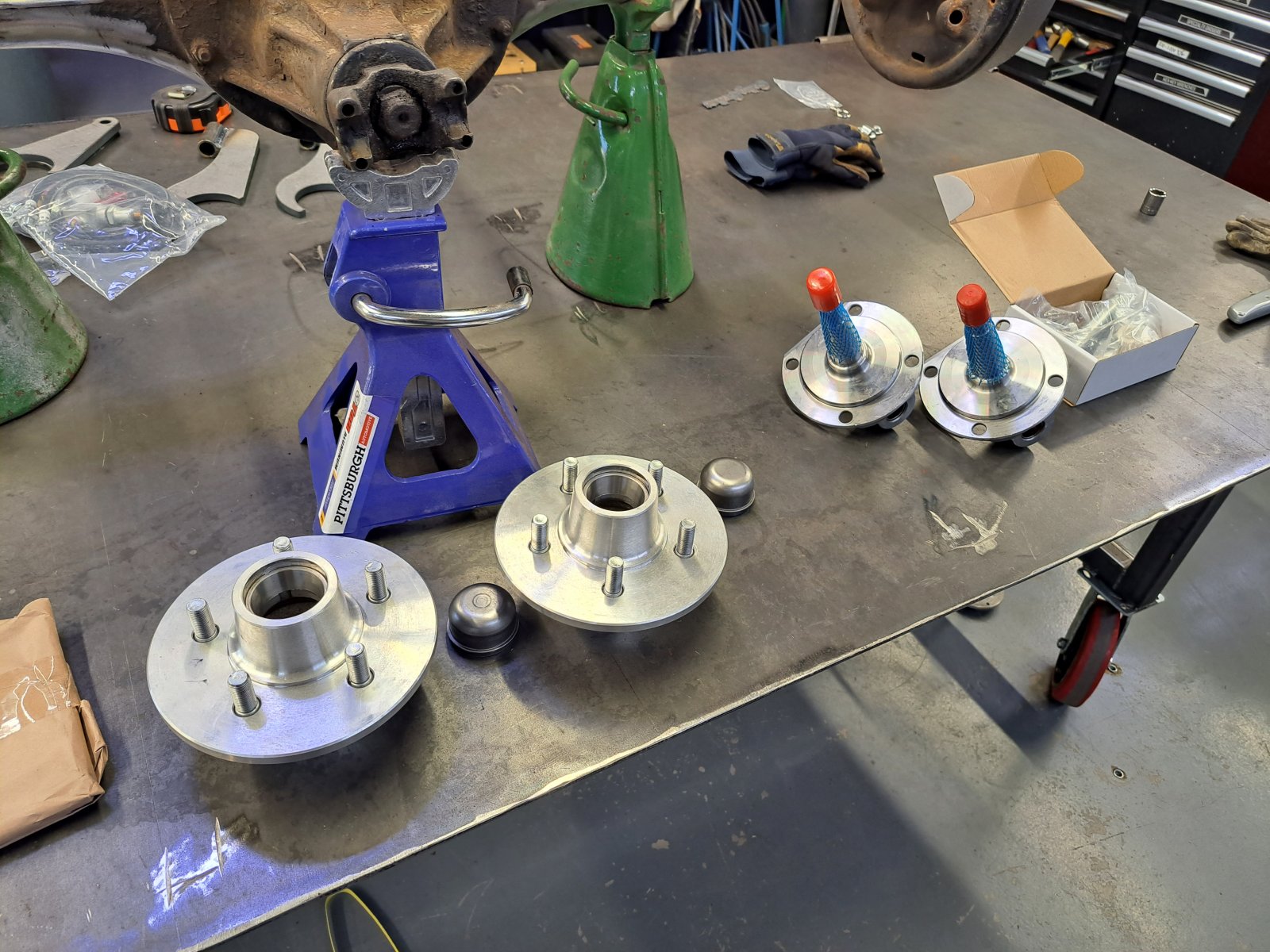

    Don't have the frame totally mocked up yet, waiting on getting the rear axle ***embly welded to the brackets and installed, probably tomorrow.
    Custom hubs in the front with 5x4.5" bolt pattern. I figured this was a smart route that way if I want to change the look of the wheel and tire combo it'll be 4.5" front and 4.75" rear which are both commonly found on identical wheels. Why didn't I go 4.75" all the way around? When I ordered the frame I didn't have a rear end picked out yet, so I just chose the bolt pattern I'm most familiar with.
    ~Peter

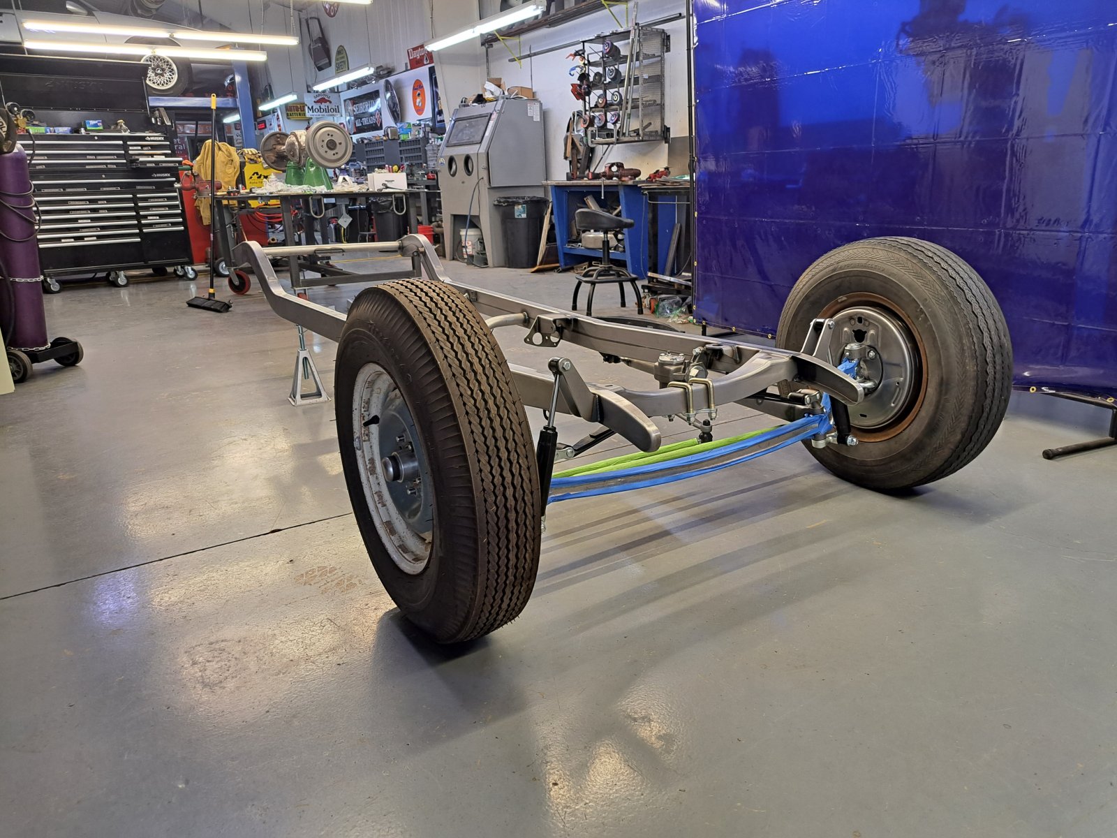

  26. caprockfabshop
    Joined: Dec 5, 2019
    Posts: 708
    caprockfabshop

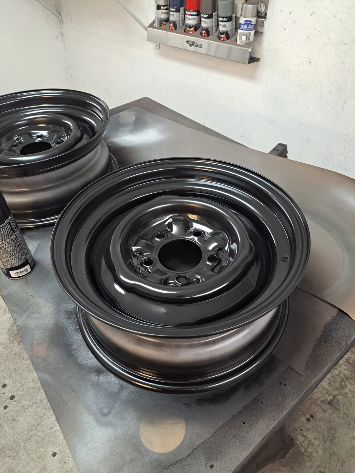

    Oh yeah, also got my back tires and rims today. Got the rims in a Henry approved coat of Black and getting the tires unsquished before I drop them off at my tire shop to hopefully get them mounted tomorrow.
    I can always repaint the rims another color, even with the tires mounted, but I hate working around primed surfaces in the meantime, oils get trapped on the factory grey primer surface and make it a h***le to prep for final paint anyways.
    ~Peter
    Hombre, Outback, 1biggeorge and 9 others like this.

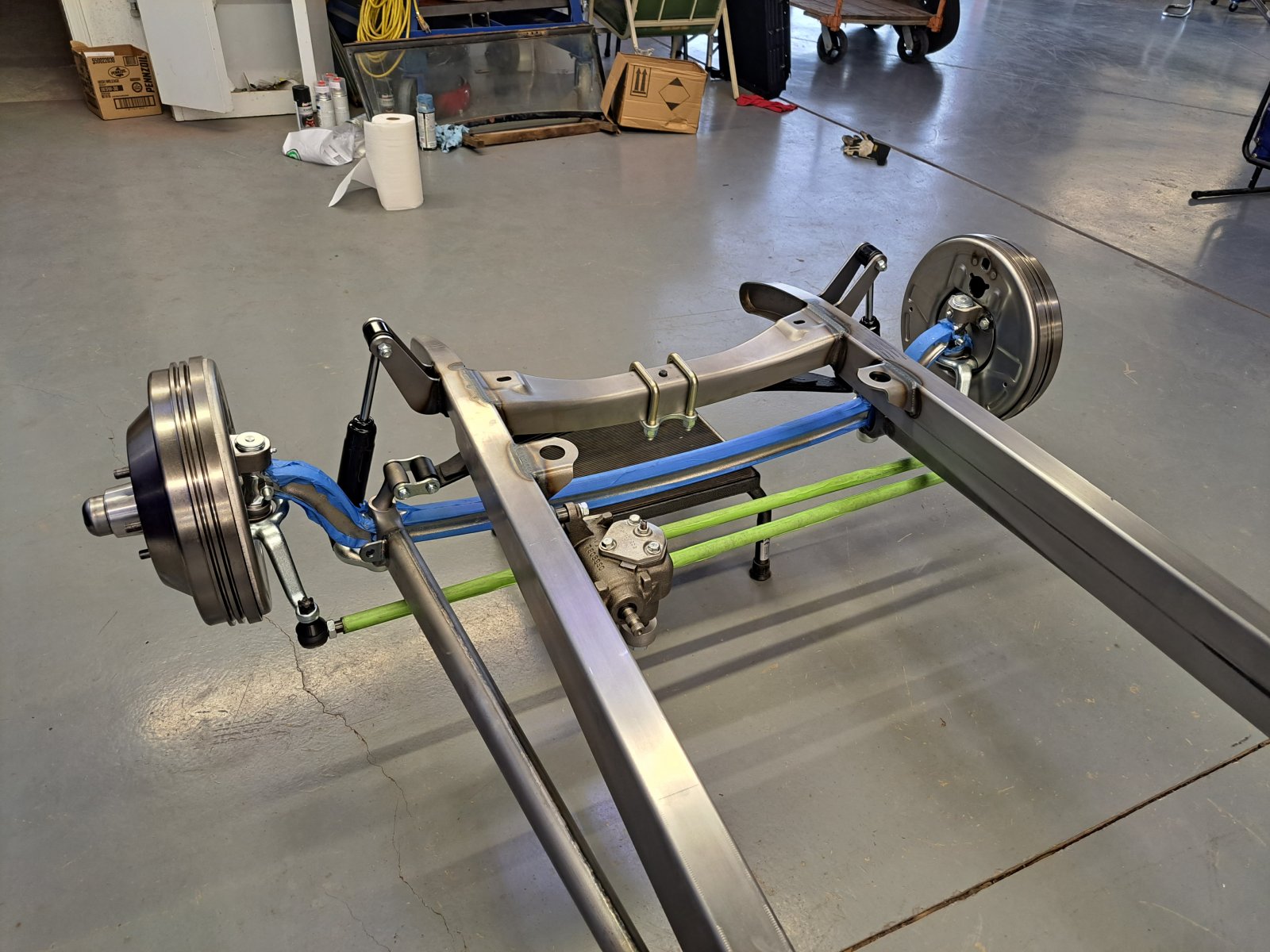

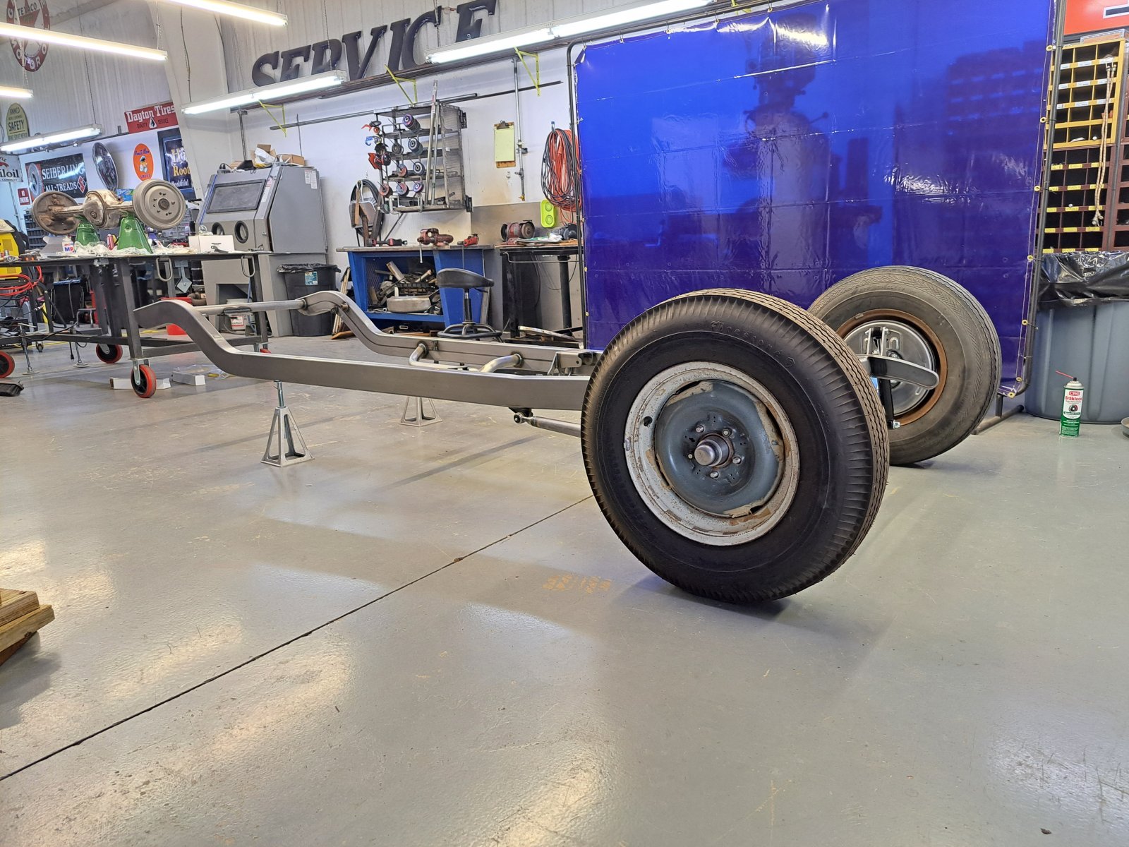

  27. caprockfabshop
    Joined: Dec 5, 2019
    Posts: 708
    caprockfabshop

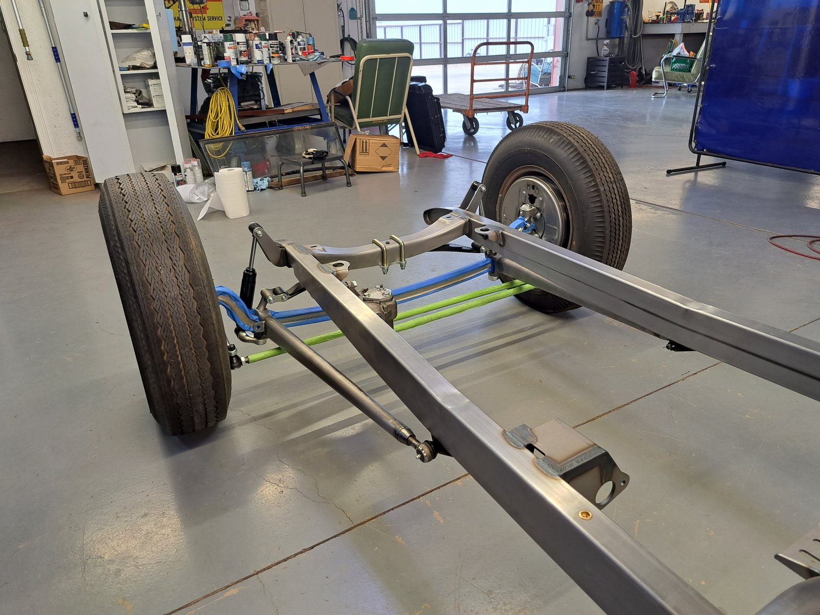

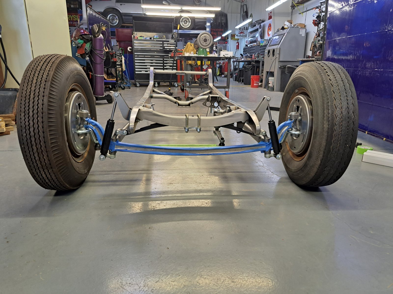

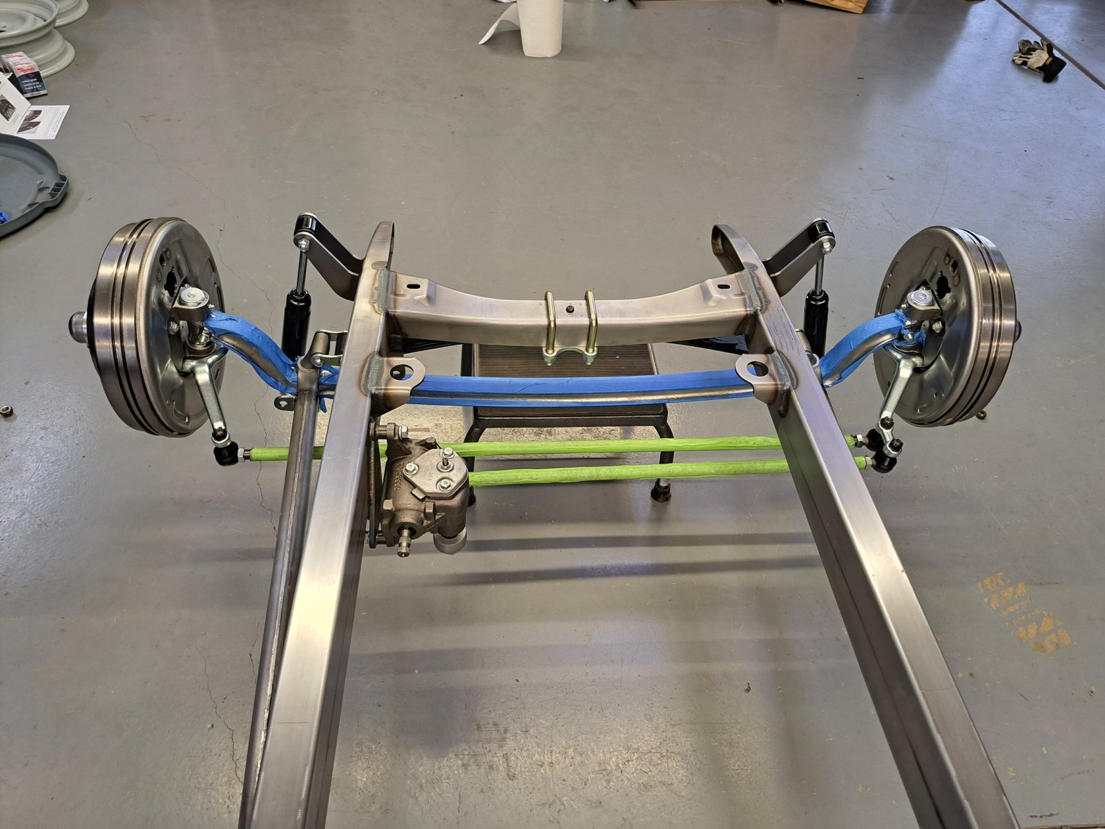

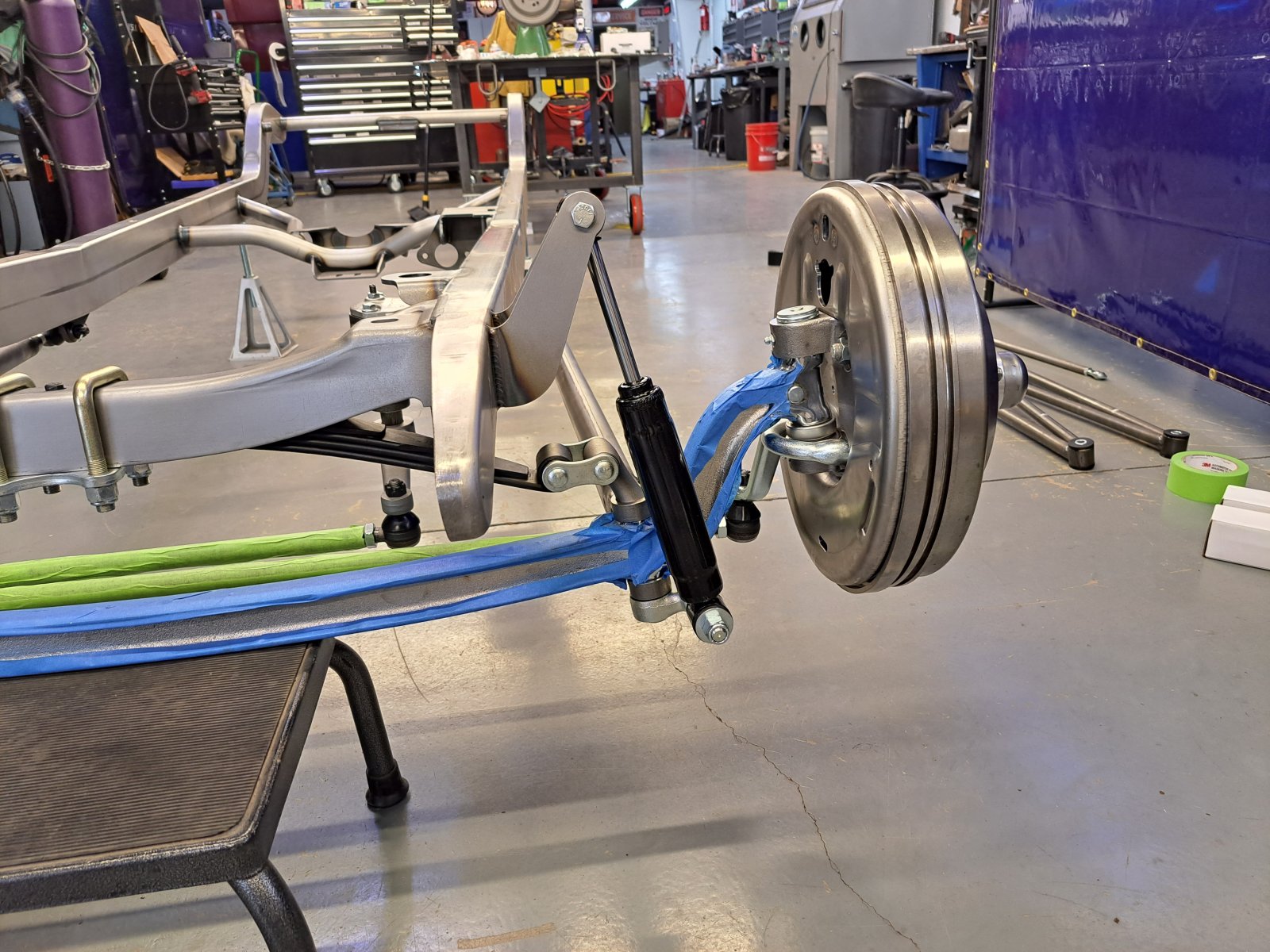

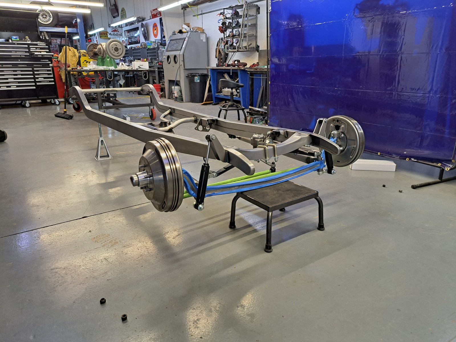

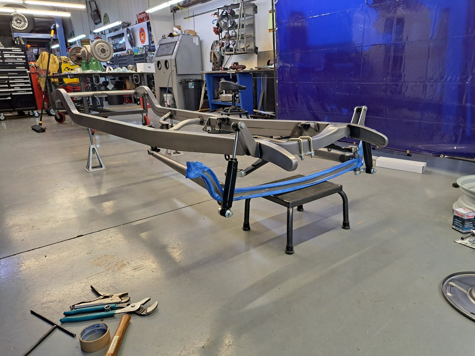

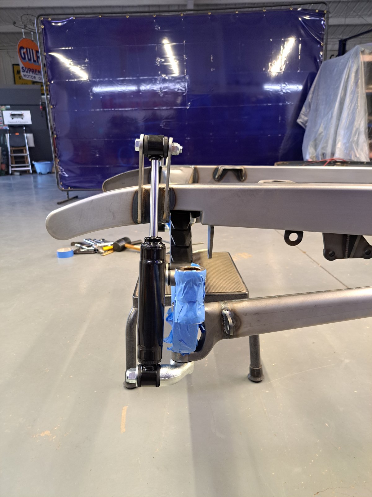

    Finished ***embly on the front suspension. Just rolling hubs for now, didn't ***emble all the brakes since all this is getting blown apart for paint and chrome.
    20220915_165903.jpg 20220915_165908.jpg 20220915_165912.jpg 20220915_165920.jpg 20220915_165926.jpg
    Borgeson Vega-style Cross steer. Performs far better than F1, though definitely a sacrifice from my 1957 era style.
    Haven't gotten the front tires mounted yet, so just through some spare tires on the front to see how ride height and clearance will be, looking really nice!
    20220915_170614.jpg 20220915_170619.jpg 20220915_170625.jpg 20220915_170633.jpg
    I ***ume Camber is a little out because there isn't any weight on the front? Definitely looks worse in the pic than in real life.
    Got my rear tires mounted today, doesn't get much better than that:
    Going to push on the rear axle ***embly tomorrow and this weekend, hoping to have a rolling ch***is soon!
    ~Peter

  30. That camber is NOT going to change with weight. Your axle is off, a truck shop knows how to bend it but since yours is chrome it may crack the finish. It also depend on if it cast or forged. They may not even want to mess with a cast axle as it will probably snap in the process.
