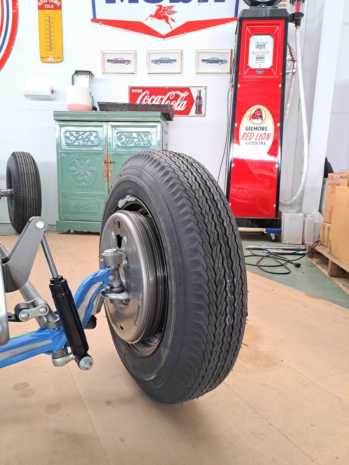

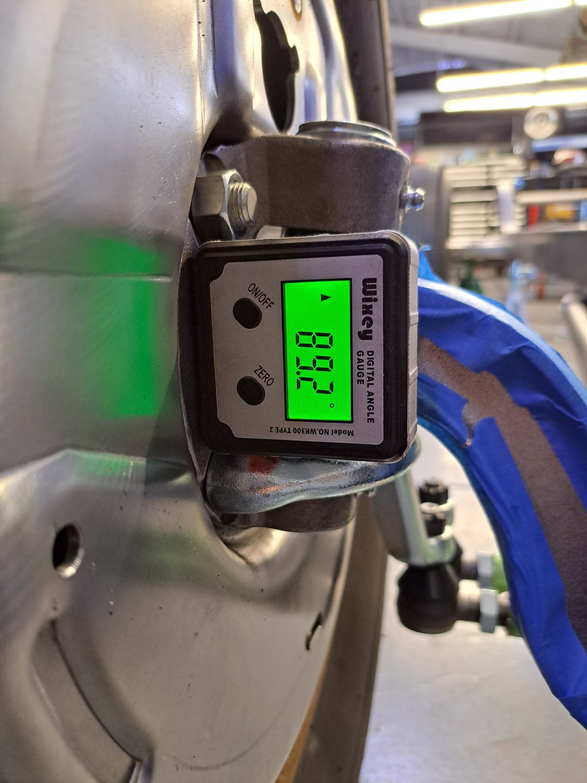

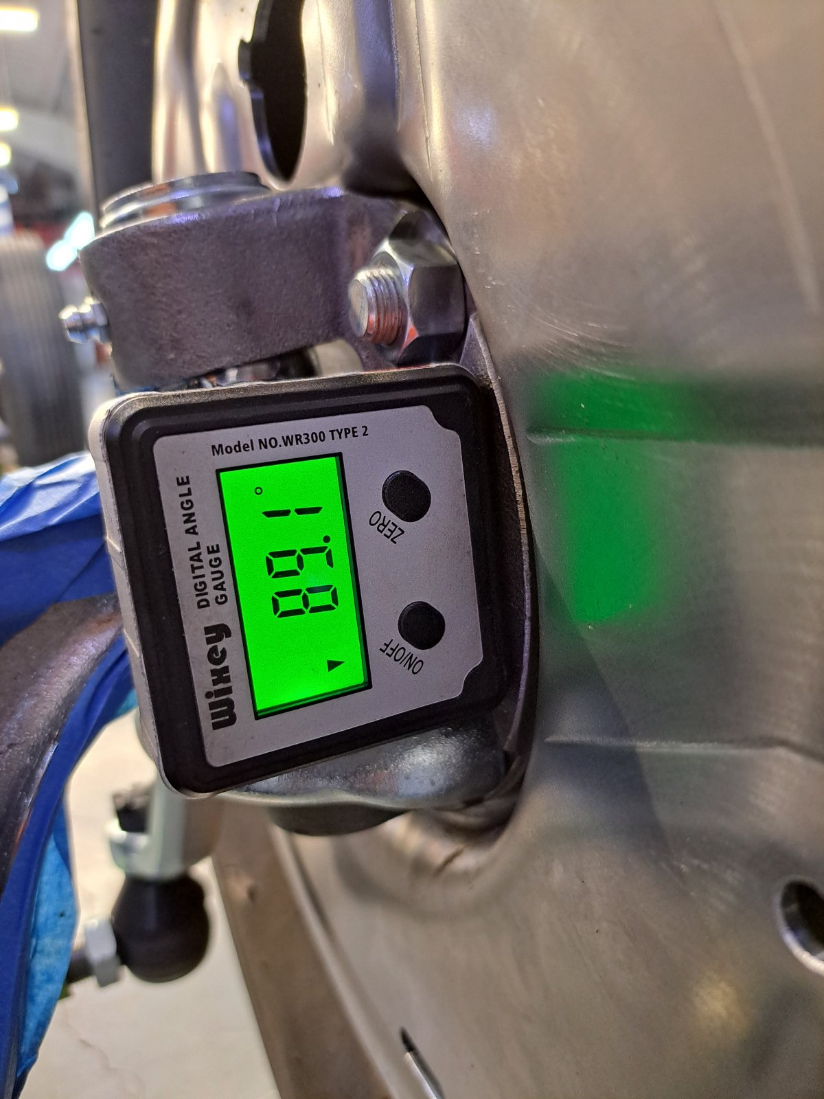

    Ford specs are max 1degree out. Looks like it's still barely within those numbers...
    Worst case scenario I'll have to buy another axle, Speedway has their forged ones for $280, which is way cheaper than shipping this one to get fixed and shipping back. Maybe there was a reason this axle was for sale at a swap meet?
    ~Peter

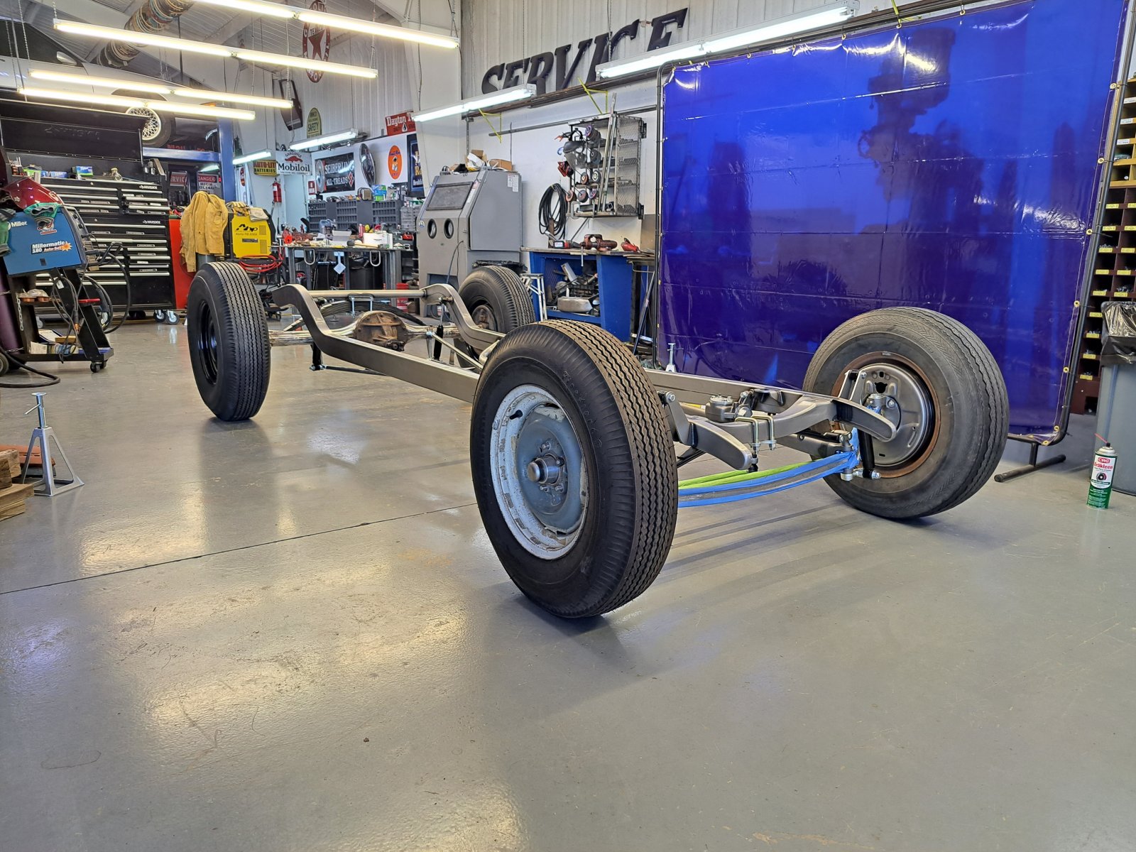

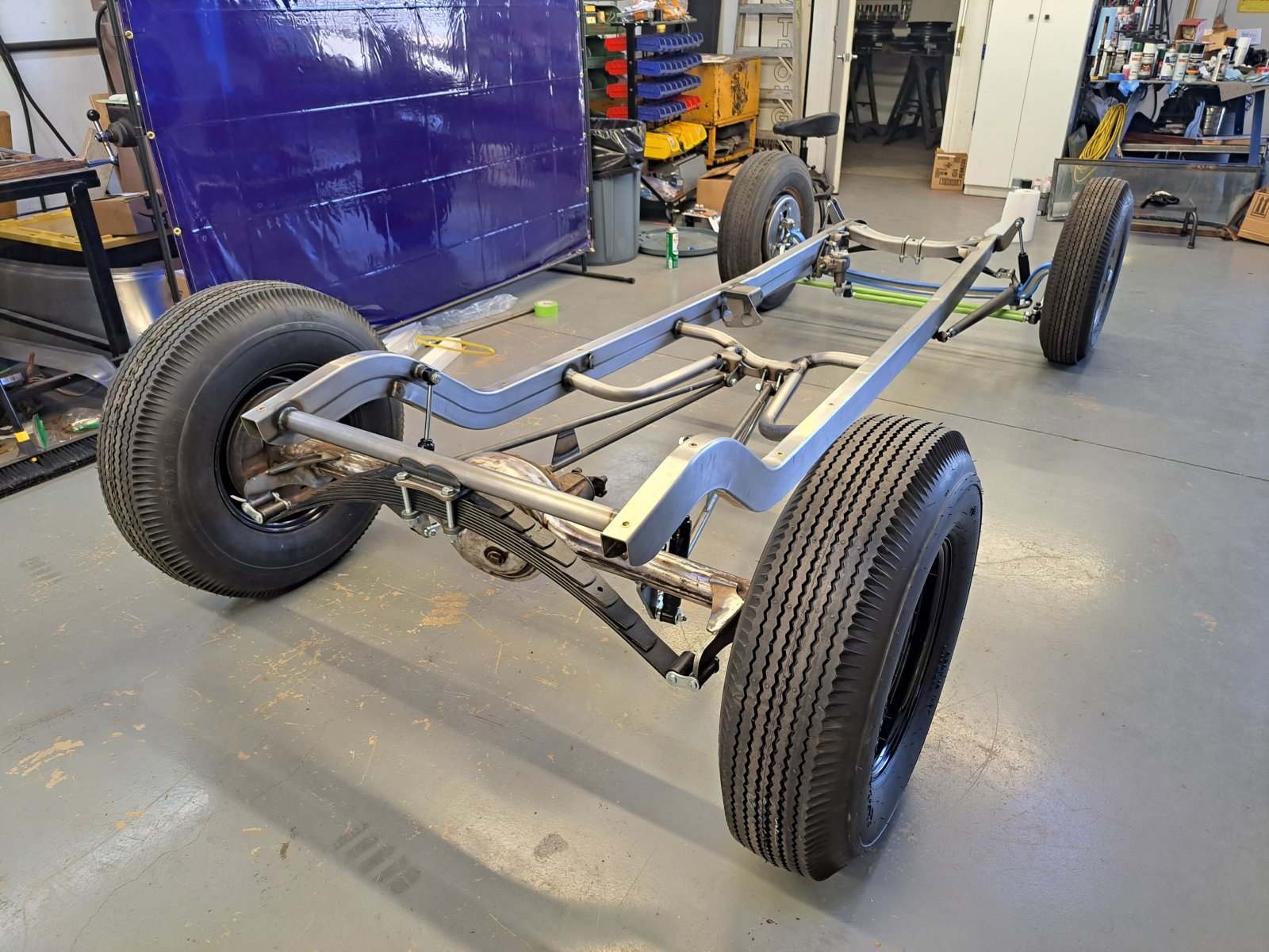

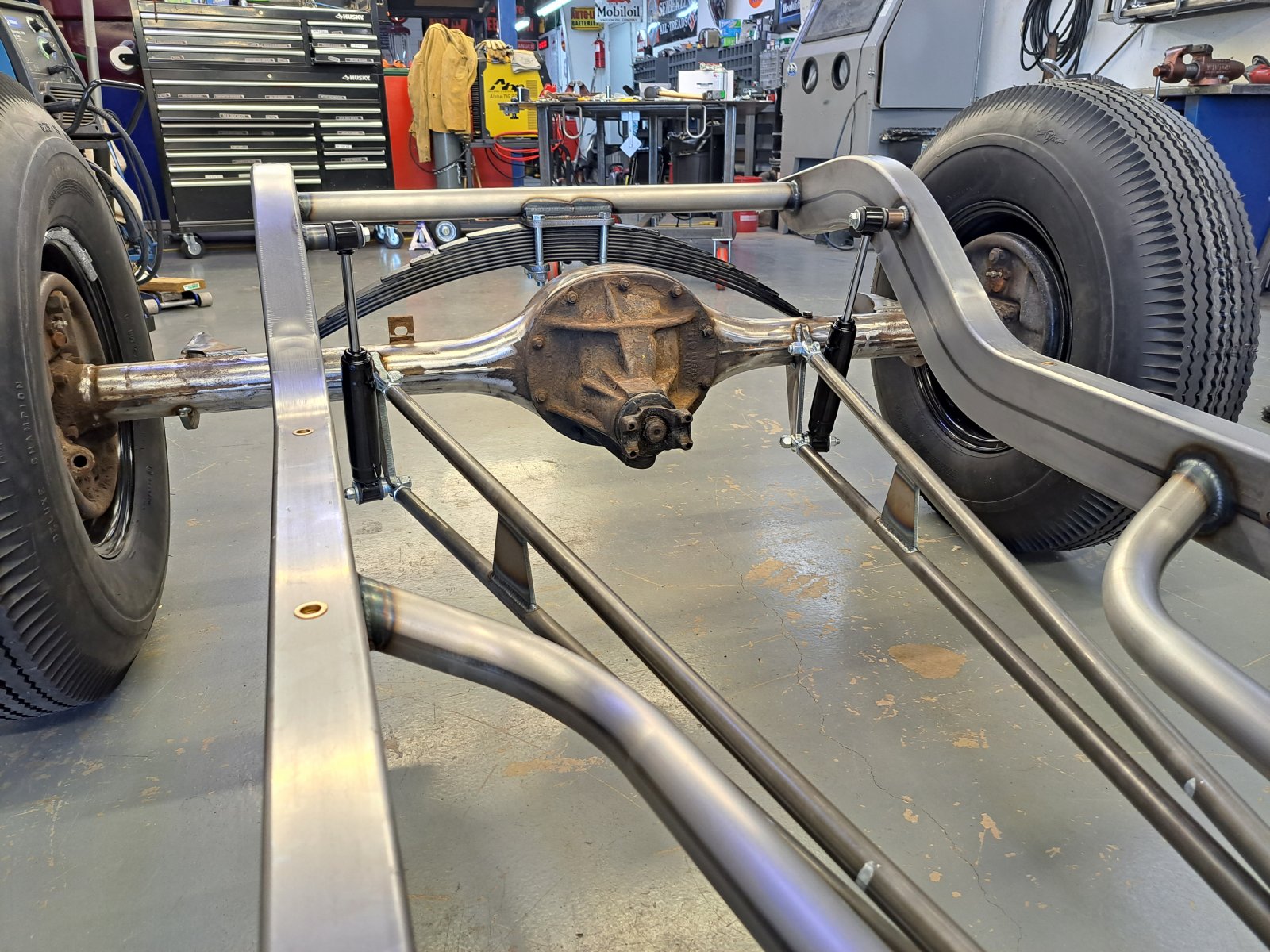

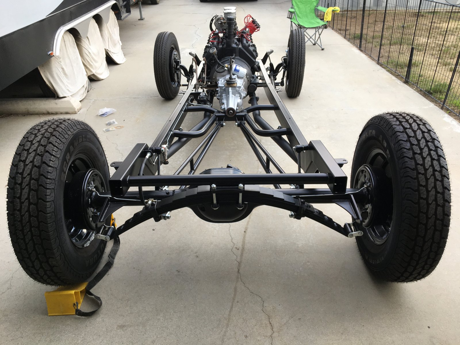

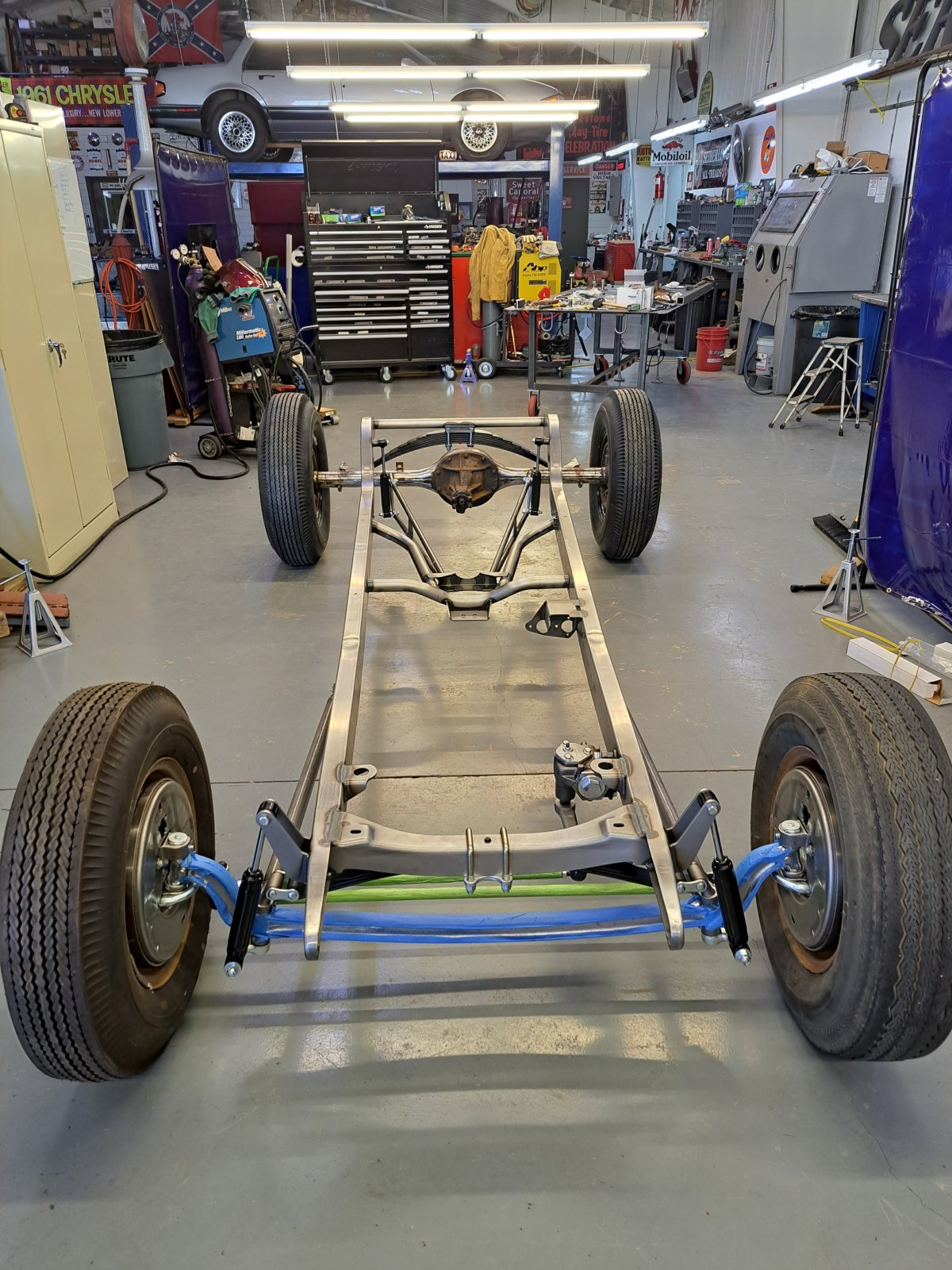

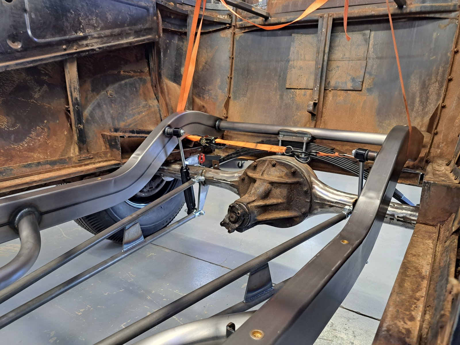

    Put in a long couple of days, and got the 1957 Chevrolet rear end oriented in place and welded the spring and ladderbar mounts on. Got everything within .03125" of square all the way around.
    20220917_141522.jpg 20220917_141539.jpg 20220917_141558.jpg 20220917_141604.jpg 20220917_141632.jpg Yes, the center section is offset to the driver's side, but then the actual pinion input is offset again to the p***enger side, so it ends up right in the middle.
    So invigorated to have a rolling ch***is; this one needs only a body to receive it and I'm working on that next. Got the body almost ready to cut the floor out, and then it's time to get these two together!

    Your project Pete, so it's your call. That said I would drill every attachment hole your gonna need for brake, fuel even wiring before you paint the frame.
    Stogy, Just Gary, Tman and 2 others like this.

    That's the plan! Going to build it all right up to almost running/driving, and then teardown for prep and paint. Not building a show car, but definitely aiming to avoid as many headaches as possible by thinking everything through in advance.
    Honestly, I like the look of bare metal, and especially in the dry atmosphere of West TX, the frame won't rust at all sitting inside. So I typically don't rush to paint. ;)
    ~Peter

    So you use as I call a ' Fitting Stage ' in the build and is necessary for proper and precision build . Alot of people only understand what they see on You Tube and those guys more interested in you seeing them than showing ALL of what is necessary for a good and long lasting build . If I tell what I think of sponsored catalog builds I'd get deleted for being political ! LOL !
    Your car is looking real nice a bare metal composition I like that theme it's a ' This Is Real ' look

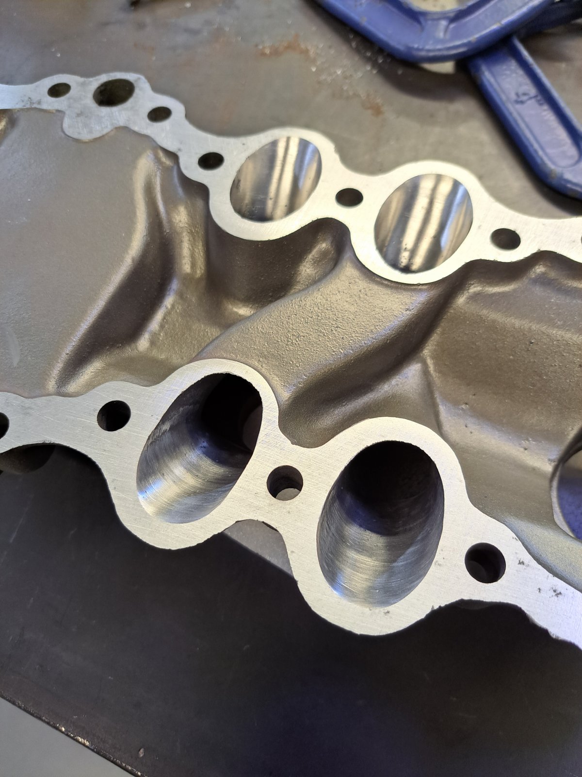

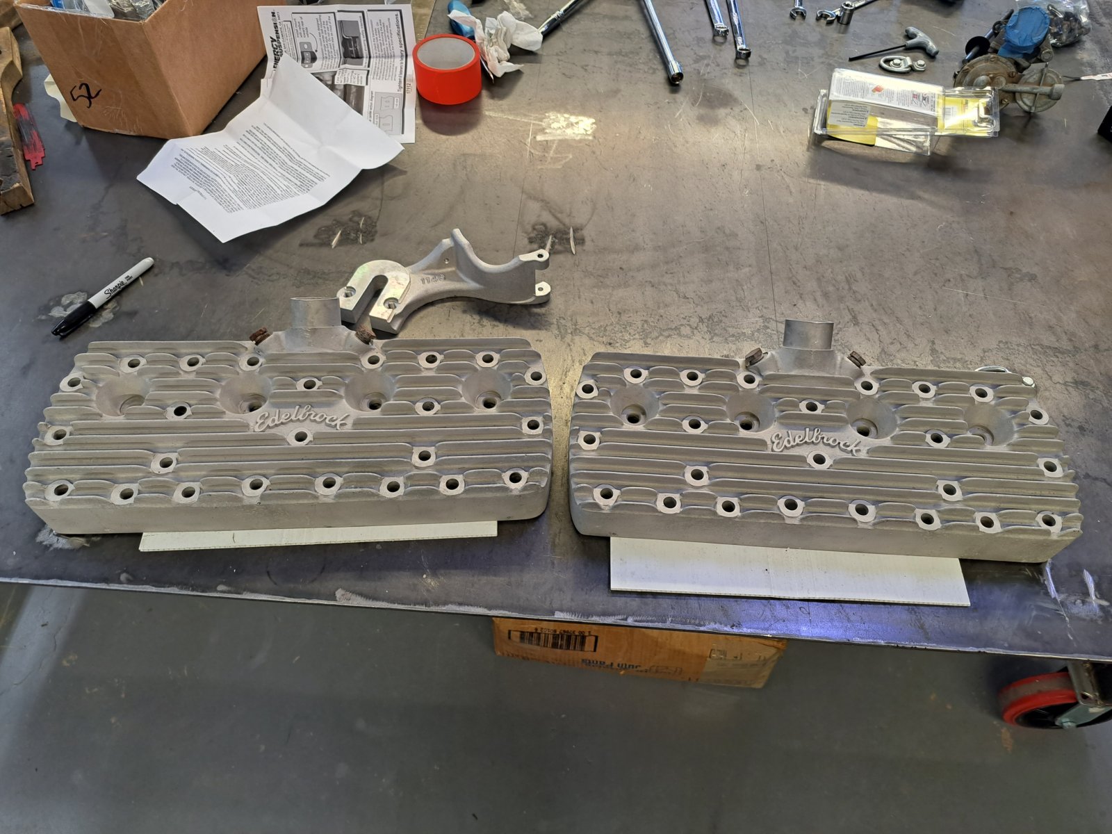

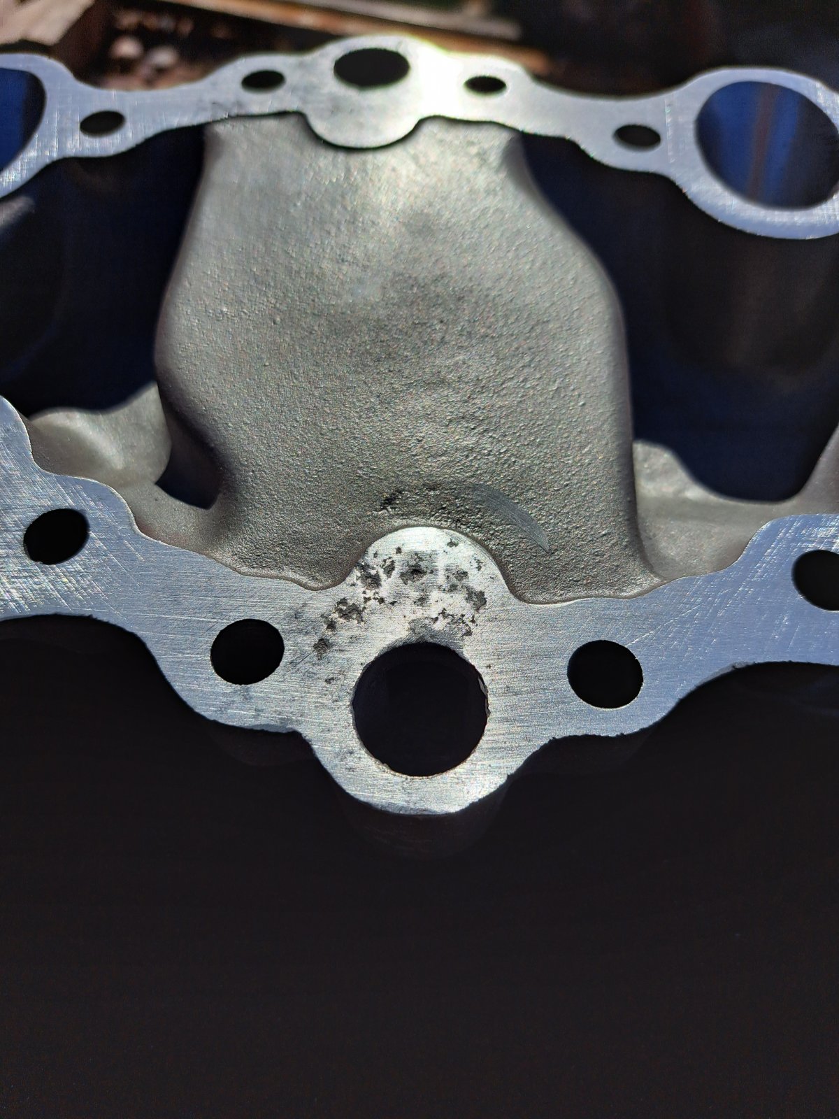

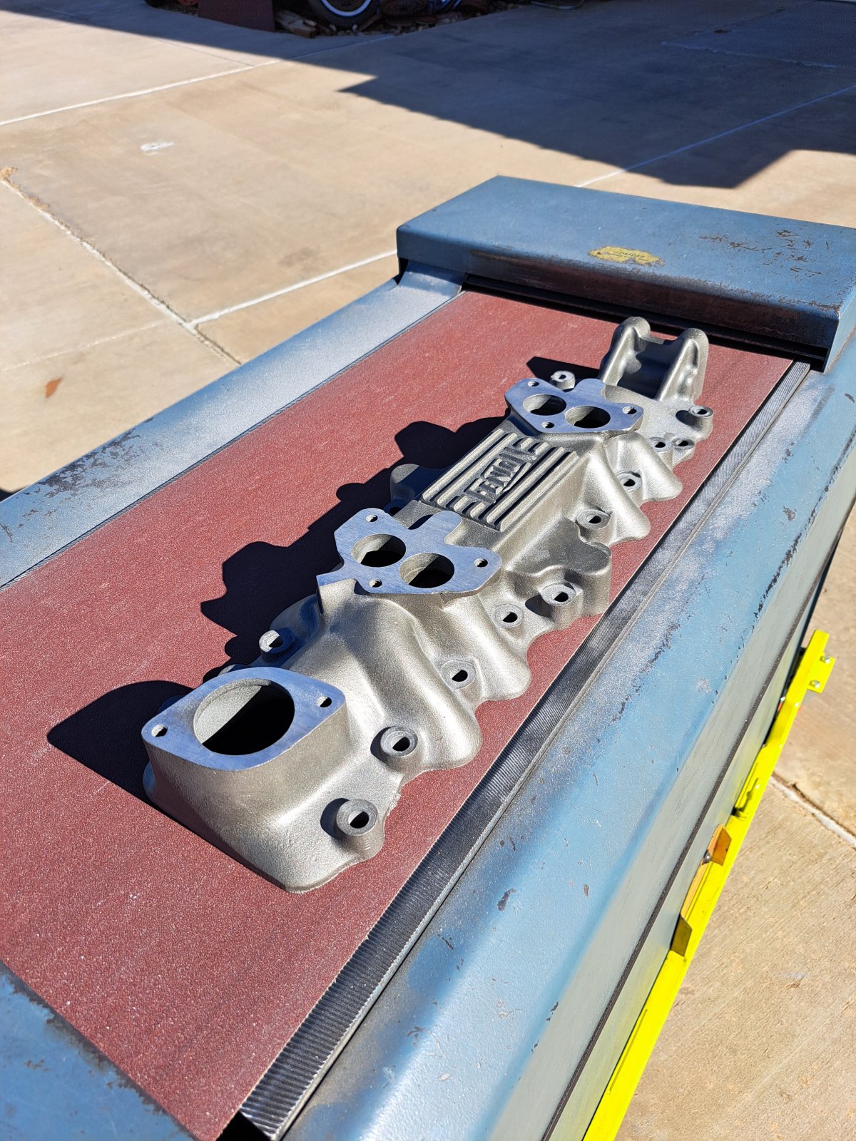

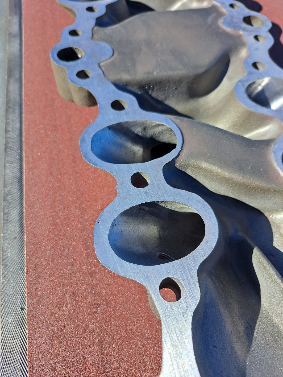

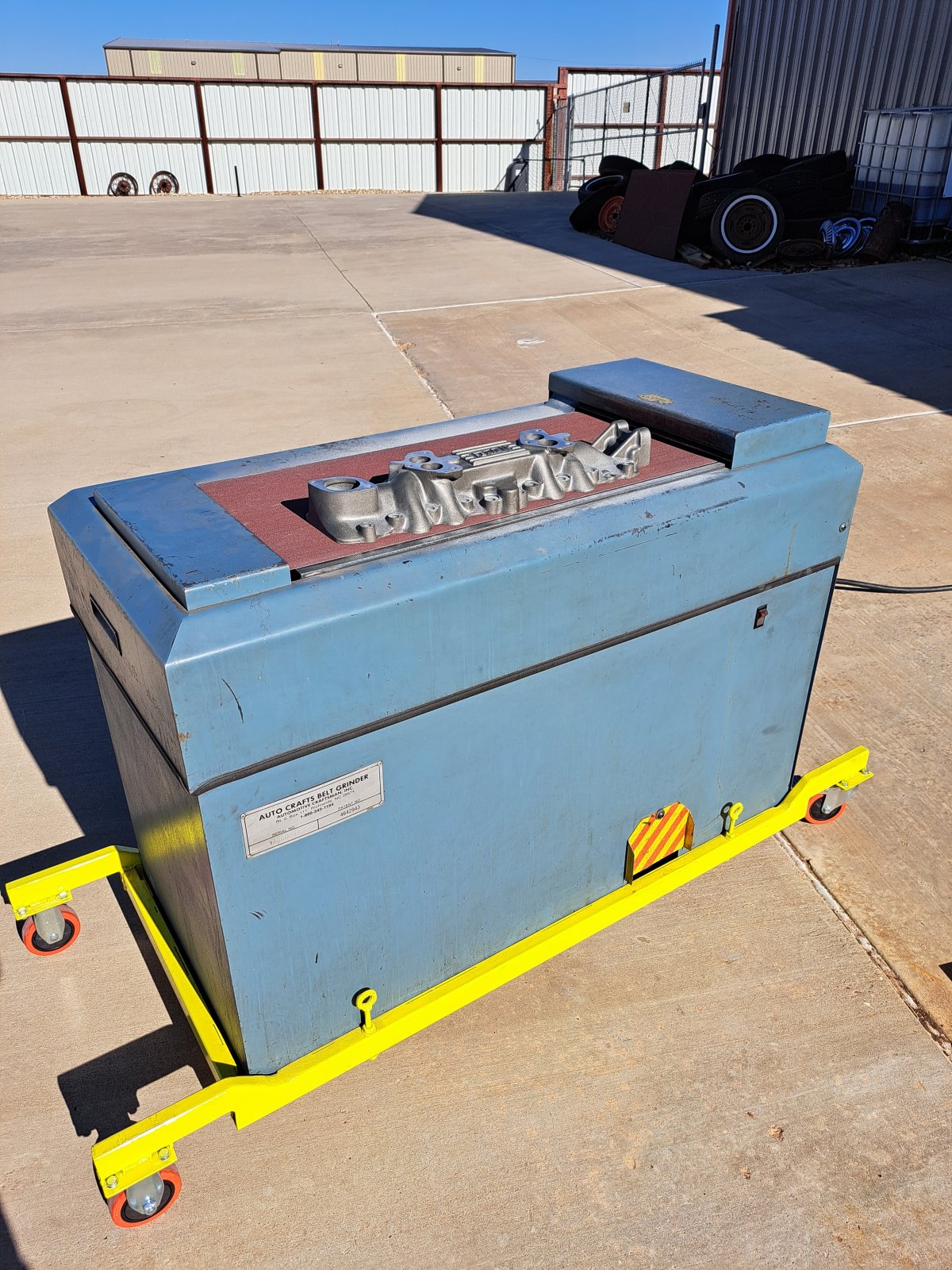

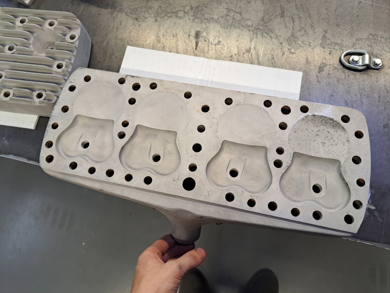

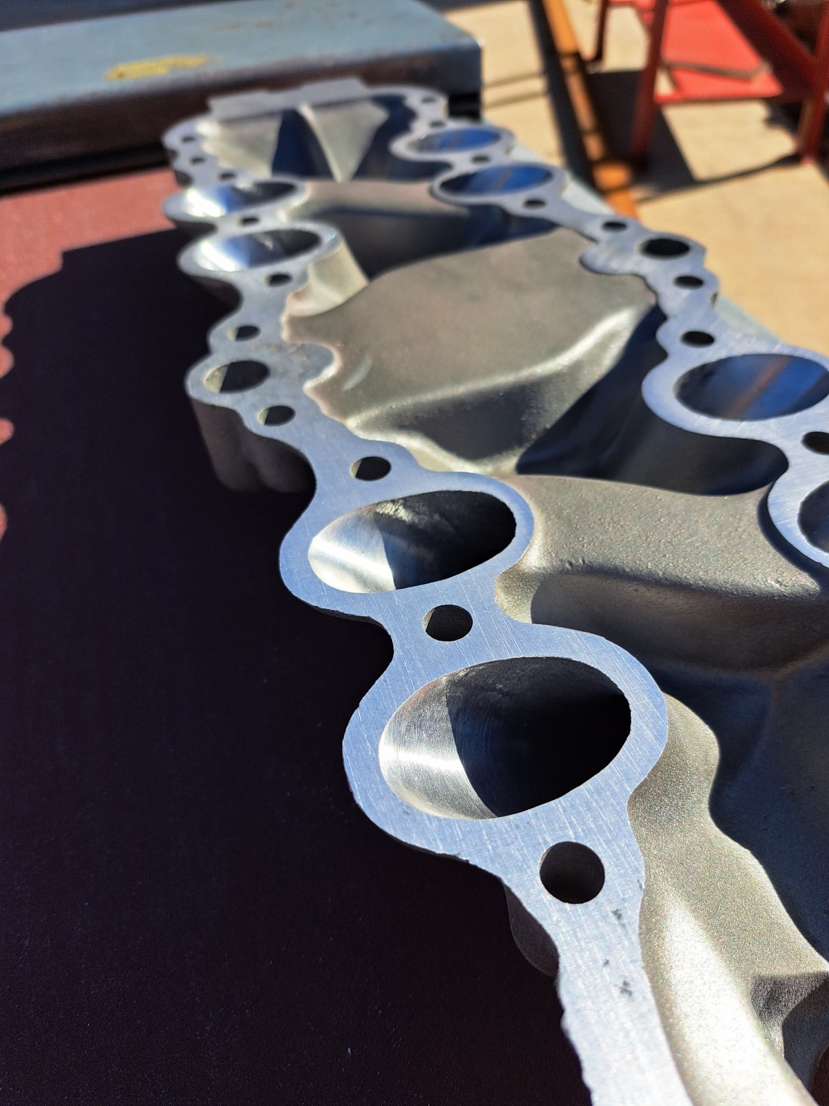

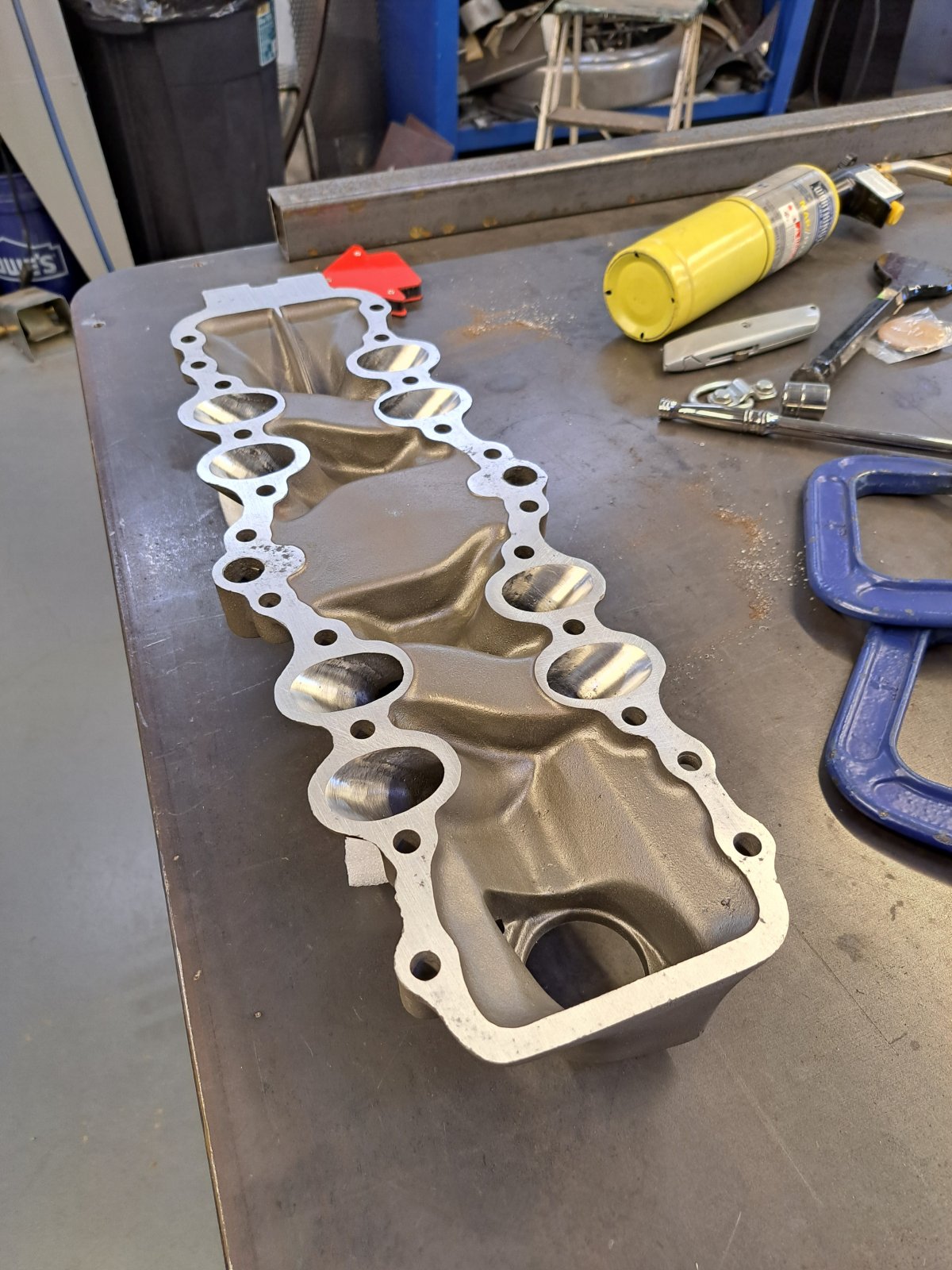

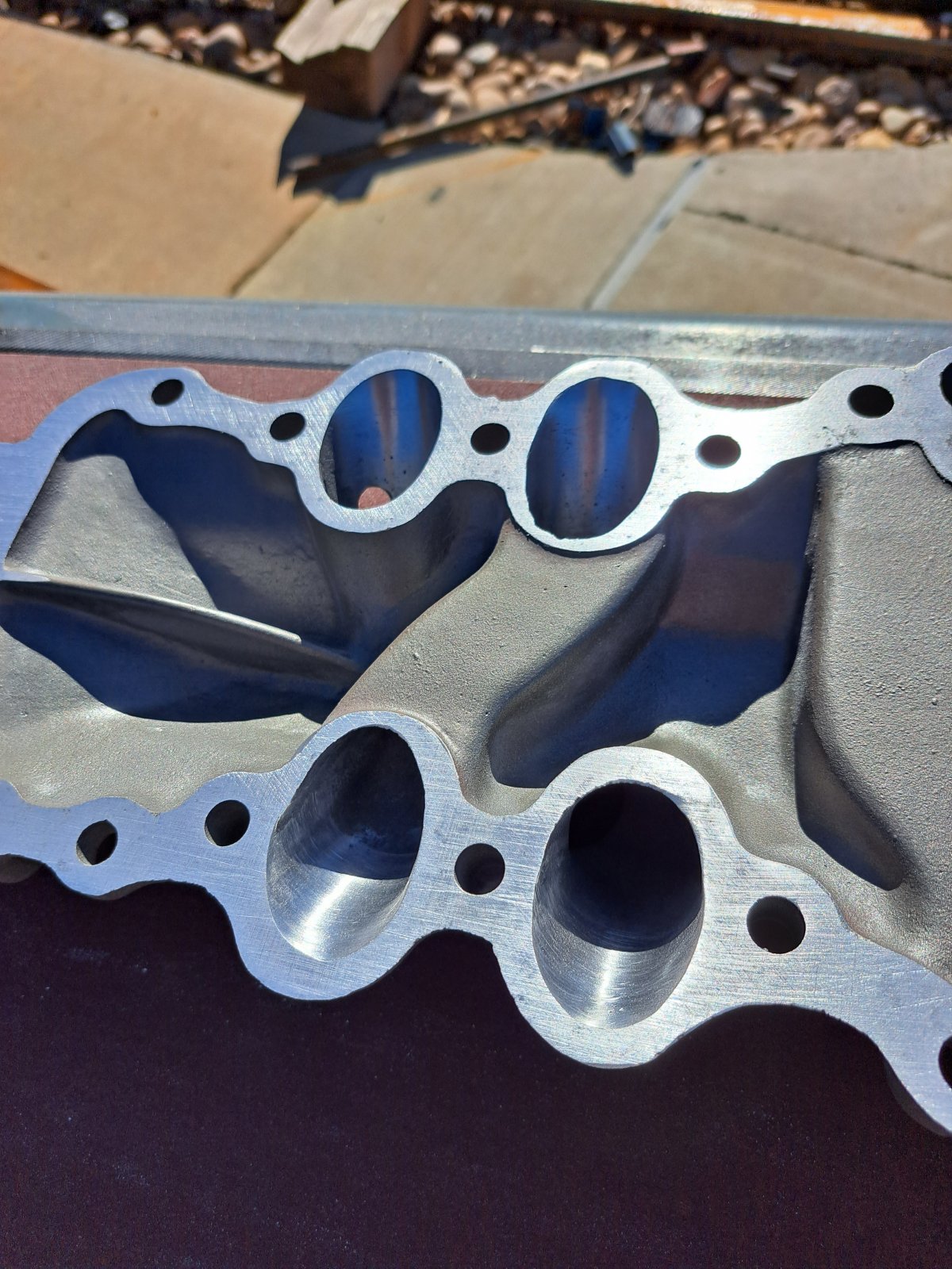

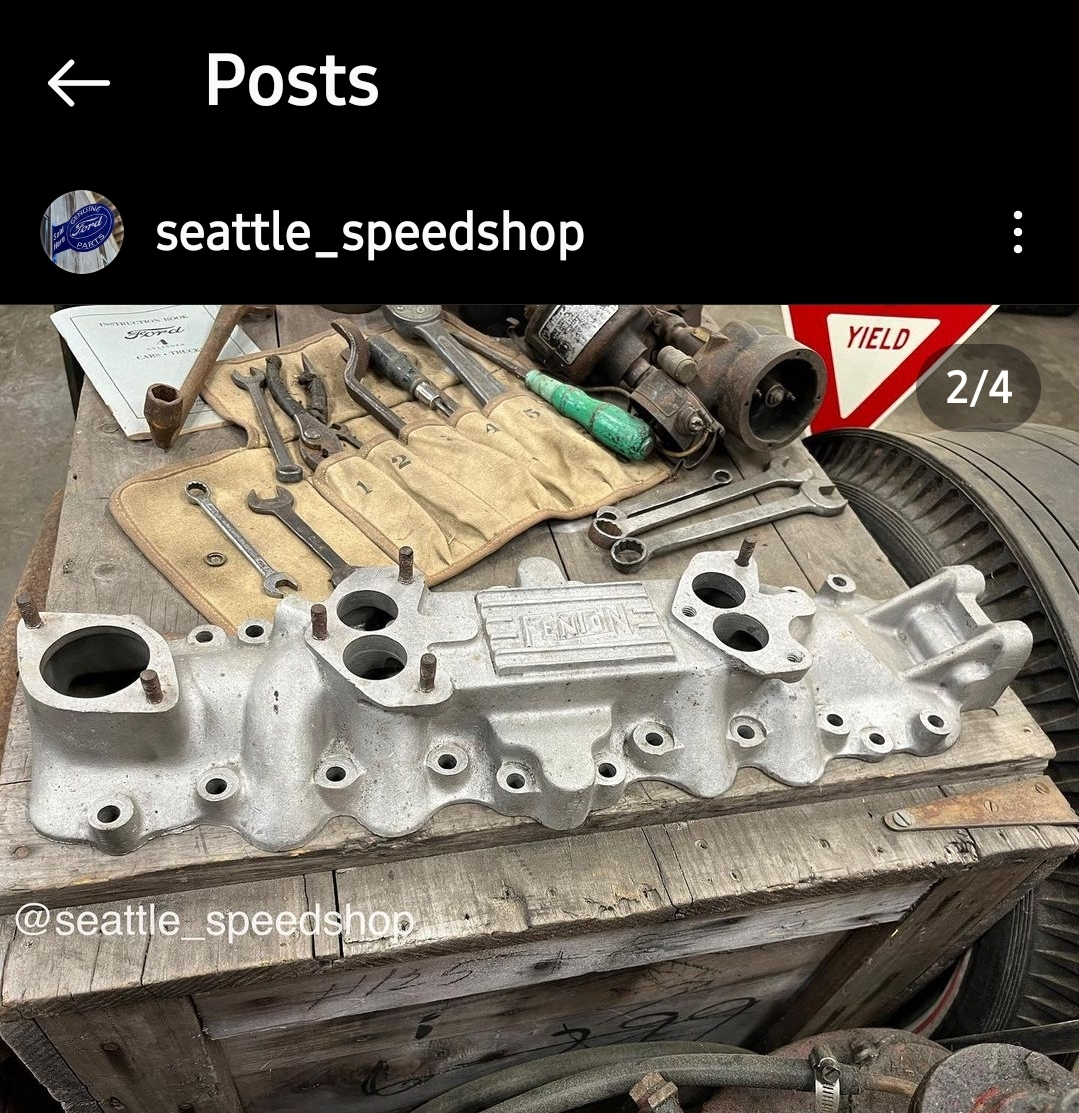

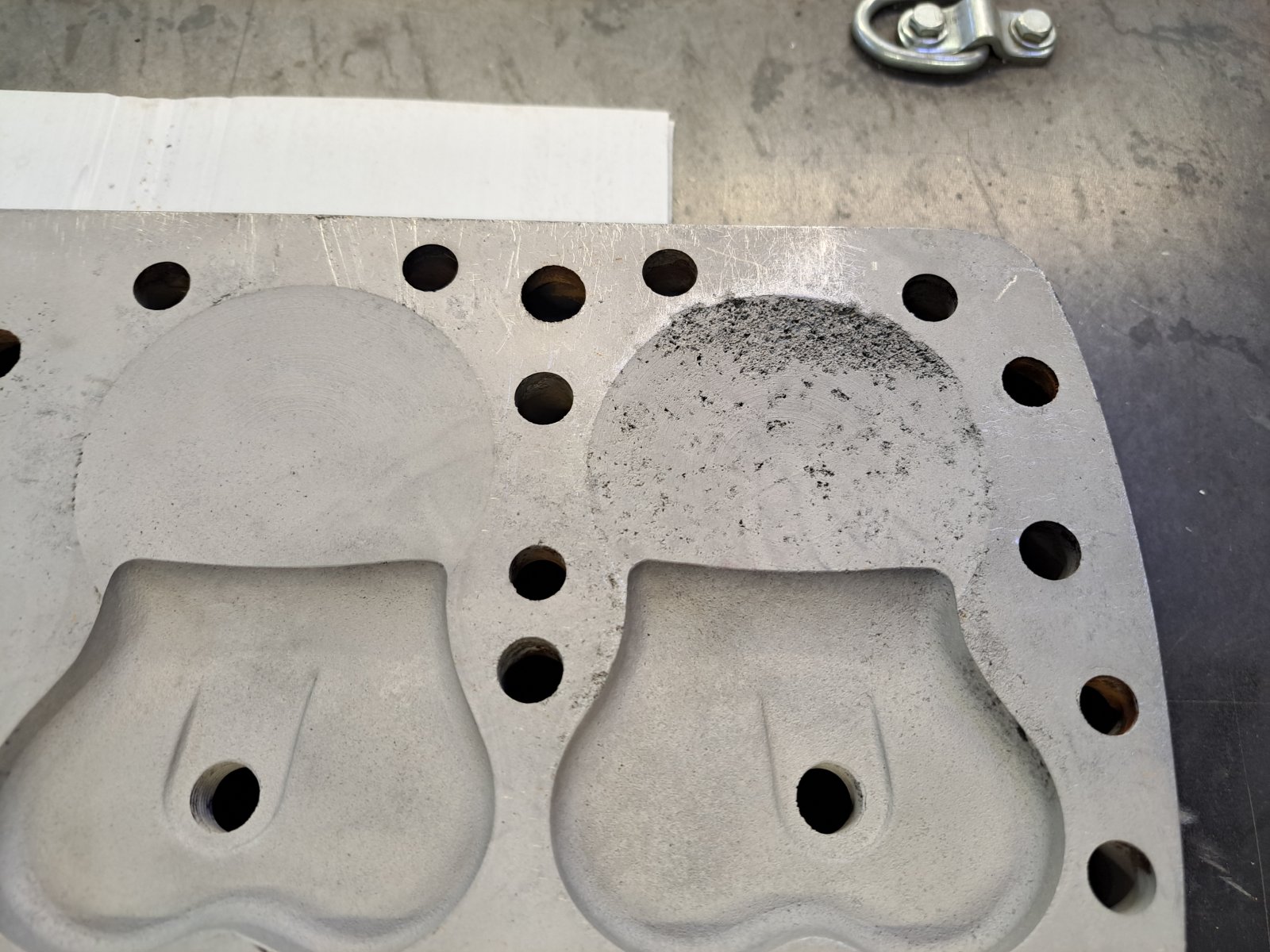

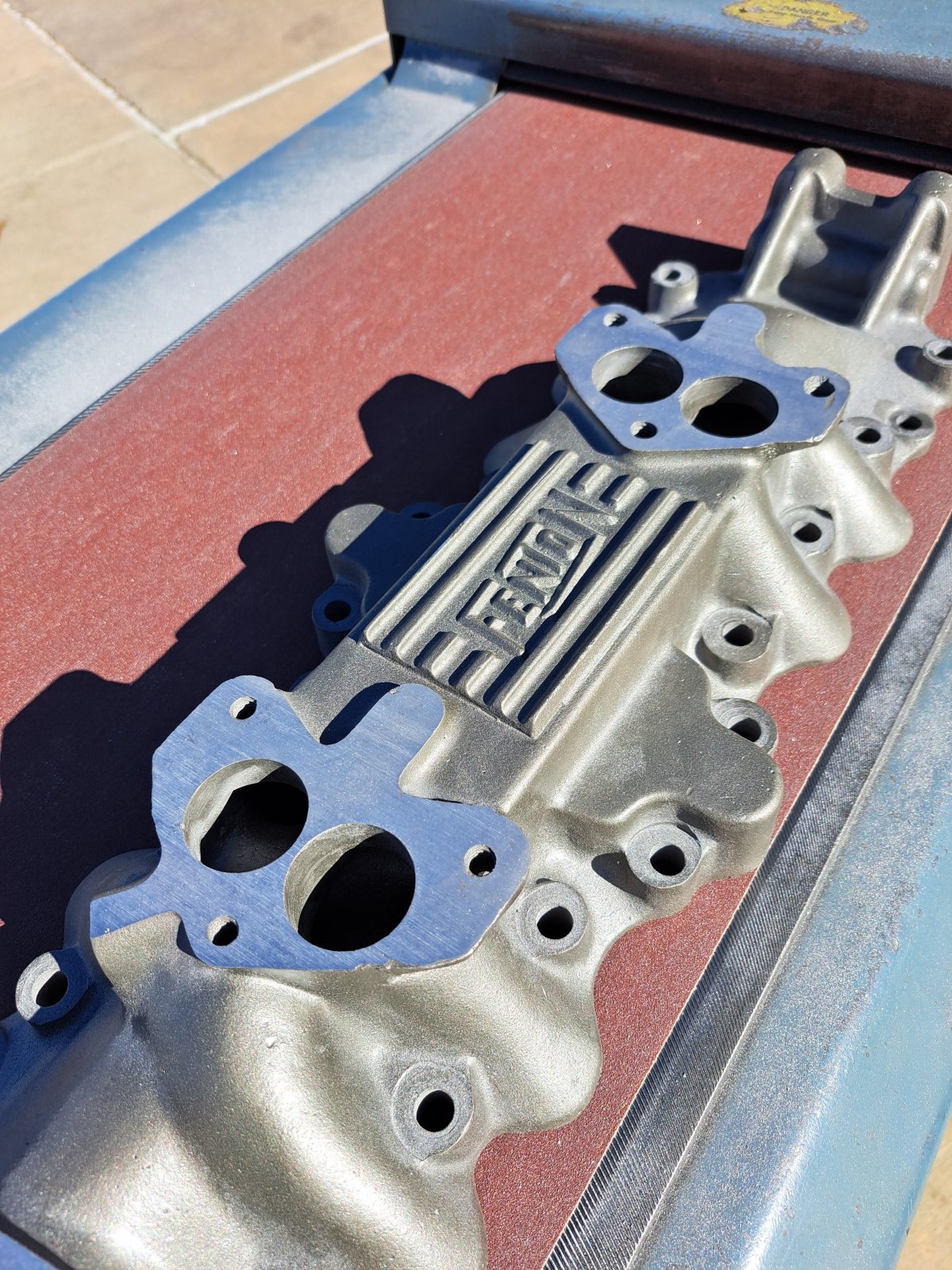

    I'm a bit of an eccentric when it comes to symmetry, and I wasn't happy with the Offenhauser intake that has both carbs towards the rear of the motor to fit the generator in the stock location. So I started looking for a equally spaced dual intake; luckily it didn't take long and it happened to be a brand I've always liked.
    Clean, no repairs or major damage, and at a fair price.

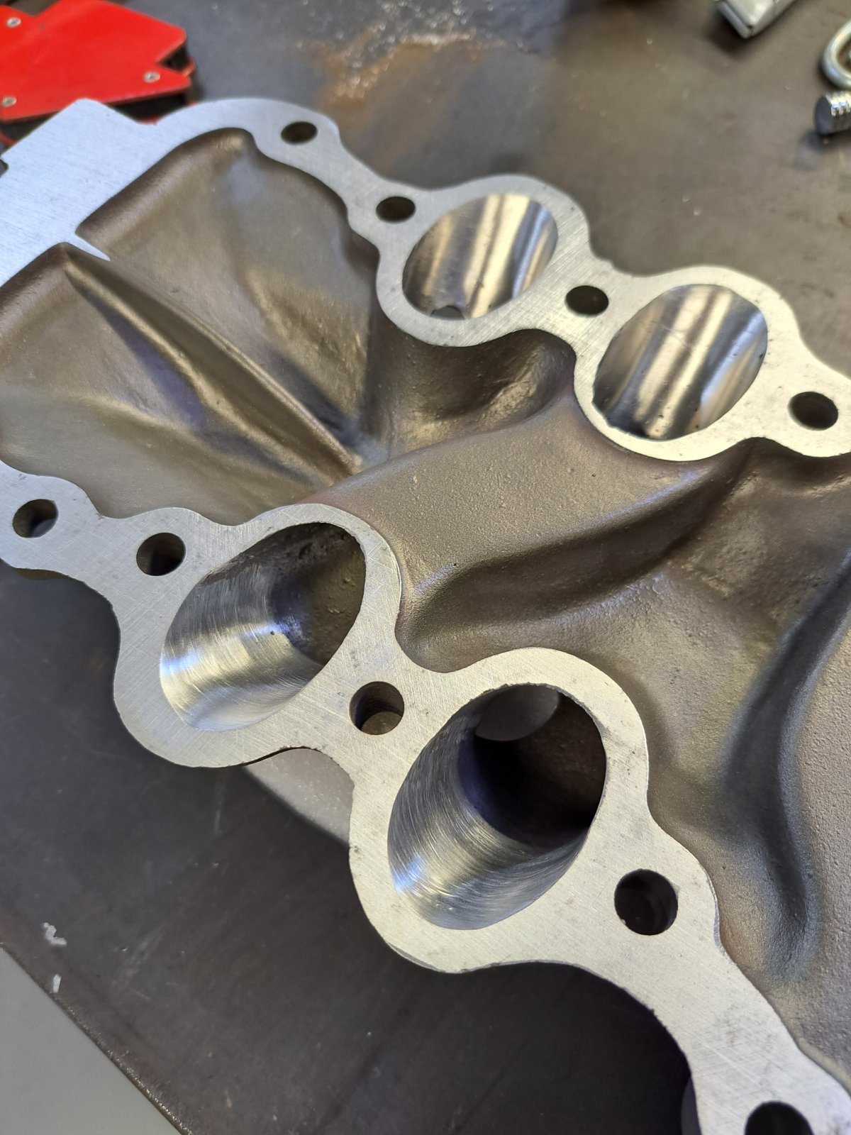

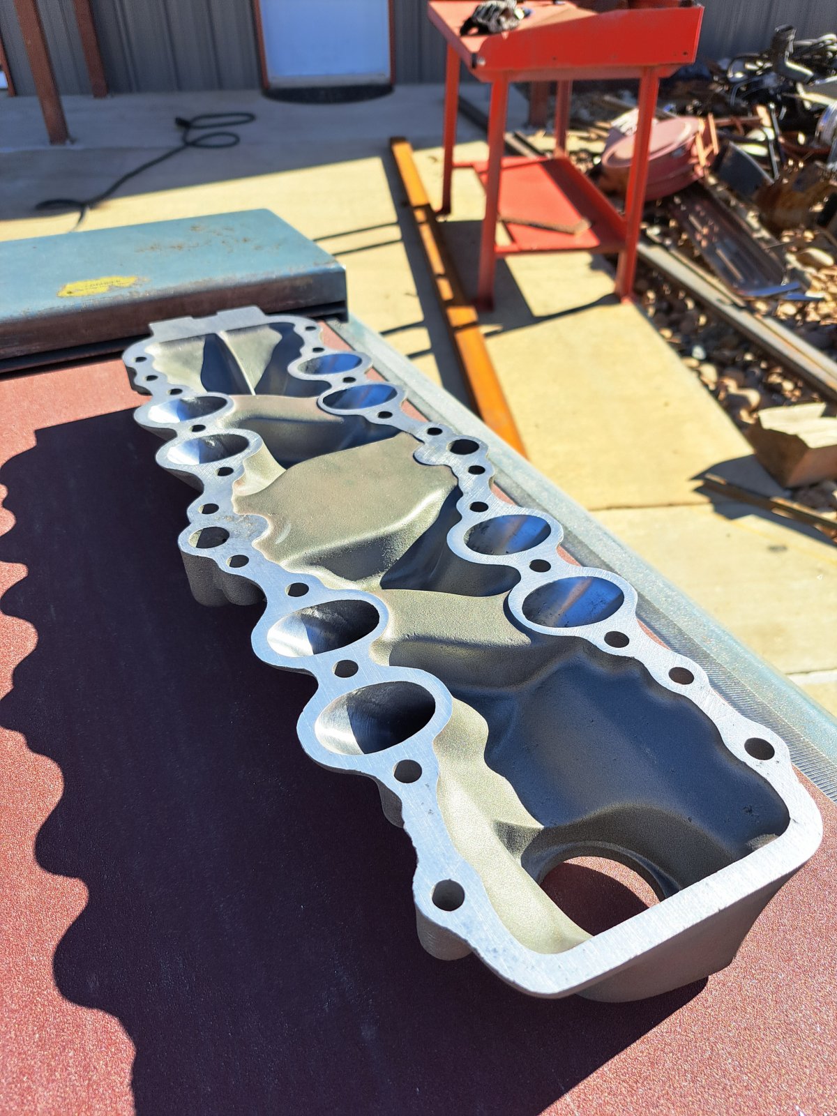

    Got it home and media blasted and cleaned it thoroughly, then I laid out the gasket and began the age-old practice of port-matching the intake runners. Following some guides from some 1951 and 1953 Hot Rod Magazines, I got it all cleaned and polished out to 600 grit. Then I ran an abrasive wheel in the ports to clean any other rough spots.

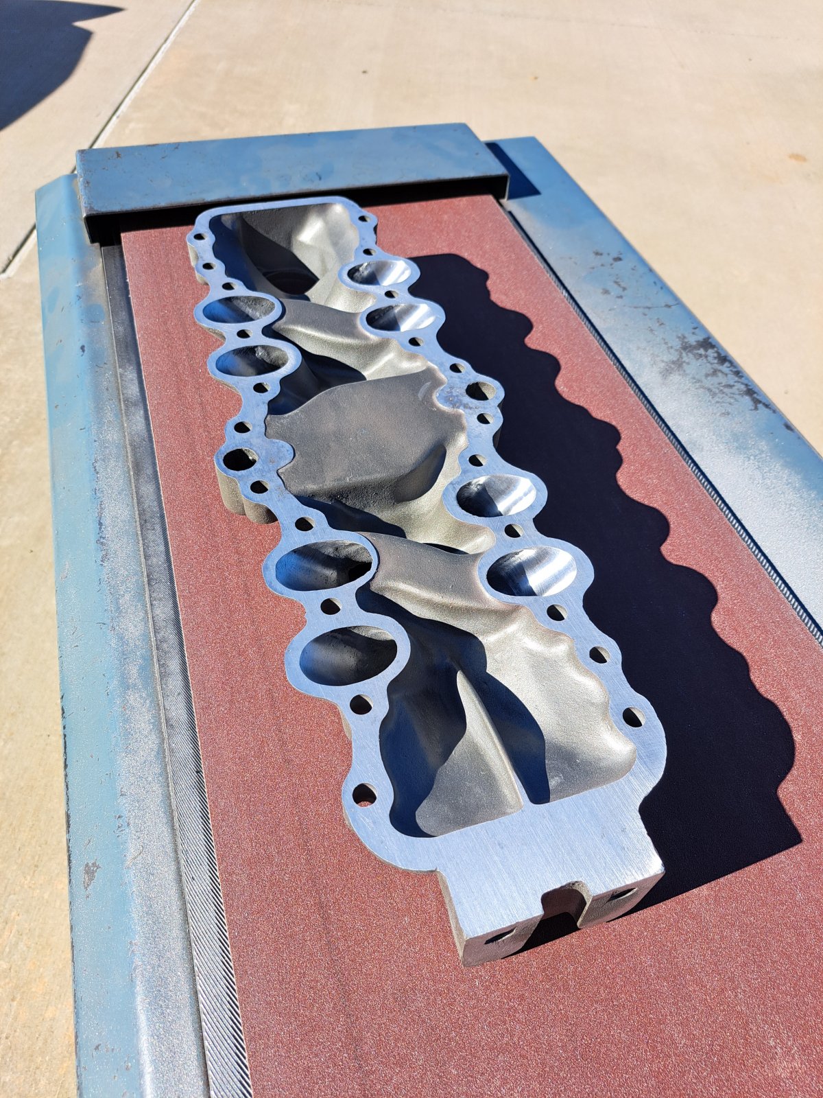

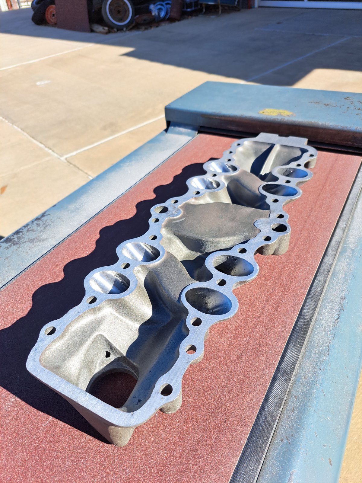

    Then it was time to drag the Auto Craft Belt Sander outside to true up the surfaces. Since we do so many old cars with rare exhaust and intake manifolds, we end up having to restore the original surfaces to correct for any warping or damage. So we bought this sander a few years back and it's been awesome!
    Trued up the carb surfaces as well as the rear breather. Might as well. o_O
    20220921_170528.jpg 20220921_170533.jpg 20220921_170540.jpg 20220921_170546.jpg 20220921_170551.jpg
    The small area of corrosion around the water p***age cleaned up just fine. Got a good clean surface for the gasket to seal to now. I'll obviously use some sealant as well to be doubly sure.
    So yeah, that was my day of wearing respirators and trying to avoid inhaling anything too harmful.
    Intake will be painted engine color, and I may polish the fins and the Fenton logo.

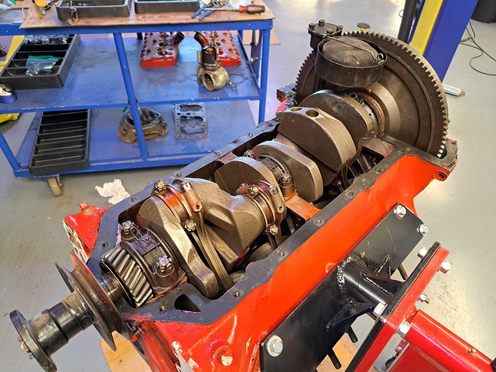

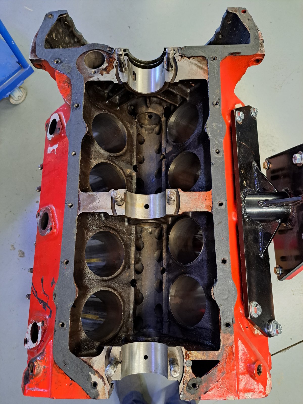

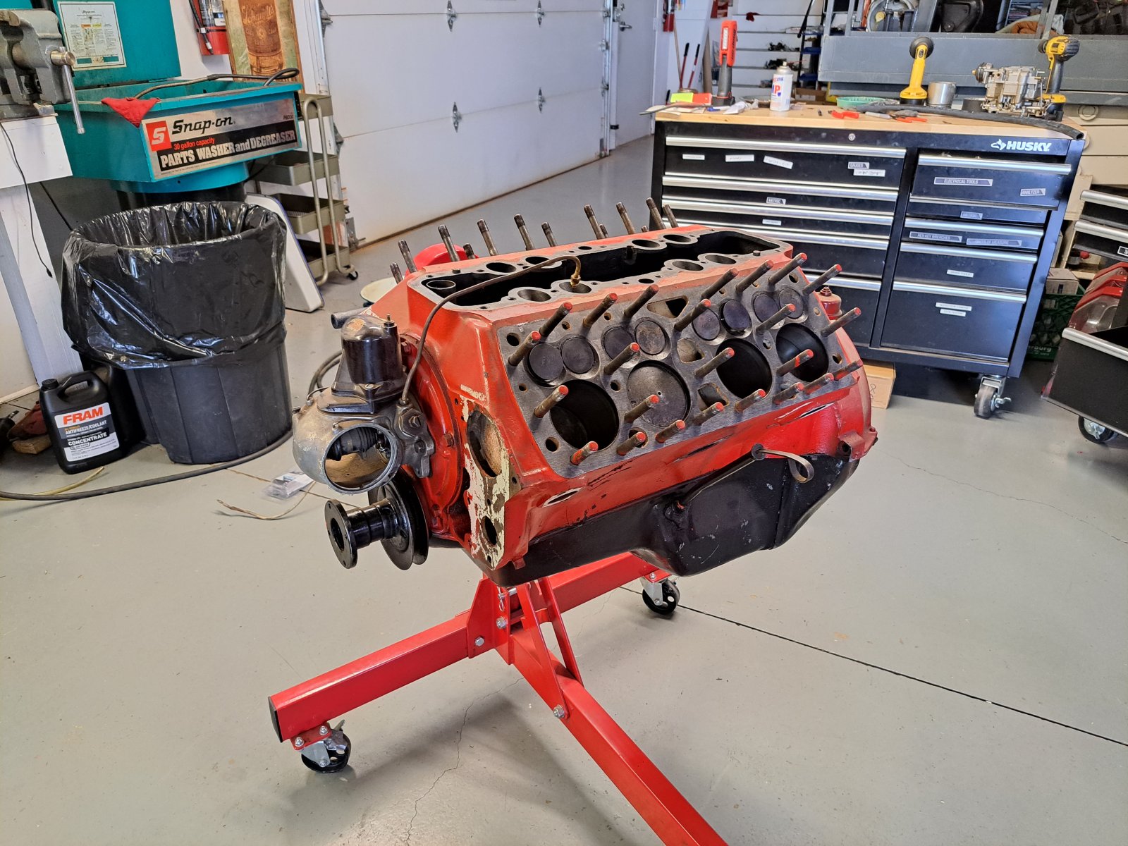

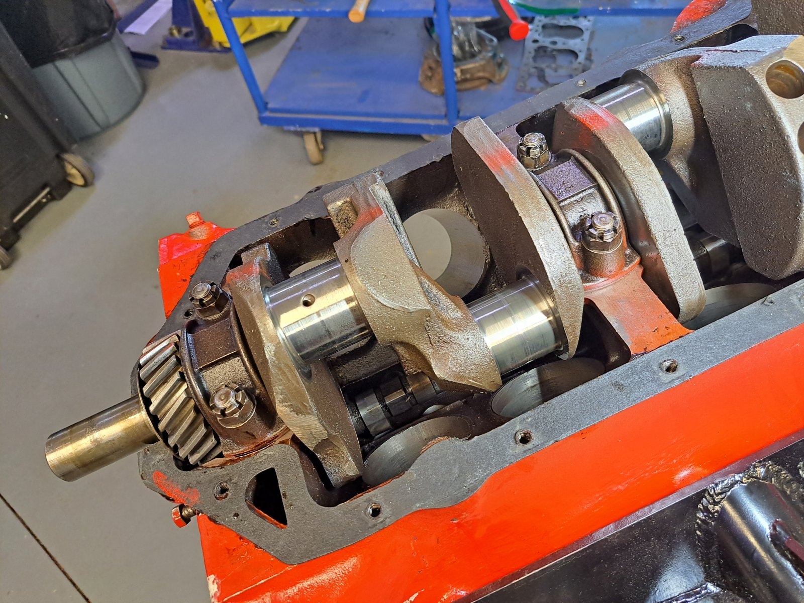

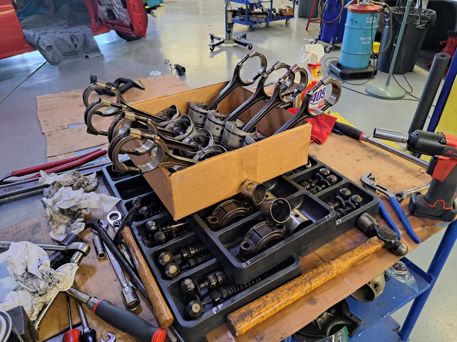

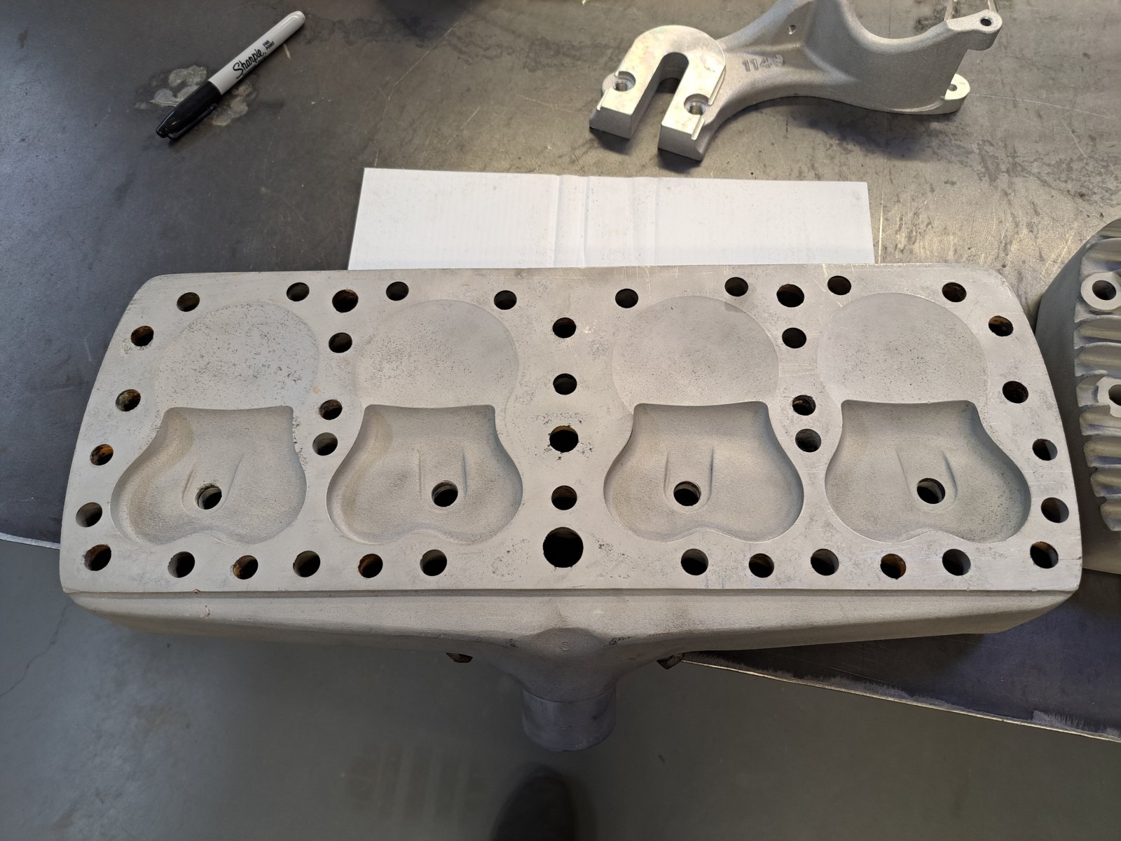

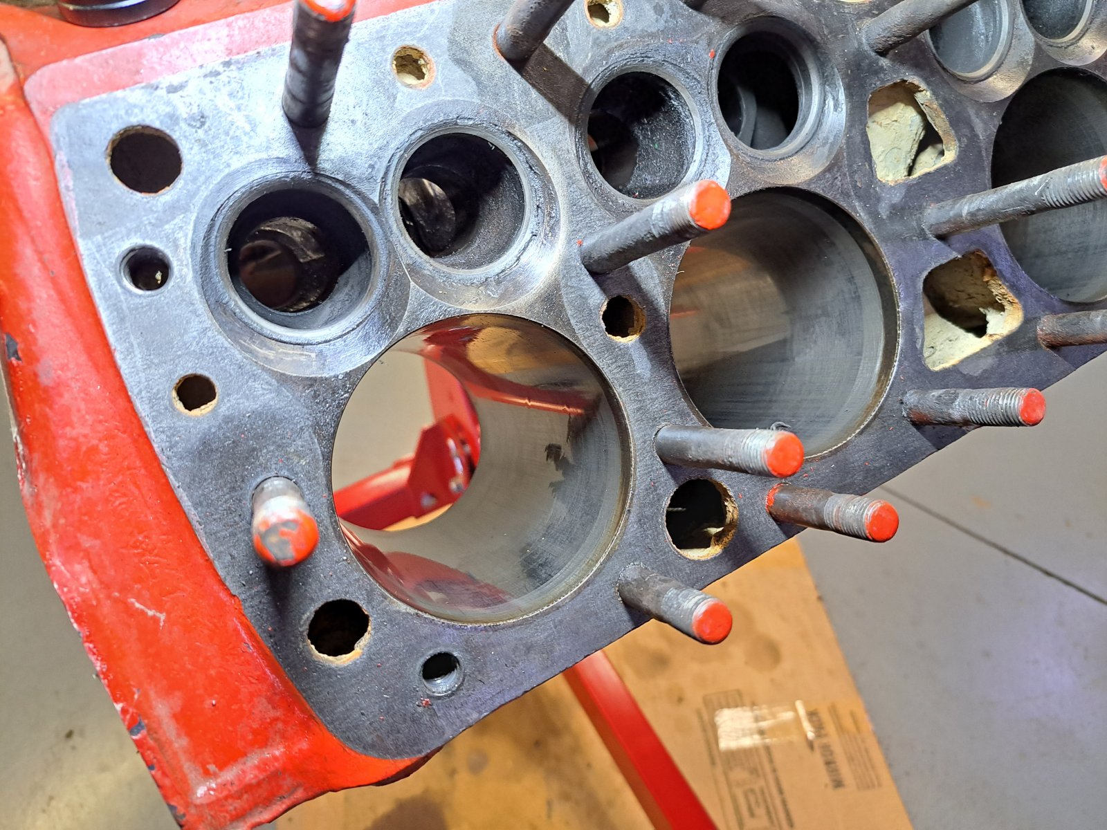

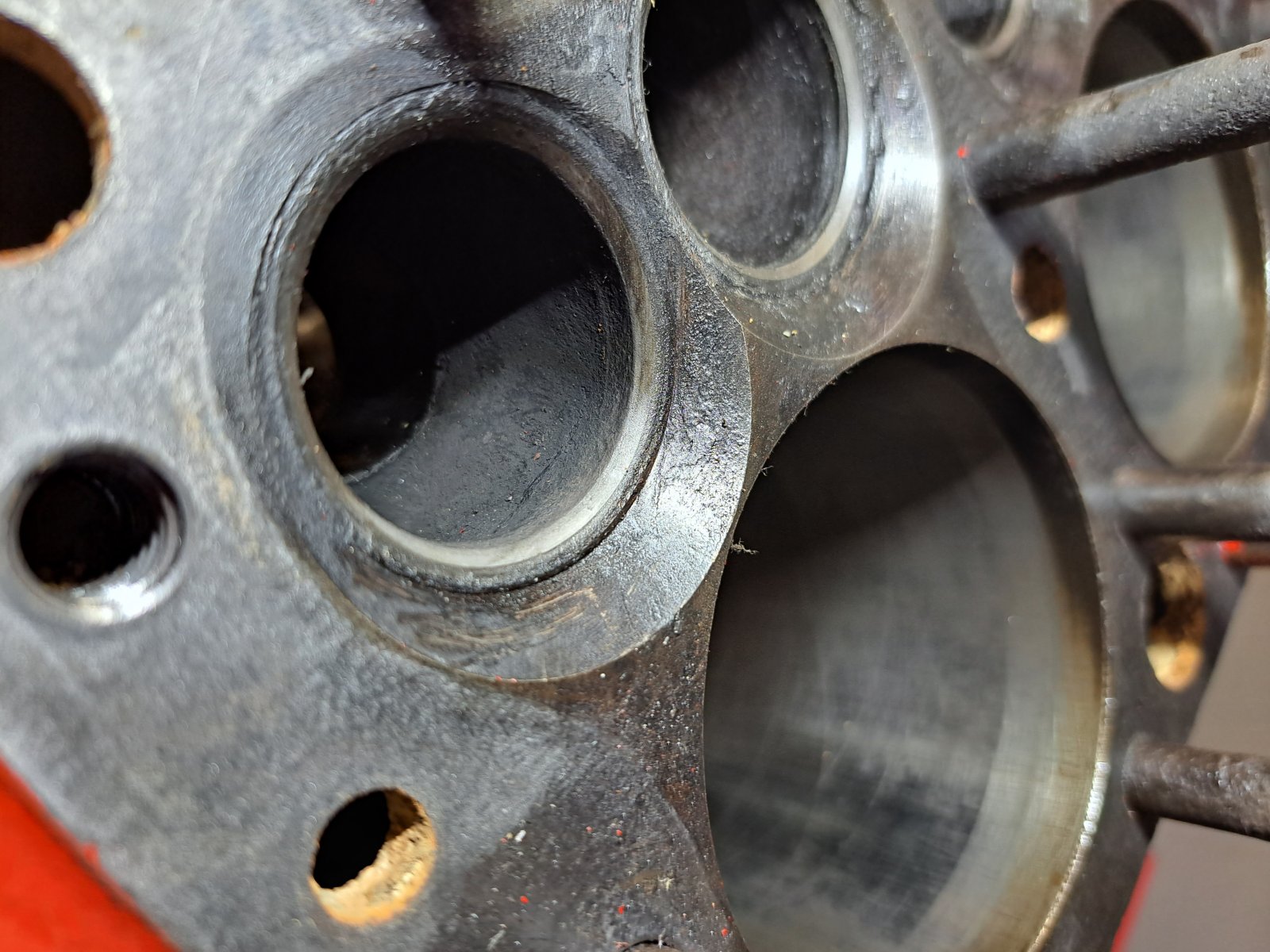

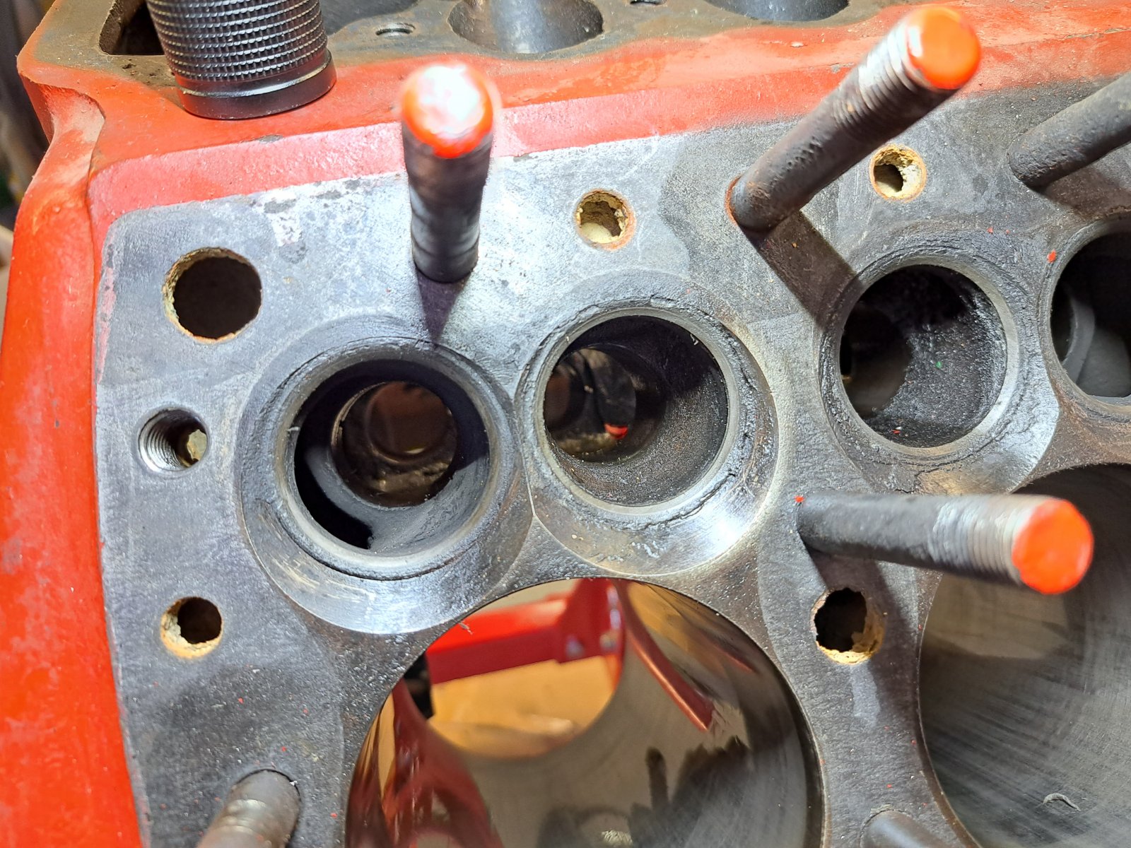

    This flathead was cast on Armistice Day 1940, and I purchased it from a big Ford guy named Bill Schriock of Minot, ND about 15yrs ago. Got it on the stand for teardown and I am liking what I see!
    Oil Pan had been off recently, likely when they painted the engine as evidenced by the overspray on the main bearing castings.
    All the pistons came out beautifully, and the journal bearings look good.
    One of the cleanest bottoms I've seen in years. :p

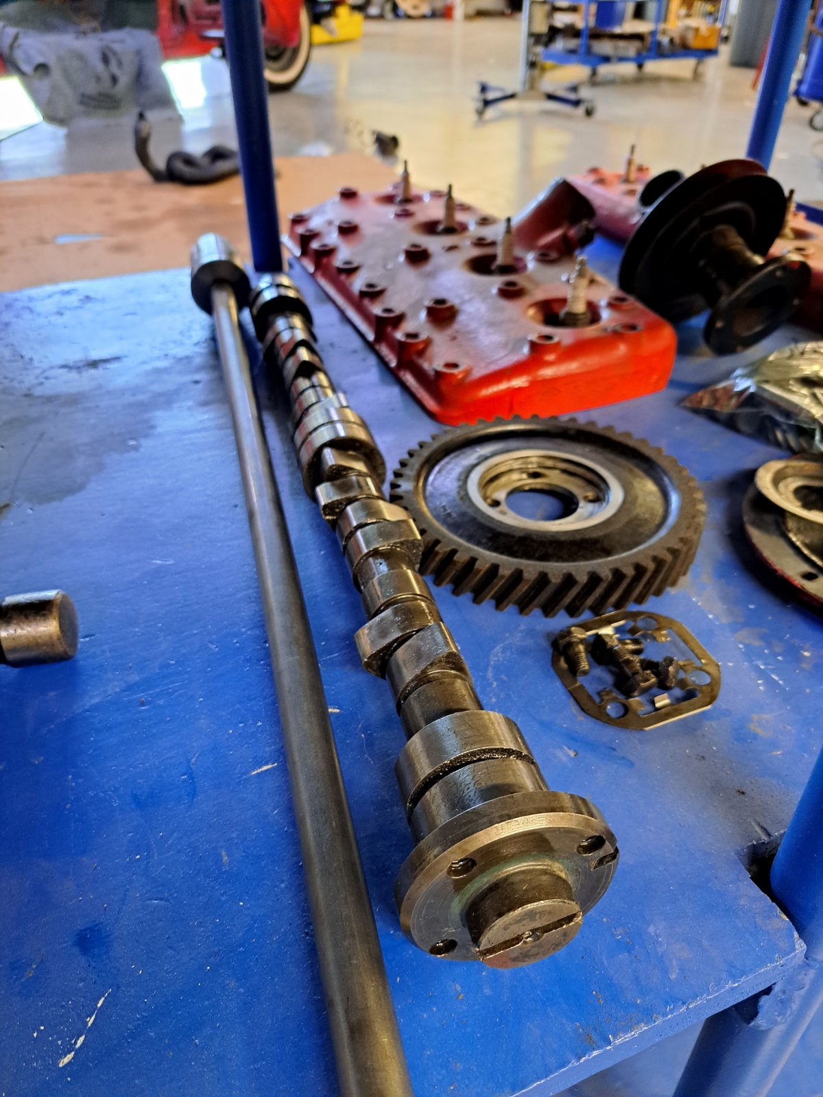

    I'll have the machine shop teardown the pistons and magnaflux the rods as well. They were all pre-stamped with the cylinder numbers, not sure if that's a Ford thing or something someone else did. 20220924_113526.jpg
    Beautiful Cam condition, likely a stock grind. I am planning on replacing with the Isky Max 1, which is their take on a 3/4 Race profile. I figure anything more radical than that and I'll be unhappy with daily driving or long trips. 20220924_125422.jpg 20220924_125438.jpg 20220924_125443.jpg
    No visible cracks in any of the seats, and even wear around the valve surface, I'll likely be reconditioning and using the old valves, just with new guides and springs.
    So the block is at the machine shop getting tanked and magnafluxed. If it all checks out the plan is simple. If the cylinders are straight and clean, I'll be doing a mild hone and new rings but re-use the old pistons and rods. All new Bearings, new camshaft and adjustable lifters, new timing gear, etc... But not going crazy with stroking or crazy valve jobs.

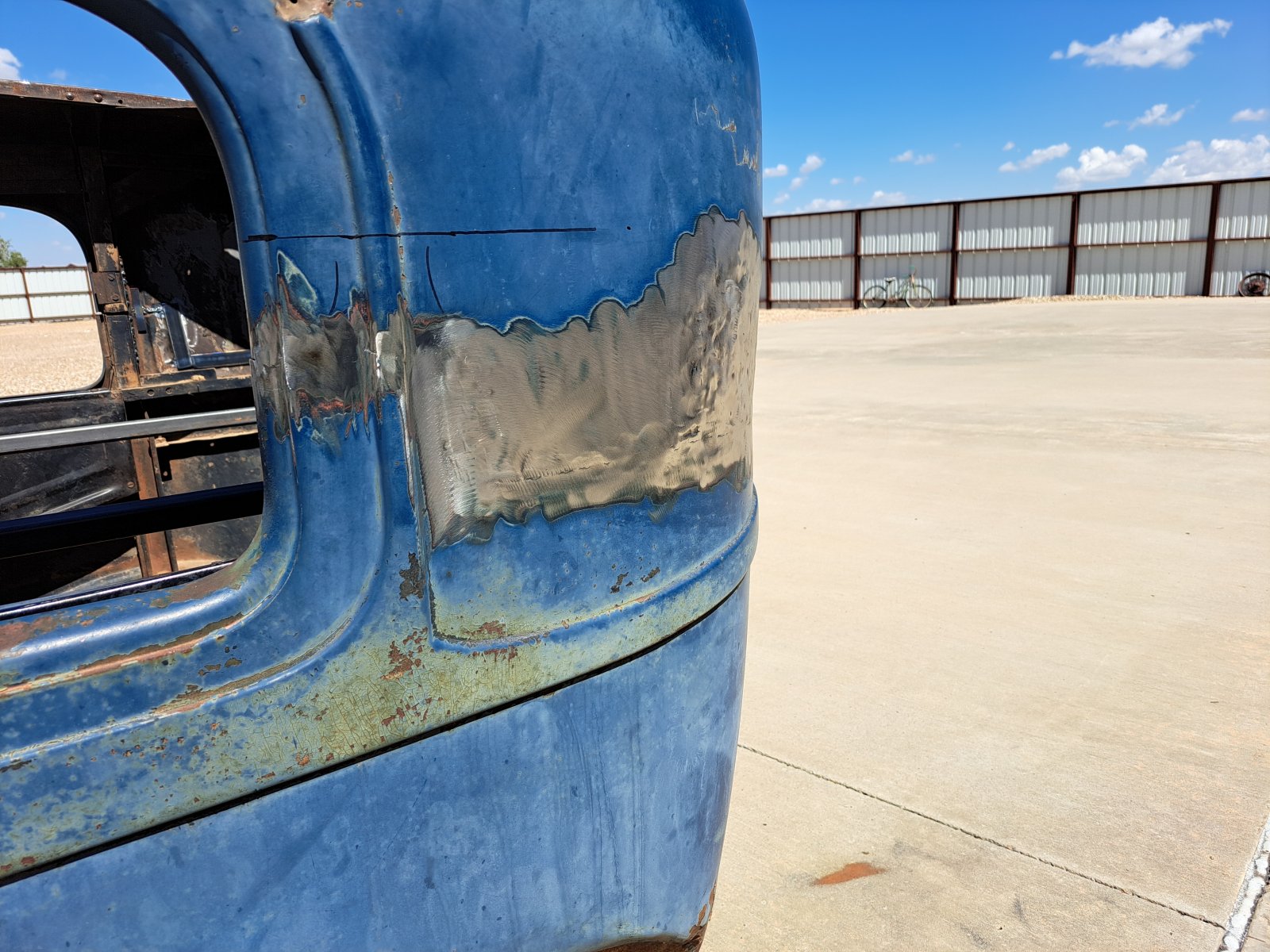

    Making real progress on the metal work, here's a peak at the driver's rear corner:

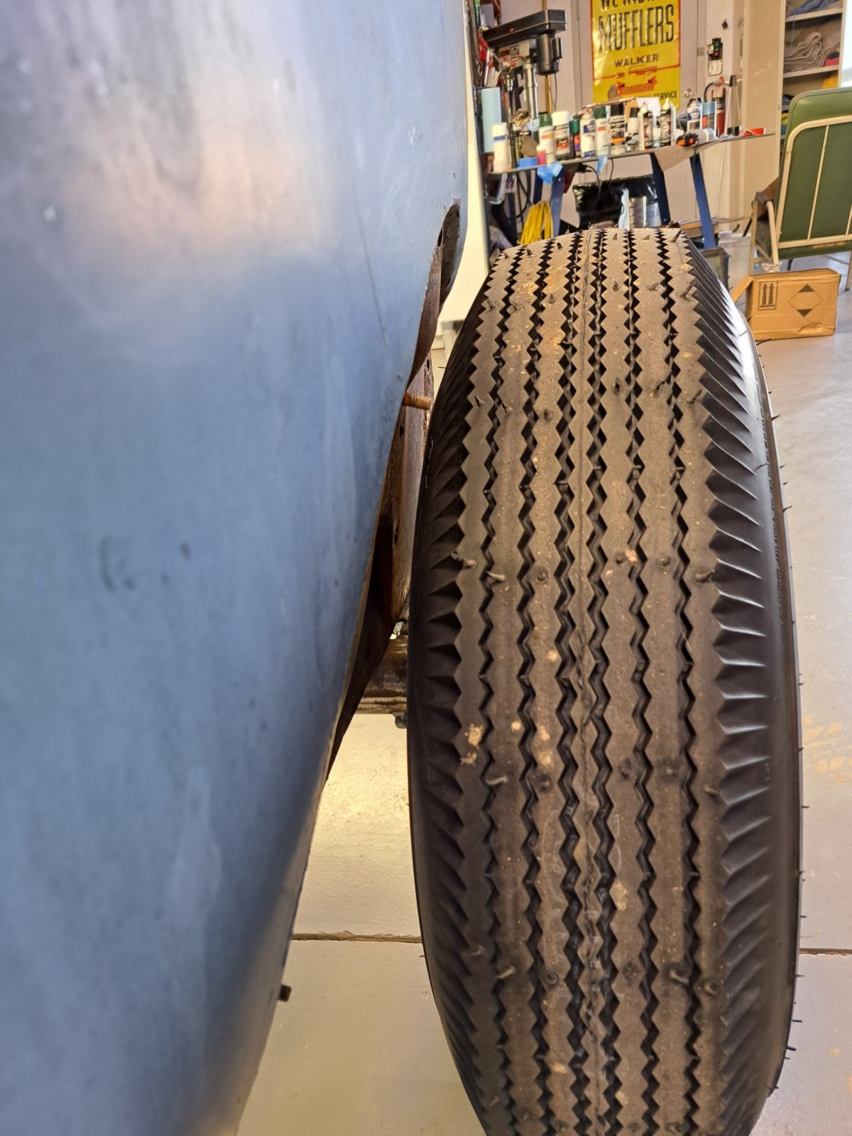

    And got the 5.60-15 tires for the front mounted. I like the size, and the exaggerated profile compared to the rear, but the offset of the front rims is taking some getting used to. That's a lot of brake drum exposed. Wheel Vintiques only sells this offset when you go with 15x5 wheels. Most their offerings are wider.
    Chime in with your thoughts, I'd love to hear them.

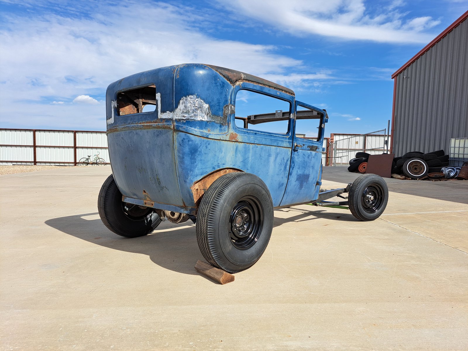

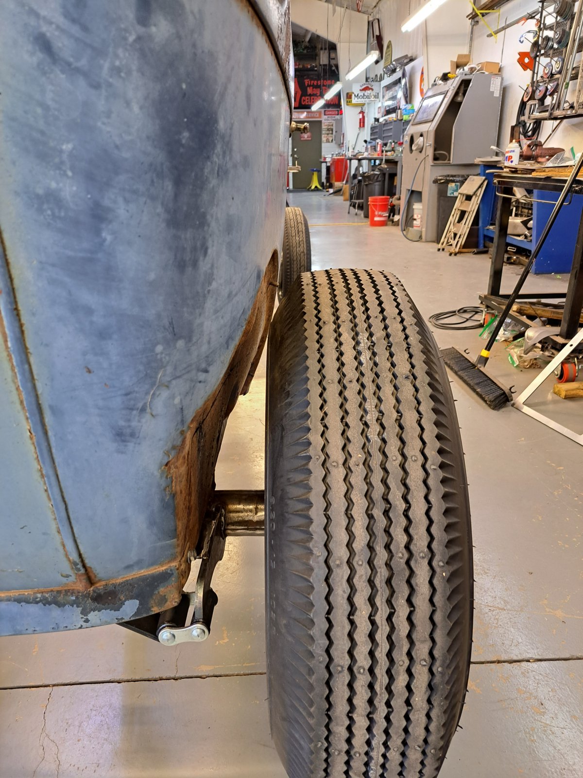

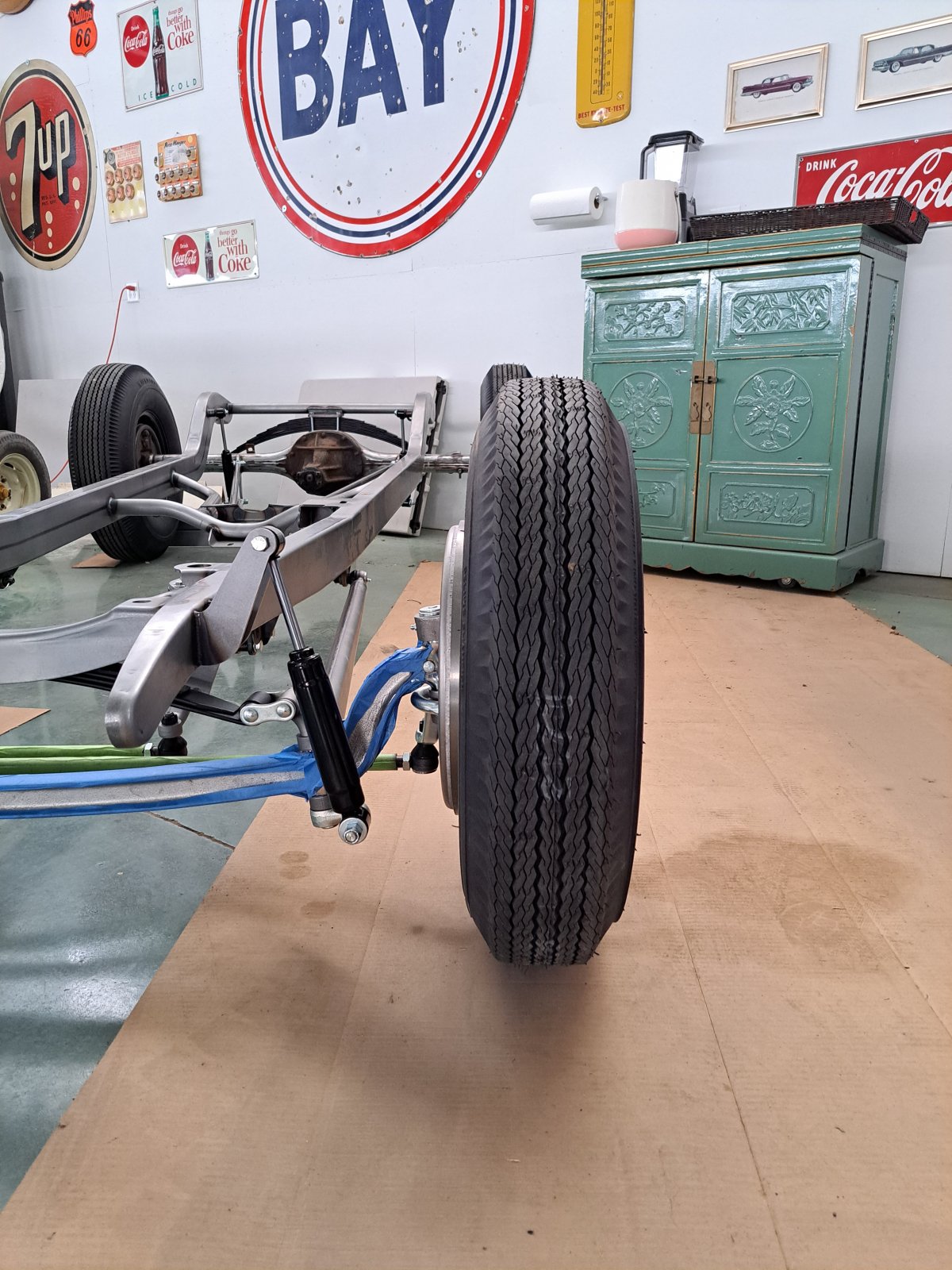

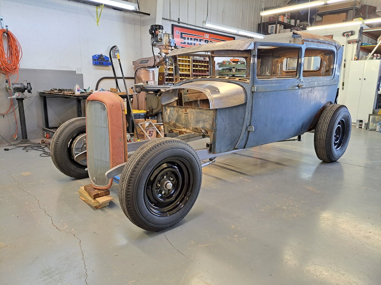

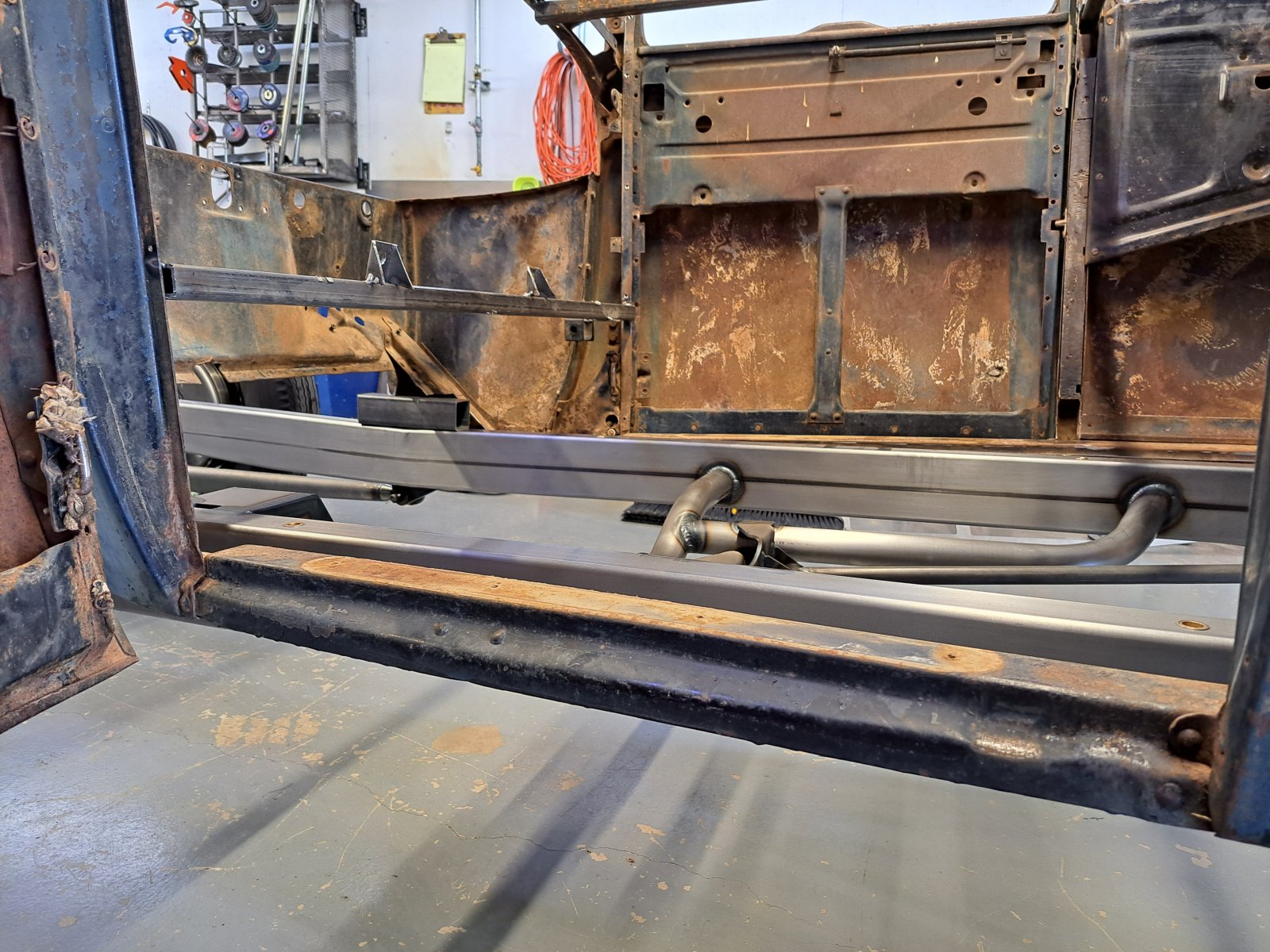

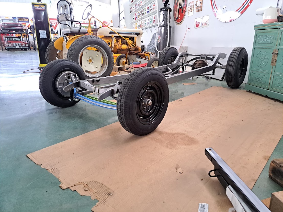

    I then got the ch***is from storage and started doing some mockup. I soon ran into a few "issues".
    What's the issue? Well, that's about 2.5" above where the channeled subfloor is designed to put it. What's hanging me up?
    Yep, despite having a 60" WMS axle and the most negative offset rims I could find, I'm still going to rub if I drop it the additional 2.5". I also would have the wheel arch lower than the tire: 20220930_155146.jpg
    So, I decided to take the advice of Flathead Freddie in post 92: let the car build itself.
    I look at that profile and I see how well the wheel arch frames the back tire, I also see how the fit to the body at that height is also just enough that I can m***age the inner sheetmetal to give a little more room for suspension sway.
    And then:
    This also means that the floor will be essentially flush with the door openings! Won't need the step up panels that a channeled car usually would!
    Obviously I'll need to modify the Boling Brother's subfloor panels or make my own. Body mounts will be somewhat time consuming, but the advantage is that it looks way cool!
    Can't fully install that upper cowl panel until the bracing is removed, but you get the idea. I wanted to use the 32 Grill I've had for years, but I feel like it would need to be sectioned to get the proportions right, and I hate to cut original and rare parts like that... Might see what a chopped 28-29 grill surround looks like.
    Engine and trans get bolted in tomorrow, so I'll have some more pics then. Thanks for stopping by!

    That's perrrrfect. The wheel arch is an important body line... I feel like a lot of fenderless cars kinda forget it's there.
    Not trying to build your car for you, but my 2c... when I go to car shows it seems like every hot rod there has a 32 grille. I know why that's a thing, but I don't wanna be every other car, I can tell you don't either.

    X2 with what @trevorsworth said. Try the A shell! Looks great channeled 1/2 the depth of the frame, too!

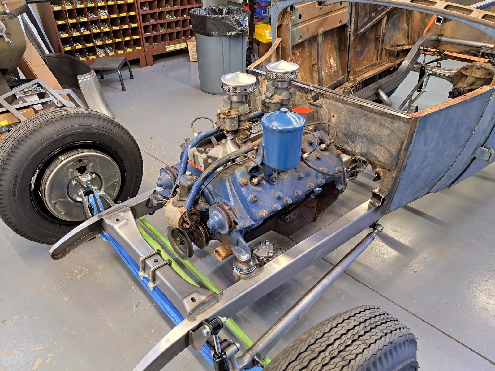

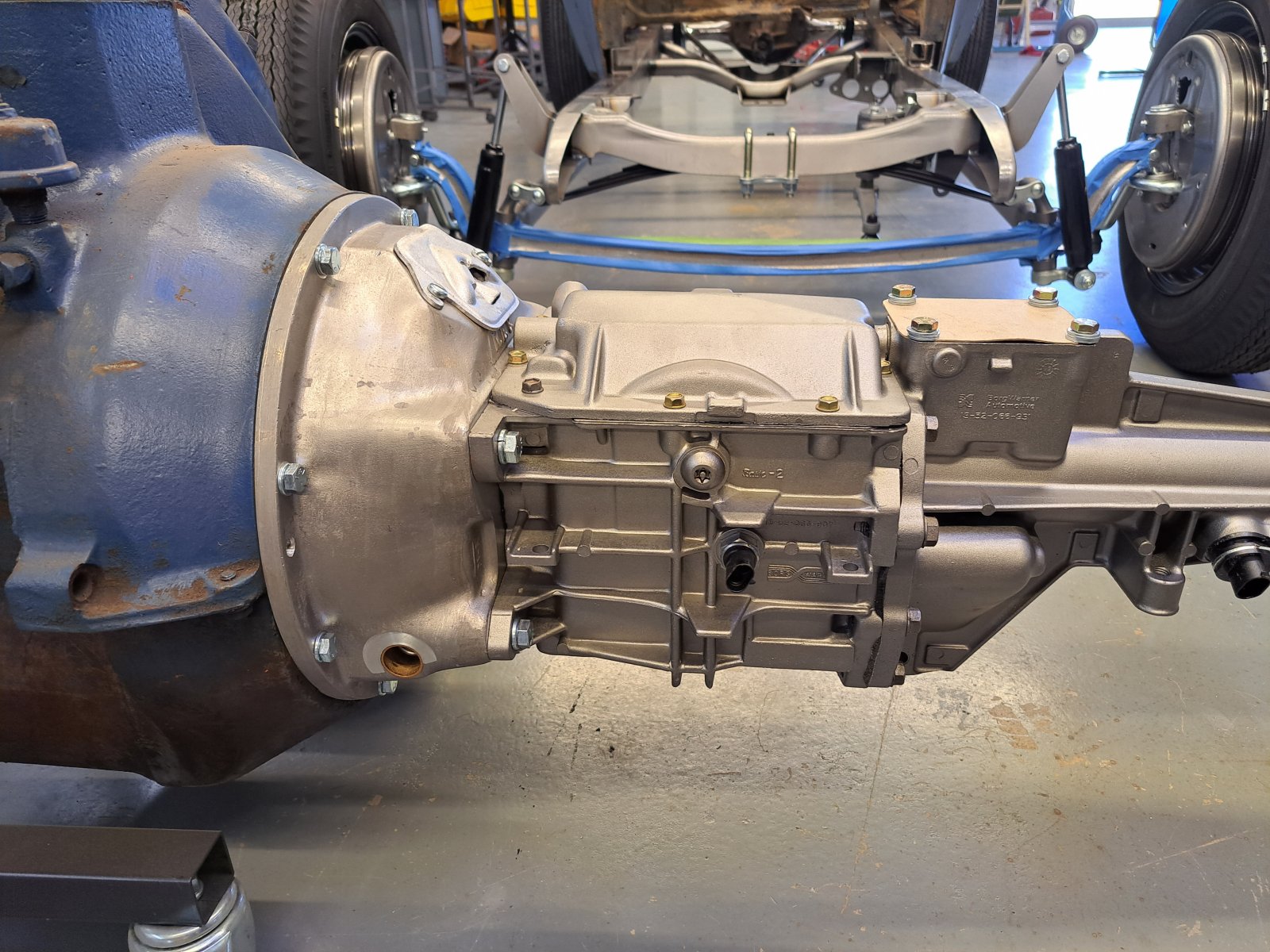

    Got busy with another project so didn't get quite as far as I planned. I did get the lower ear cutoff the Tremec T5 that typically hangs down and looks funny.
    20221001_170404.jpg 20221001_170410.jpg 20221001_170414.jpg 20221001_170419.jpg
    This is using the Cornhusker's Rod & Custom adapter kit. They also supplied the rebuild transmission as well.
    Yes, my mock-up engine is another 1940 Ford Flathead. This one came out of a lifelong friend's '40 Ford Coupe and identical to mine in every critical dimension, so it will be an excellent (albeit heavy) mockup tool.
    Only complaint so far with the Cornhusker kit is that the lower right bolt is just a little too tight to the cast gusset for a socket or closed end wrench to fit over. Had to do it 1/4 turn at a time with an open end 9/16.
    I'll probably replace these bolts with grade 8 hex head sockets or ****on head bolts once I'm ***embling for real. That would help with that clearance issue.
    Engine and trans get bolted in tomorrow and then I can decide some critical issues like rake and body height.

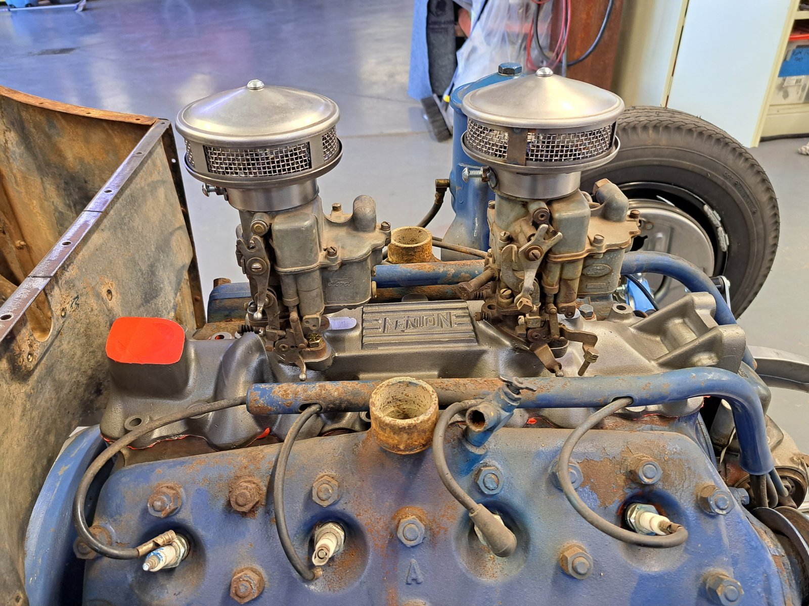

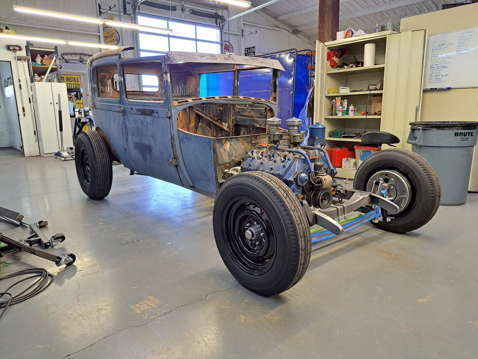

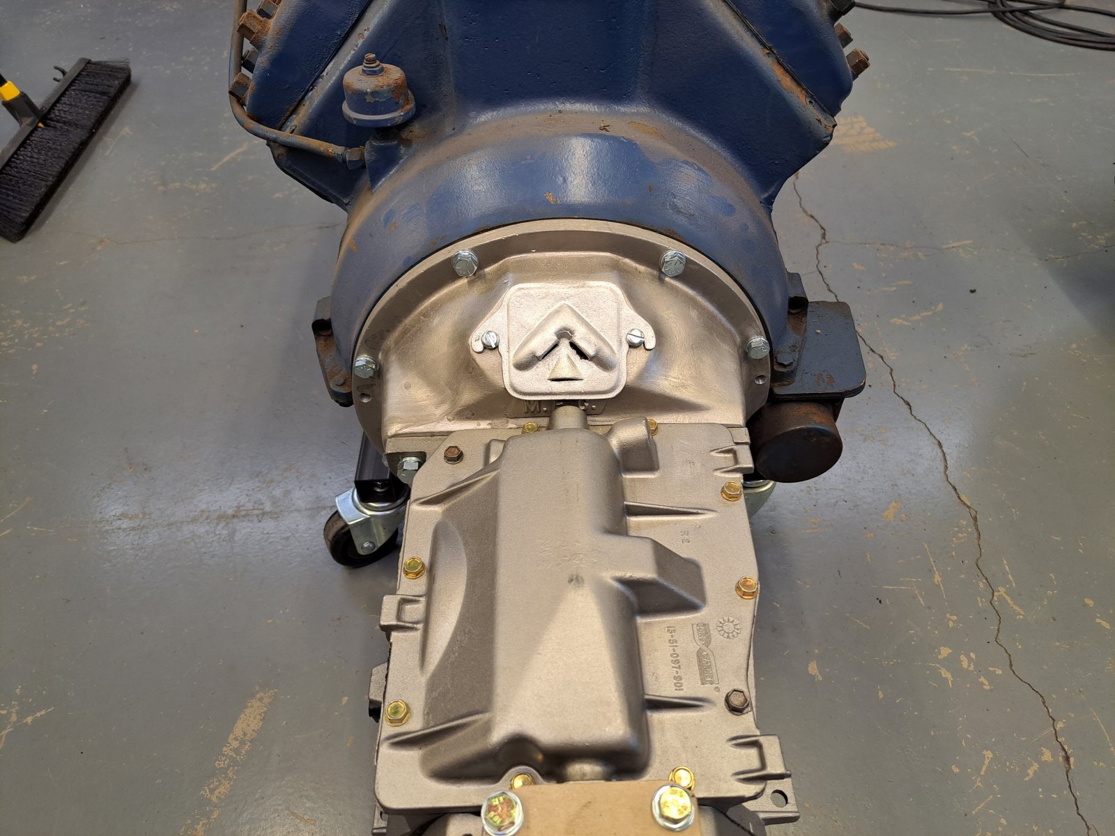

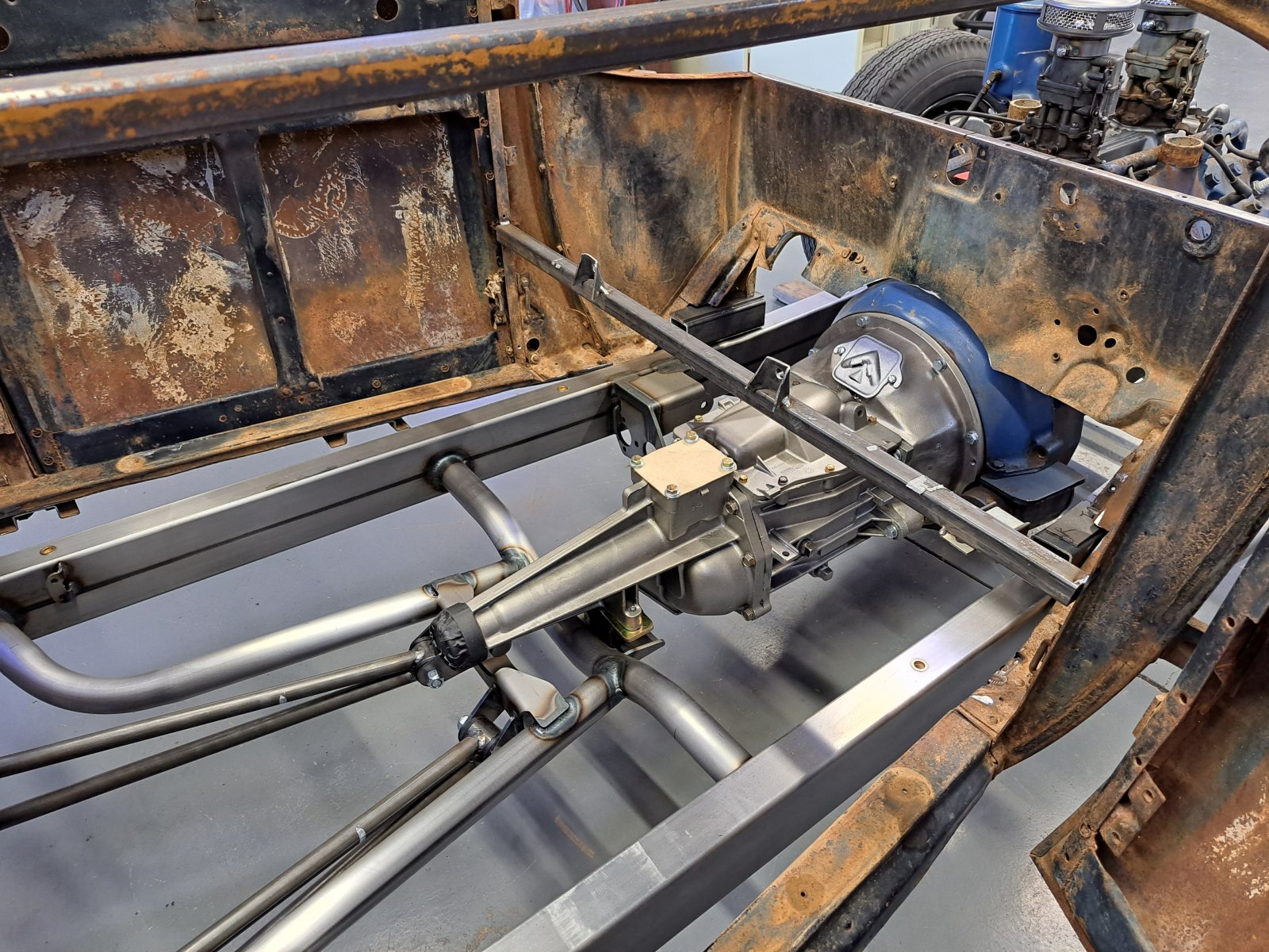

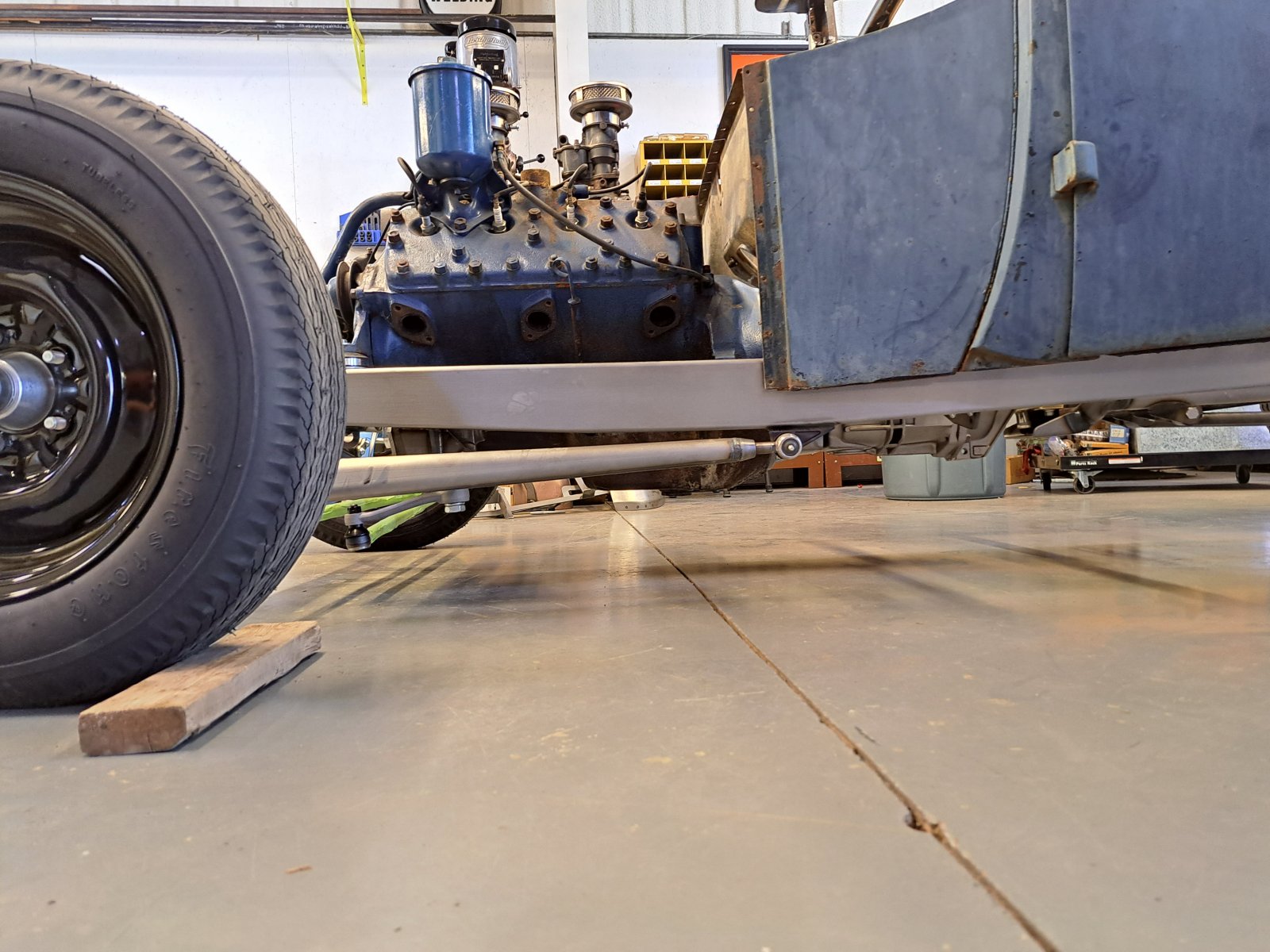

    Got the engine and T5 installed today, clearanced the firewall just enough without going crazy. 20221002_151903.jpg
    Note this has the double pulley off the crankshaft so I can run a fan off that forward drive while the water pump belt powers the generator. I'll be figuring out all that mounting in the near future.
    For now I am using a pair of Ford carburetors but I'll be doing genuine Strombergs on the finished motor. Grace & Co air cleaners help the vintage look and also will easily fit under the hood. (I'll be running a one-piece hood top only, no sides.)
    20221002_162209.jpg 20221002_162220.jpg original_37c5be62-87eb-431f-a9cc-4e738251c678_20221002_162240.jpg
    I was rummaging through some old boxes of flathead and model A parts from like 15yrs ago looking for some carburetors and found some treasure! Appear to be original Edelbrock Heads that only have a few issues to address. Looks like one cylinder must've had a head gasket failure and then water sat in the cylinder? What do you guys think on it's usability? I think my machine shop can mill the heads and maybe flycut the domes to get rid of that corrosion? Or is that even an issue?
    Better pics and more progress tomorrow.
