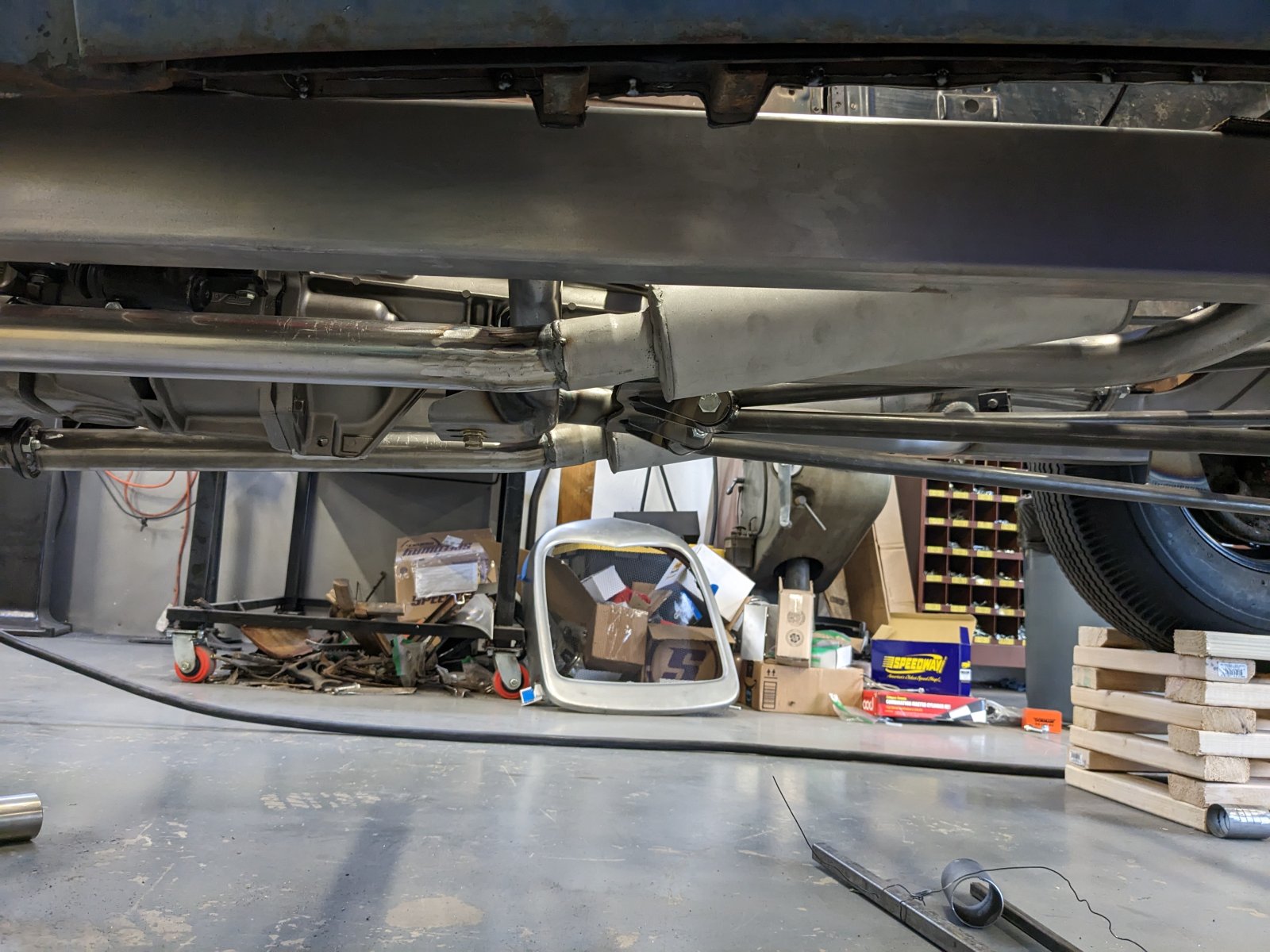

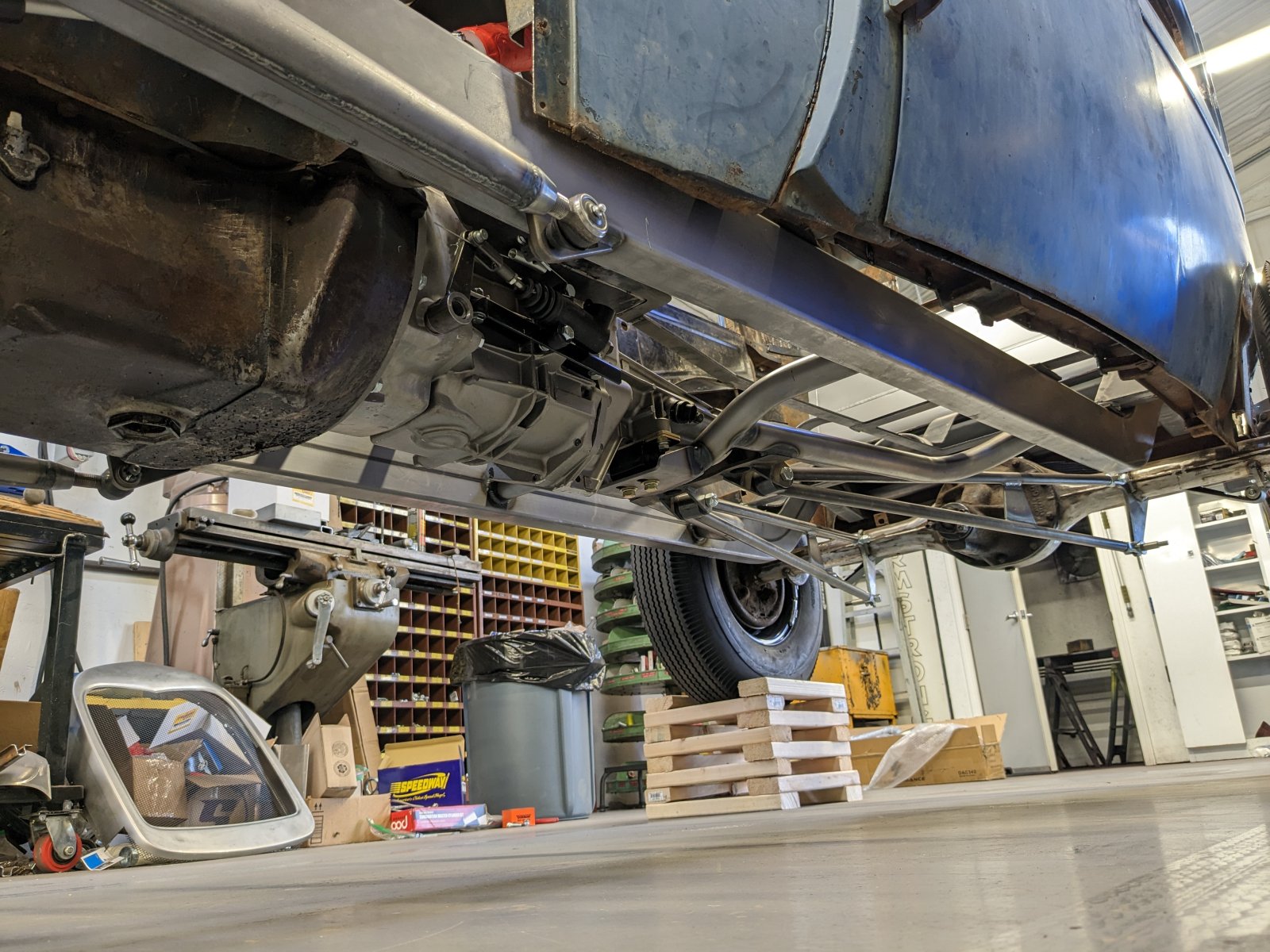

  2. caprockfabshop
    Joined: Dec 5, 2019
    Posts: 698
    caprockfabshop

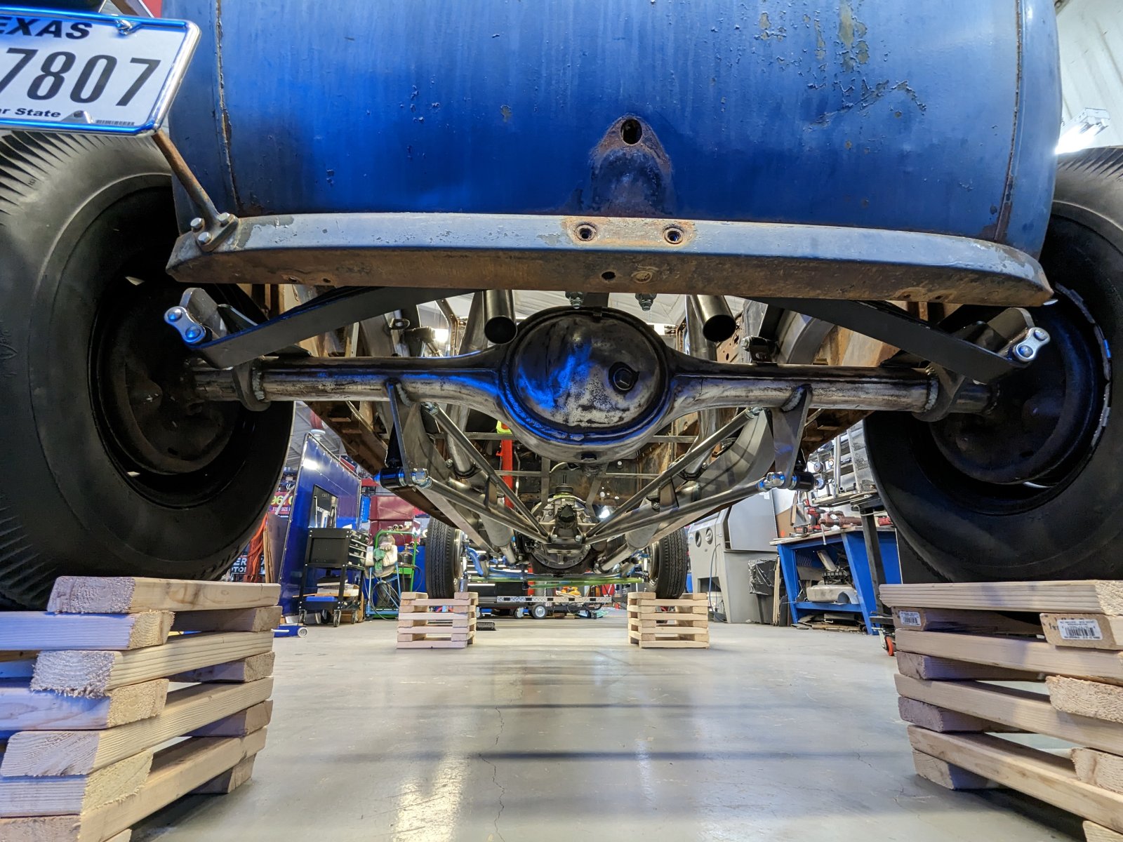

    Picked up a pair of the Shorty 2" Porter Mufflers, forgot to use the alliance discount, :confused: I don't mind supporting good folks though.
    Then it was on to getting the exhaust as high as possible without infringing on floor pans.
    PXL_20230115_181852732.jpg PXL_20230115_181945611.jpg PXL_20230115_190435458.jpg PXL_20230115_190441905.jpg PXL_20230115_190451817.jpg
    I don't have a exhaust tubing mandrel bender, and all my exhaust pipes had either 45° or 90° angles, so in order to get the angles I needed I had to do some pie cuts and weld them up.
    PXL_20230113_193820851.jpg PXL_20230113_193825619.jpg PXL_20230113_193832157.jpg
    ^The lowest point is that forward edge of the mufflers, and it's 7.75" off the ground at ride height, which I'm sure is far more than most hot rods out there. I'm not too worried about ground clearance.
    Now for the tricky transition over the axle.
    ~Peter
    shortypu, brEad, rgrhoward and 3 others like this.

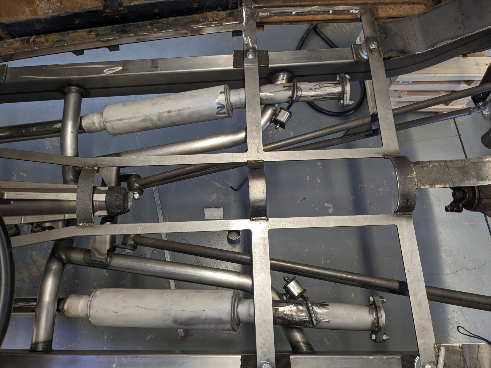

  4. caprockfabshop
    Joined: Dec 5, 2019
    Posts: 698
    caprockfabshop
    I went over the axle after all:
    PXL_20230116_220911717.jpg PXL_20230116_220919576.jpg PXL_20230116_220931104.jpg PXL_20230116_220937873.jpg PXL_20230116_220950514.jpg
    I'd like to do a transition to straight out the back like Gary posted, but that would make the rear section too long to wiggle out without dropping the rear axle or raising the body. So for now it will remain with the hidden turndowns.
    I then got it all installed on the run stand:
    Of course, I got y'all a video:
    The audio is really close in the video vs real life. It's a similar to most of the 50's Mopars I work on in decibel levels. Much deeper and richer tones than some 1949-50 Ford flatheads I've worked on, but I imagine that's due to the 2" pipe and Porter Mufflers since all those other Fords got Smitty Mufflers.
    ~Peter
    Sprout, Stogy, jaracer and 7 others like this.

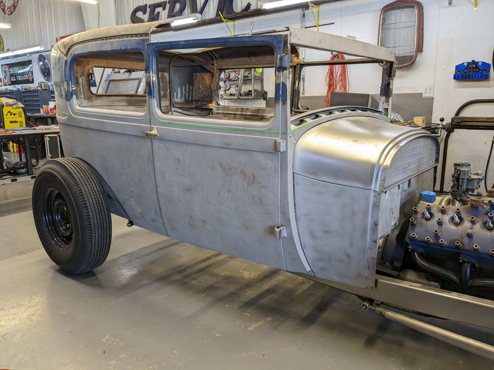

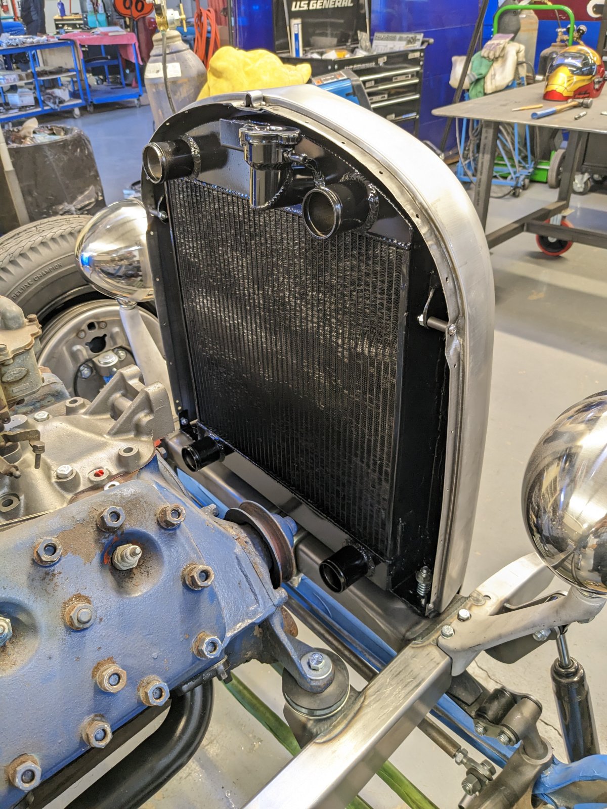

    Finally back on the A, got some studs welded in the grill shell for mounting the inner screen:
    Then got brackets fabricated for the shell to bolt to the radiator:
    PXL_20230218_202442481.jpg PXL_20230218_202449253.jpg PXL_20230218_202458793.jpg
    I'll build some better looking spacer plates for the upper mounts when this comes apart for paint. For now I'm using roll-pins... :confused:
    And just to prove that it's an optical illusion, the grill shell IS over 1" lower than the cowl:

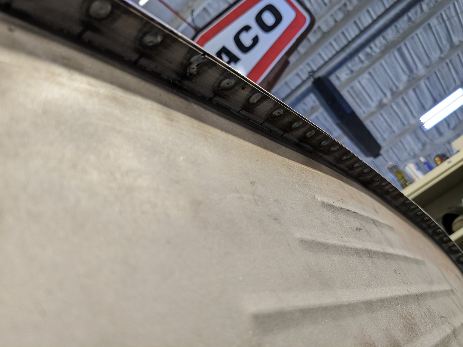

    Then I moved to spot welding in the Brookville upper firewall to their smooth cowl top. This allows me to slide it in from the front and bolt into the factory lip of the cowl side panels under the dash.
    PXL_20230218_210613156.jpg PXL_20230218_210619794.jpg PXL_20230218_210634602.jpg PXL_20230218_210644791.jpg
    ^I'm going to fix that overhang of the cowl, I guess Brookville supplies them long just in case. And I'm very happy with the alignment of the new panel to that stock vertical line shown above, it's plenty for a mid-50's style hot rod! :D

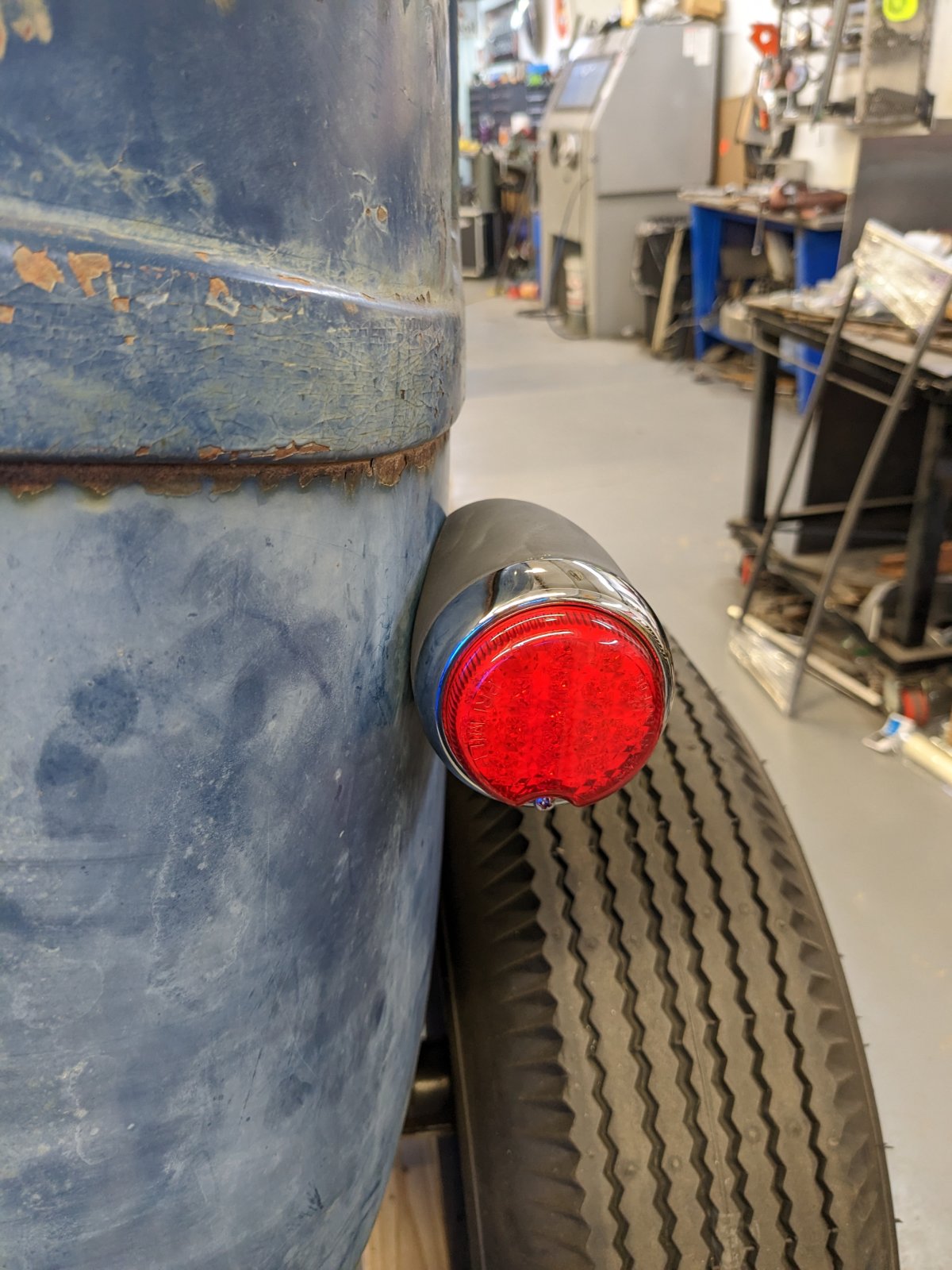

  9. caprockfabshop
    Joined: Dec 5, 2019
    Posts: 698
    caprockfabshop
    Installed the 39 Chevrolet Taillights:
    PXL_20230226_173425102.jpg PXL_20230226_173430936.jpg PXL_20230226_173439073.jpg PXL_20230226_173445946.jpg PXL_20230226_173458859.jpg PXL_20230226_173512129.jpg
    Really amazed at how well the curvature matched the body, required no metalwork at all to get bolted on and clocked at the right angle. Hopefully once everything is painted one color they'll just vanish and appear stock.
    Then got everything stripped out of the interior so I can media-blast the body at last. I need to get into all the nooks and crannies, and since tomorrow is looking to be a calm day (finally!), I'll be lifting off the body and taking it outside for the cleaning. Not sure how far I'll take it, but for sure all the interior panels and lower areas where the floor needs filling.
    ~Peter
    Shadow Creek, Stogy, Tim and 8 others like this.

  11. nunattax
    Joined: Jan 10, 2011
    Posts: 3,391
    nunattax
    nice lights and placement too. i feel having the light s far apart gives you more presence on the road at night .fit led s too c
    Stogy and caprockfabshop like this.
  12. ModelAMitch
    Joined: Jul 8, 2022
    Posts: 295
    ModelAMitch
    Those tail lights look great, they fit the body perfectly. Will they get painted body colour?
    Stogy likes this.

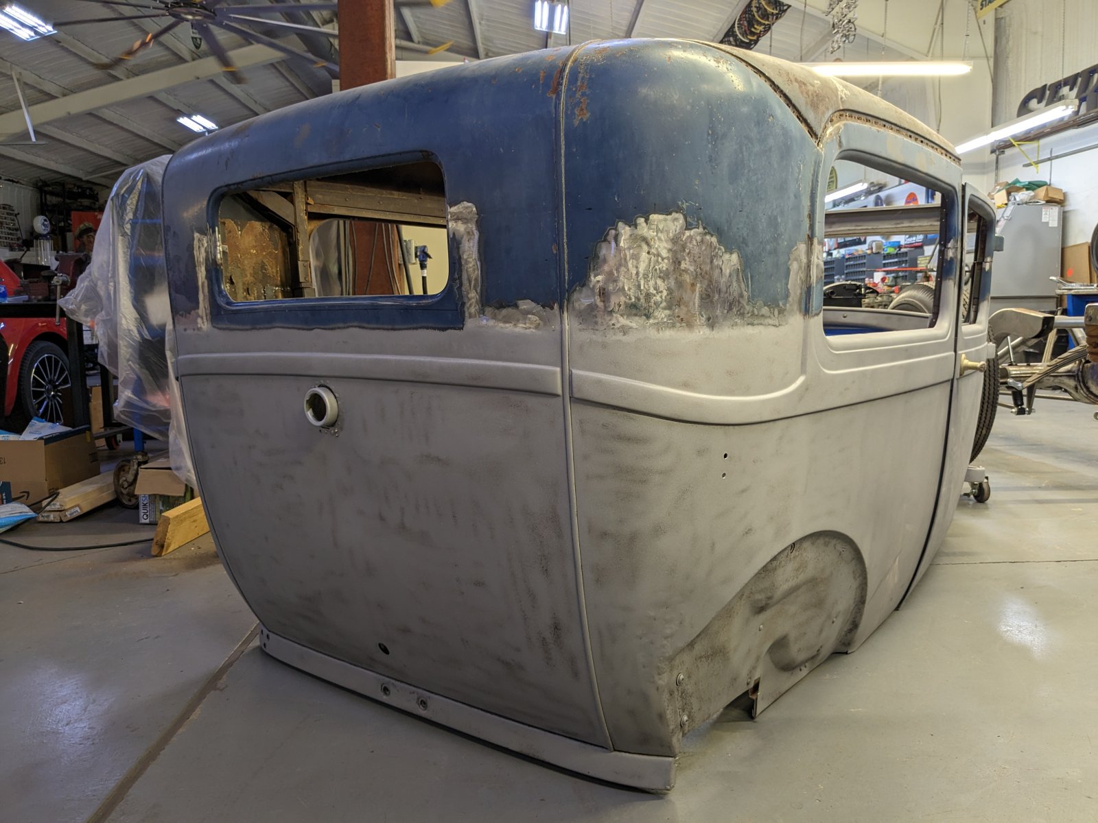

  13. caprockfabshop
    Joined: Dec 5, 2019
    Posts: 698
    caprockfabshop

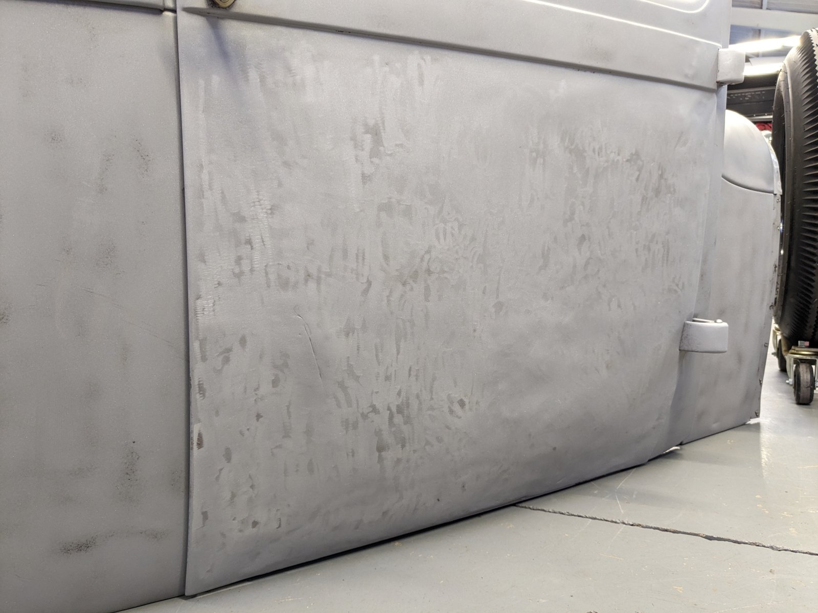

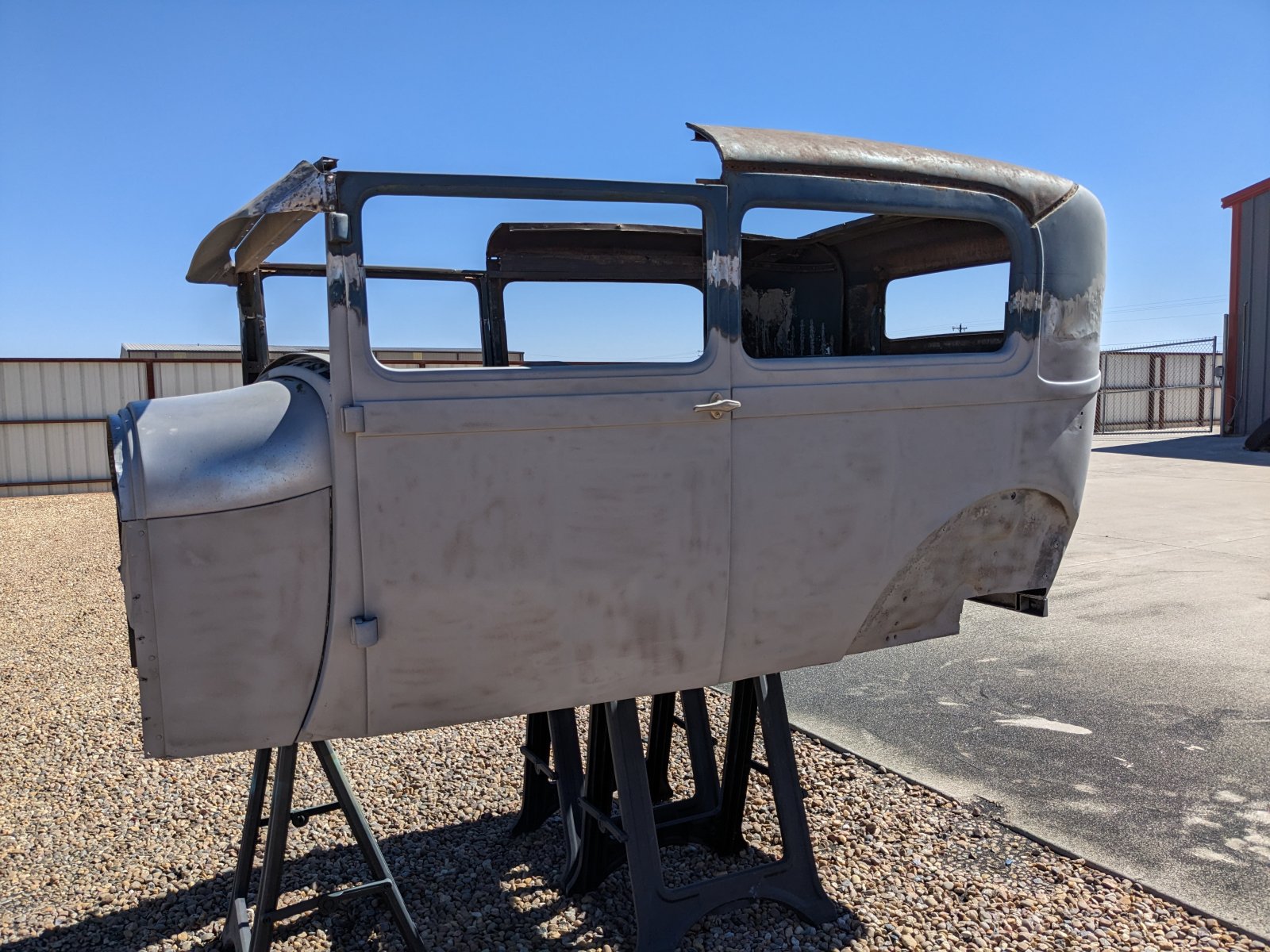

    Started out by getting it up on sawhorses and media blasting the rockers and underside:
    PXL_20230303_185747913.jpg PXL_20230303_185802081.jpg PXL_20230303_185812202.jpg
    Only ran into one problem area, the P***enger door had previous damage that was hammered back and then skimmed with 1/4" of filler across the entire door:
    80grit flap disc took it all off without issues.
    Then media blasted until I ran out of daylight. Here's 370lbs of Coal Slag later:
    PXL_20230304_005706502.jpg PXL_20230304_005716557.jpg PXL_20230304_005726749.jpg PXL_20230304_005739691.jpg PXL_20230304_005751355.jpg
    As you can see, the damage doesn't really seem that bad once you get all that bondo off! Couple of areas I need to shrink to get rid of some beer-canning, and some hammer/dolly time for the rest of the bumps.
    PXL_20230304_005806541.jpg PXL_20230304_005847986.jpg PXL_20230304_005853401.jpg
    Only other small area is that P***enger rear that also has been previously repaired. That's a bit more manageable and easier to hide vs a doorskin.
    So it sits in disarray for tonight until I get back on it tomorrow:
    ~Peter
    Stogy, anothercarguy, Tim and 12 others like this.

  16. That door skin is crazy but not unusual. Pretty normal for a "restored" Model A. We ran across more than one like that at the shop. Many of these were built by those old Model A fogies that used to ***** about hot rodders "wrecking" Model A's!!!!
    I have seen "repairs" done with galvanized tin, window screen, socks, spray foam and of course lots of old pink ****py Bondo. The stuff you could buy at Kmart in the Auto Dept.
    Just Gary, Stogy, Tim and 1 other person like this.

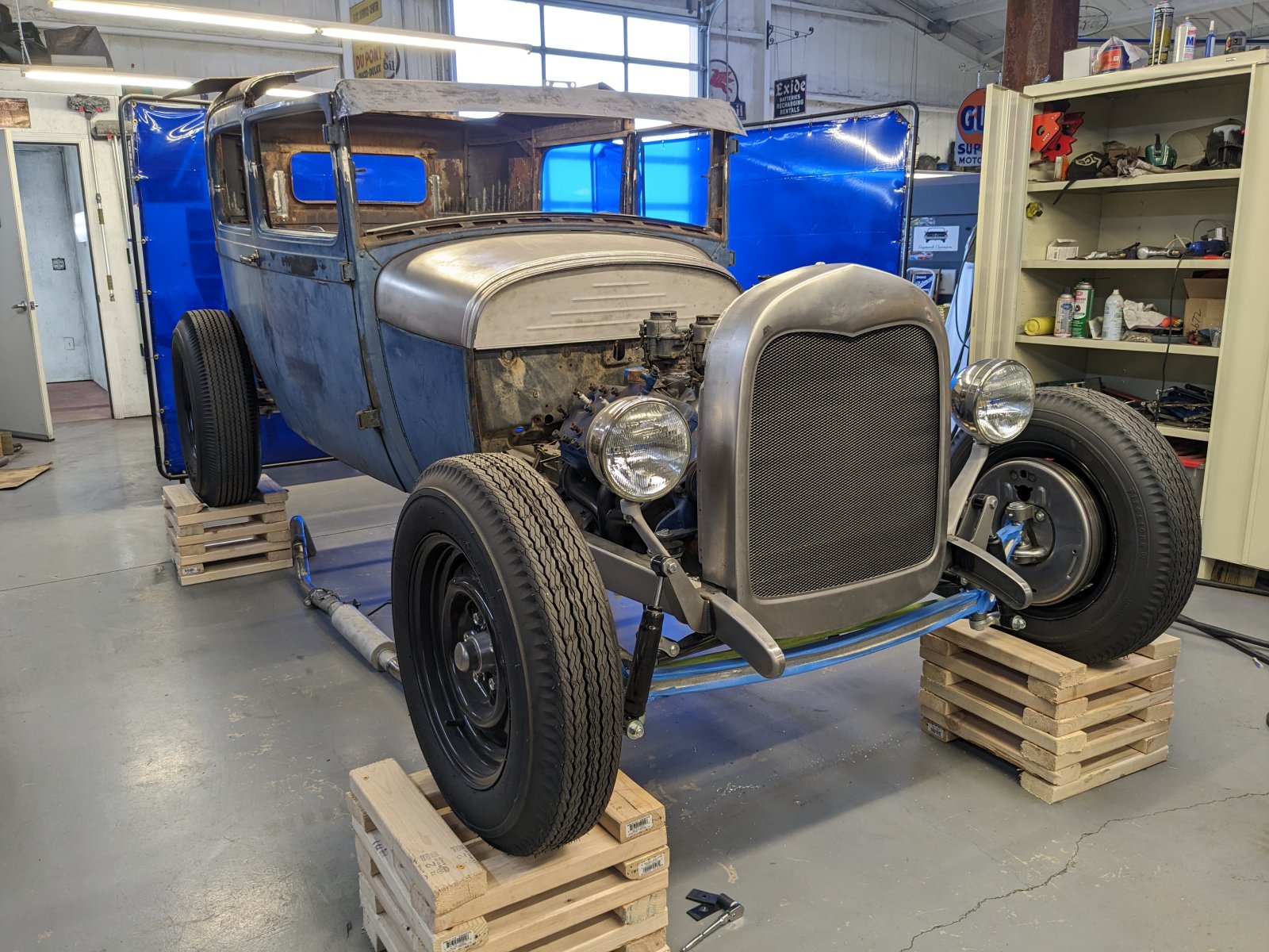

    Let me start by saying, I know this is gonna rub some the wrong way, and while I appreciate constructive input, if you have a problem, then just close the page and find something else.

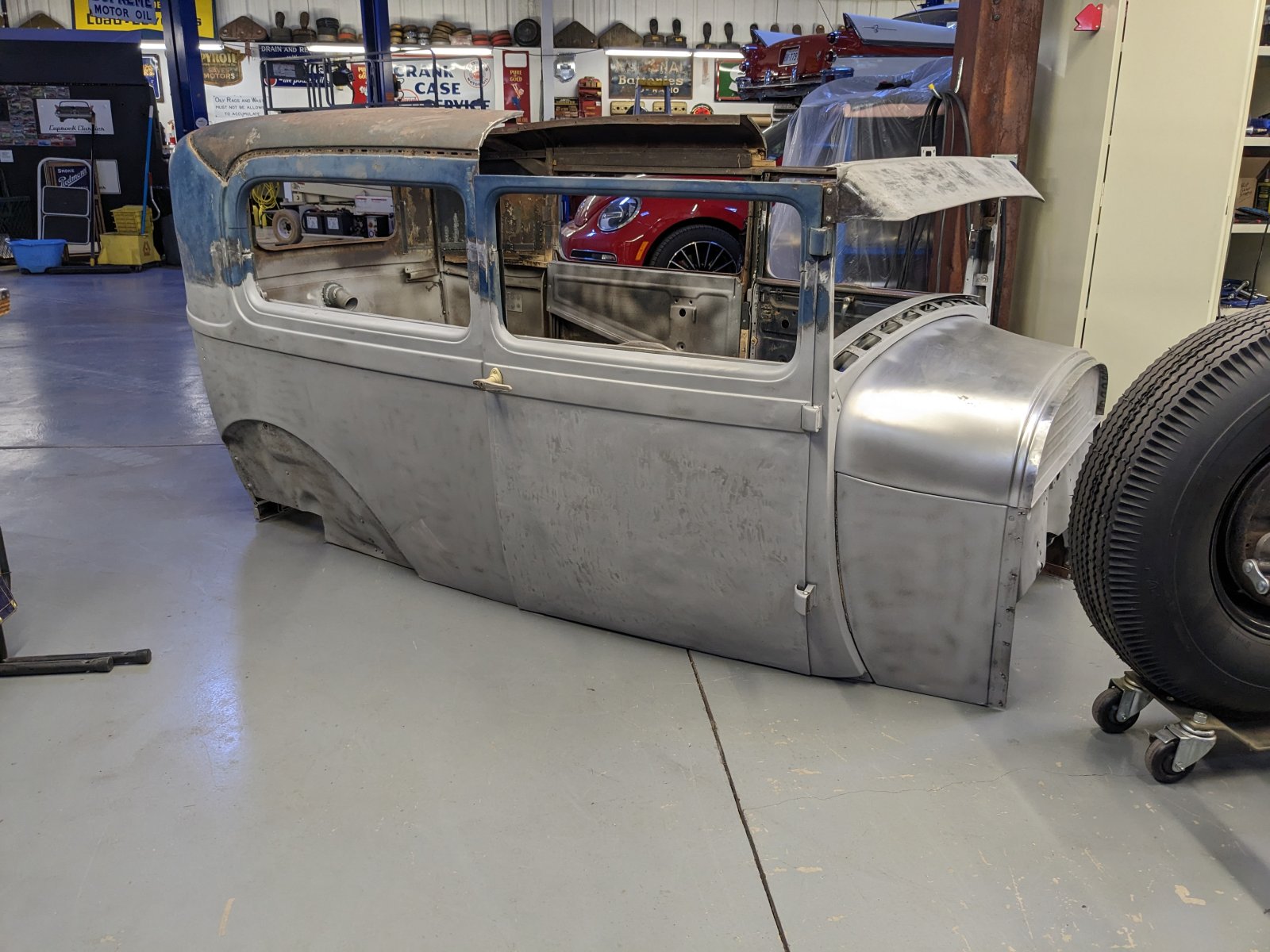

    So I decided to chop the top off.
    Let me start with my rational:
    1: I felt it was ridiculous to spend countless hours of my time bodyworking, woodworking, and upholstering the stock roof of this car, only to be left with something that was still noisy, drafty, and rattle-prone. If I'm going to have an open car experience, why not have an open car experience?
    2: There was significant damage done in previous impacts to the roof that cracked and twisted many of the upper panels and structures that were giving me headaches trying to get things aligned and fitting the way I wanted.
    3: When I looked everywhere online, I only found 10-12 1928-29 Tudor Phaeton conversions, which makes this car that much more unique and special. They only built 4dr Phaetons in 1928, so once this is completed, I'll be left with a car that will standout at any show, no matter how many Tudor sedans are in attendance.
    4: I hated the bulbous width of the Tudor sedan body. I was considering doing a vertical sectioning of the whole thing, to try and lean in the rear quarters more, but that's crazy for what this build is meant to be.
    So I spent a lot of time browsing the internet, drawing up plans, ordering parts, and then just sitting in the shop staring at things for the past few weeks thinking it over.
    I knew what needed to be done, and I've planned out how to avoid some of the common pitfalls and areas of conflict.

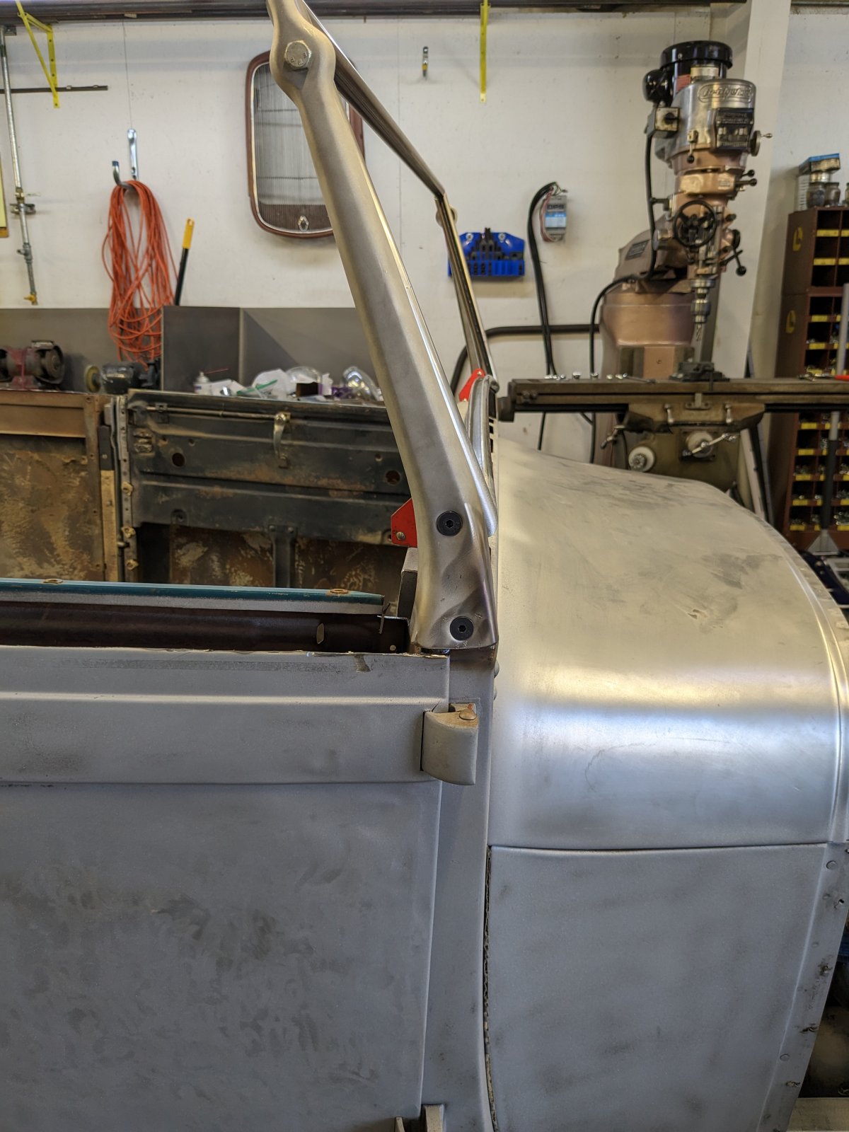

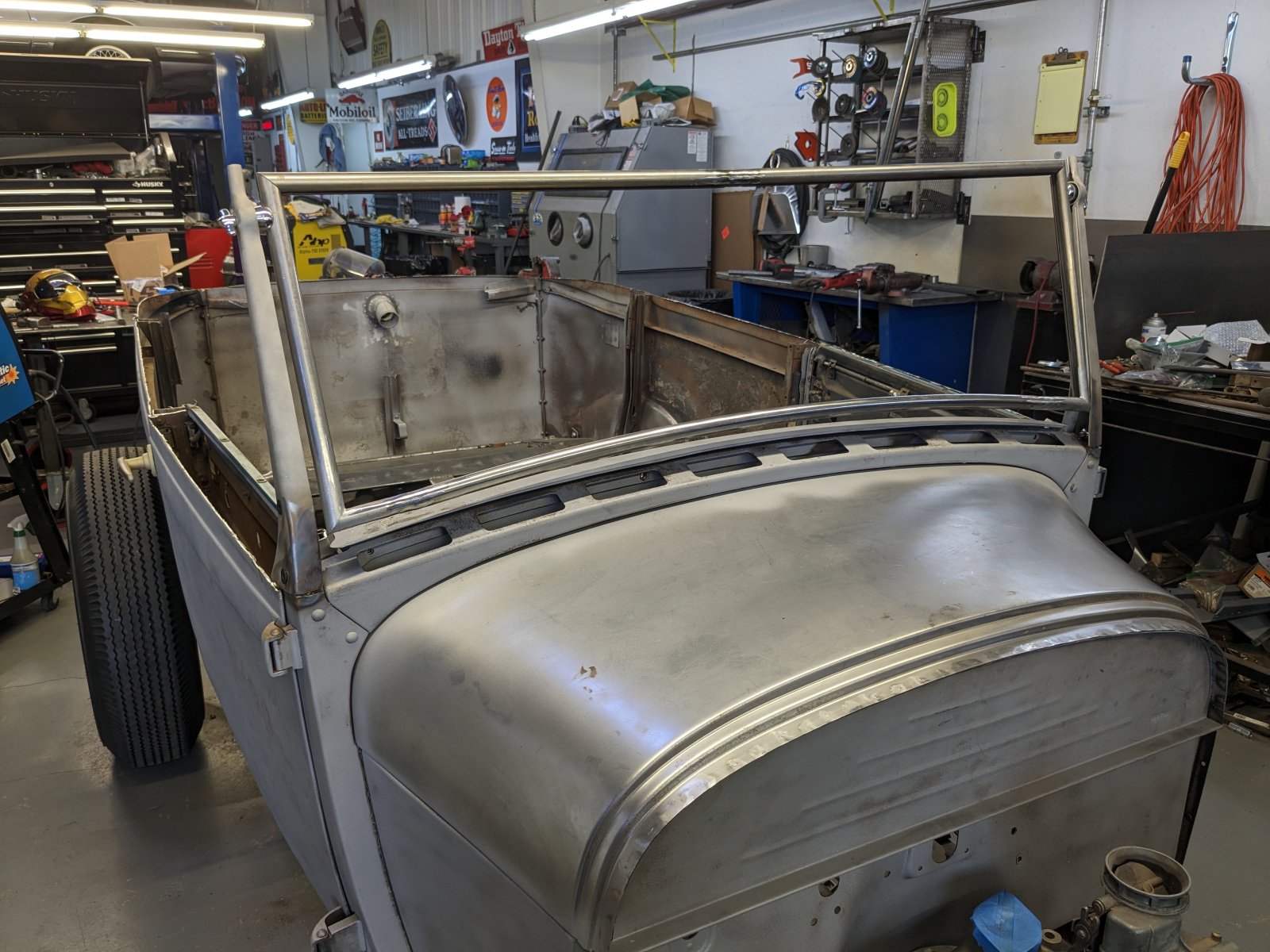

    Rather than use the original A pillar metal like some, I opted to remove and replace with 3/16 steel plate, and these are now the new A pillar bases. I then bolted on new 2" chopped windshield posts, and had to do some initial fitment to get them to look right on the closed car cowl.
    PXL_20230316_181633124.jpg PXL_20230316_181640687.jpg PXL_20230316_181654994.jpg
    Much more work to be done for sure, but luckily they're stainless and easy to work with compared to alloys.
    As you can see, the A pillar posts end up being much wider than the roadster windshield frame, so the frame needs to be widened to match:
    PXL_20230316_204118630.jpg PXL_20230316_204123531.jpg PXL_20230316_204613478.jpg
    The frame is still 2" short so I need to decide if I'm going to be chopping the posts more, of lengthening the frame itself.
    Quite a bit of work to do making the new door tops, and making them look like factory ford pieces.
    The rear quarter-panel beltline is always a problem on these conversions. Most leave it, but I'm going to cut out "dip" and run the horizontal beltline flat all the way around to the rear. Following the green tape line seen here^. This will mimic the same area on a 4dr Phaeton. cp 970.JPG
    I chose to cut it above that major beltline because it allows me to retain stock door locks and keep most of the door and quarterpanel structure. Also, I'm not a fan of the lines on 4drs (like seen above^) where the seat back is higher than the quarter panel. This still could change, and that's why I opted to start high and I can always bring it down to mimic the normal phaeton lines.
    I love it, to hell with the critics, it makes the car look lighter, slimmer, and faster. It also has the added benefit of making for less final paintwork and allows me to spend more time making the virgin lower sheetmetal fit and look perfect.
    So yeah, definitely gonna catch some initial flak, but that's life in the hotseat.

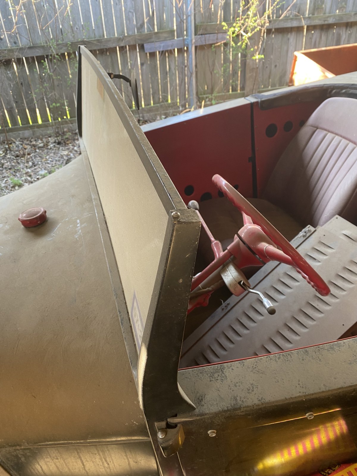

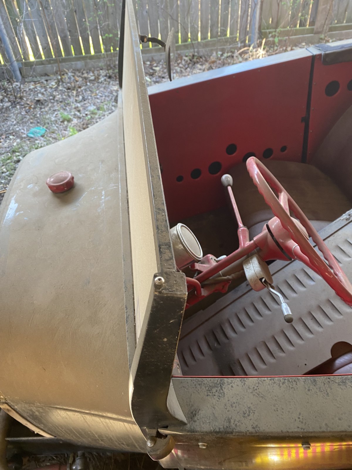

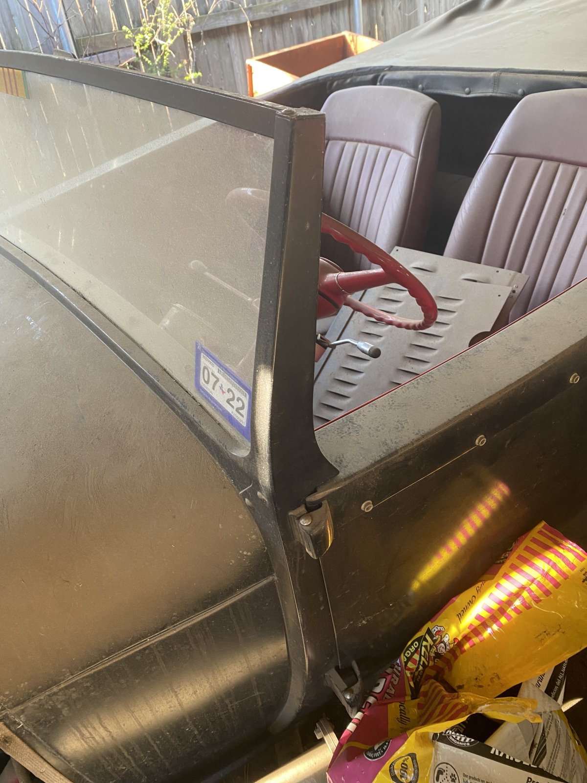

    I like it, but would prefer a lower windshield like that 513 car. You do want that wind in your hair experience, right?
  25. When I saw post 254, I wondered if something was up. The journey continues…
    Outback, Stogy and caprockfabshop like this.
  26. caprockfabshop
    Joined: Dec 5, 2019
    Posts: 698
    caprockfabshop
    Yeah, windshield posts are getting an additional 2" haircut.
    282doorUK and Stogy like this.

    Mine sat upside down and the roof was really rusty so we gave it a hair cut also. Here is some smaller pictures how the windshield was done. Hope this helps you, sorry for all the dust but Lubbock blew thru here the other day and have not had time to clean it up. IMG_6018.jpeg IMG_6017.jpeg IMG_6016.jpeg Frank IMG_1574.JPG

    I dig it, no worries here. This is not the AACA, its the HAMB, we cut stuff up.
