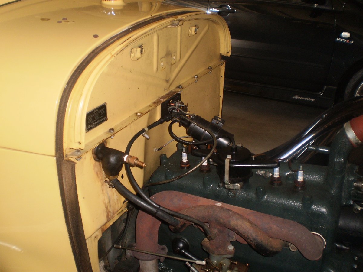

    O.K. here goes. I am not a tank removal expert but it isn't rocket science. First I disconnected battery, drained tank, removed fuel line ect from under tank,took seat base,side trim panels and floorboard out. Removed the dash rail and the column clamp. Fuel tank remove 001.jpg Fuel tank remove 002.jpg
    Remove the instument panel and disconnect the wires and speedo cable. Fuel tank remove 003.jpg
    Moving out undo the rear hood hinge bracket and with someone on the other side lift the rear of the hood slide out of the front hinge and remove. Remove the stay rods. Slide the outer tube up the GAV rod and slide the shaft apart and remove the rod from inside. Fuel tank remove 004.jpg Fuel tank remove 005.jpg
    Remove the cover off the terminal box and slide the wiring and speedo cable out of the tank tunnel. Unbolt the coil, I just layed it on the head.
    My cowl hood lacing is well and truly glued on so I crefully cut it at the cowl/tank line. Fuel tank remove 007.jpg
    Now undo all the bolts, follow your way around the whole tank about every 6 " there is one. Then slowly lift the tank from the front trying not to damage any lacing. I lifted mine 2" or so and sat a block under it and with a small steel rule (whatever is handy) freed the lacing. Fuel tank remove 008.jpg Fuel tank remove 010.jpg
    Then lifted it till the wiring tunel cleared the cowl and out she is. Fuel tank remove 011.jpg
