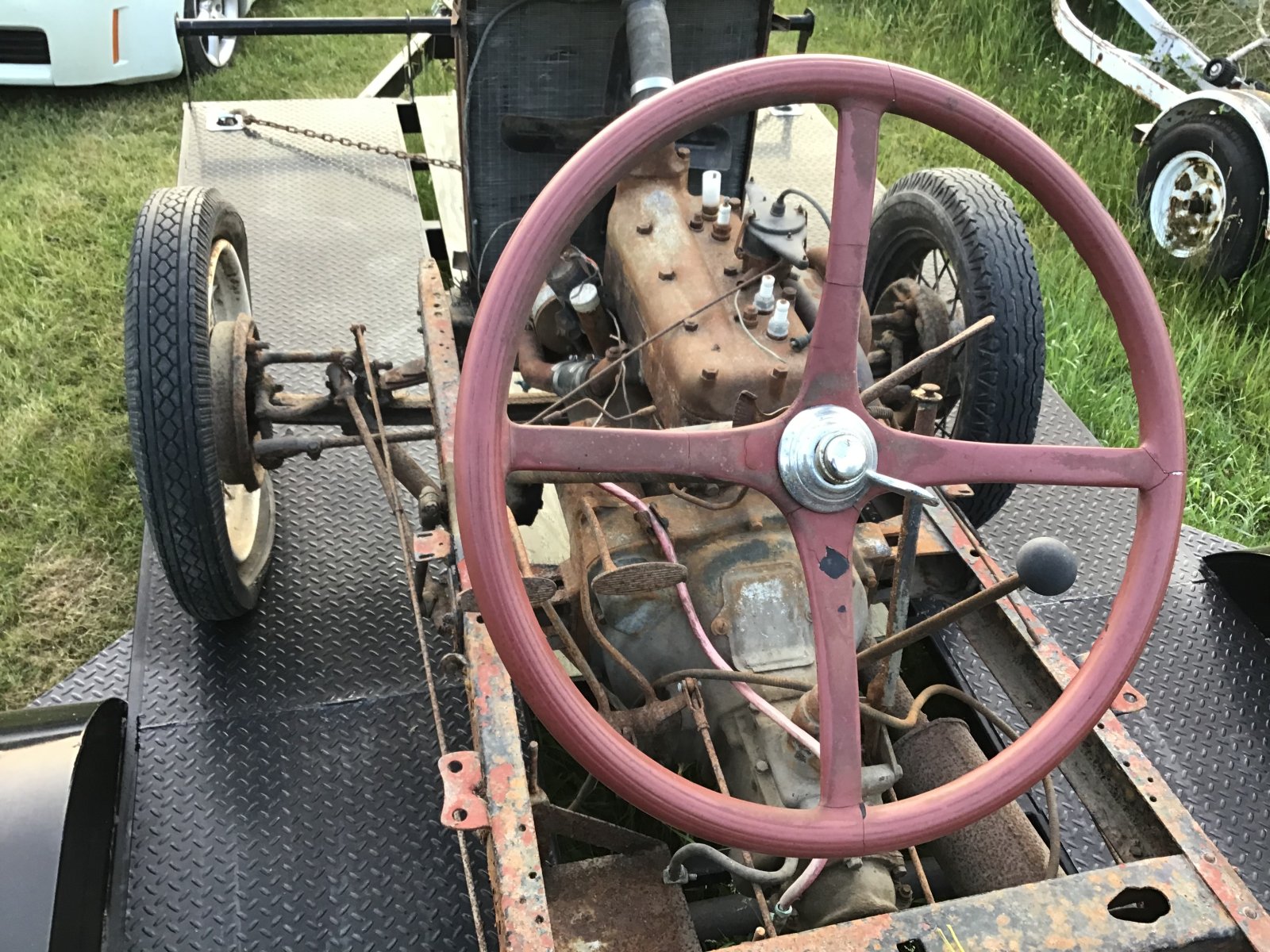

  1. So thanks to the graciousness of a friend I have this early 28 rpu frame, and the truck now on a 30 frame. What is the right thing to do. Is this important to get this in the right hands? It won’t be an immediate project, there are others ahead of it. C67D9587-603D-45BA-9B15-0970B7A69AA7.jpeg

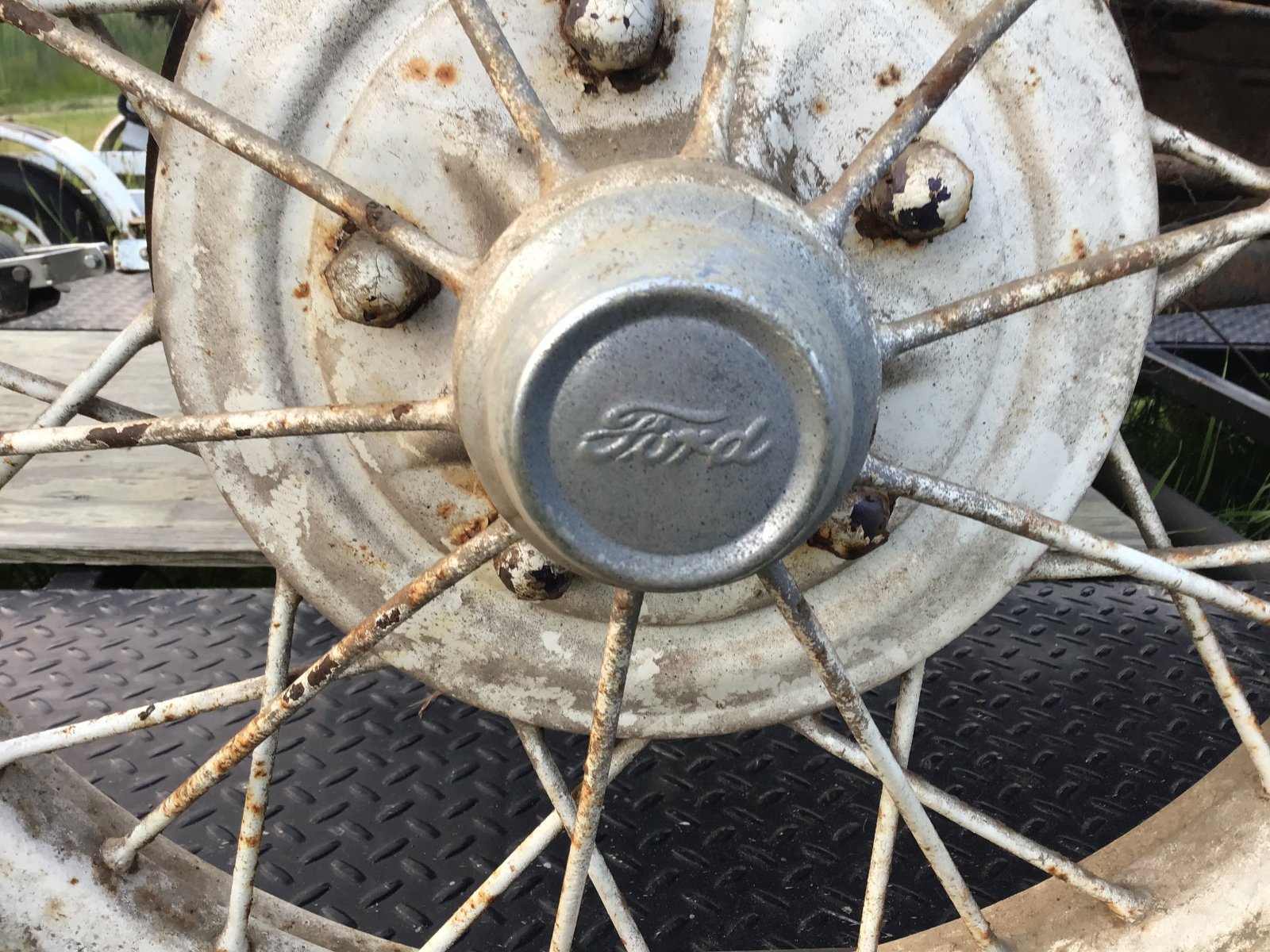

  3. It was running and has the early 28 rims. C3CECE25-2EEF-49E5-ADB8-46DFF44DE8C5.jpeg

  10. I guess it is the least clear part of my model A collection of stuff. I want to know if the early model A frame and red wheel stuff is sacred to restorers and needs to be offered to them, or if I should make a plan to build something else.

  15. There are a lot more subtle differences on an early (AR) frame/running gear than just the red steering wheel. Do some more research to determine what it is and go from there. If it truly is an AR, it's probably best suited to a restoration.

    Model A restorers are becoming fewer and farther between. If there is no ***le, the ch***is is probably worth more in parts. I don’t see a left hand parking brake. I don’t see a powerhouse generator. Does it have an early front crossmember?

    Front crossmember of an early frame has tabs pointing up to direct mount the front of the engine. No separate mount.

    Red steering wheel was discontinued in February 1929, the red wheel pictured might be painted because it looks like a big chip exposing a black wheel. Push ****on emergency brake started in July of 1929. The new style generator started in July 1929. It also has the cast type steering box that was used between September of '28 until March of 1930. The only way you can tell the build date of this mix of parts is with the serial number.
