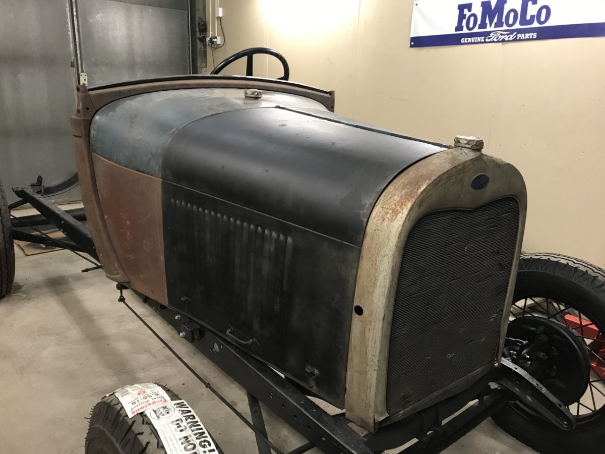

    Got bored so mocked up the hood.
    Maybe I'll paint the whole body to match the hood? Something to think about.

    Long time since the last update but today I swapped out the butchered radiator shell for one that is not.
    And if everything works out as it should a major update is coming tomorrow.
    ClarkH, brEad, OFT and 4 others like this.
