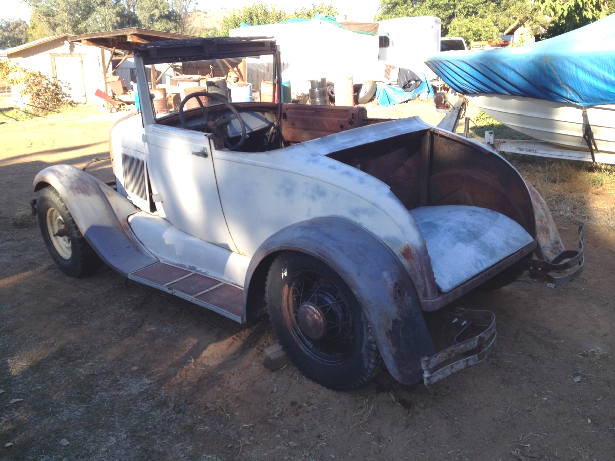

    I'm gathering parts for a build of a roached 1928 Sport Coupe depression-era banger . I'm torn between a full-scale old-school build or leaving it in as-is condition, sans the stock suspension/brakes. Will be using 1939-48 spindles, brake stuff w/ a dropped 4" front axle and split the 'bones. Same with the rear axle, using 1940 Ford backing plates and hardware. What method works best to lower the rear with the stock axle? I know there's a lot of new stuff out there but would prefer some older, used parts; maybe a reversed-eye spring or one with less leaves. Would I need a spreader kit to R&R this? Kinda want to keep it old-school but am open for opinions/suggestions. I also was thinking of lowering the windshield about 2/3rds of stock. The previous owner cut the b door posts. Would I be too crazy to make it look roadster-like by sectioning the doors? Any help is appreciated. I posted a couple of pics as it came off the trailer from Colorado.

    If this is your first big project, I would say do it in bite size pieces. Start with the suspension, get it running, driving, and then worry about the body. That way you don't have a huge overwhelming project that is 100% apart. Looks fun!

    Was the rear of the body hacked to make a pick-up bed? Many of the coupes were to qualify for additional gas rationing during WW2.

    Yes, I'm sure that is the case. My dad was discussing the very same reasoning calling it a Depression car.

    sport coupe, YEAH. the paint color on the firewall looks like the green on my car. keep posting the progress.
