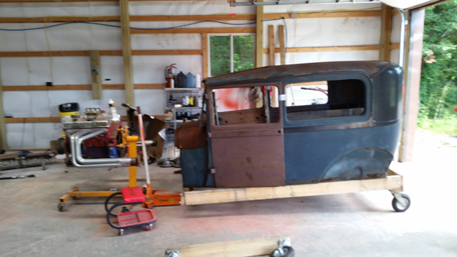

    I've been working on this since about May. So I have a bunch of photos to post on this build ImageUploadedByH.A.M.B.1449093871.788116.jpg Z ing the rear to allow me to lower the frame further down in the rear ImageUploadedByH.A.M.B.1449094014.150318.jpg ImageUploadedByH.A.M.B.1449094035.657956.jpg the pictures are fussy sorry about that. I kicked it up about 5"

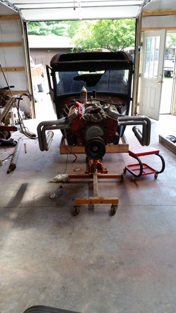

    I also found so Sanderson headers off of craigslist for $150. Not what I originally wanted but the price was right ImageUploadedByH.A.M.B.1449094229.584434.jpg ImageUploadedByH.A.M.B.1449094254.589600.jpg

    My plans is to get it on the road spring time and then winter 2016 bring it back in the garage for a 3-4 inch chop will see how the summer goes and finish the body for a quality paint job

    Great Project, keep us posted. I suggest you chop it now if that's the plan anyhow. It will only add day or two to your build at this stage. Much more effort required next winter.
  29. LOL looks like you'll need to shorten those headers up about a foot so you don't hit gas pumps and little kids on the sidewalk with 'em. :D
    Like the direction this is headed. looks like you got a pretty good handle on it.
