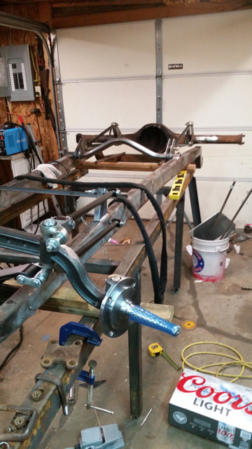

    I installed the ladder bar in the rear and the 4 inch drop beam with a reverse eye leaf spring in front and the 4 bar. Planning on 4 wheel disc brakes. The rear end is too wide I'm either going to get it narrowed or find another reared.

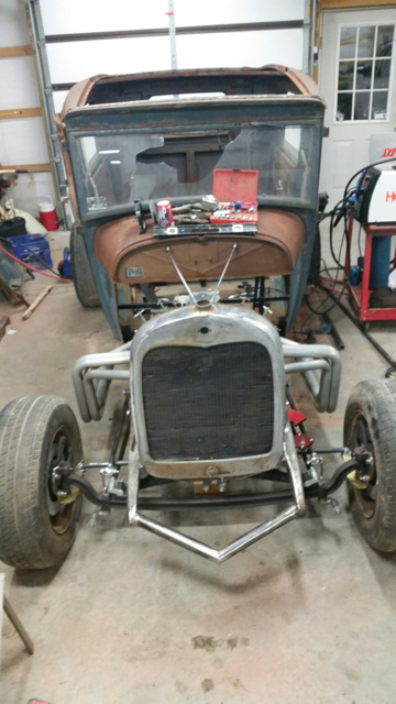

    ImageUploadedByH.A.M.B.1450056764.610801.jpg ImageUploadedByH.A.M.B.1450056784.693331.jpg I got the body back on the chassis. Now need to figure out the motor mount and tranny mount. I need to mount the brake mount and master cylinder. Probably the car will placed on the back burner till after Christmas.

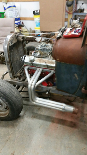

    Personally I'd ditch the headers.more for a t bucket.just my two cents.nice start,looking good

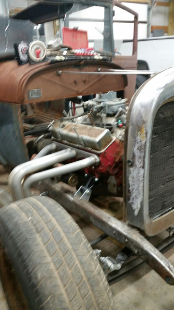

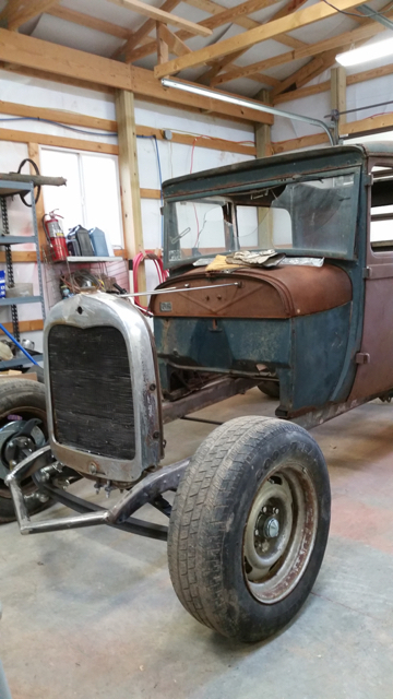

    ImageUploadedByH.A.M.B.1452143713.792188.jpg ImageUploadedByH.A.M.B.1452143728.340915.jpg ImageUploadedByH.A.M.B.1452143754.698437.jpg I installed the motor and tacked in the motor mounts. I set the engine approximately 4" away from the radiator, that was a mistake. I thought it would be more than enough room for the electric fan but I was wrong. I thought I wouldn't have to notch the front of the fuel tank, for the distributor. Another mistake of mine tonight. I figured it was time to head in. I'll try to work on it tomorrow
