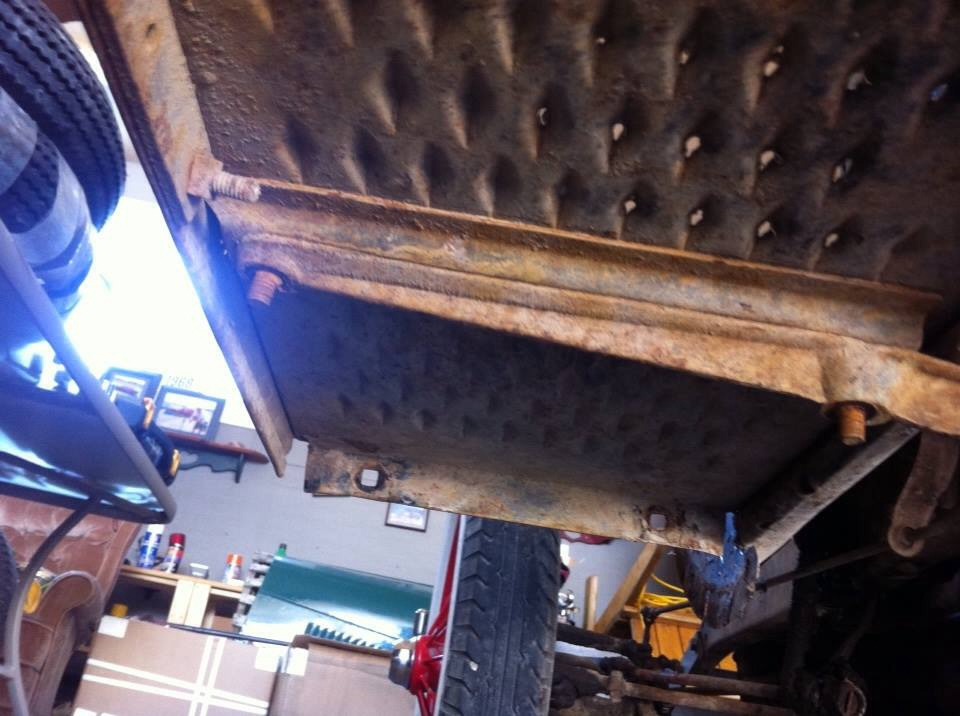

    Need some help on getting off the running board without damage, I believe everything is off and it should pop
  4. The bolts may be frozen between the board and bracket due to rust or road gunk. The boards also fit into a channel on the edge of the splash aprons - could be frozen there, too. You can hold the top to keep it from flying up and then bump them with your palm to free them.
    Have you tried just removing the brackets from the frame and taking out the boards with the brackets attached?

    brackets underneath seemed riveted. Would have to drill them out
  6. If you are removing the boards - you will be removing the brackets anyway.

    Anyone have best practice.e for taking off running board supports? I removed the nuts underneath but she won't budge. The supports are riveted to the frame and I do not want to destroy the support or the frame.
  11. OFT
    Joined: Jun 1, 2005
    Posts: 579
    OFT
    First take off the running boards-use rubber mallet and hit along seam by splash apron then near braces (underneath towards top). May take some firm taps as boards look to be rusted to brace/splash apron.
    Undo body bolts and lift cab/bed a inch or so to slide running boards out.
    After that drill out rivets for running board supports.
    Earl

    After lifting cab/bed slide the--"splash aprons" out (not running board-my bad). The running board should lift up off supports. Splash apron slides out from under body/cab.

    Try using a piece of 2x4 or 2x6 and a floor jack to apply light pressure on the board close to the bracket, then tap on the side of the bracket where the bolt goes through with a hammer. Just an idea, may not work at all.

    I'd try heating up where the support meets the running board with a torch, and then giving the bolts and boards a little whack with a mallet. Looks like they haven't been apart in a long time, and could be glued together with rust.
