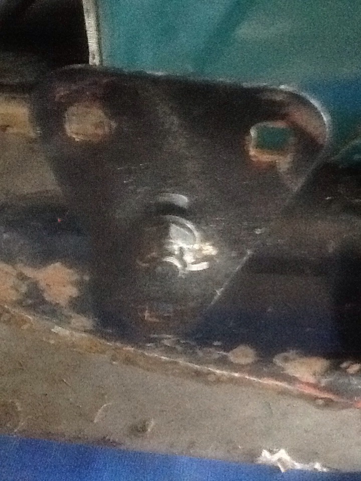

    Looking for pro tip on removing these nuts with a pin through

    The picture is fuzzy but it looks like a castle nut with a cotter key. The key is looped on one side and flat on the other. The flat side is bent over the nut once it is pushed through to keep it from coming out and the key then keeps the nut from coming loose. You can straighten the bent end out then pull on the looped end to remove it. Sometimes I just clip the bent end with a pair of dikes and then grab the loop with them and lever it out.

    Thanks to firetique the nut is off, but he spare tire holder on the drivers fender will not move an inch..am I missing another fastener?
