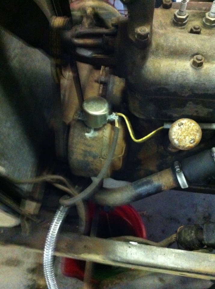

    Engines coming out next week for blast and paint..what's up with this alternator I don't see one like this on anyone else's.
    Drained the radiator to remove tomorrow in anticipation of engine removal...smell gas in the coolant...uh oh..pretty sure it's from the transporters trying to get it started hope nothing serious.

    Carter
    That is an early Model A Powerhouse Generator.

    As you can see its in ruff shape, anything vintage I can replace it with or do most just use a mod generator?
  12. Old-Soul
    Joined: Jun 16, 2007
    Posts: 3,795
    Old-Soul
    Just get it rebuilt. When I first got my coupe it came with a powerhouse and a regular A generator. I ran the more common A gen cause it already worked. The powerhouse would make a pretty cool detail on your banger.
