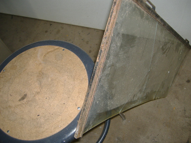

    Here is what I have for my 28 windshield. The top that the glass secures to, both side pieces that secure to the glass, and the u channels that fit in the piller that the rubber or felt will go in...John

    Ghost, I think those U channels go in the doors I didn't use those for the windshield I have pictures showing the yellow metal that butts against the U felt channel that I purchased in the 3 piece kit from I think the Filling station, came in a Steele Rubber Products bag. The other piece is suppose to fit the top metal windshield piece with the 2 brackets on it for the riser mechanism. The interior moulding holds all of mine in place on the vertical sides. I hope the pictures up-load if not anyone interested in them I'll e-mail them to you. The bottom rubber for the windshield has a dovetail that holds it in the body that thing fit very well without much hassle, the lip goes to the interior side of the car. I wasn't sure about that so I had to go look at my friends original 31 to see. Thanks

    Ghost; The metal channels that you show don't go with the windshield, they go in the door to hold the felt window channels.

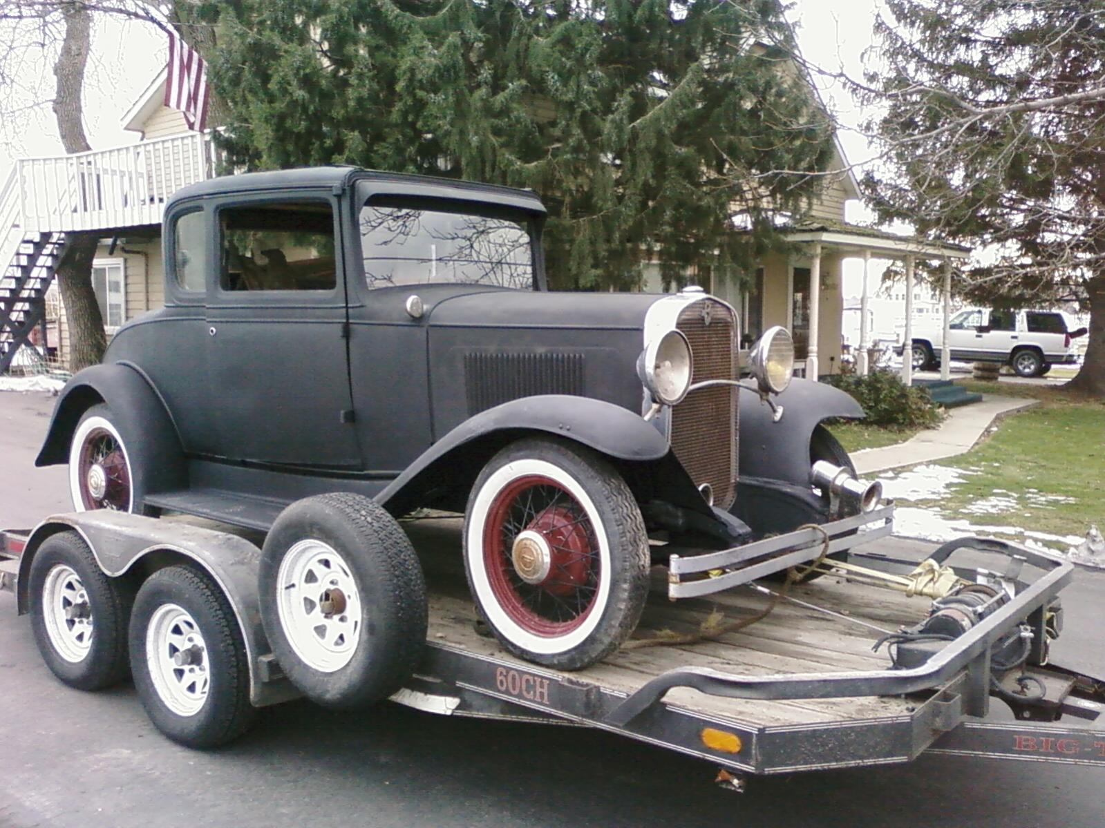

  15. Hodgeshotrods
    Joined: Jan 12, 2009
    Posts: 6
    Hodgeshotrods
    I'm new to the hamb. I have been reading this thread over the past three days... wow! Great projects! Good information! I have a 31 Chevy five window with a rumble seat that I picked up off of craigslist in Jan. The guy started to restore it and had the motor rebuilt in 2002 and drove it in three local parades. I haven't had a chance to drive it yet just put it shop, because I skipped my first day of classes of my last semester of college to go buy it and pick it up. Now I'm working in florida until november and its in Idaho. :( I like the 32 grill a lot and was wondering if anyone could tell me if it will interchange with the 31 grill?

    Posts: 3,195
    Ghost28
    WOW. That's a cool car. and I like the six. I dont think there is a whole lot of difference in the 31 to 32 chevy grill except slight cosmetic changes.
    Well what are your plans for your car when you get to it? John

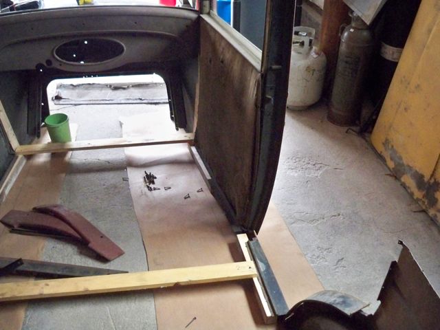

    1st pic Is the frame horn caps that were used to finish off the frame horns after the fenders were installed.
    2nd pic Is the track metal above the passenger door on the body. This had a hole in it for the door stop mechanism I welded mine back in even though I wont be using the stock door stop.
    3rd pic looks like the door sill area around one of the front doors that would surround the hinges.
    4. even with your chop the riser should work as long as you leave the cavity at the top of the windshield for it to go up in. Mine is chopped only 2 3/4 inches, but the way the stock dash mounts you will have to lower the dash so it alligns with the door garnish moldings. I lowered mine like this and it gave me more lower visible windshield area, and still allowed an air gap flow to the foot area on the first crank, then with a little more cranking it allows the air to come into the passenger, and driver face area.
