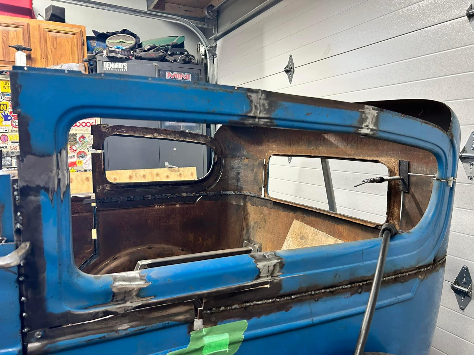

    I tied the cab floor into the back of the sedan

    Stretched the rear windows with the leftovers of the deleted doors.

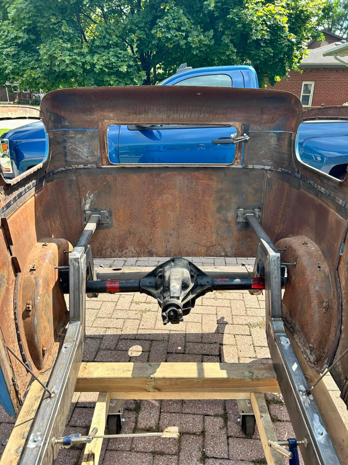

    Got the motor and transmission mounted so I can do the body floor and attach the sheet metal to that. It’s a 1964 327 with a 700R4 behind it.

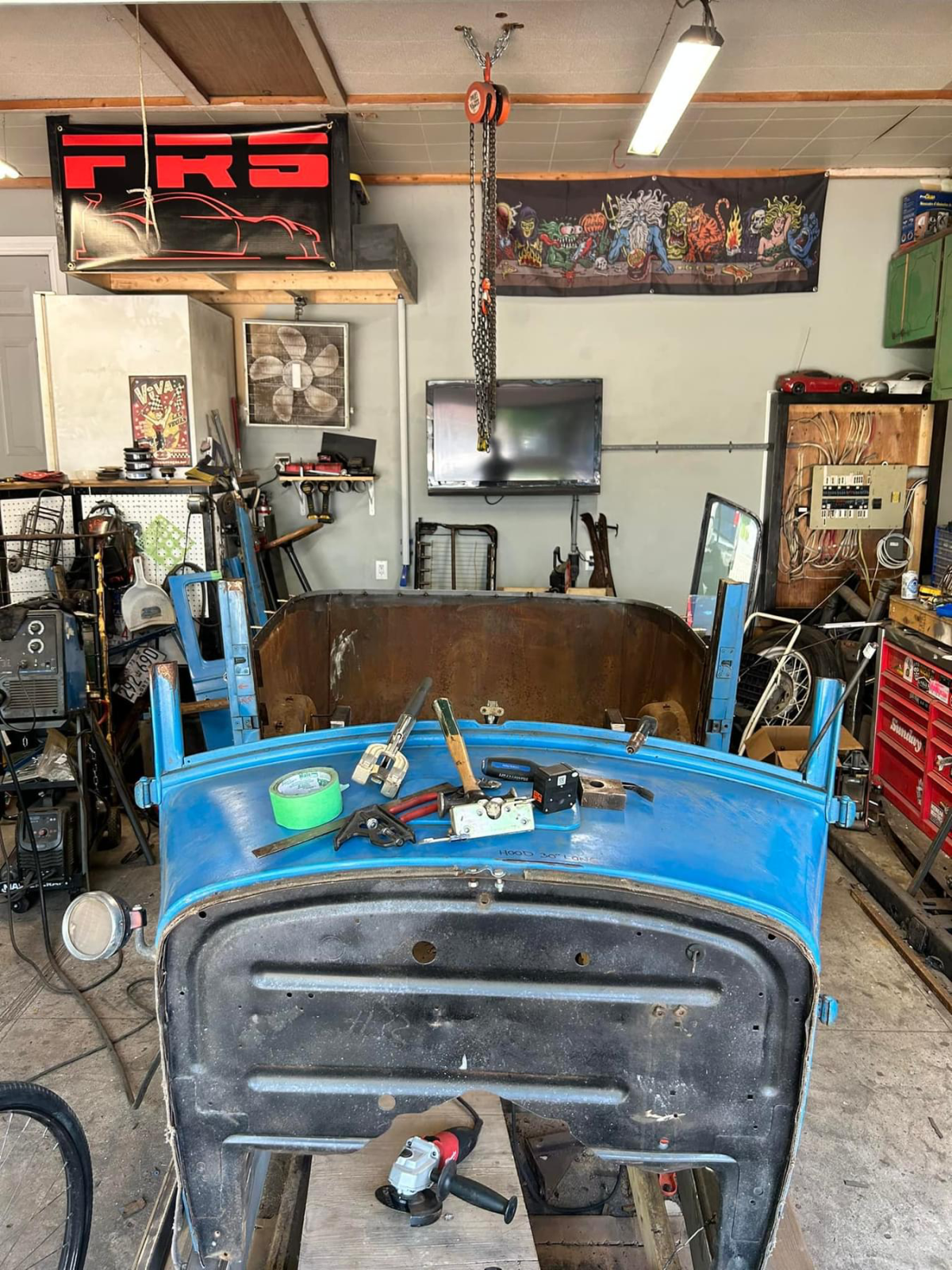

    After dealing with a sick wife for a few weeks and crazy overtime at work, I finally had a bit of time to get outside and work. I got the drivers side all matched up with the door and cowl, along with some 1/2” square tube just to hold things instead of the wood.
    Also got the hairpins mounted.

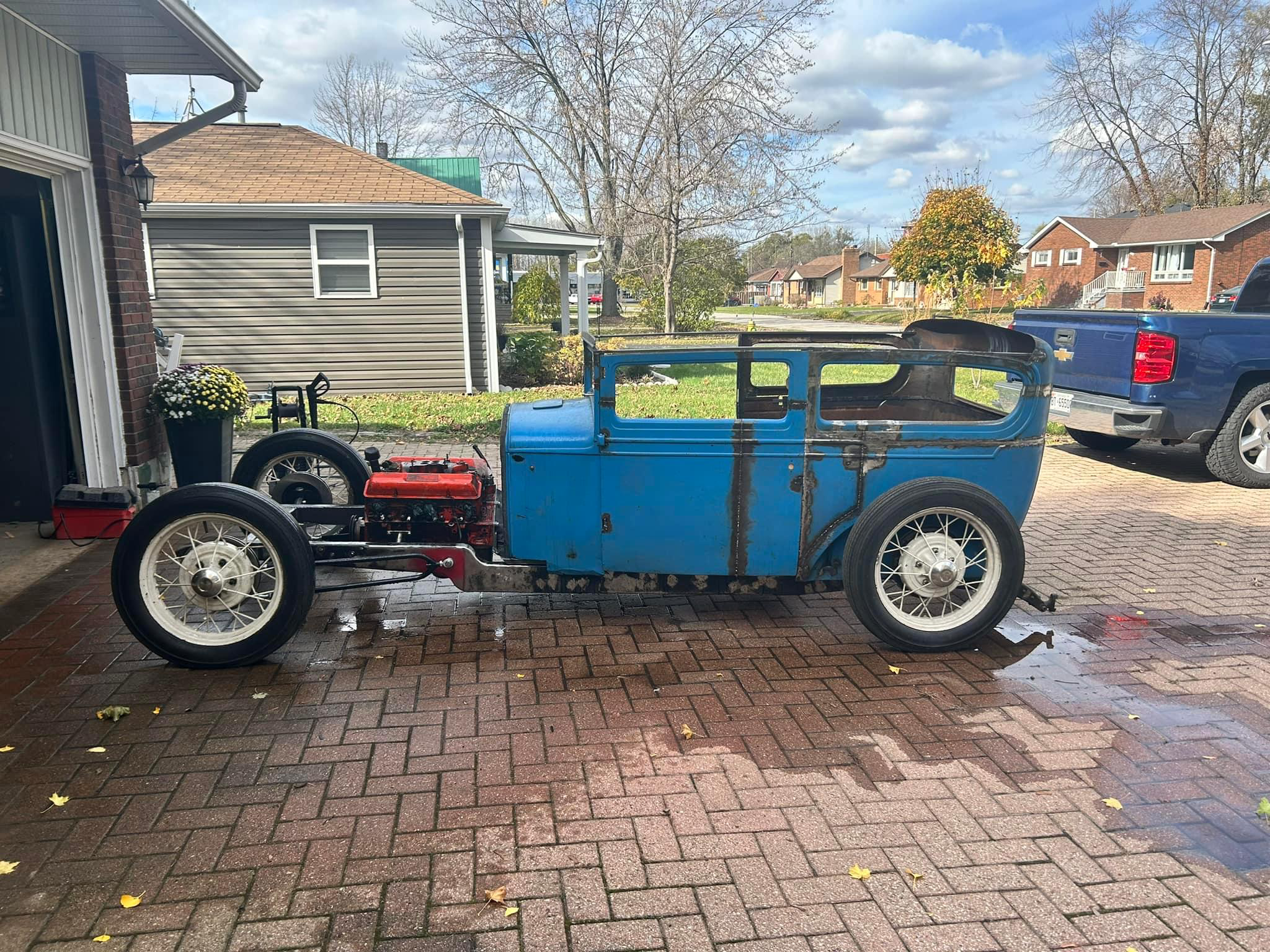

    Got the Durant rolled outside for a distance shot and engine cleaning. I haven’t seen this yet with all the panels attached.
