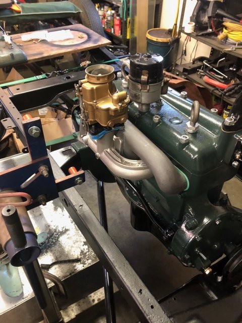

    I've had 5 Model A's one stocker, two with flathead V8's , one with a hopped up B motor and I'm working on a 29 roadster pickup with a mild banger in it. Rebuilt stock block, Snyder's 5:5 to 1 high compression head, Burns intake with a Holley 94 and a 50's Mallory dual point distributor. Banger powered Model A's are great as long you are okay with running 50-55 mph, I like cruising secondary roads so it works for me.

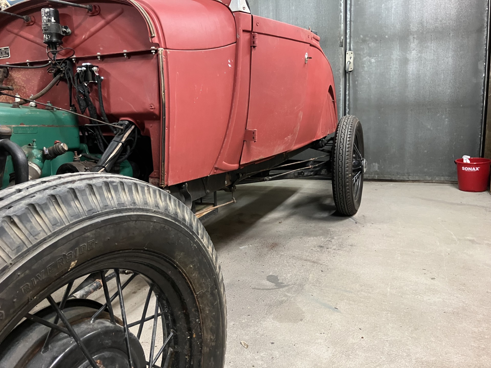

    A bunch of parts fell off the car and just like that another roadster is being ruined.
    But it already looks more like a hot rod.
    And a question for the model A gurus:
    As you can see the floor needs repairing so the seat riser must come out first, do I need to brace the body in any way before removing the riser?
    My guess is no since I can't see that it has any structural purpose but I better ask first.

    It would not hurt to at least cross brace the back door jambs and the cowl, You should also remove the splash aprons so the body bolts must be removed to do that. There is wood that runs along the frame that will be needing possible replacement depending on the past history of the car. that will also enable easier removal of the running boars brackets from the frame. Another way is just torch them off with an acetylene torch. The wood front floorboards once removed as they just sit in place then remove the rivets that hold the seat riser. Replace the floor under the riser and the riser. Remove the bracing and done.

    The aprons and running board brackets are coming off too but I was going to leave them on 'til I have a more solid floor but maybe that's not possible?

    Easiest to do them all at one time. Just torch them off or a cut off disc in a die grinder if you don't want to remove the body bolts.

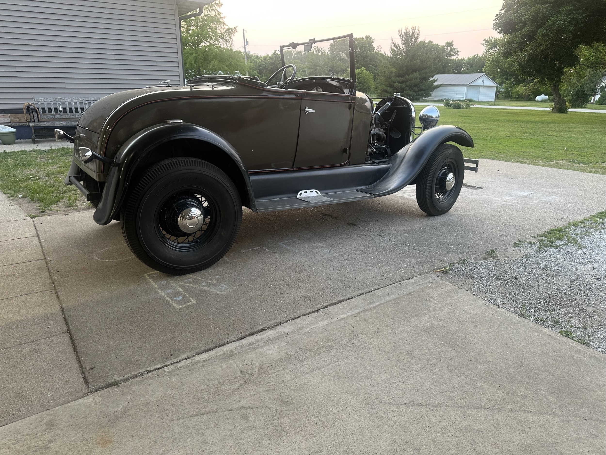

  30. Cool car! I’ll be following along! I love the look of cars with the splash aprons! Mine will be going under the knife someday! IMG_9750.jpeg IMG_9749.jpeg
