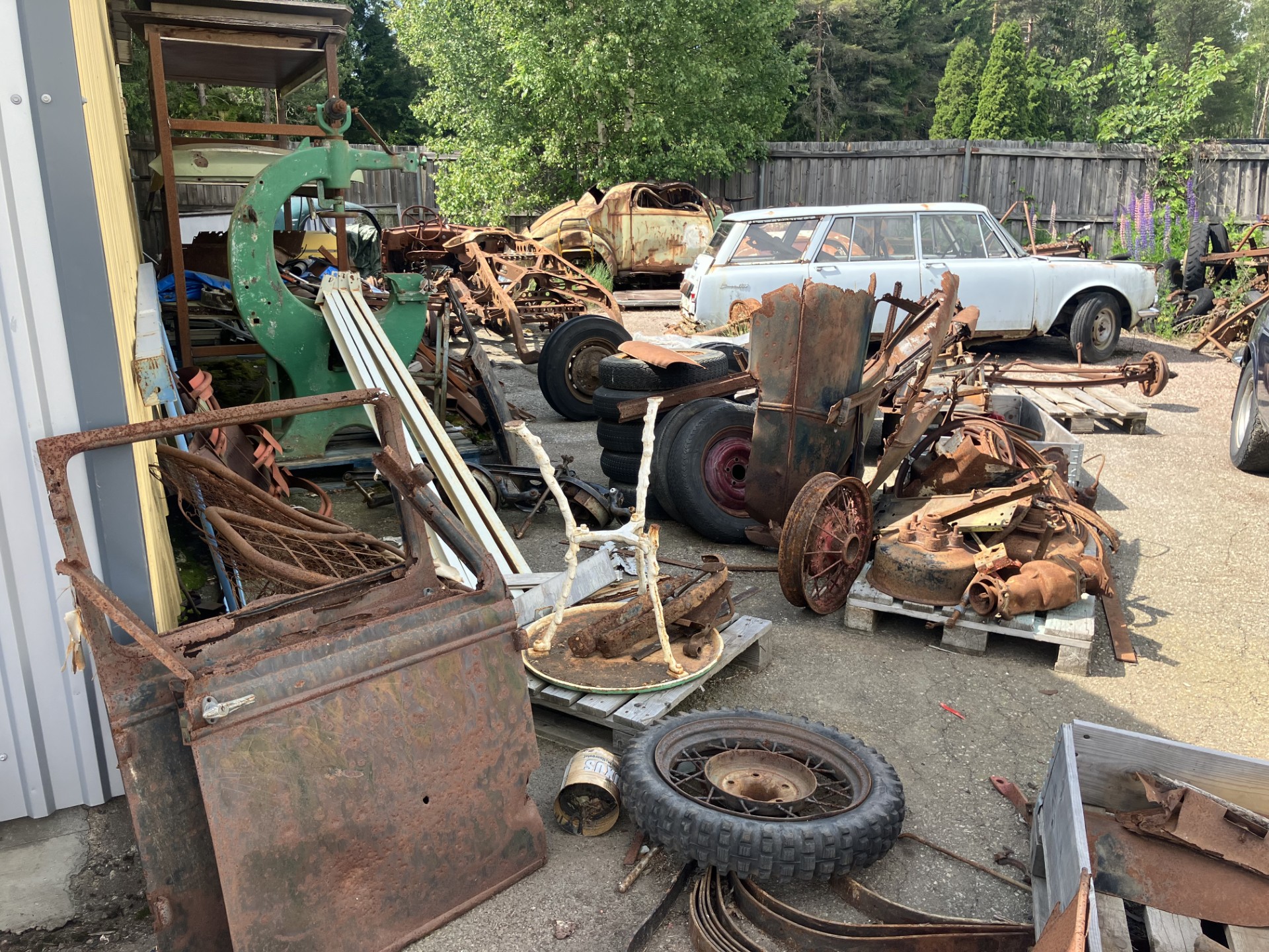

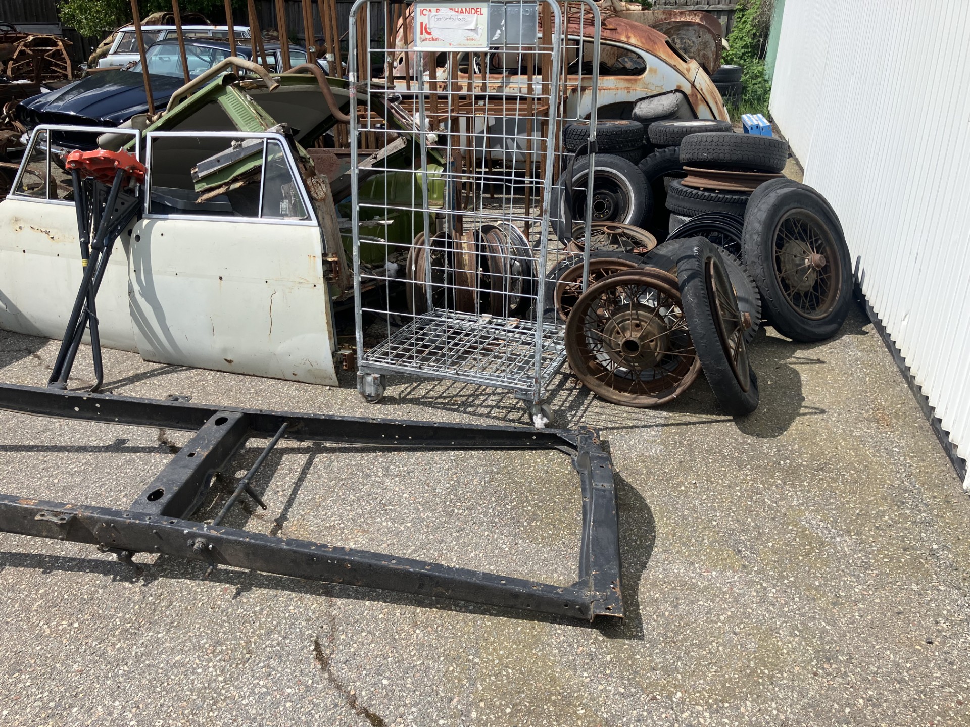

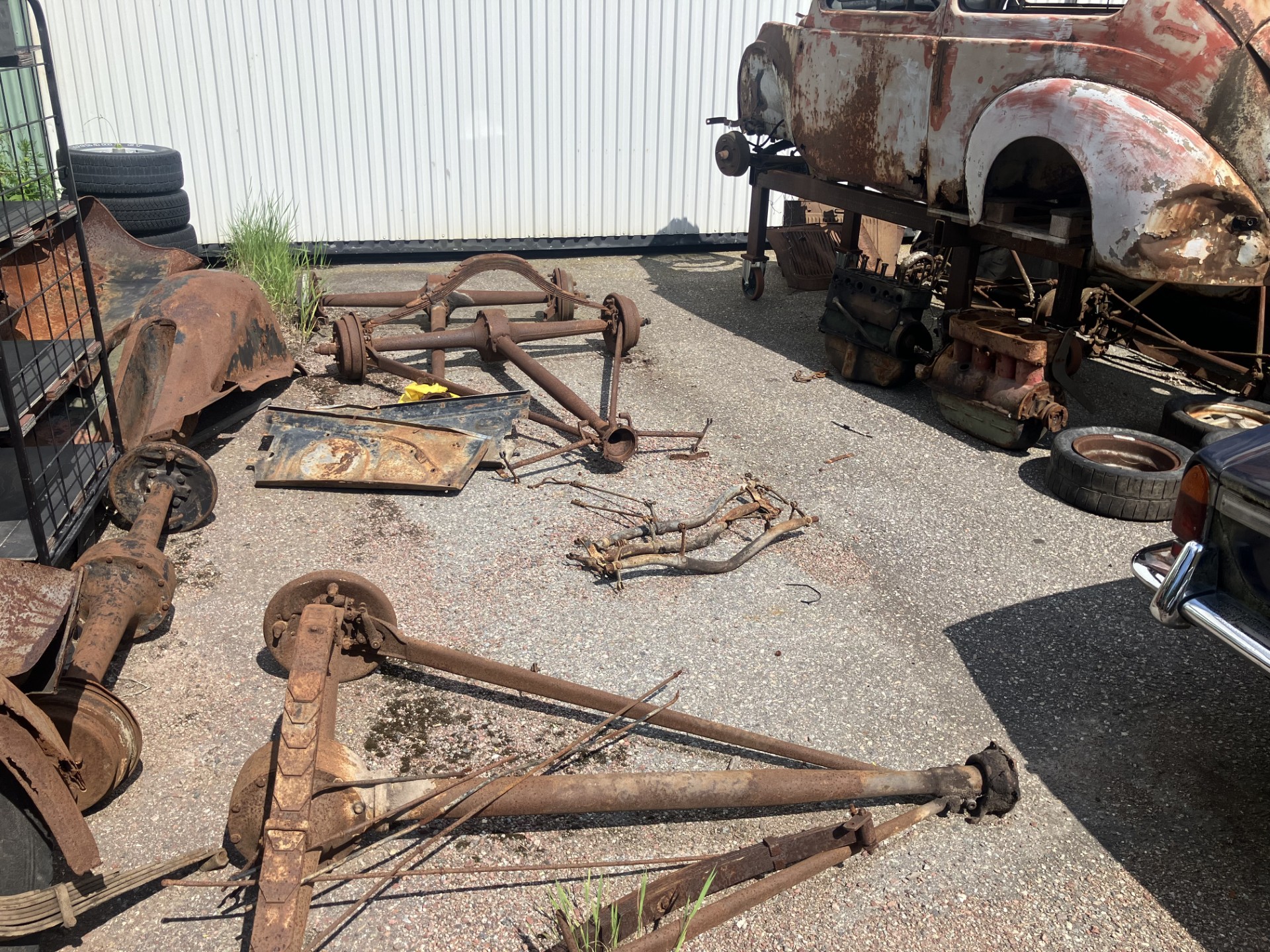

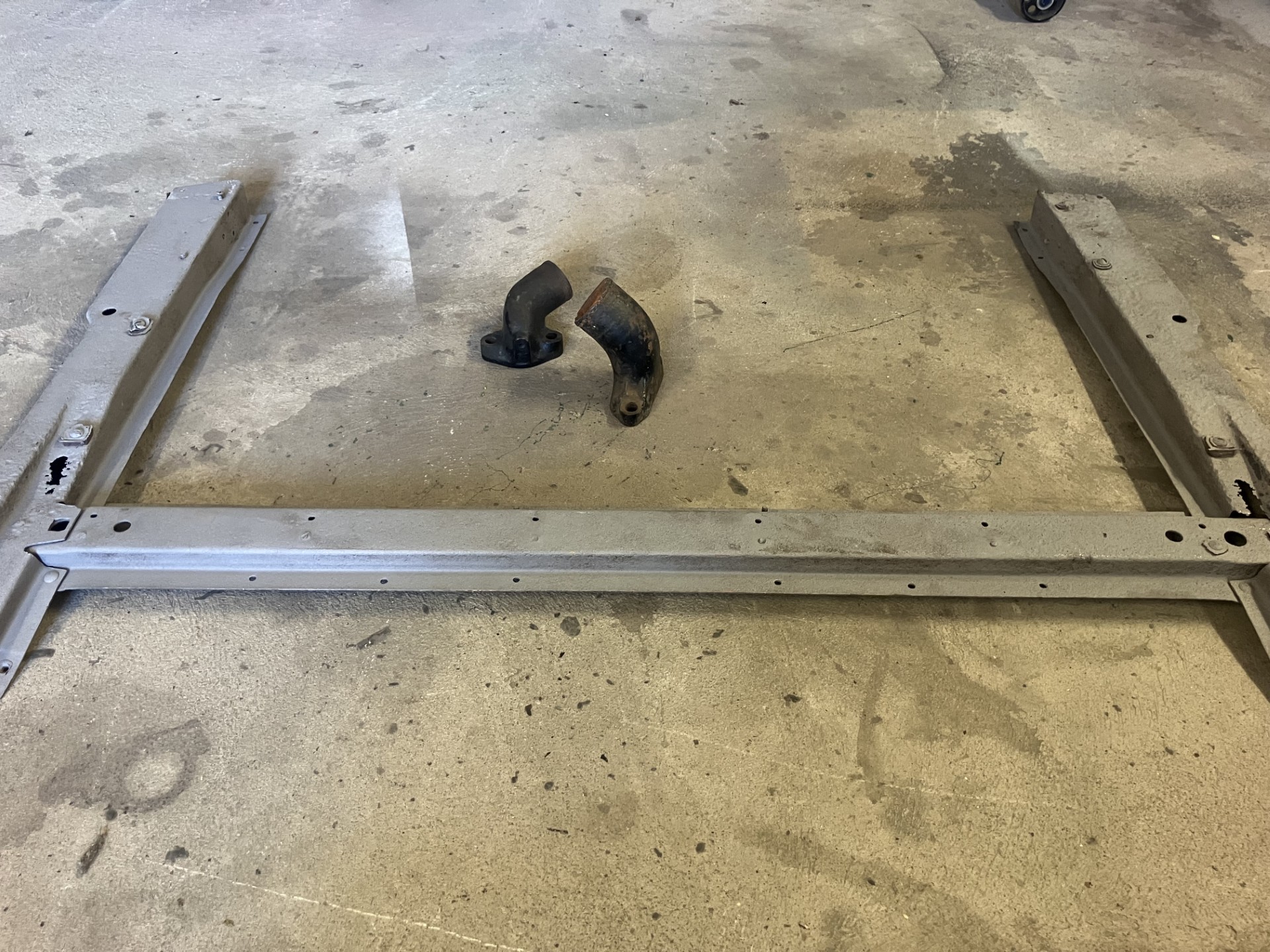

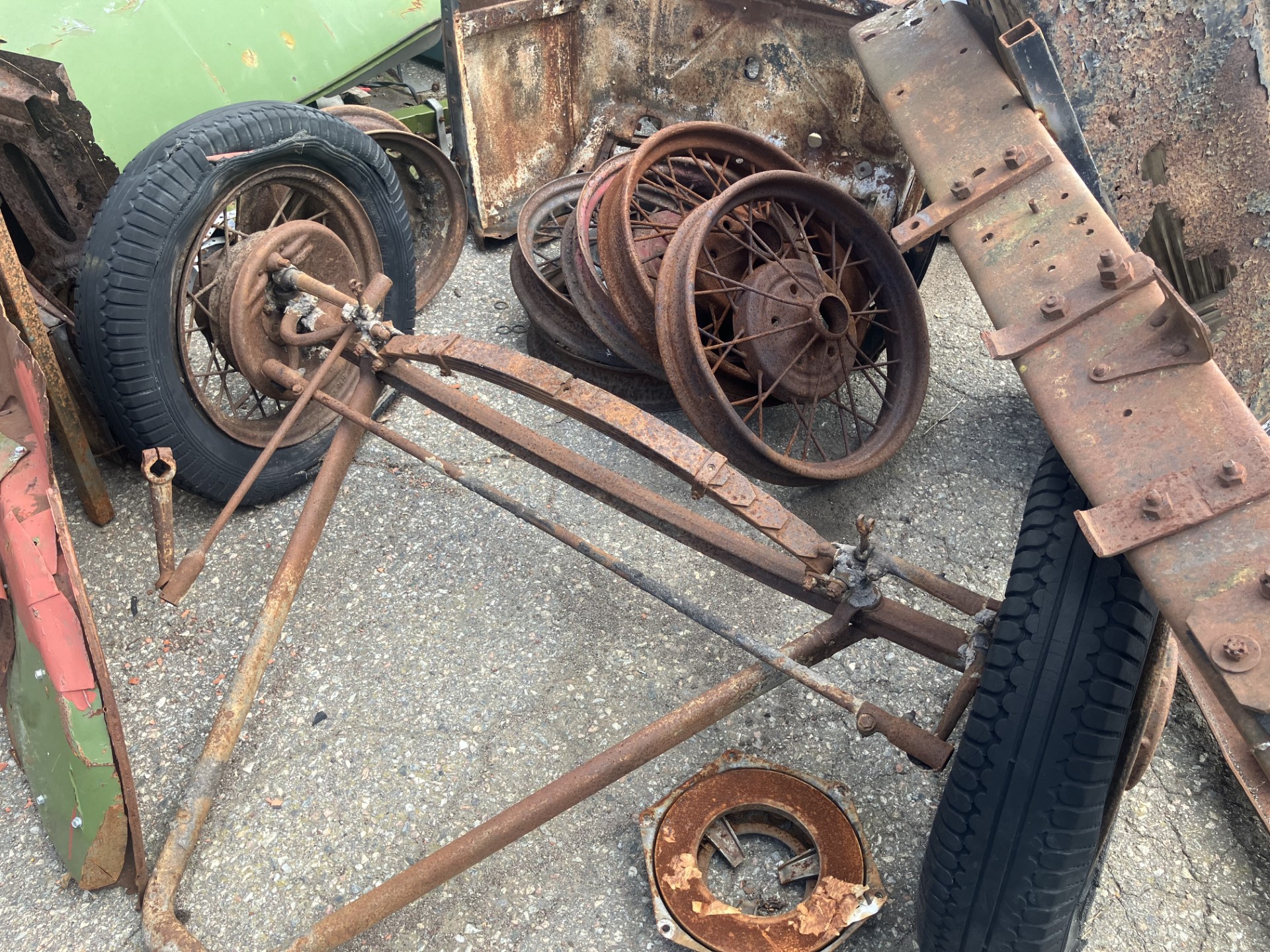

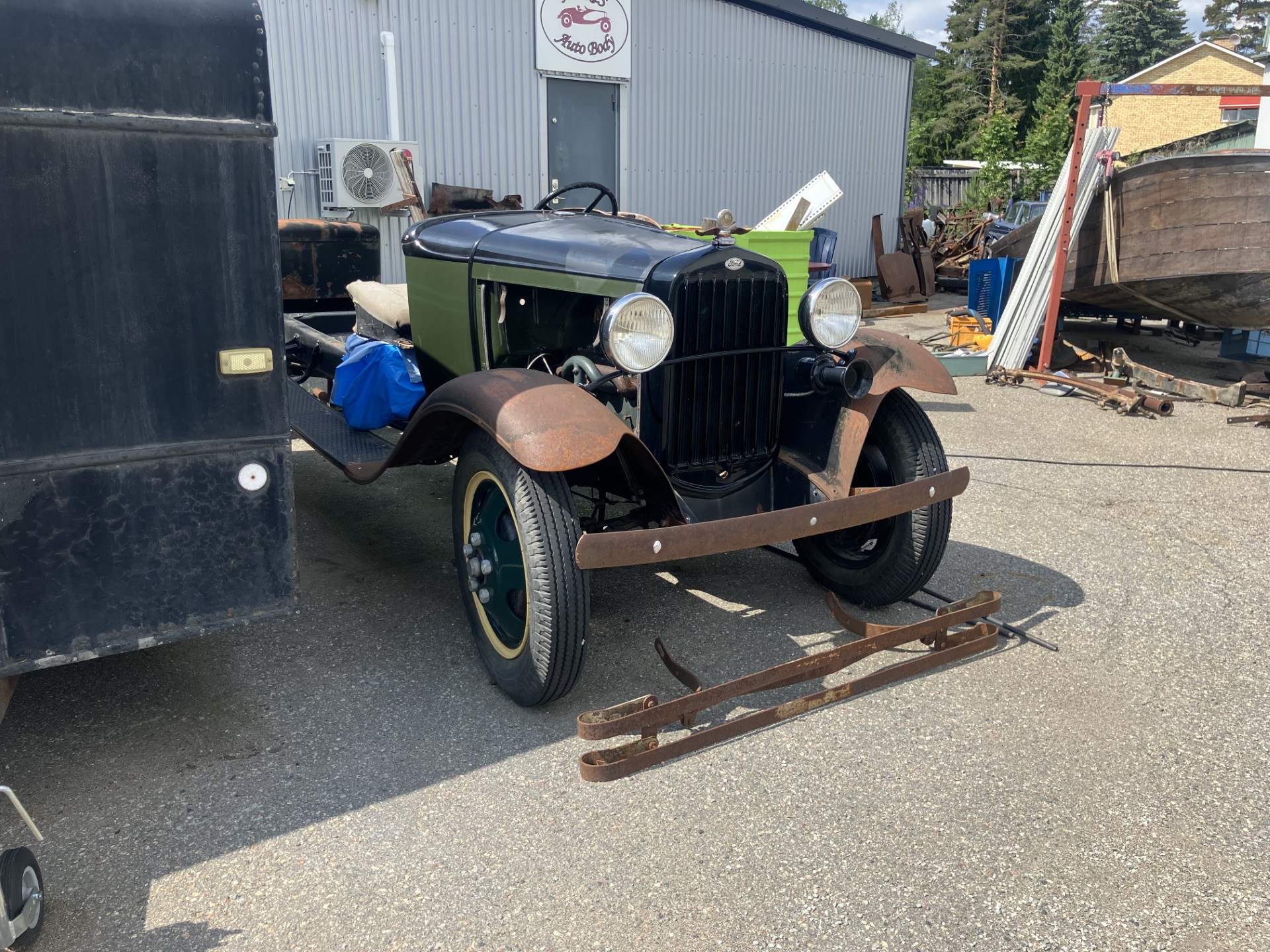

    Went on a trip today to pick up that sub rail cross channel I mentioned earlier, also collected some water connections since the ones on my engine have some funky extra connections welded to them.
    Lots of old car parts, a very nice 68C, BB truck and other various things.
    And a lot of pictures taken.

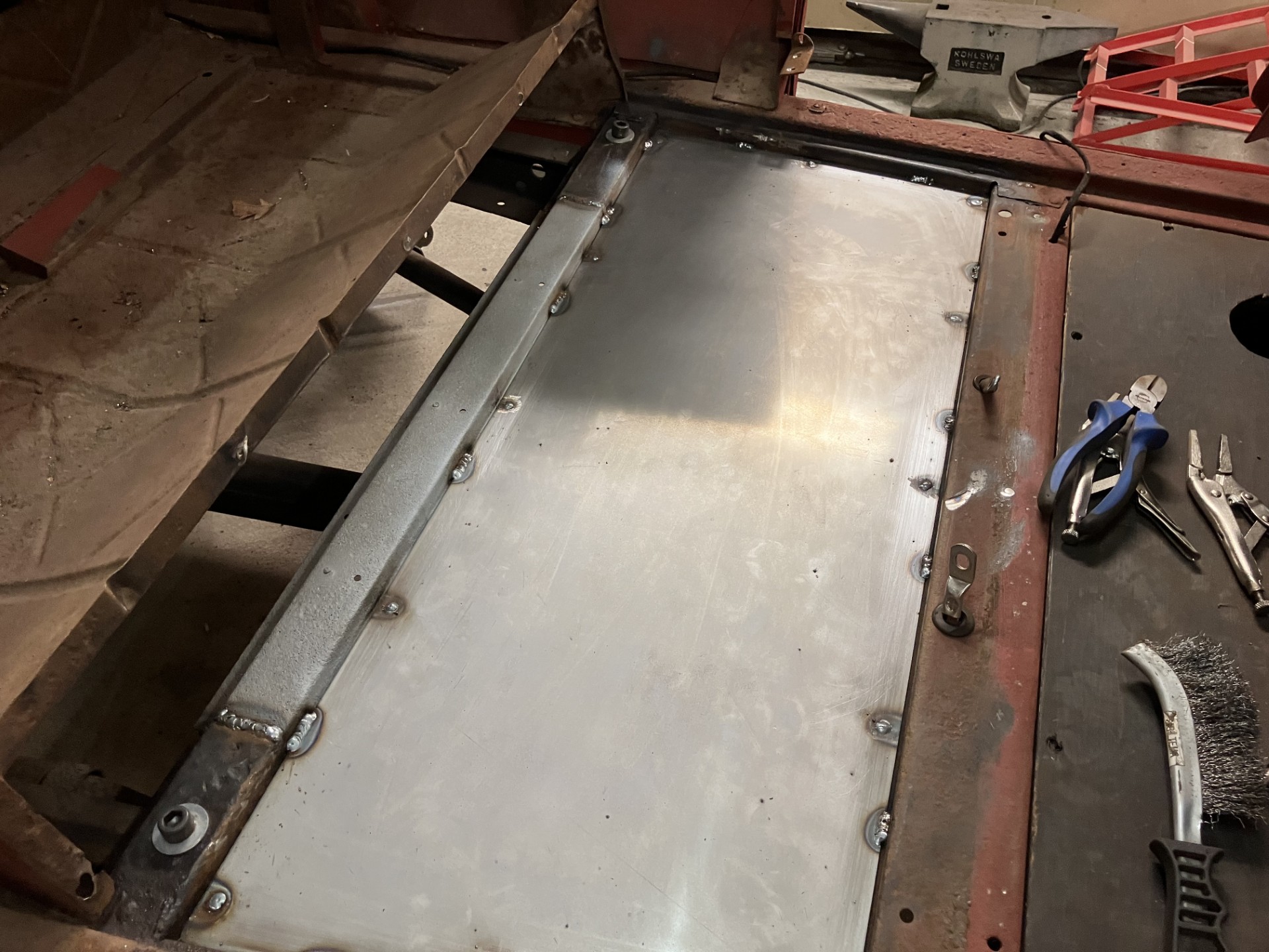

    "New" cross channel is in, just some minor cleaning up left.
    I decided to splice it rather than replacing the whole thing, less work involved and I figure it's gonna be plenty strong once the new floor pan is welded in.

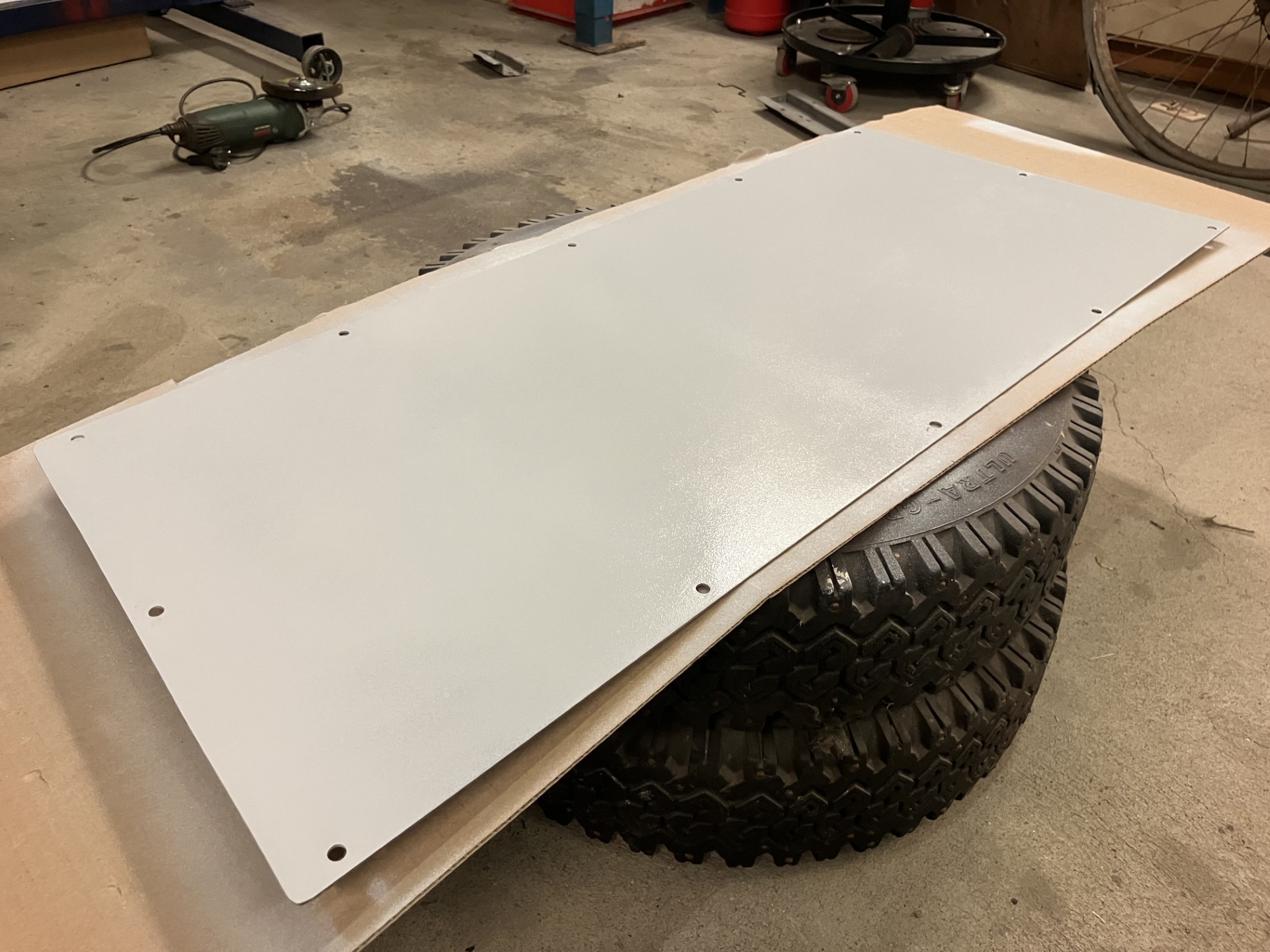

    And the new floor pan I made got a quick coat of high zinc primer on the underside before installment.
    Since I can't make original style pressings I just made it flat but with thicker metal than the stock one.

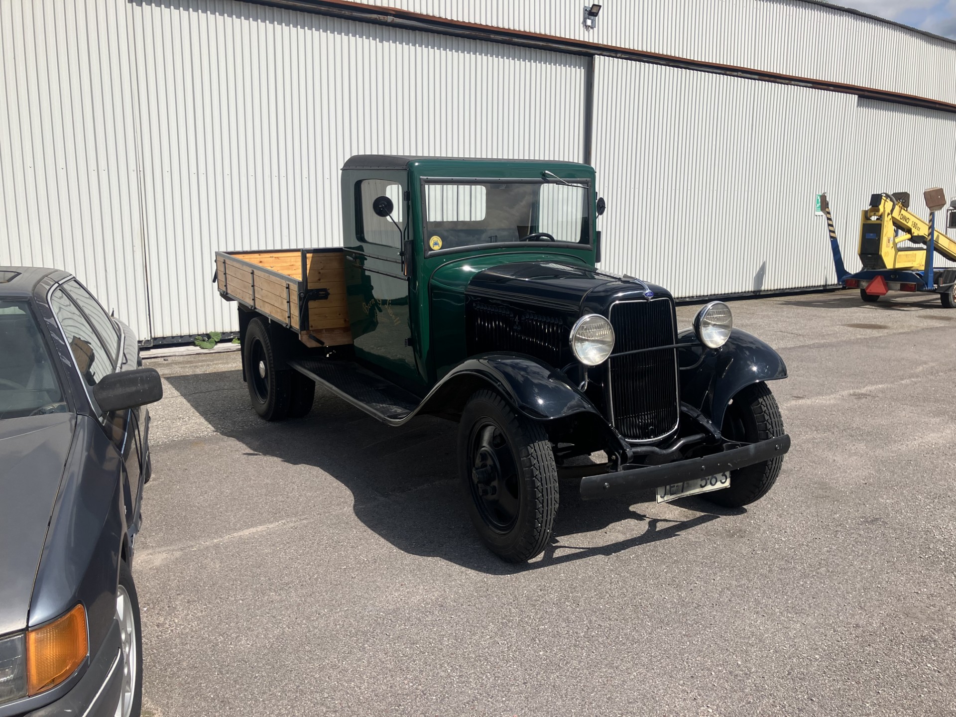

    That BB has a very interesting cab. Were they imported as a ch***is and finished locally or has someone made that cab more recently?
    dwollam, Mikko_, Jeff34 and 1 other person like this.
  19. Mikko_
    Joined: Aug 3, 2018
    Posts: 653
    Mikko_
    from Sweden
    @trevorsworth I never thought of asking but my best guess is that it came to Sweden as a rolling ch***is when new and got the cab made at one of the many body shops/coach builders we had here back in the day.

    New floor pan is in.
    Not exactly concourse quality but it will have to do for this jalopy.

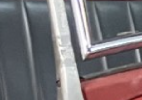

    What a neat little roadster, I’m going to be following this one. I must say, that’s the first time I’ve seen someone extend the windshield posts. Keep the good work coming…..
    Mikko_ likes this.
  25. Mikko_
    Joined: Aug 3, 2018
    Posts: 653
    Mikko_
    from Sweden
    @richard noble Thank you.

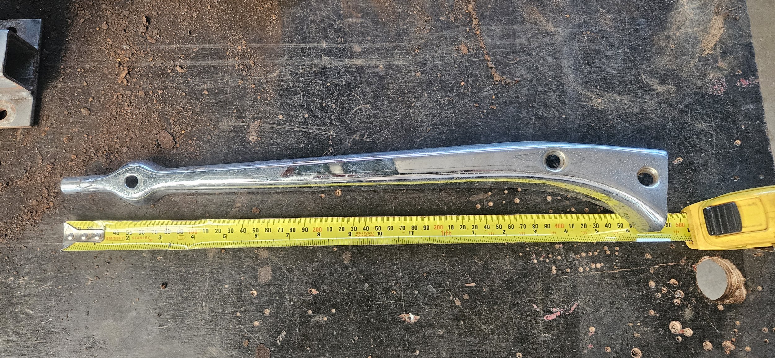

    Regarding the windshield posts they are most likely stock height.
    I'm thinking it's either missing some sort of rubber piece along the bottom edge or the windshield frame itself is from a 30-31 deluxe which I believe is lower from the factory.
    Outback likes this.
  26. lamaison
    Joined: Oct 21, 2006
    Posts: 147
    lamaison
    from Canada
    I think you likely have the correct 28-29 windshield frame. 1930-31 frames are all about 2" wider.
    There is indeed a rubber seal that slides into a groove in the bottom of the windshield frame and it's about 1" wide to close off the gap. Also used were fairly narrow seals that slide into a groove in the posts/stancheons to seal off the sides.
    I'll look for some pictures I took and some others that were posted on another forum quite a while ago.
    dwollam, Okie Pete and Mikko_ like this.
  27. Dedsoto
    Joined: Jan 7, 2014
    Posts: 376
    Dedsoto
    from Australia
    The posts look extended to me which is a strange modification,
    here's a pic of my standard height posts for reference
    Okie Pete and Jeff34 like this.

    I think that is just some residue from tape or something on my windshield post.
    But thanks for the reference picture, I'm gonna measure my posts and compare.
    winduptoy and Jeff34 like this.
  29. Mikko_
    Joined: Aug 3, 2018
    Posts: 653
    Mikko_
    from Sweden
    Measured my windshield posts today and they are the same height as in the reference photo by @Dedsoto .
