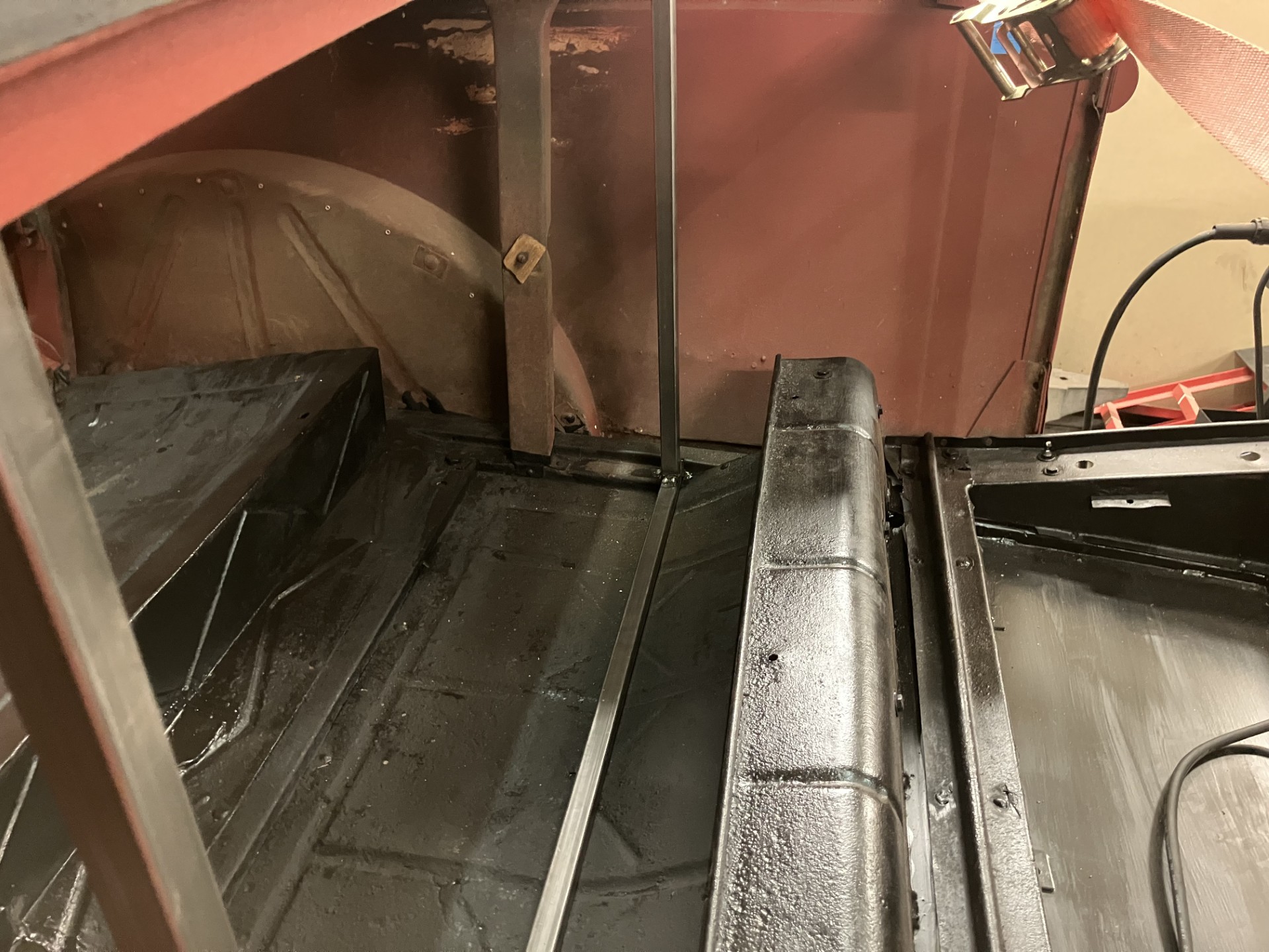

    Began the morning with making the three support brackets/legs for the rear portion of the seat riser.
    Then I patched up the last two holes in the rear floor, it ain't pretty but atleast there are no gaping holes anymore.
    As you can see the whole rear floor is a bit of a mess and should really be replaced completely but it will have to do for now.
    After that, as a personal motivation booster I brushed the inside of the floor with Eastwood rust encapsulator.
    That stuff sure smells bad.
    Still hasn't dried completely in the picture so still a bit glossy but should dry down to a flat finish.

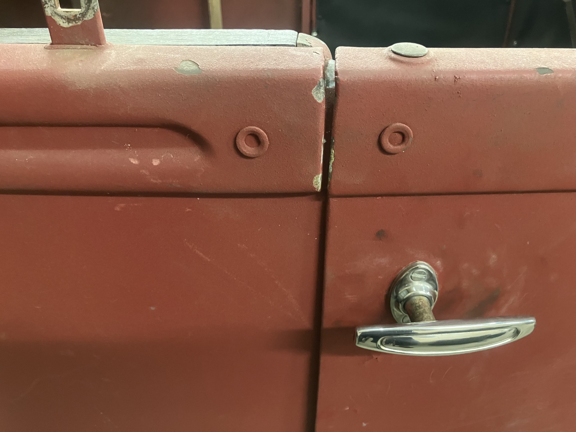

    Instead of digging into the front end suspension today I kept on trying to get the rumble seat lid to fit better, with no luck.
    I think one of my issues is that the hinge pivot bolts are rusted to the hinge itself, which makes the whole bolt and nut turn instead of just the hinge moving on the bolt, which I think it should do when opening and closing the lid?
    Also think it will be easier to adjust it if the lid is in the closed position and I crawl inside the car adjusting the hinges while a helper is on the outside telling me when the lid is in a good position.
    Then I turned my attention to the doors.
    They open and close pretty good but when closed they stick out a bunch, see pictures.
    How do I go about adjusting this? Is it a matter of shimming the body wood blocks or should I focus on the hinges? (I tried loosening the bolts that attach the hinges to the a-pillar but they are rusted solid, drenched them in penetrating oil for the time being)
    I know they weren't perfect from the factory but I would like them a bit better than this.
  26. winduptoy
    Joined: Feb 19, 2013
    Posts: 4,153
    winduptoy
    Hi Mikko....glad you are getting some therapy time in....
    I don't know what specific product you are using, the Rust Bullet I use stays sticky..then soft and suddenly after a couple of days it turns hard and dry....I believe it is the nature of the encapsulator to 'soak' into the rust instead of drying on the surface.
    It is a two person job,,,it can be done open but holding the position and tightening the fastener is almost impossible by ones self....
    looking at the profile of the body bead and the door bead....the door bead is shallower.... is there play in the latch?
    It looks like the door is closed at the top and the gap below the bead is pretty even....I have all late A's with flush doors so I am not much help....and have never looked critically at a door gap from your angle that I can recall...
    Keep up the momentum....

    @winduptoy I used Eastwoods rust encapsulator. It seems like it was less sticky today so I think it will be ok eventually.
    When the doors are closed there is some play in the latch if I pull on the door, if that makes any sense.
    P***enger door is worse than the drivers door.
    I have gotten some advice on adjustments on the Fordbarn.
    Okie Pete and winduptoy like this.

    After some advice over on Fordbarn I pulled the quarters together with a ratchet strap, probably moved the doors in about 1/4 inch on each side.
    Then I welded up a small crack in the left quarter panel, reinstalled the wood pieces along the tulip panel (with glue between the big middle piece and smaller side pieces) and I also made 2 small angle irons (1 for each side) that I screwed to the inside corners of the wood pieces to further brace them a bit.
    I'll let the glue set over night before removing the strap and see if it holds the shape.

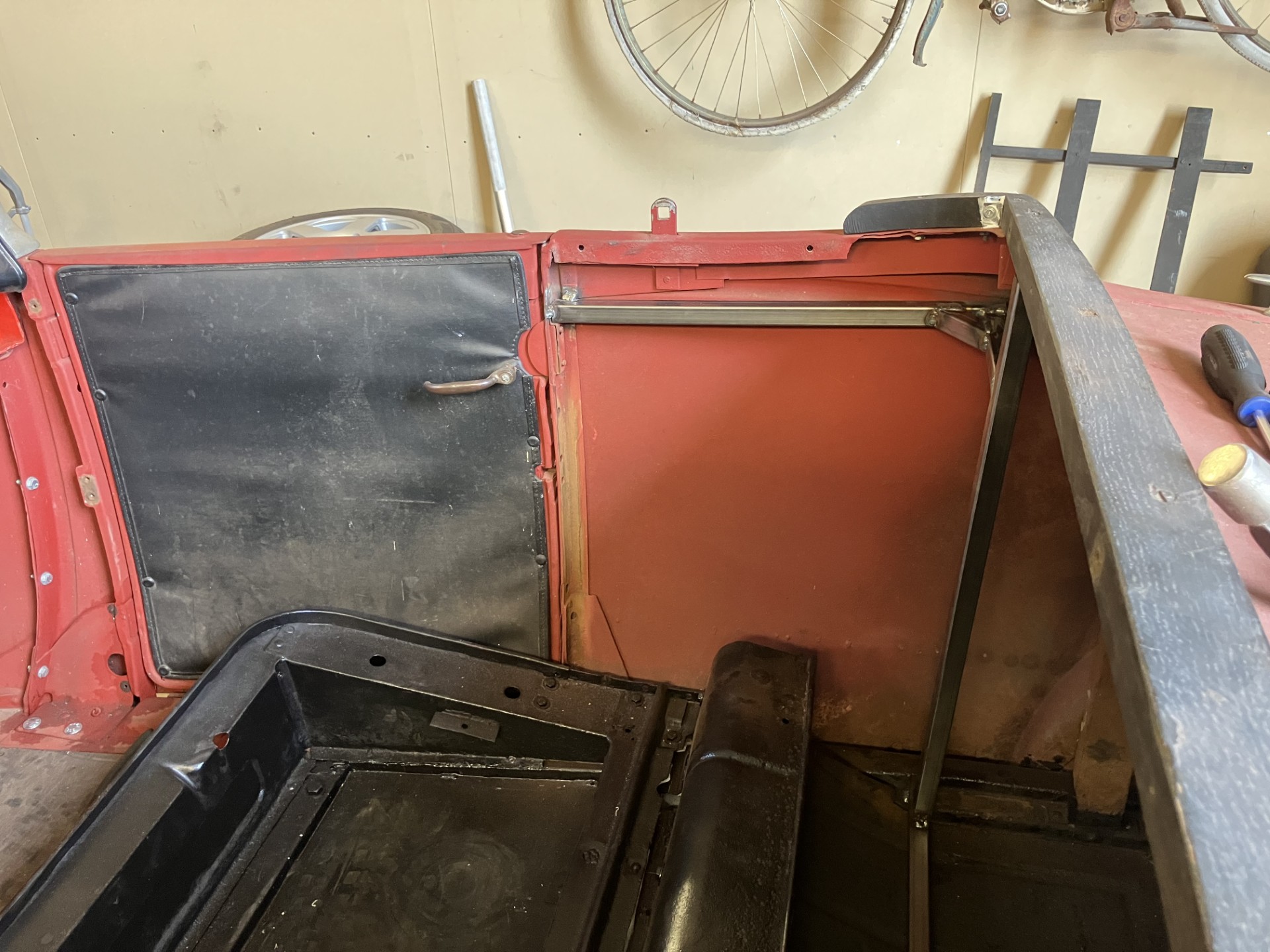

    I quickly realized the quarter panels isn't gonna hold their shape without some further bracing.
    So today I began to weld in some bracing made out of square box tubing.
    Got the box tubing frame behind the front seat welded in today, except some sort of cross bracing.
    I'm gonna connect this frame thing to the B-pillars and also box the B-pillars with the same size tubing.
    Hopefully this will give some sort of rigidity to the body.

    Got my B-pillars tied to the frame thing I welded in yesterday, and just like that my quarter panels stay where they are supposed to stay and the door gap is much better on both sides.
    Still have to weld in a cross brace between the two vertical box tubes that I welded to the tulip panel, and box the B-pillars but ran out of box tubing to do it all (I have enough to box one B-pillar, might do that tomorrow).
    P***enger door still opens and closes fine while the drivers door requires a bit of force both to open and close.
    I'll look into that a bit more but I would still call today a win.
