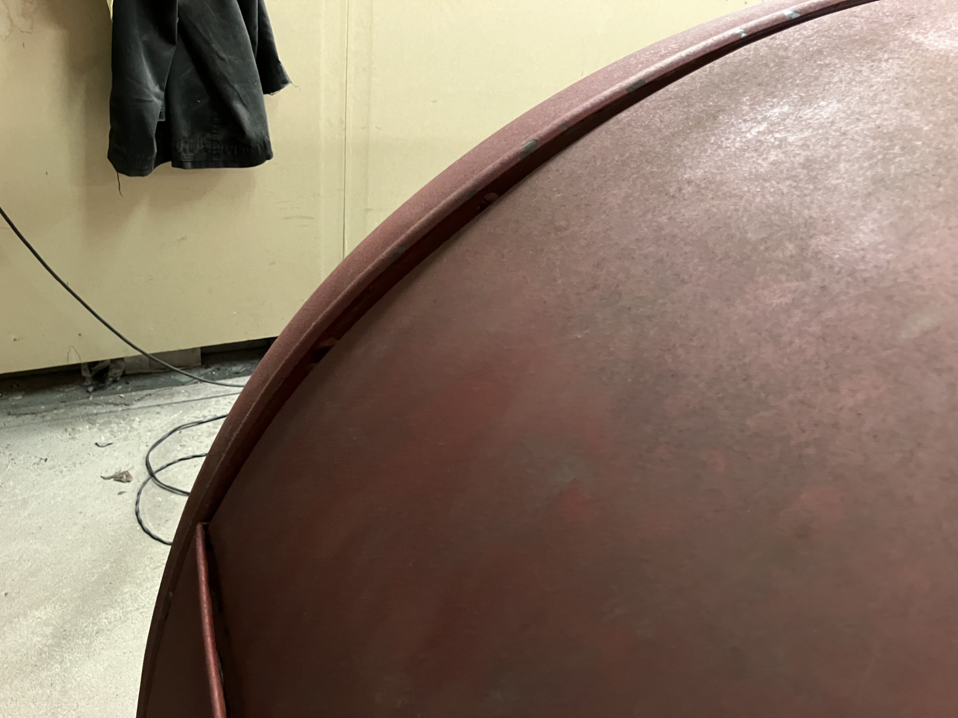

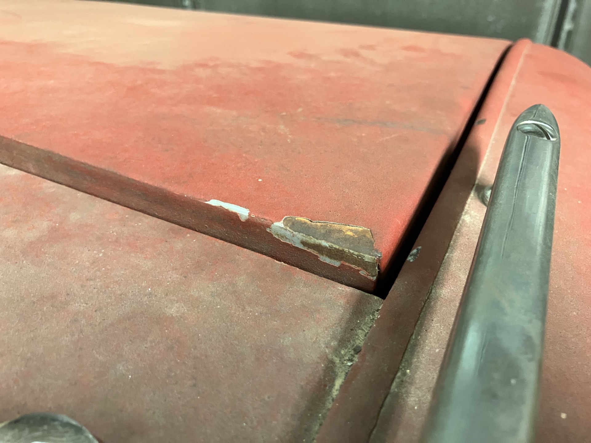

    As mentioned before the rumble seat lid fits really bad.
    Or it fits ok on the right side but on the left side it sits too low and too close to the tulip panel, making it impossible to fully close. See pictures.
    I already adjusted the hinge as much as possible in the right direction to correct it but there just isn't enough play to get it right, and some previous owner has tried to shim between the lid and hinge with washers to get it to fit.
    How would you go about to correct this?
    Make the hole for the pivot bolt in the hinge bracket bigger to allow for more adjustment?
    Find other hinges and brackets and replace them to see if that helps?

  3. jaracer
    Joined: Oct 4, 2008
    Posts: 3,056
    jaracer
    If it is like mine, the lid itself is probably tweaked. Mine was bent backwards, not enough to see at a glance, but obvious when I was trying to fit it to the car. Mine took some bending, pie cuts and general twisting to get it to conform with the opening.
  4. Wanderlust
    Joined: Oct 27, 2019
    Posts: 1,089
    Wanderlust
    Make a template of the quarter and compare with the lid, looks to me like the lid is too flat, not enough curvature.
  5. warhorseracing
    Joined: Dec 26, 2006
    Posts: 2,832
    warhorseracing
    from cameron wv
    Let's get creative. as Wanderlust said above. Make a template of the quarter on each side. The side that is out of compliance set up some wood bucks. apply slight pressure on that side while frequently comparing both sides. DO NOT APPLY TOO MUCH PRESSURE. You will run the risk of kinking it. Do several attempts with just your body weight so you can feel the give of the metal and repeatedly check the template. Worst case you will need to pie cut it then flex it into shape and weld it back up.
    winduptoy, Thor1 and Algoma56 like this.
  6. Mikko_
    Joined: Aug 3, 2018
    Posts: 653
    Mikko_
    from Sweden
    And this is why I like The Hamb, didn't think about the fact that the deck lid could be twisted.
    Gonna try the wood buck method and see if I can get it better.

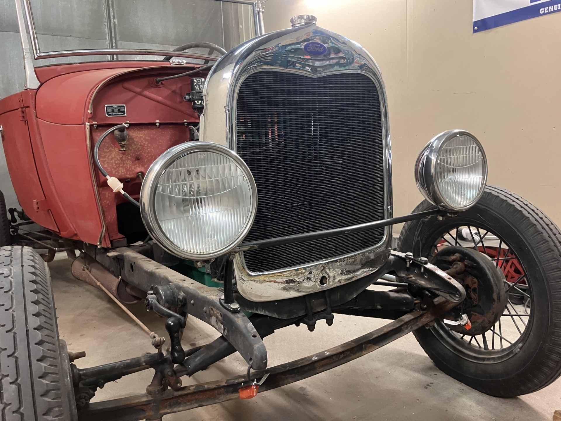

  7. Mikko_
    Joined: Aug 3, 2018
    Posts: 653
    Mikko_
    from Sweden
    Regarding the wood buck theory: Am I supposed to try it with the lid installed on the car or with it removed?
  8. Mikko_
    Joined: Aug 3, 2018
    Posts: 653
    Mikko_
    from Sweden
    Found a cheap radiator shell on FB marketplace just 40 minutes away so I went and picked it up this morning.
    Then I just had to mock it up and finish the headlight bar, nothing ground breaking but I'm happy with the result.
    I will most likely use some different headlights when the time comes but you get the idea.

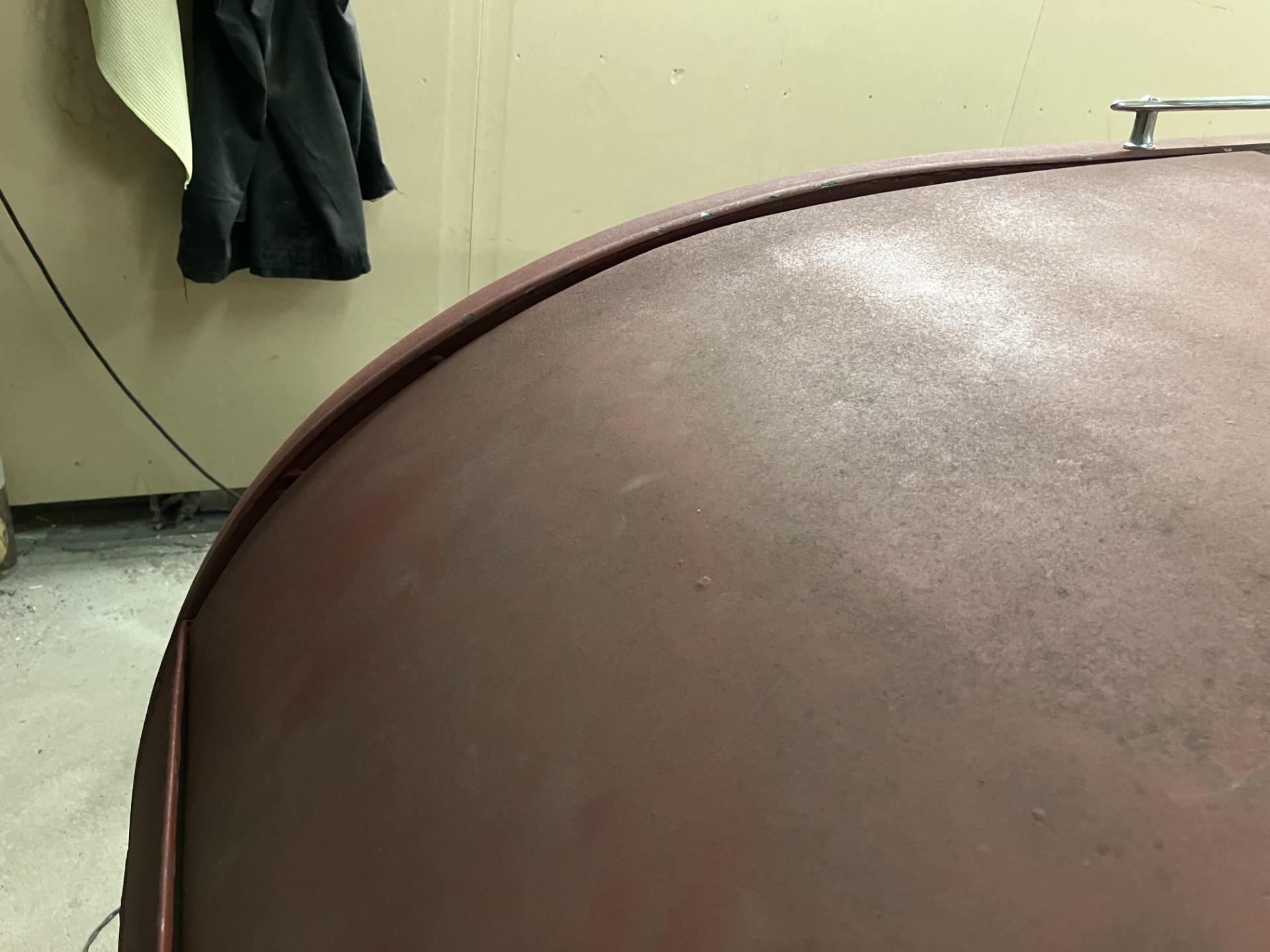

  12. Mikko_
    Joined: Aug 3, 2018
    Posts: 653
    Mikko_
    from Sweden
    Did some deck lid adjusting with the help of some wood blocks today.
    Still a bit low on the curved part on the left side of the car but something moved because now it closes fine without hitting the tulip panel.
    Might do some more adjusting tomorrow, might leave as is, we'll see.

  13. warhorseracing
    Posts: 2,832
    warhorseracing
    from cameron wv
    ^^^^^ When you are satisfied with it it's done. WARNING. Now that you have "felt" how much pressure it takes to move it be careful, go slow, easy does it. patience. Looking pretty good so far on the tulip panel so show us the radius on the quarter panel.

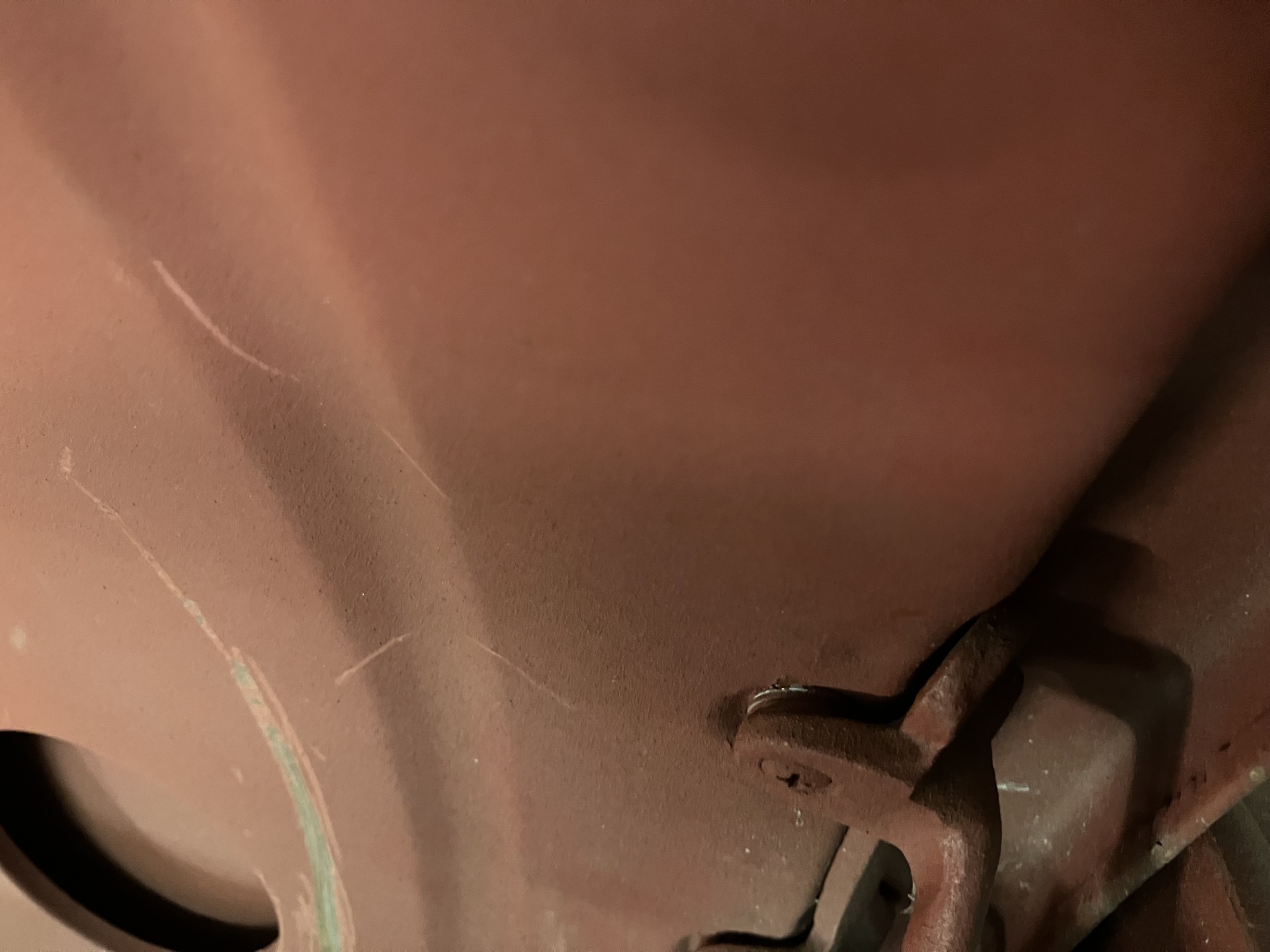

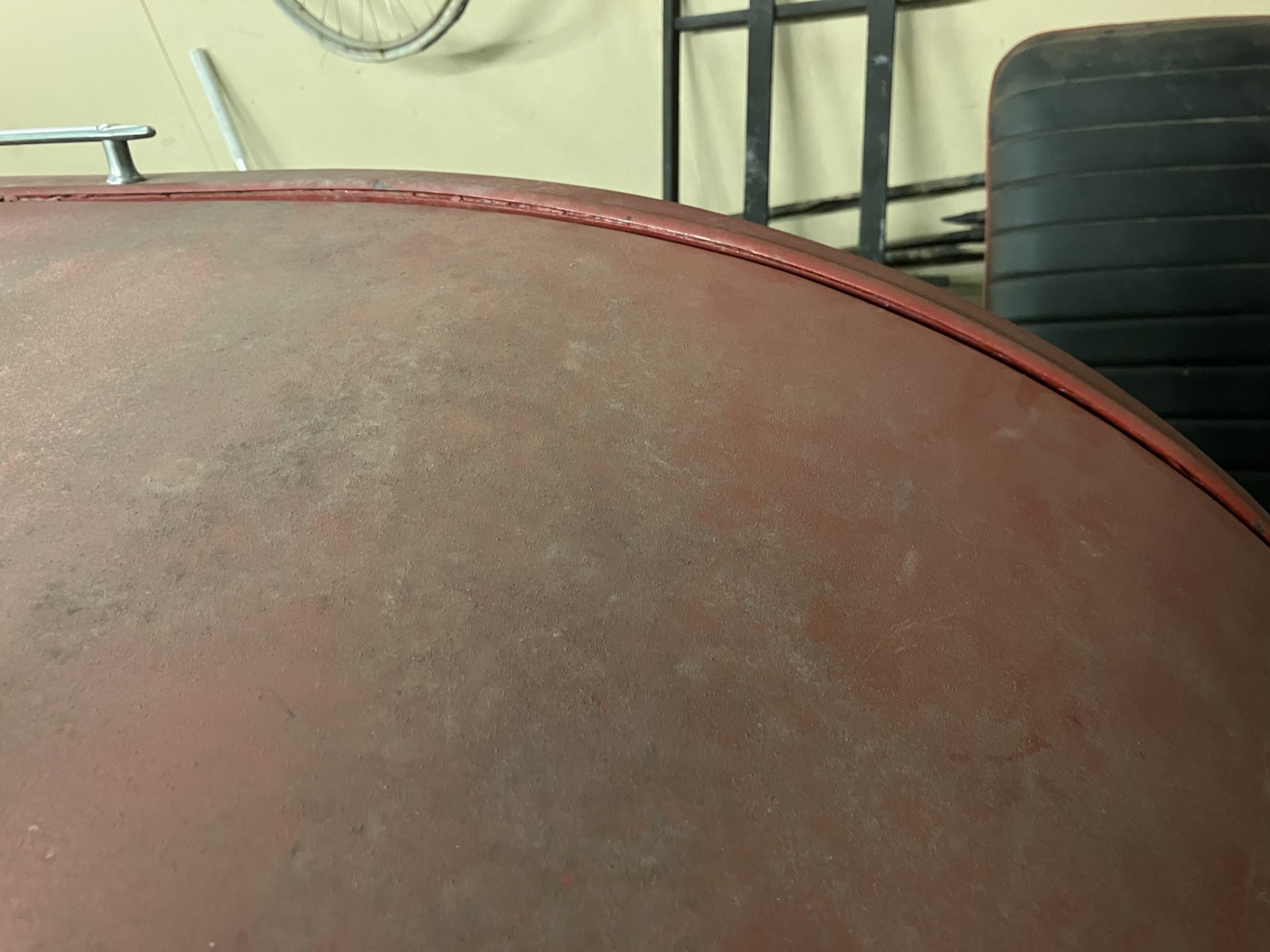

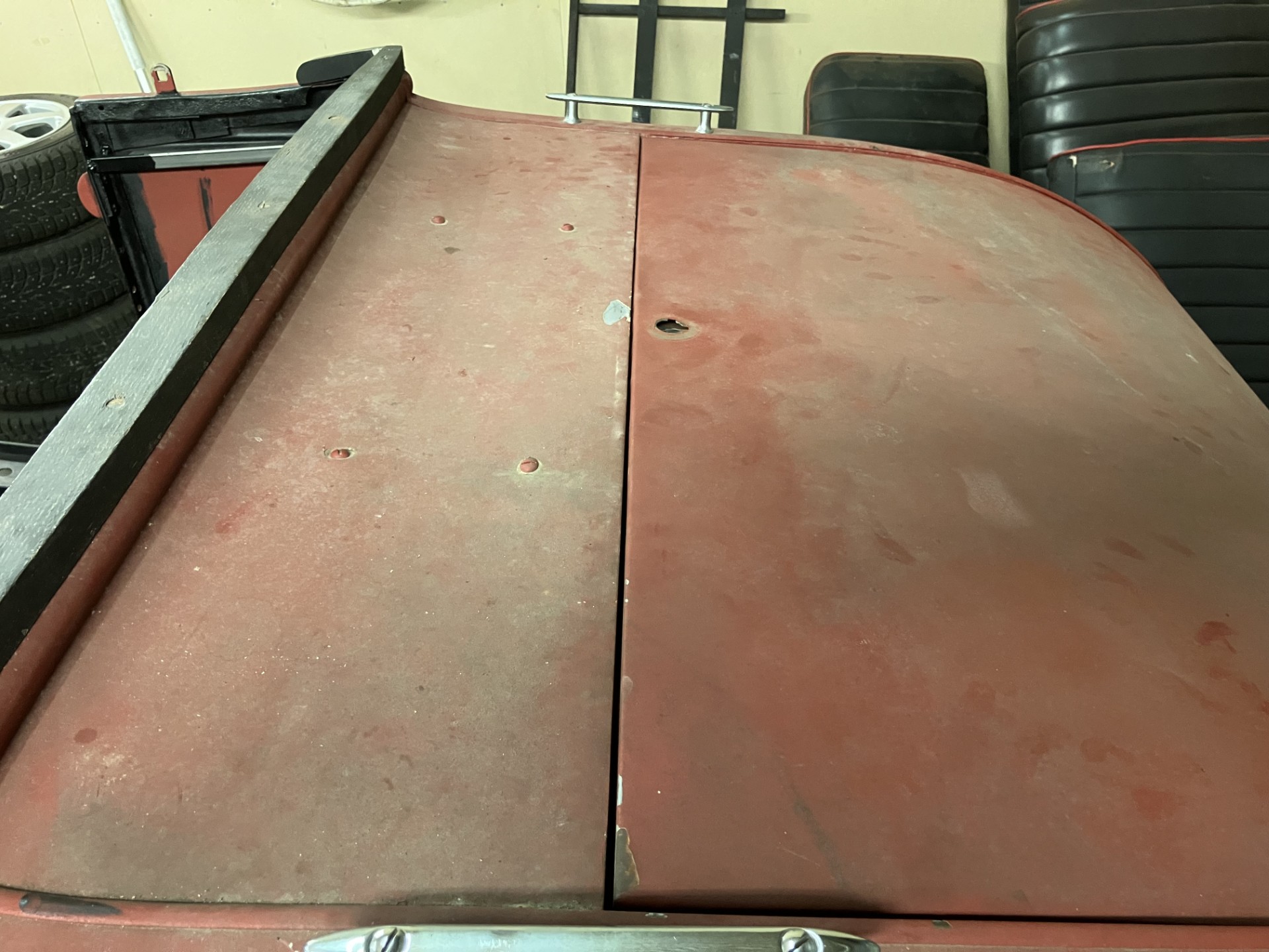

  14. Mikko_
    Joined: Aug 3, 2018
    Posts: 653
    Mikko_
    from Sweden
    Some pictures.
    P***enger side is good enough, edge along the tulip panel is good enough.
    Driver side still too low, thought about leaving it for now but bothers me more every time I look at it.
    I made a paper template of the quarter and that matches the radius of the lid so something with the hinge or hinge bracket is a bit wonky I think.
    Maybe I'll try and elongate the hole for the pivot bolt in the bracket, that should give me some more adjustment.
  15. patsurf
    Joined: Jan 18, 2018
    Posts: 2,588
    patsurf
    sure looks like tolerances stacked up wrong--people always say the old car fit and finish is poor-(no bodywork evidence there @top of quarter?)--not so much hinge as just metal that is diff.-
  16. warhorseracing
    Posts: 2,832
    warhorseracing
    from cameron wv
    From what you are showing in these pictures you may be right. The gap between the tulip panel is tight and the lower lid and rear valance looks off. The one corner does not look too bad but when you slide the lid back it will increase that gap in the tulip panel and correct it. Then the rear valance center section would look better but the lower corners stick out past the valance and require bending them back in. You have no idea what the car has been through in its' 100 year life and even if the parts are unique from the factory. My, aren't old cars fun?:rolleyes:
    That should help. At any rate you are getting to where you want it and learning along the way.;)

  17. Mikko_
    Joined: Aug 3, 2018
    Posts: 653
    Mikko_
    from Sweden
    @patsurf Can't see any evidence of bodywork inside the quarter.

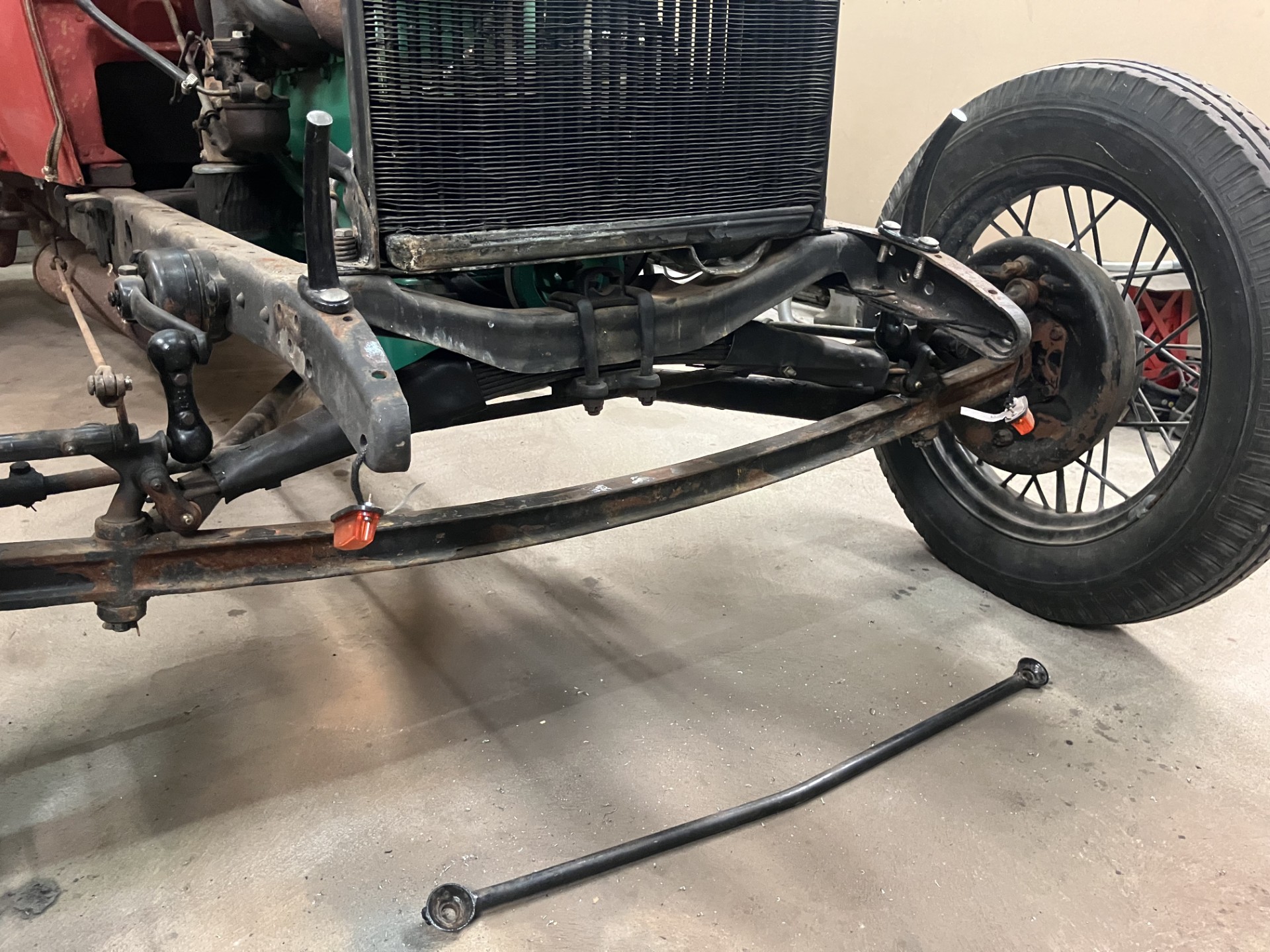

  26. Mikko_
    Joined: Aug 3, 2018
    Posts: 653
    Mikko_
    from Sweden
    Pulled the front end today.
    Ideally I would like to get a 32-36 axle, 32-34 spindles and 32-34 perches but might have to settle for just a reverse eye spring and pull out a couple of leaves.
    Parts are out there but prices are high here for anything that is '32 Ford compatible.
    Acres, osage orange, mvee33 and 8 others like this.
