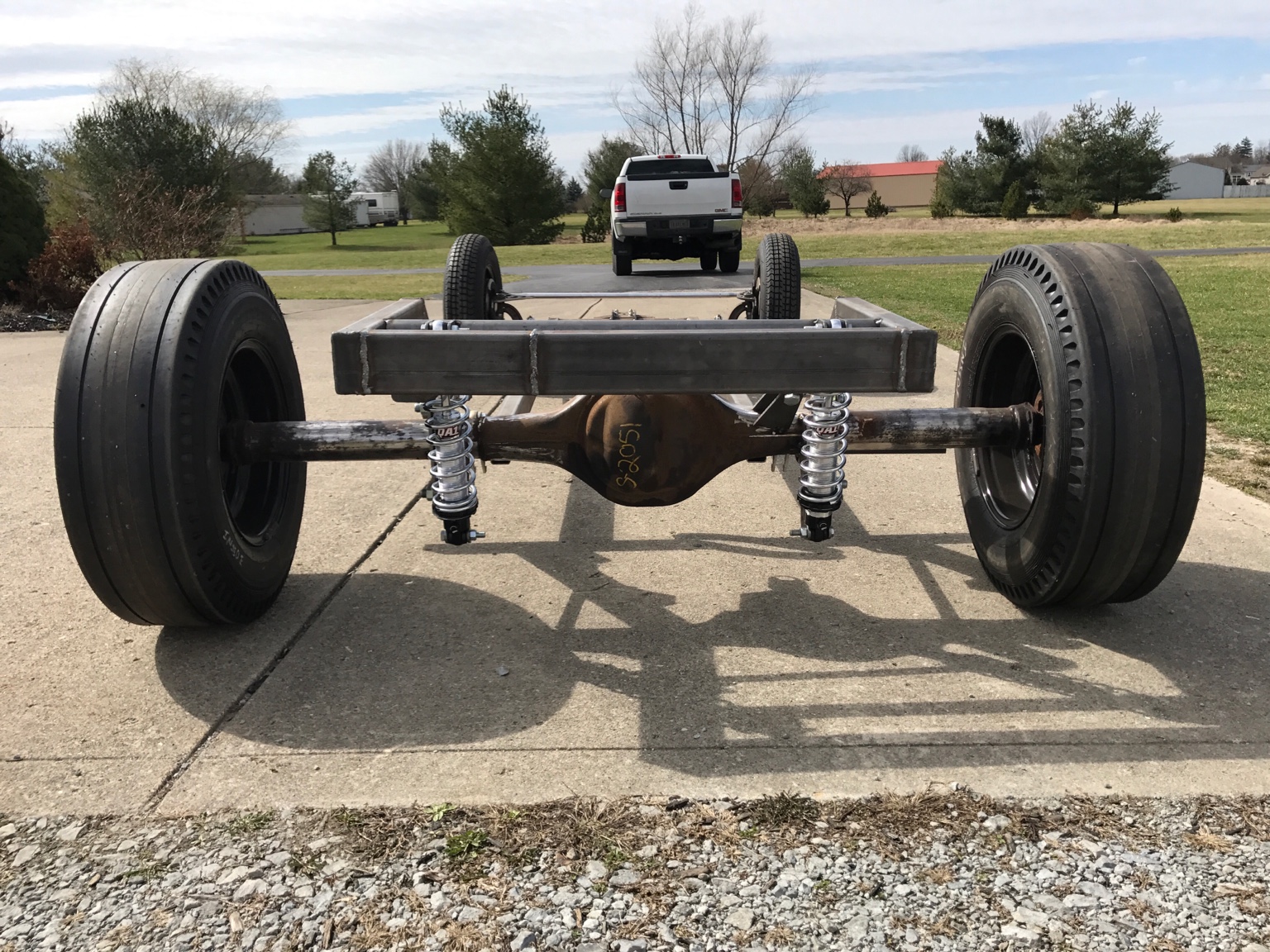

  23. JTRodder
    Joined: Jun 26, 2014
    Posts: 29
    JTRodder
    And finally my rolling ch***is, I don't know if any of you are still following my build or even care. It's taken me 3 years to get to this point. I just finished the rolling ch***is last weekend and when I get home from work I spend about 30 minutes staring at it before I go in, it's surreal. Still need to finish weld everything and chop the ends of the crossmember off but it rolls and I'm happy. Now I just need to get the body mounted to the frame. At ride height the bottom bar of the four link is level and the top is 3 degrees down, track bar is also level. Just sitting up high with no weight. (For those of you with a good eye)
    [​IMG][​IMG][​IMG][​IMG]
  24. After you put a tube into each hole and weld them in, is it really any lighter? It looks cool like that, but it seems to me that the whole idea of "lightening holes" is defeated. They're now "decorative holes."
