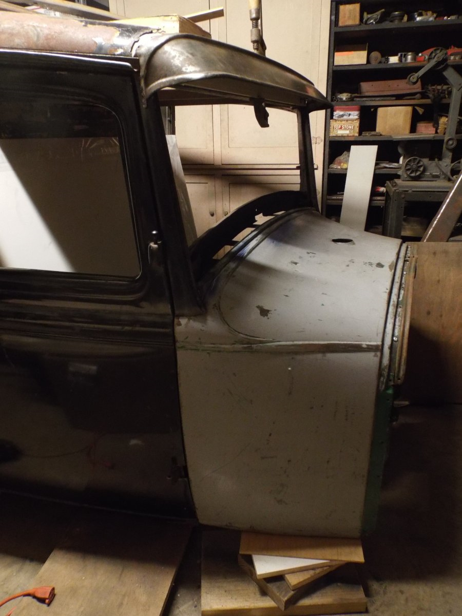

    Be sure to set the visor at an angle you like, Ford leaded them in on the Fordor. Bob

    [​IMG] got it tacked on, it was pretty ugly after I melted all the lead off
