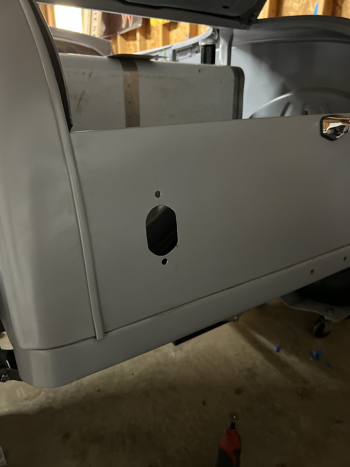

    rgrhoward

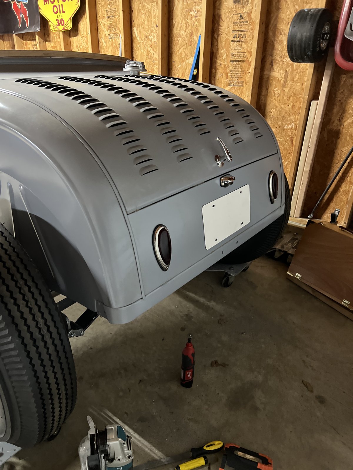

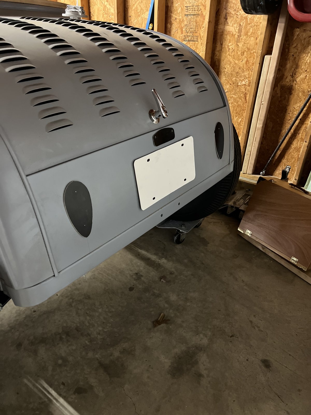

    Got my taillights done.
    877BA404-BA50-4403-B8B4-E9C4A32558BB.jpeg A3A45028-3236-4AE3-ACB6-7FA5343DE05C.jpeg 2B0AACE5-2CE1-46AE-B4EB-9038A8D6D12E.jpeg 73F8416A-7501-4638-BE93-A7B6CECC3163.jpeg

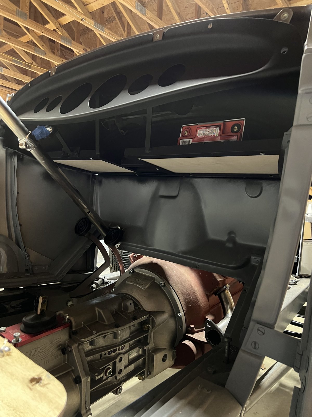

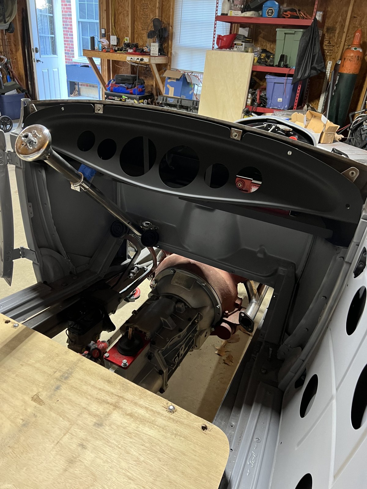

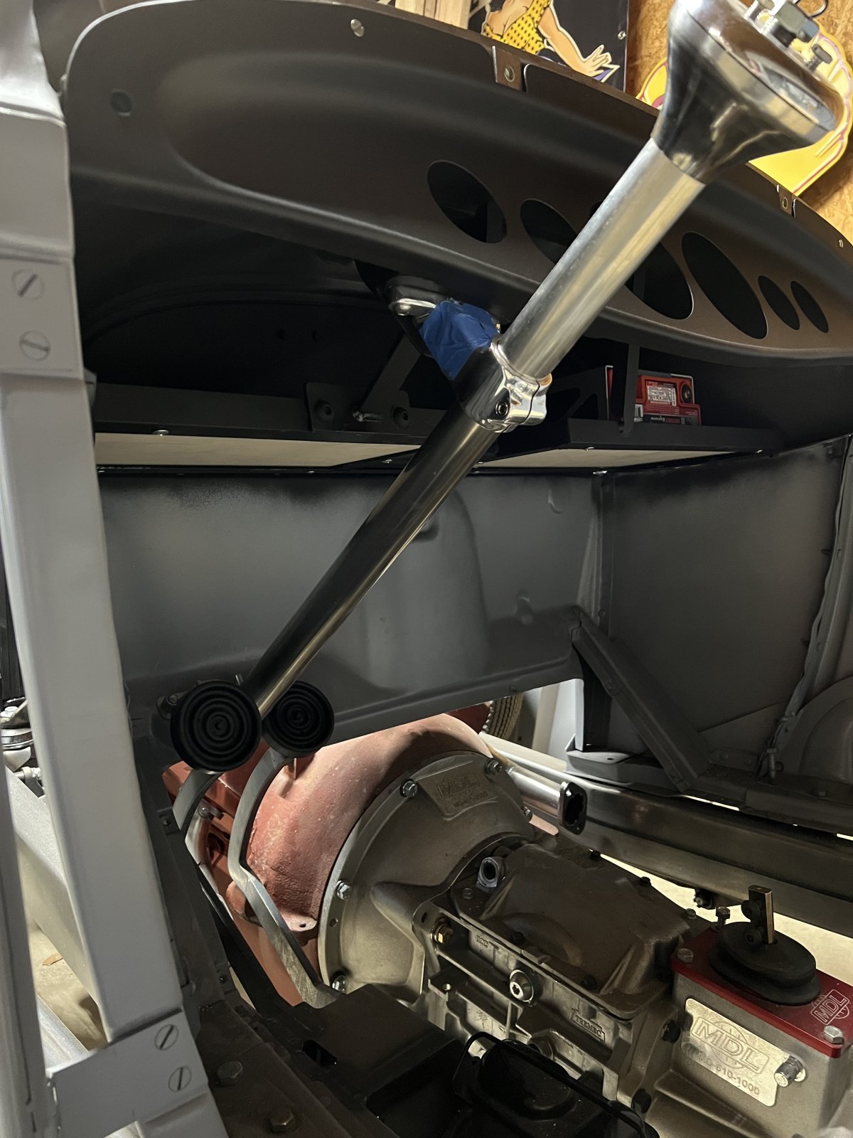

    rgrhoward

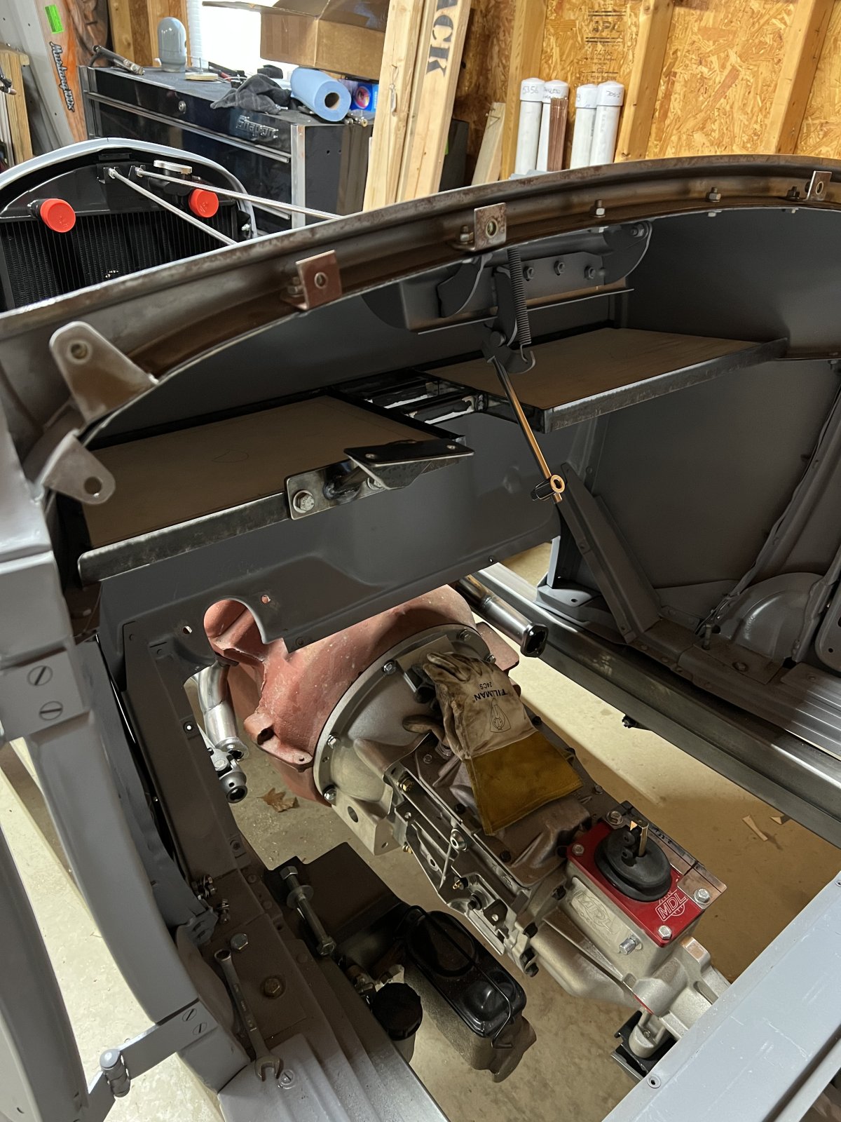

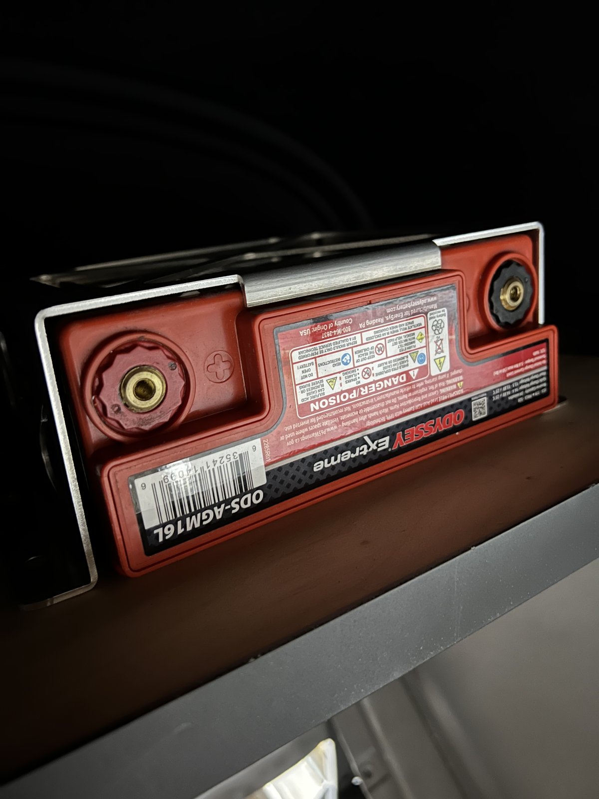

    Under dash storage / column brace is done. Think the battery has found a home. Got this little aircraft battery idea from a fellow hambr’. Should start a flathead anyhow.
    A909578F-981B-4CA9-ACB8-ECD7BFE51FB8.jpeg 7BFC3547-7968-4F69-A16F-3A41679C3E8A.jpeg FE53213F-9799-4E64-93B8-1C51BDF2A560.jpeg 07B593D2-4D48-4B48-91BA-213254BB2D0E.jpeg 857FD800-21E2-457D-BEF1-31976358595A.jpeg

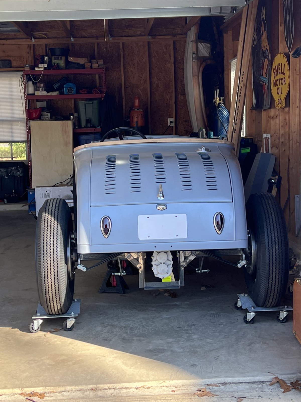

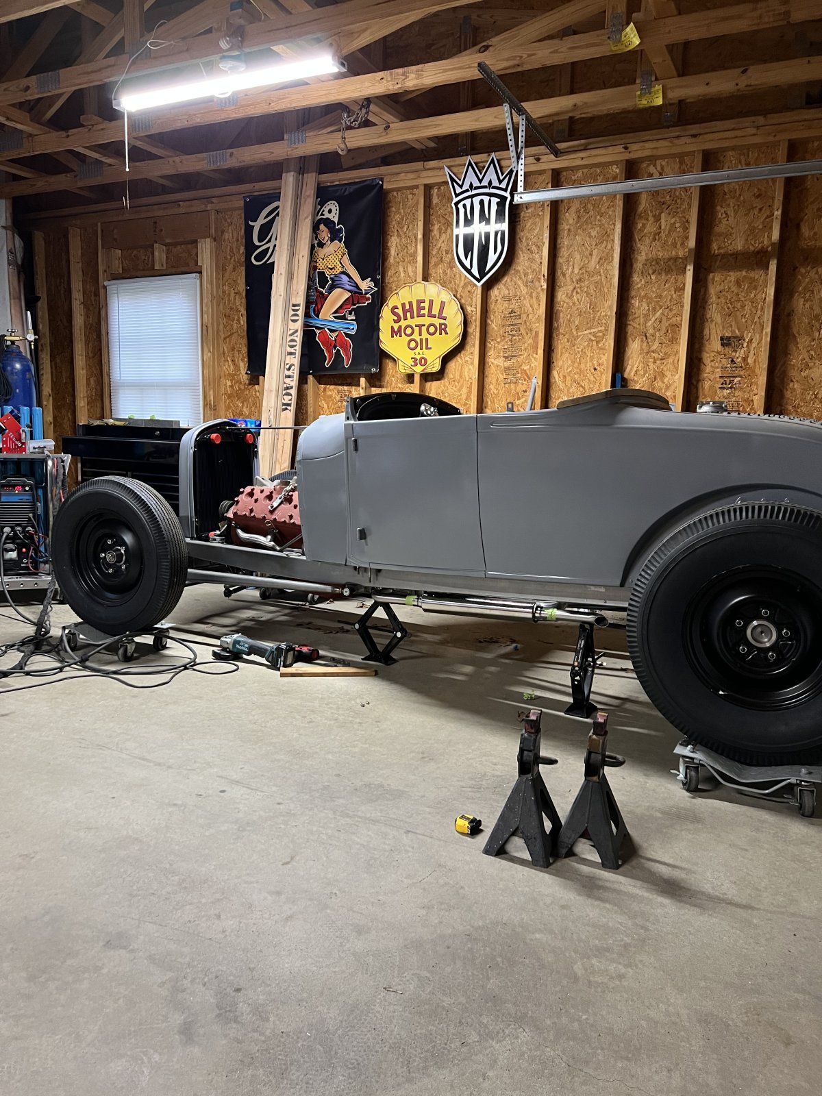

    Playing with some exhaust ideas. I’m hoping these porters make the exhaust bearable being so short.
    8CFFBB24-D102-4ABE-B86D-B84707B66EE2.jpeg 68231D98-285B-46F2-8690-E20BC91725A8.jpeg 48589EBB-BF17-4BE3-83DA-0F33B111458D.jpeg

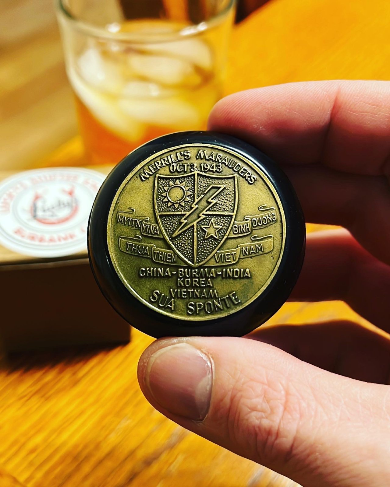

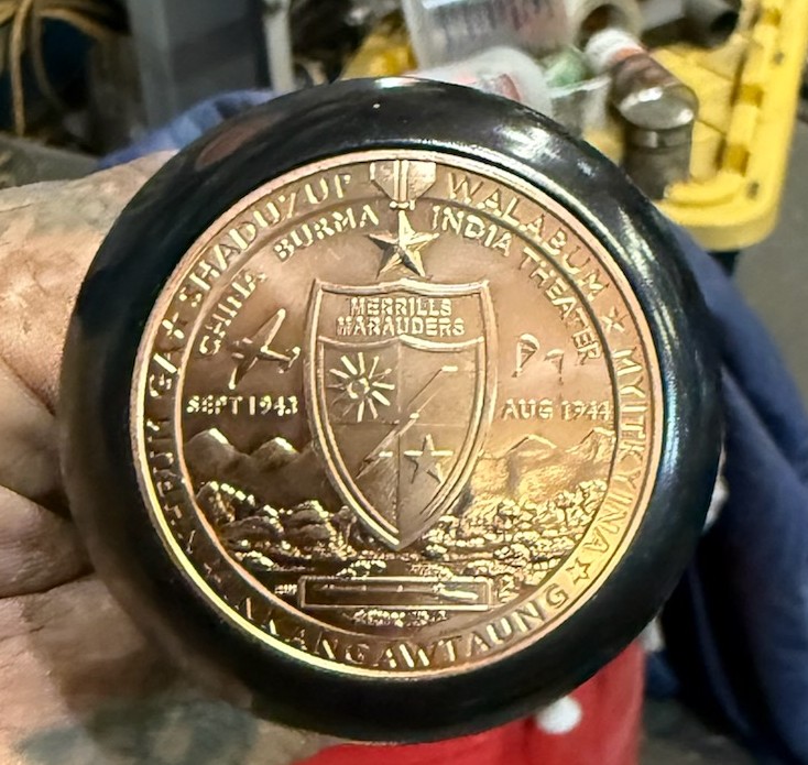

    Lucky Burton knocked my shift knob out of the park. RLTW. E7781ECF-A7D8-46E1-8027-E3782C042563.jpeg

    1 3/4
    lothiandon1940 likes this.
  8. caprockfabshop
    Joined: Dec 5, 2019
    Posts: 696
    caprockfabshop
    So yours will be even quieter than mine. I think you could be ok. Turning them out vs down prevents any droning as the exhaust hits the pavement and bounces back into the underside of the body.

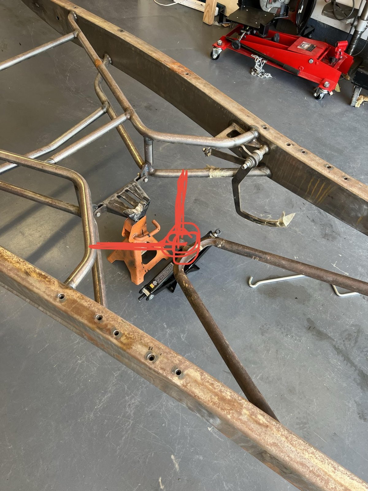

    from KCMO

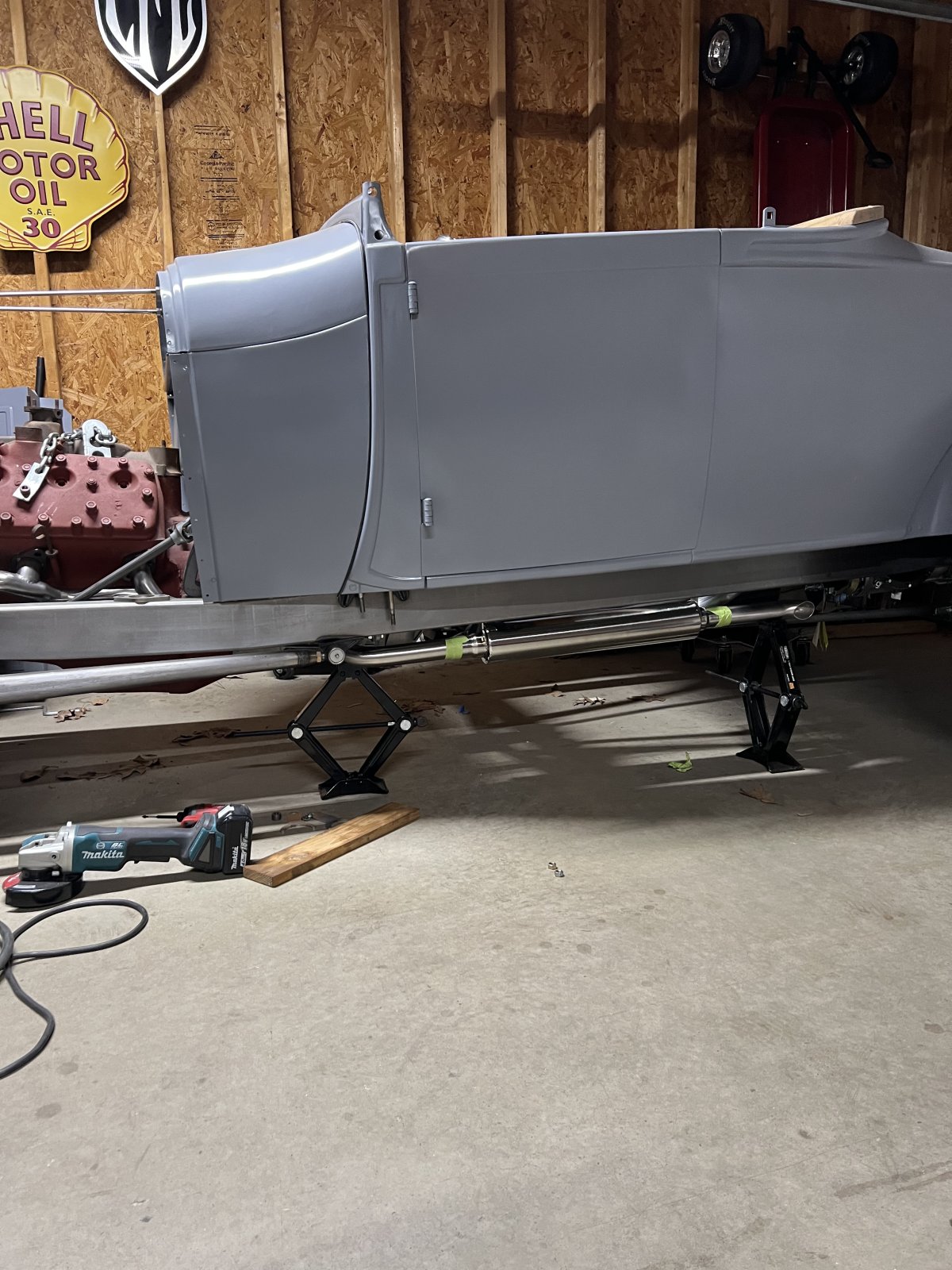

    Slick looking hot rod! Curious what the square around the quick change is that we see from the rear?
    rgrhoward likes this.
  11. rgrhoward
    Joined: May 20, 2010
    Posts: 258
    rgrhoward
    just some bracketry to keep the spring mounts where they need to be until I finish weld it.

    Cool!My dad served with Merrills Marauders and my older brother got me a Merrills Marauder Medal for Christmas and I was thinking of having a shift knob done like yours for my Model a Roadster.[​IMG]

    I finally had Lucky Burton do a shift knob with my Merrills Marauders Medal.My dad served with Merrills Marauders in WWII IMG_2006~2.jpg
