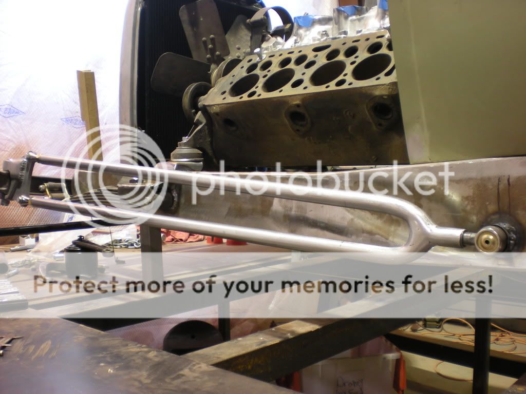

    Am making the same style rear suspension and thought it would bind also. Would a tie rod end on the front of the radius rods solve the problem? P.S. Looks real good!
  10. need louvers ?
    Joined: Nov 20, 2008
    Posts: 12,901
    need louvers ?
    No different that the rubber or urethane bushings on the front. The amount of "bind" in this suspension set up will be close to absolute nil, and will be taken up in the bushings at the front of the radius rods. As a matter of fact, a small amount of "bind" can help settle some of the liveliness in a rear suspension. You just don't want to present so much that it effects the major components such as the radius rods and axle housing. A good example would be if you took these same radius rods and split them all the way out to the frame. at that point, all of the "bind" would translate into "flex" in the radius rods and axle housing, which would try to act like a torsion bar. Not good. But set up as is, just about perfect...
  11. need louvers ?
    Posts: 12,901
    need louvers ?
    Not wanting to come off as the be all suspension expert, (got a good friend on here who is!) I wanted to point out a couple of things that caught my eye on this set up. Notice that both ends of the radius rods (or wish bones, if you prefer) are mounted in double shear. That means that both sides of the suspension bushing is supported and through bolted. I can't remember the equasion mathmatically, but that just about doubles the strength of the joint and worth doing when you can possibly do it. i thought about that specifically because of your question about tie rod ends, Marvin. The other to notice is the radius rods are triangulated, i.e. one mounting point at the front, and two at the rear splayed up and down, about 3 to 6" apart. This going to control axle wrap up as the car decelerates and accelerates. Sorry, didn't mean to highjack your thread Salt flats speed shop, just saw some stuff to answer. like your stuff and can't wait to see the tudor!

    Nice build and I appreciate you using my products. To answer everyone’s question there is NO bind in this setup. It uses custom spherical bearings from Aurora like you would find in a rod end. Also it requires the use of a panhard bar to control side movement of the rear axle.

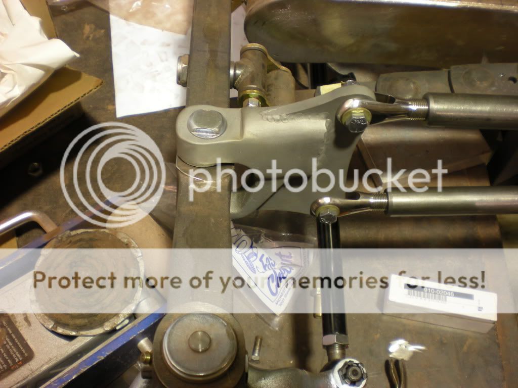

    I worked today on getting the tie rod mounts in the frame. I sleved in a piece that already had the 7 degree taper into the side of the frame. Then from the back side I welded in a tube so that there is access to the nut. Then I made a couple simple aluminum caps that will cover the hole.
    Also getting the pieces together for the hairpins. The front wishbone is finished and the rods are tapped. Im just waiting on the pieces for the tie rods and i'll start putting it together.

    I got started on making the hairpins. I got the top and bottom rod welded onto the tie rod stud. I have designed the inside web and ill get that waterjet cut.

    I got the webbing back from the water-jet cutters. It really finishes off the hairpins. Also got the new rear wheels on the car.

    I got the webs welded in the hairpins so they are finished now. And I also got the front shock mounts done.
