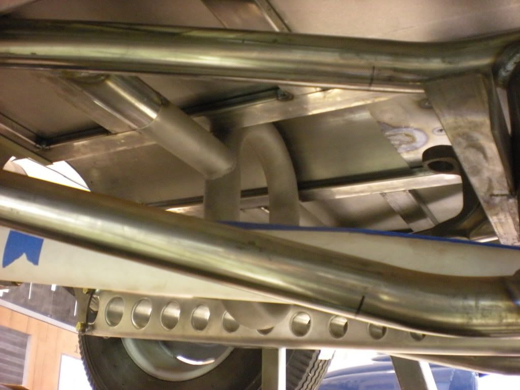

    Chris, Got to love the shock brackets and the web for the hairpins. Did the webs have to be that thick to do the job on the hairpins ? What thickness is that ?

    The webs are 1/4" thick. It probably could have been made out of a little thinner material. But with all the holes in it I wanted to be on the safe side, and with it a little thicker the thickness of the inside of the holes looks a lot better.

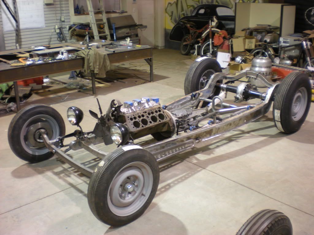

    I got the front bar removed and the front frame horns bobbed back in line with the grill.

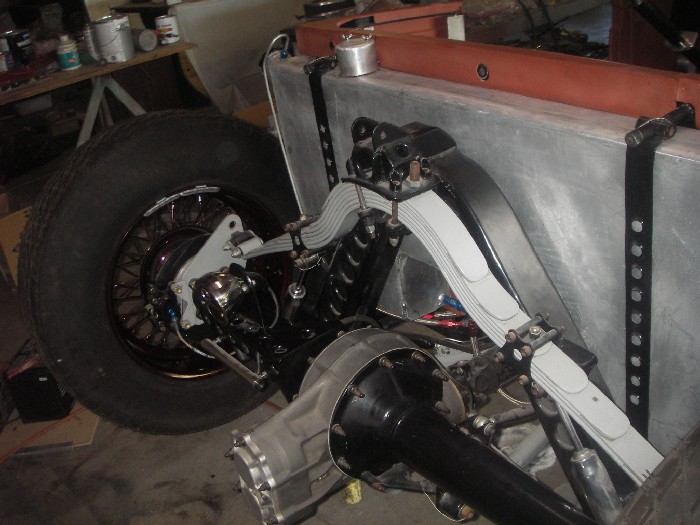

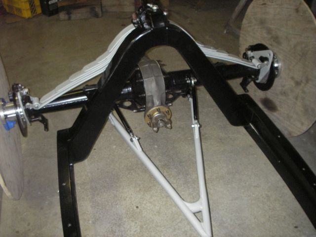

    I would like to make a kind of late comment regarding your rear suspension. Alan Johnson stated that you need a panard rod which is not really true when you have a cross spring as you do on the rear. If you set the spring/shackles up correctly the rear spring will do a pretty good job of keeping the rear end in place from side to side. Mostly because your car is going to be light and the spring is pretty stiff if you push on it from the side. My rear suspension is a single "Y" shaped control arm that has a single 3/4 inch heim joint at the front, a cross spring (Model T) no panard rod and I have absolutely no problem with the back of the car getting away from me.

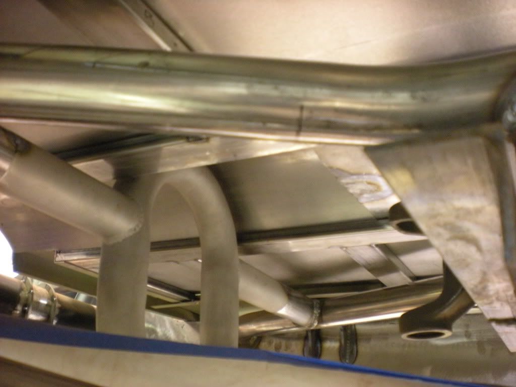

    Ive been working on the floor area of the cab. I fabricated a drive line loop and got it installed in the car.

    I got the car off of the frame rack and on the ground last night. Its so nice to see it on sitting low instead of 3 feet off the ground.
