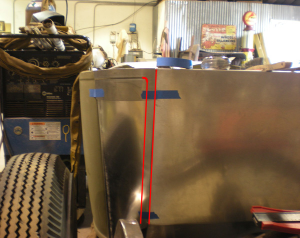

    Here is a s**** piece that I put a bead in and tapered out before it got to the gas tank. What do you guys think?

    That's JUST what it needed!

    Would it work rounding it up to the top? To me, it looks incomplete.

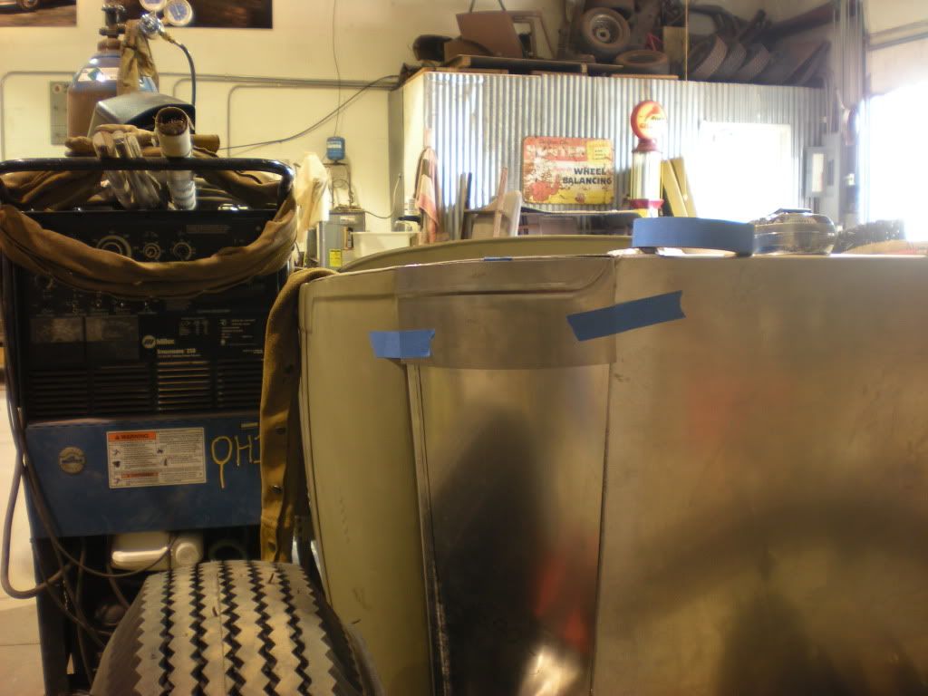

    I took that piece and rounded the end. What do you guys think?

    I think you need to get the owner to fork over a few more bucks to make the tank match the belt line. :D What are we talking about, an aluminum strip welded and blended into the tank? I know you're completely able, do you think it'd look better?
    I do think it looks more finished off, however, it looks modified, you know? Whereas if the beltline went all the way it'd look factory.
    I don't know, that's what I'm thinking. What do YOU think?

    Looks great with the rounded bead - ties it in with the other step in the body line behind the door. Great work.
