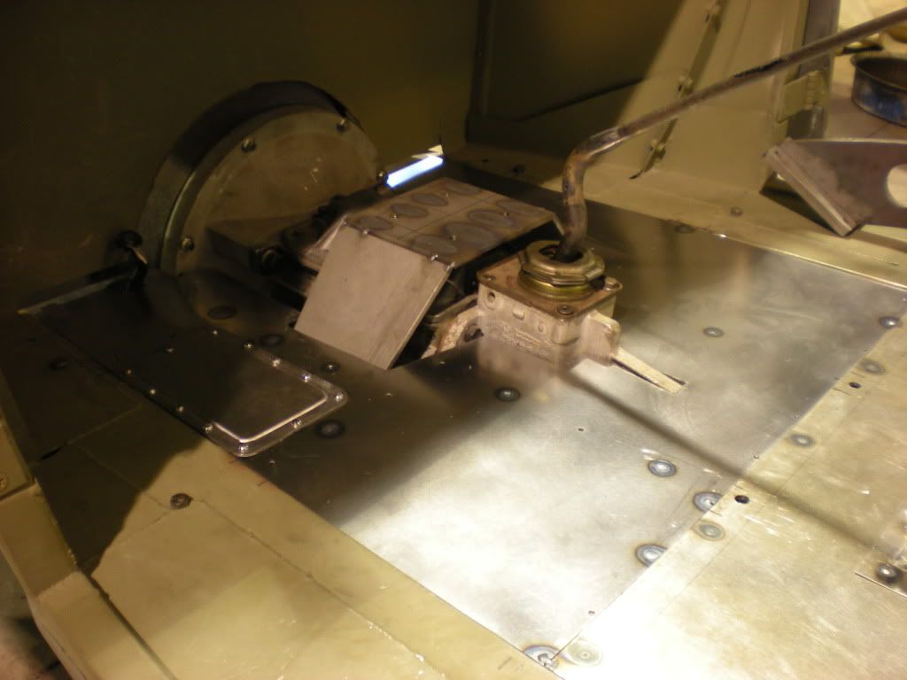

  10. Salt Flats Speed Shop
    Joined: Sep 30, 2007
    Posts: 1,474
    from Utah
    I got the front part of the floor made. Put in an access panel for the brakes. Now its on to the trans tunnel.

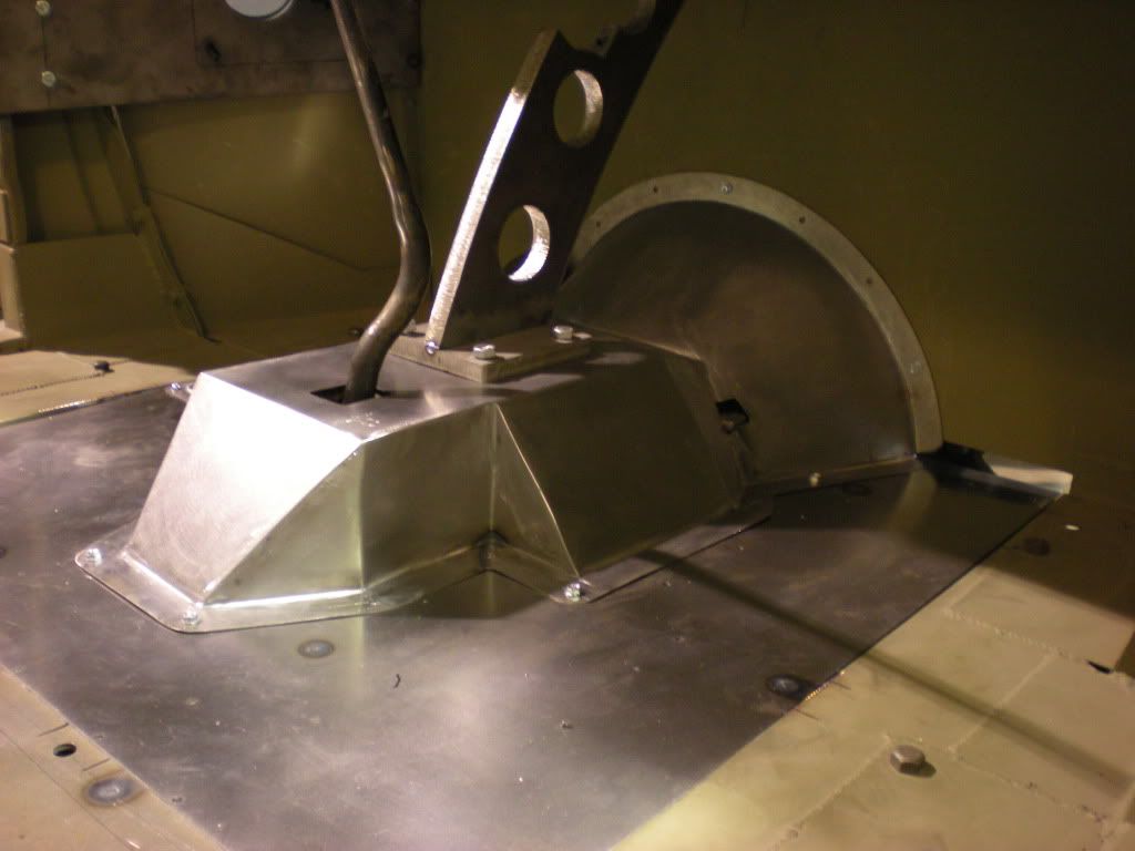

  11. Salt Flats Speed Shop
    Posts: 1,474
    from Utah
    Started on the trans tunnel. Kind of a lot going on trying to make it fit around everything, and also make sure that the steering brace can bolt through it.

  13. Salt Flats Speed Shop
    Posts: 1,474
    from Utah
    I got the trans tunnel pretty well finished up. Kind of an intricate piece where it had to go around so many different things.

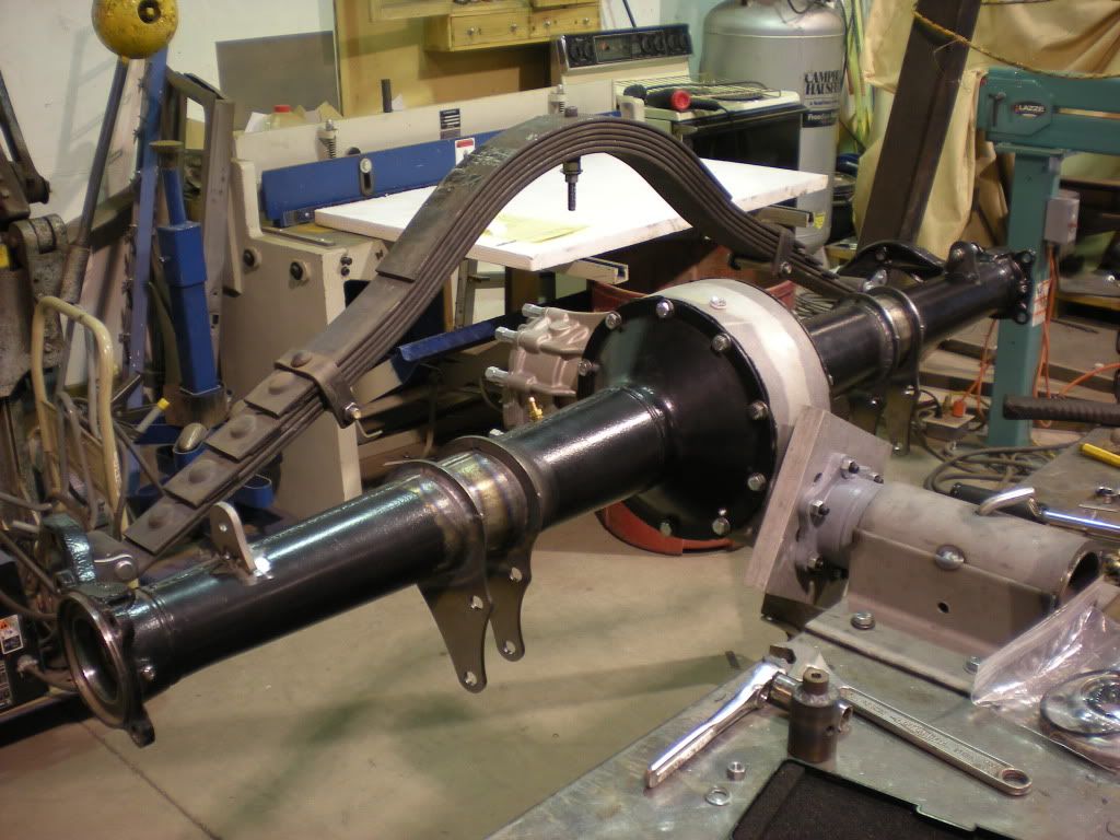

  25. Salt Flats Speed Shop
    Posts: 1,474
    from Utah
    Iv'e been working on re-setting up the rear axle. When I got it the spring was mounted in front of the axle, and we ended up switching it to the rear. So I re-checked all the bearing preload's and got the axle back together again.
    I made a fixture that allows me to bolt the front of the quickchange. Then I can spin it either straight, or on its right and left side. It sure made it super simple to set up the quickchange. I then had to make a simple bracket that changed the bolt pattern from the winters quickchange to the ford bolt pattern so I could bolt it up.
