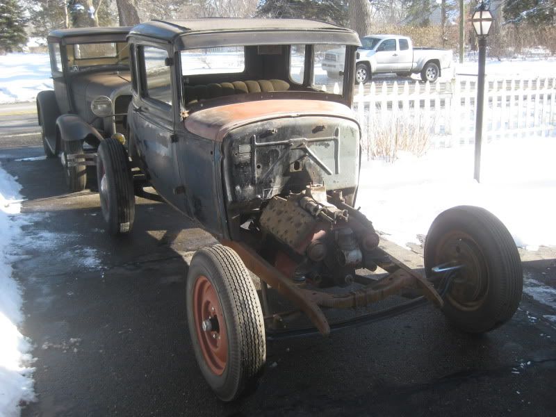

    Thanks guys, my pops is really excited. Last week when he was over I found him sitting in the body holding the merc steering wheel like he was driving! Today I put the two factory front body mounts back on the frame, they were taken off by the previous owner. Ordered up some new body mounting blocks too as the originals were a little rotten.
    This is what happened to the original ch***is, it is now in Iowa and under this former coupe turned roadster.

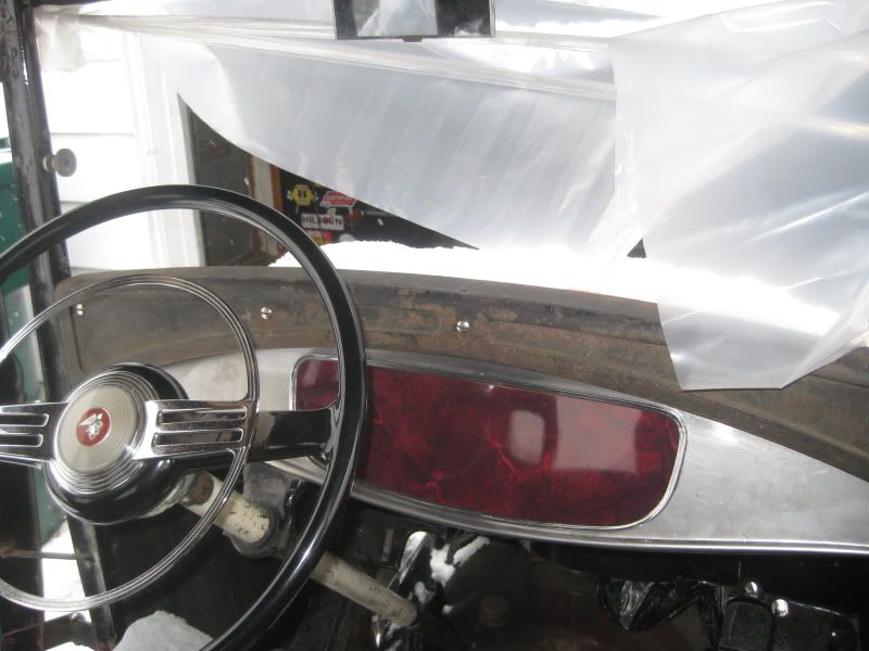

    Today I did a little work on the dash. I had a 36 dash for the car but I was missing the waterfall trim and I really did not want to spend any more money on it so I sold it and bought a repop 32 style dash and had enough money left over to buy this dash insert. I think it is a 33-34 Buick. I made the red insert for it at work but do not know if I am going to stick with it or try tortise shell. Haven't drilled it for gauges yet so it looks kinda funny.
    I also got the pitman arm/draglink figured out, I reversed the F-1 pitman arm so that the ball faces the frame (like a Model A) and I dropped the steering arm on the spindle a bit. It works great and looks kinda stock which was what I was going for.
