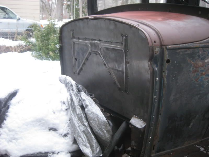

    Worked on the firewall today and I gotta say I am super happy with how it turned out. I tacked the original firewall to some heavy angle iron to hold the shape. I marked 1 inch up and cut around the permeter but left the feet on it. I then took some 16 gauge and used the part I cut off as a trim template. I removed the ribs from the original and put them in the new one to give it more of an original look. I didn't really loose any foot room either. I now have tons of room at the back of the engine and won't have to angle the breather at the back. What do you guys think?

    I think it would of been alot easier to make a flat fire wall, But easy is not why we build these things ourselves. Now you have a very good looking fire wall, with the clearance you need and some added strength to it. Well done.

    The firewall looks good, nice idea on using the original beading.

    I know it would have been easier to make it plain and flat but I think it wouldn't have looked right with the style of the build. Once the firewall tags and radiator support bracekts are added, I think it will fool some people. It isn't finished yet as evidence from the tack welds but I wanted to see what it looked like and if it fit like the original one did. Fits perfect and only cost me $18.00 for the steel and 6 hours of my time.

    Firewall looks great ! i like the factory ribs! great idea

    Nice job on the firewall. my original has cracks at the radiator support brackets, it may help if you reinforce it there, so you don't end up with cracks just my .02 C:rolleyes:

    Finished up the firewall today, wow 10 hours of my time for something I could have avoided by mounting the engine a little more forward. Oh well, I like how it turned out. I also moved the toe boards in (toward the seat) about 3/4 of an inch so that I can run a stock style wood floor without hitting the engine/trans. I sat in after I was done and I honestly cannot notice any foot room that was lost. I think this week I will be buying the grill shell for it. Going to be running a filled 32 shell with a stock style insert.
