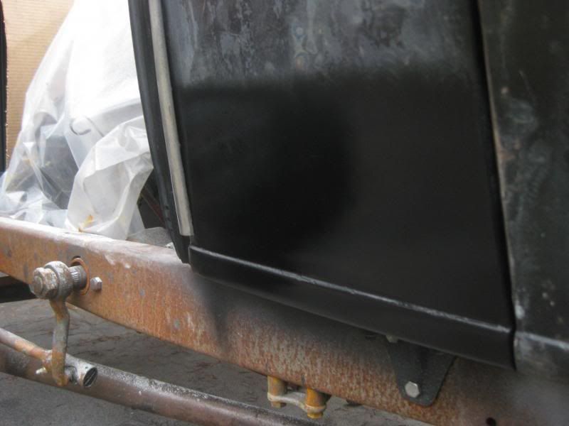

    My T is also going to start to get worked on so the updates for this might go slower than they were but we will still have stuff to show. We started tackling the subrails where they were cut to clear the z in the frame. We had to remove the lower front quarter and wheel well to do this and we found some rust in the outer subrail behind the lower quarter. We replaced the rotten outer subrail and fabbed up new pieces to go over the z in the frame.
    It may not be the prettiest but it works. Put in new lower quarters and new wheel wells and pretty much have the driver side done. Also made a mount for the taillight using the existing fender brace holes. Now we need to do the p***enger side.

    Over the weekend I poked the front lower quarter with a screwdriver and it went through it. I cut out the bad and welded in a new patch. Driver side now has no more rot! Going to tackle the other side next. Even though I thought this was a super clean body, there is still some areas that need attention.

    Hey Chris, the hole is the stock A hole but the stock mounting holes have been moved from stock.

    My 31 roadster needs lower cowl panels and my metal skills are so so. Did you fabricate those with a bead roller? The purchase items I have seen usually don't match the lower detail very well.Yours look perfect
  17. olskool34
    Joined: Jun 28, 2006
    Posts: 2,636
    olskool34
    They were actually given to me by an old timer that stops by so I have no idea how old they are or who made them.

    Olskool, I like the way that you modified the rear subframe to fit the kick in the frame. Are you planning to use the wood blocks between the body and frame similar to the stock mounting? Thanks for the info. Keep up the great work! CTJ

    I like how you modifies the rear subrails for the kick up. It's how I did mine

    Thanks! Actually, I just sold the T body because I decided to use the front half of a touring and build a 20's style lakes modified instead. This weekend we tackled the p***enger side front cowl patch on the A and it is done. Next is the p***enger side rear wheel well and then pull the body for prep work before paint.
