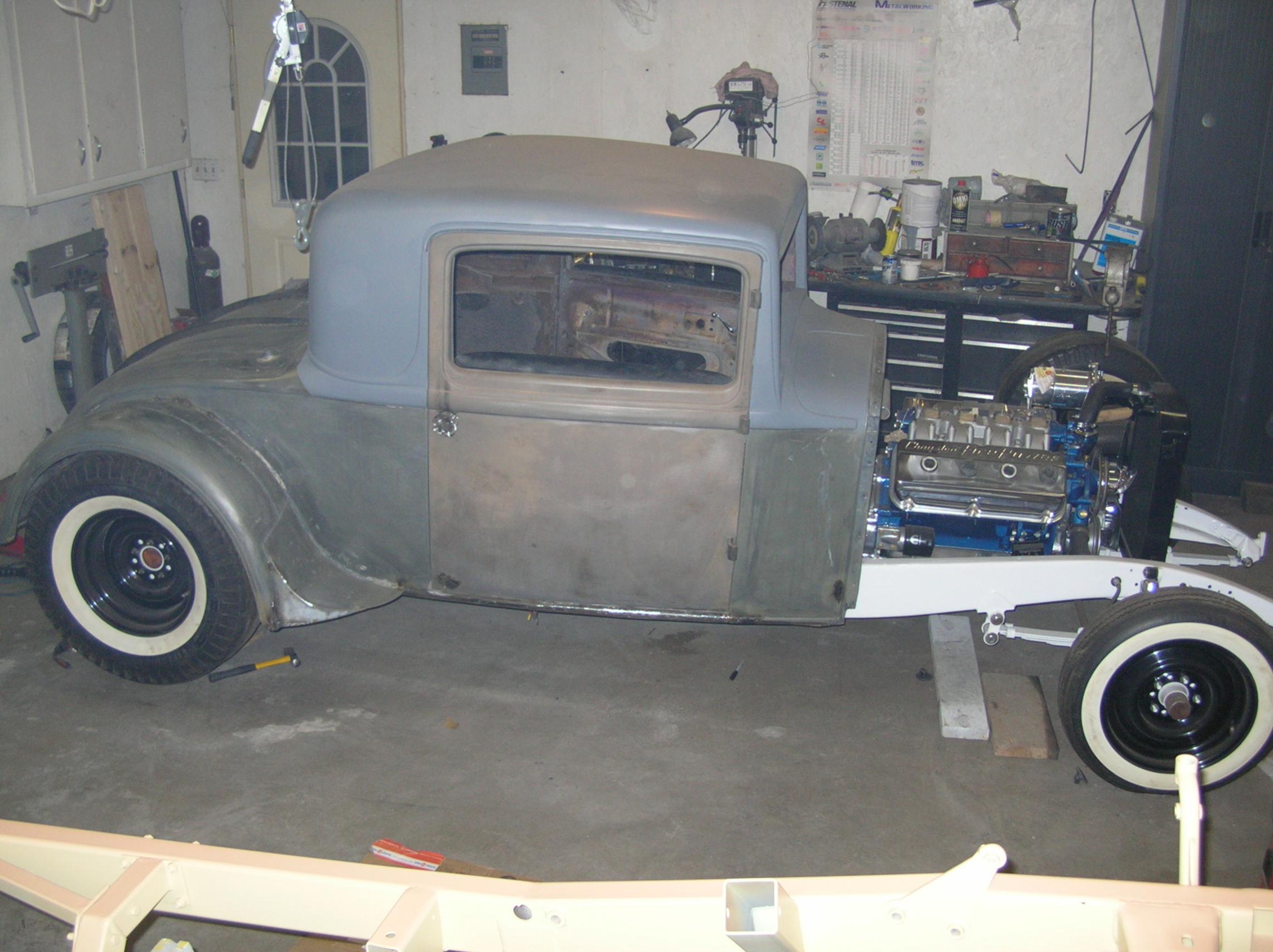

    The Build is back on. I had to take care of some customer project and was just plain worn out! Here is a cheesy mock up for now! I have since found different hub caps for it. The exhaust will be alot higher lake style. The grill will be much tighter they are just propped up for now. I have also straitened out the grill shell since this pic. More pics to come! Doing the sub floor

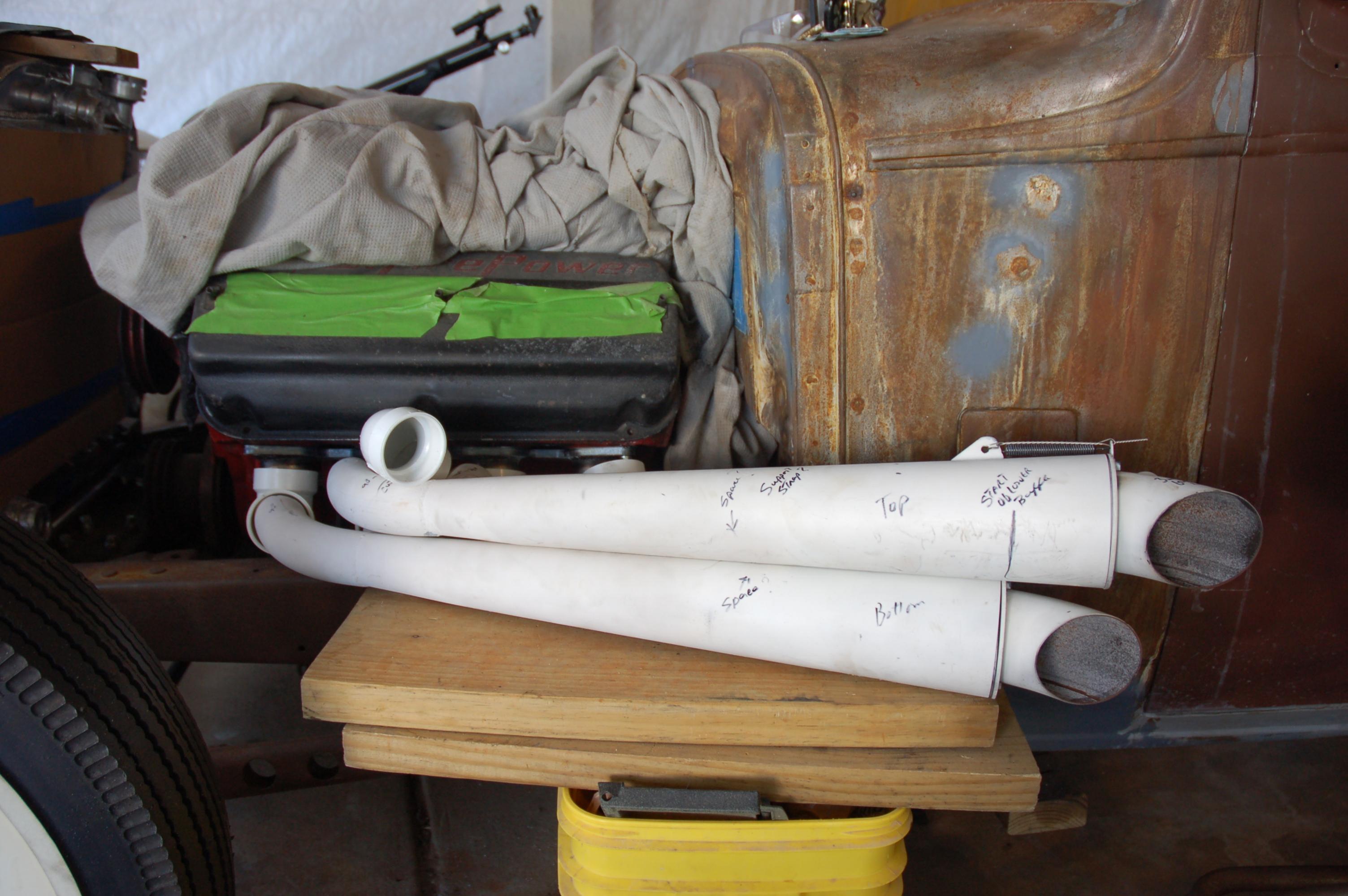

    This is the start of my header mock up. I bought these headers were on a big block chevy the ports are slightly off and of course the angle is going to have to be corrected I purchased Hot Heads Header flanges with two inch extensions so I need to cut down some bends from speedway and start figuring this out. I also bought 2 inch alignment sleeves from ****** for welding the pipes together which will help hold it together while I weld it.

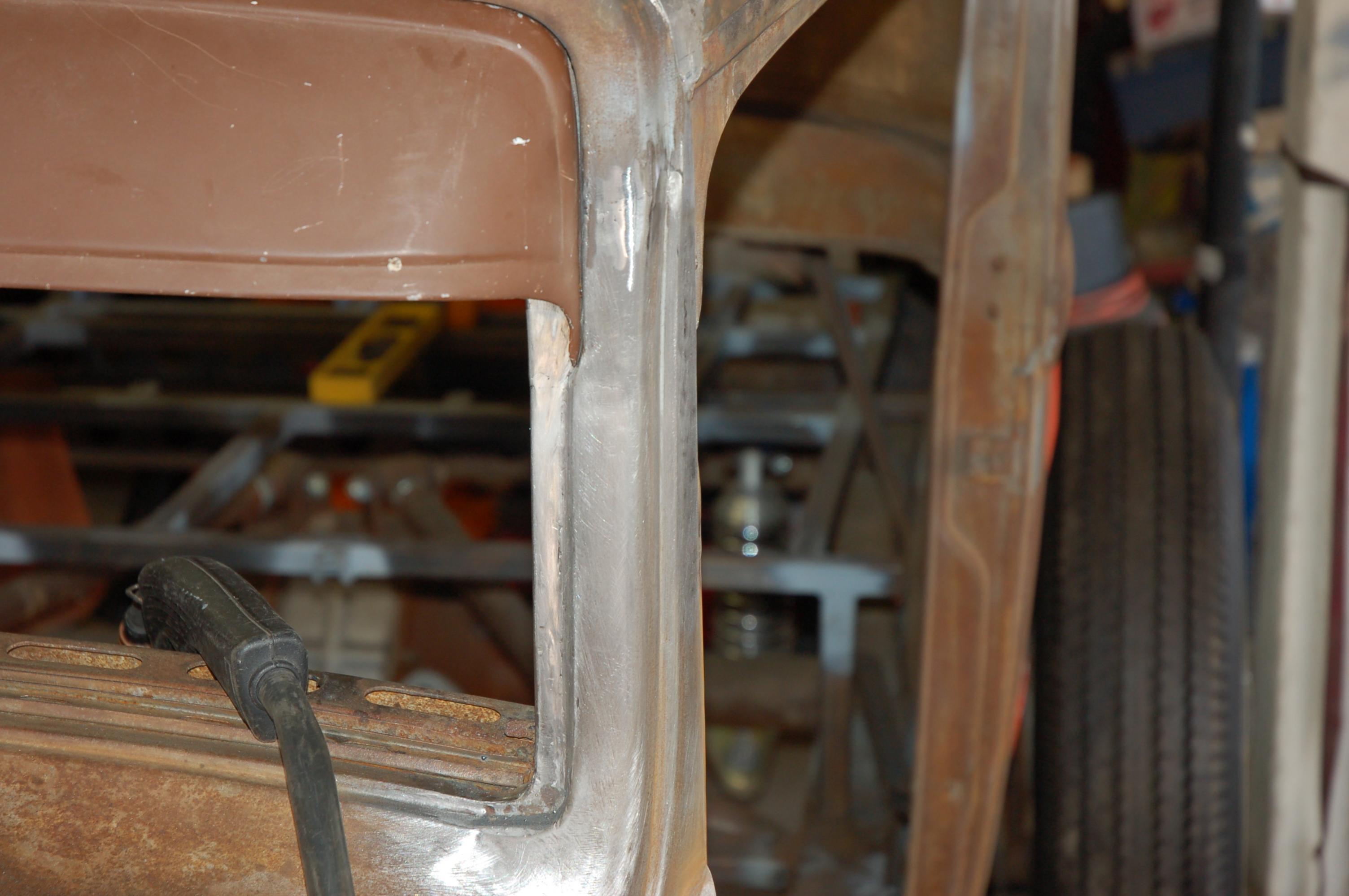

    During the chop

  18. Dirty30Dodge
    Joined: Jan 10, 2009
    Posts: 698
    Dirty30Dodge
    Lots of finish welding to do. Then I have to set up the head light stands and the upper shock mounts, flooring, steering box, finish the headers then take it all apart

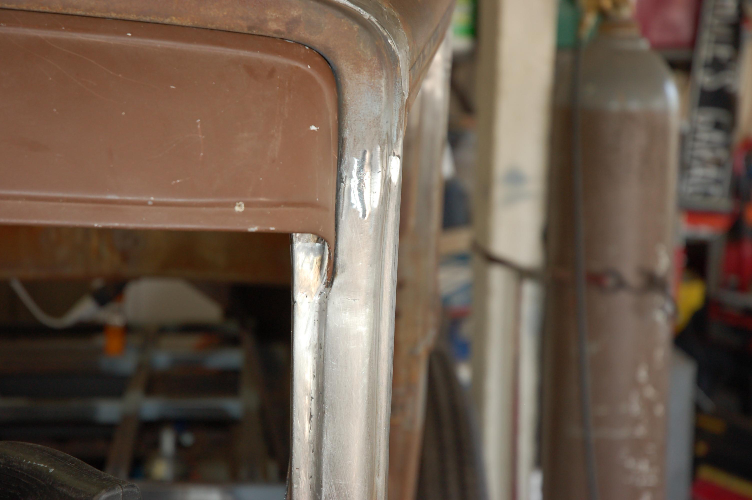

    The chop is finished other then the detail finishing. I hid the taper issue right at the visor looks ok to me. I am a little rough with the grinder. And I figured I at least had grinding mastered by now LOL

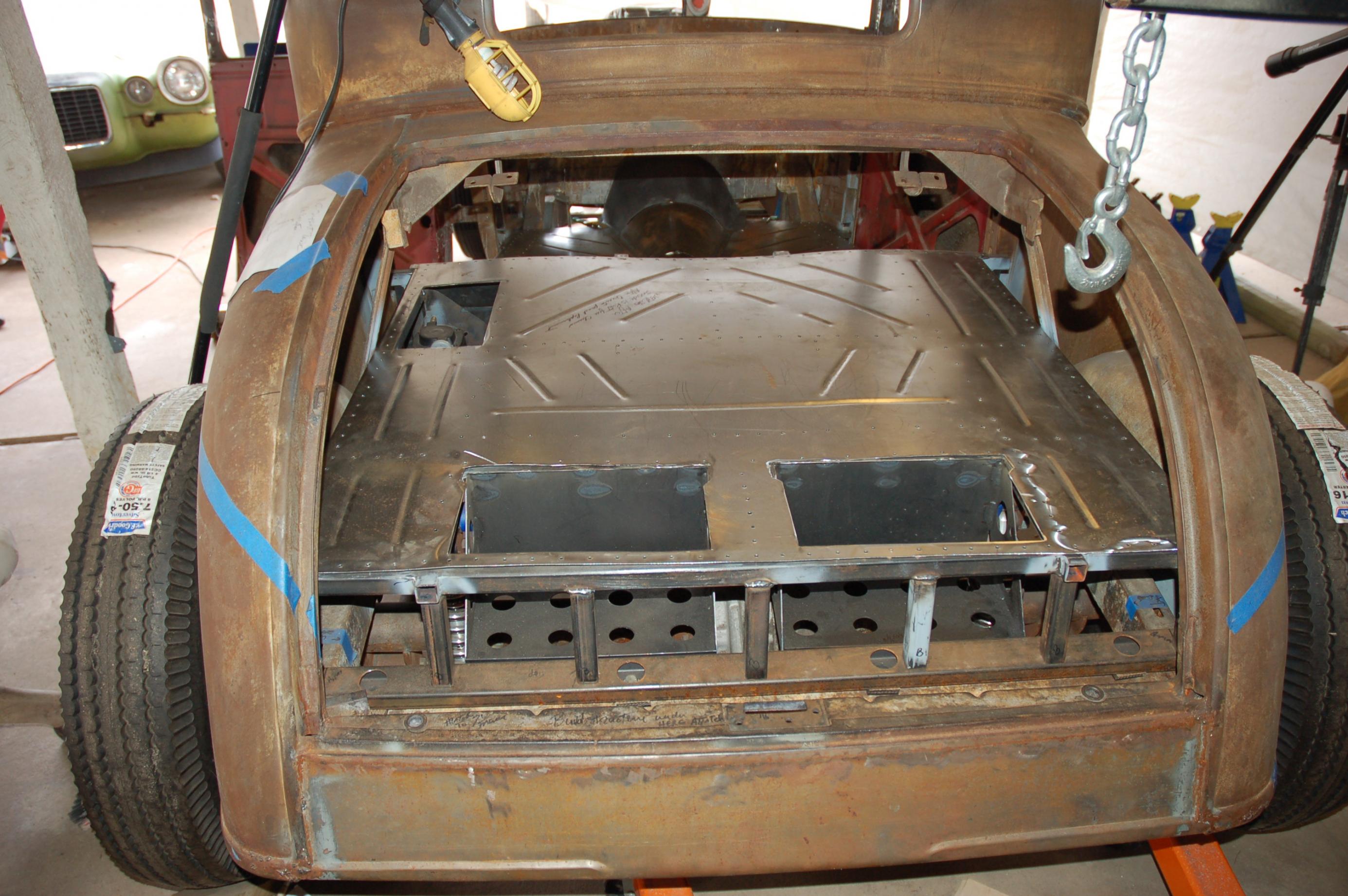

    This is my sub floor pans I just finished I still have to weld them in. I used 3 unversal battery trays. The back two are for batterys or maybe one for storage. On the left side of the tank I am using one to put mu electric vacuum motor in it

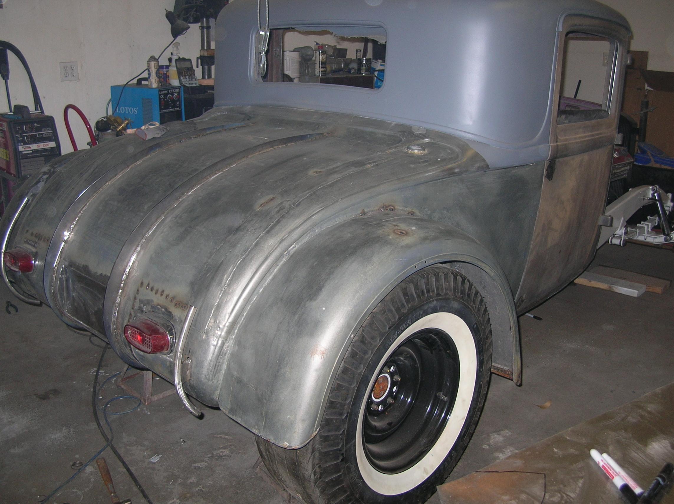

    Amish Quarter Panel Jig! LOL I am sure there was an easier way but this came to mind I traced the driver side and cut it out and flipped it. Then I traced it on a 2x12 then I used my Harbor freight router and a 1/2 bit and cut it out. Then I sanded it and made some adjustments and then i locked down the wood and the sheet metal and hammered my *** off. I still need to hammer some more and smooth it out better. If there is a better idea then i may do it over but so far it seems to work. they dont make Dodge panels so I had to think of something.
