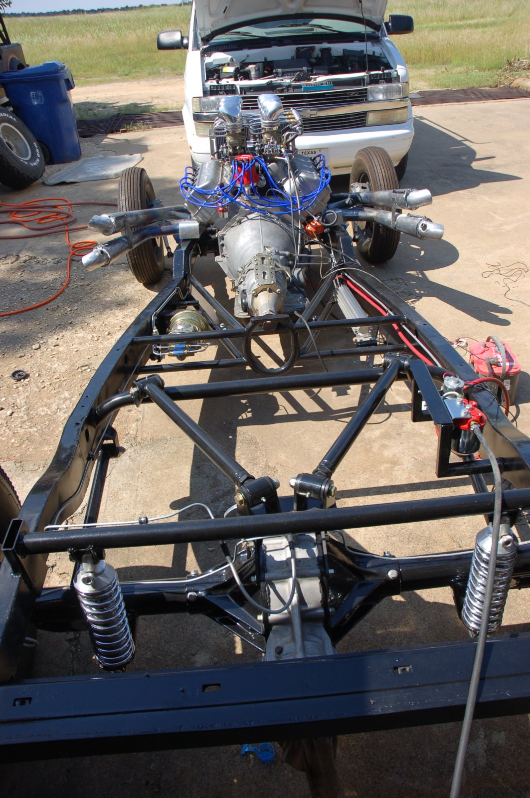

    I have a lot of carb adjusting to do going with progressive style linkage. The Holleys were all ran together before so I think its real lean off the center two. Heated up the headers real quick! Turned them blue! Water pump leaks so I have to send it out to egge Machine to have it rebuilt. I was greatly concerned about the motor since I never heard it run before. I primed it manually a few years ago and I couldn't get the lifters to pump up. I just recently got the starter in and electrical so I re primed it while using the starter. It worked a lot better! I pulled the oil filter and cut it open it was all clean. I then Did a cold comp test and it was all over the place but rising each time. So I put my spark plugs in, stabbed the Distributor set up the cooling system and fired away. Sounds like a rad speed boat with those headers I put together and I am alright with that LOL !!
