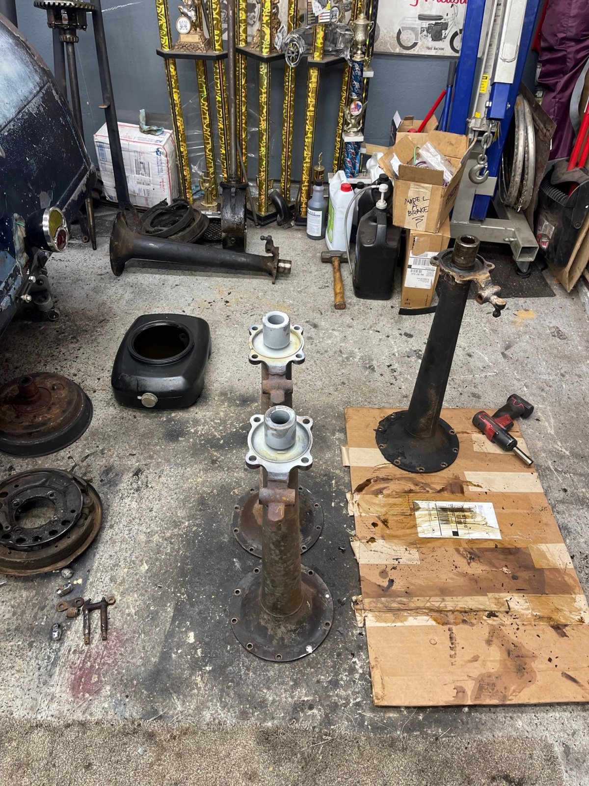

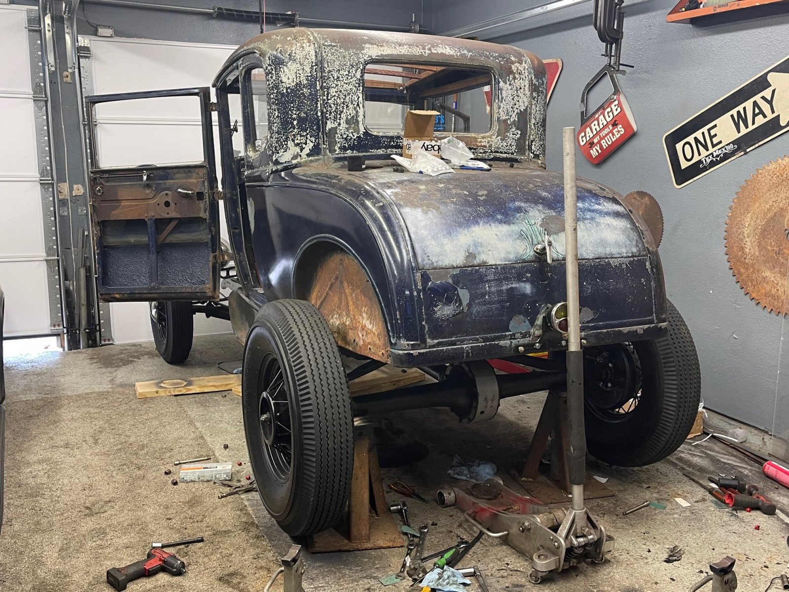

    So I got tired of not having an Emergency brake... Figured I would need one for the Hotrod Showdown in Wimberly... So what started as just doing E brake repairs, went into full shoe replacement, clean and rebuild of the brakes, to tear the rear end down and rebuild and install the new gear I had bought for it. 3.27 gear... Thankfully I have enough motor to pull it...
    So here it is all torn down... and pulling axle out of the car...Learned a cool trick going back in though... TIP of the day, get one of the 15 dollar furniture dollys from harbor freight, the wood ones, put the axle ***embly on it with the banjo in the hole, puts it 1" off the ground, rolls easy and makes torque tube installation a snap......
    All stripped down... The spring perches on the axle bells were in bad shape... So I had another set of bells here so I decided to go ahead and use them...
    Thankfully I had bought a wire wheel and small bench grinder, that thing earned its 40 bucks I paid for it and then some... The Rock Island vice worked perfect to do the gear swap, thankfully it had enough throat on the vice to chuck up axle tubes and banjo section etc...
    So here is the gear pattern I was able to get, not bad at all... I havent rebuild a rear end in 20 years....1 Shim on one side and no shim on the other....
    So here she is all back together, new brake shoes, springs, cleaned up, new cast drums etc...This was the point I was adjusting brakes and adding 600W lube...
    Success was to be had, I learned a few things.... How to safety wire....How much spring tension is on the Buggy spring....
    But here she is, first outing with axle rebuilt... The car is tons smoother now for some reason... Cruising 60 like nothing... Shifting 2 to 3 at 38 to 40 mph now... I have all 3 gears and love it now... 3rd gear is now a bit of a load but gaining top speed is always good... Few minor things to dial in to push speeds up higher... No noise, no weird issues... I am very happy...

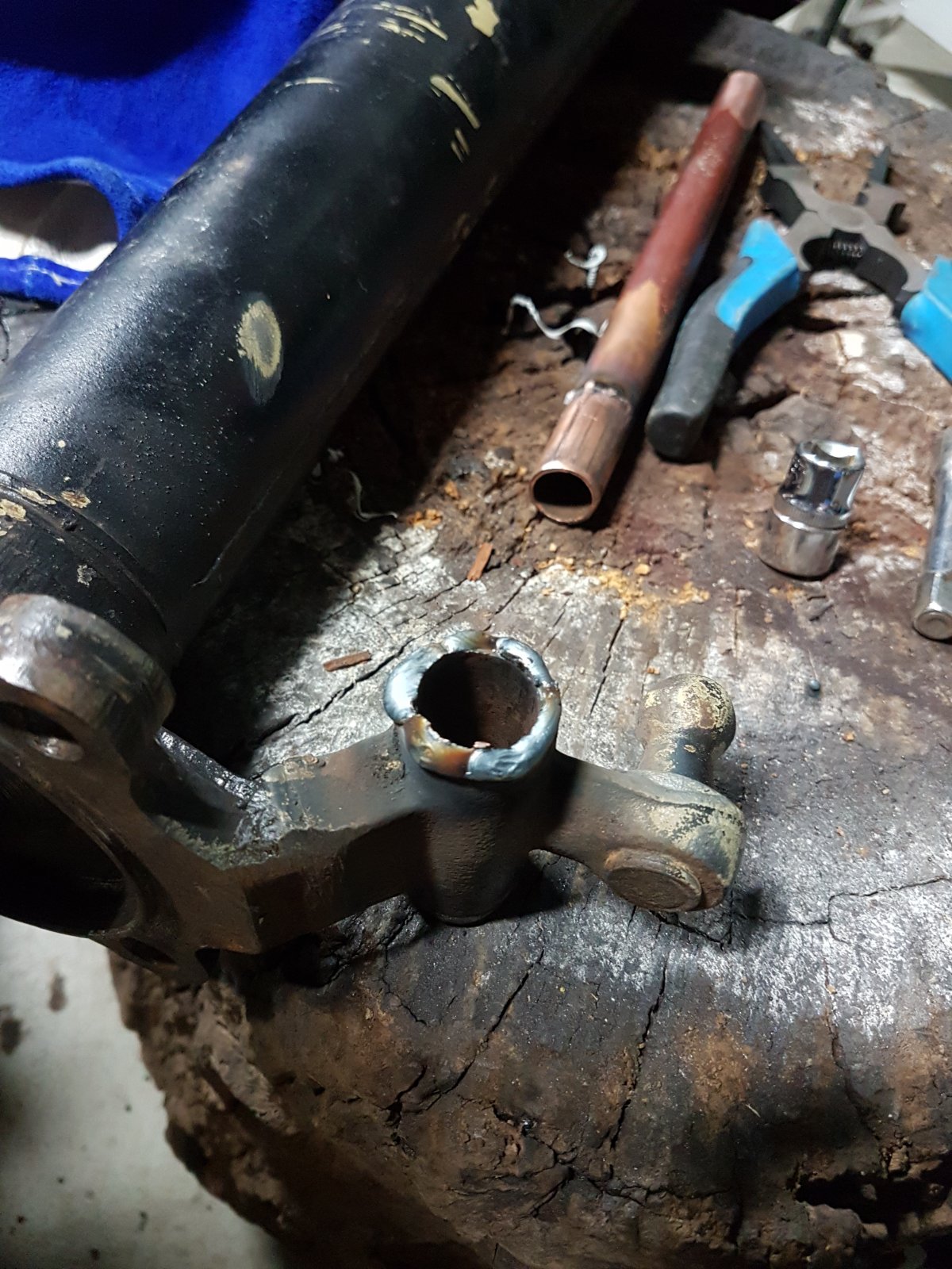

    I've tidied up perches using a bit of copper water pipe and the mig. Decent A rears are pretty thin on the ground down here.

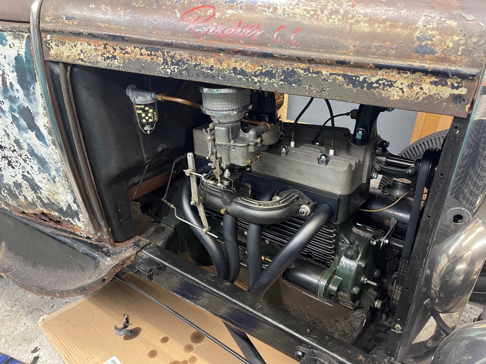

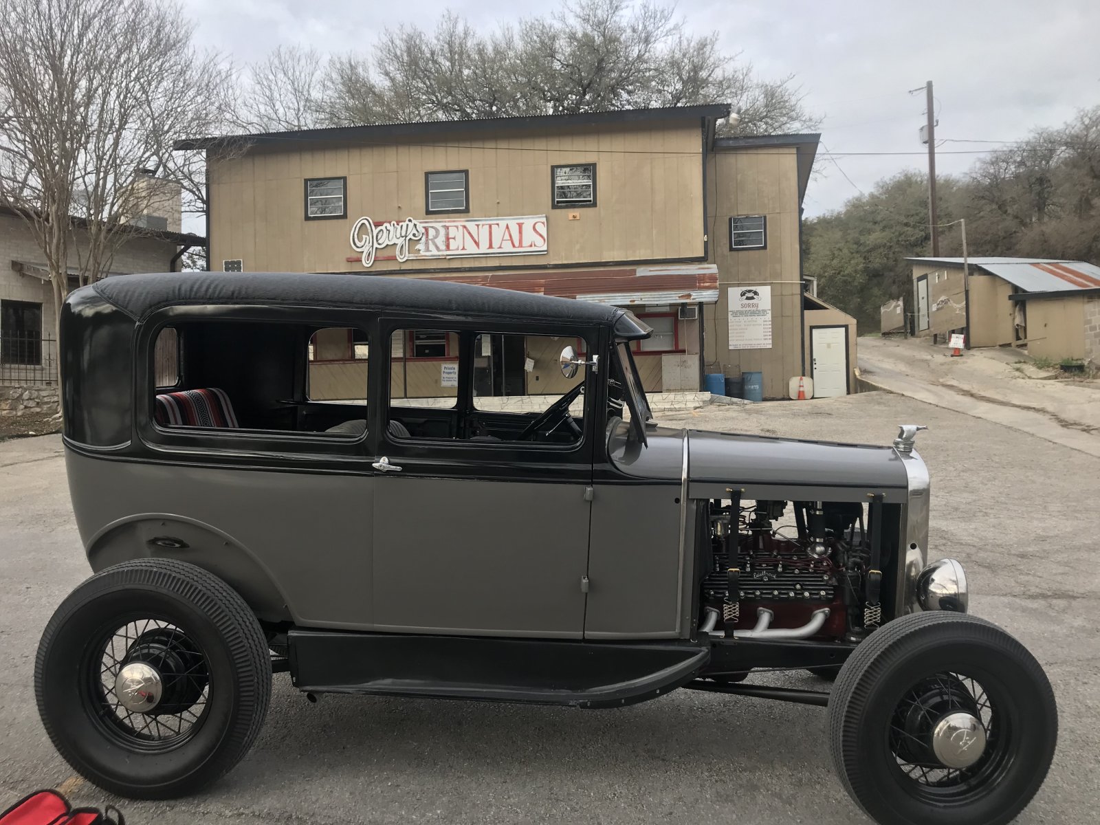

    Some updates, decided to put a full exhaust on it. I have never built an exhaust on the floor. But Didnt turn out too bad. First weld by the collector was learning curve, the rest ****er... 39 dollar Jones Exhaust chambered muffler, not bad tone at all...

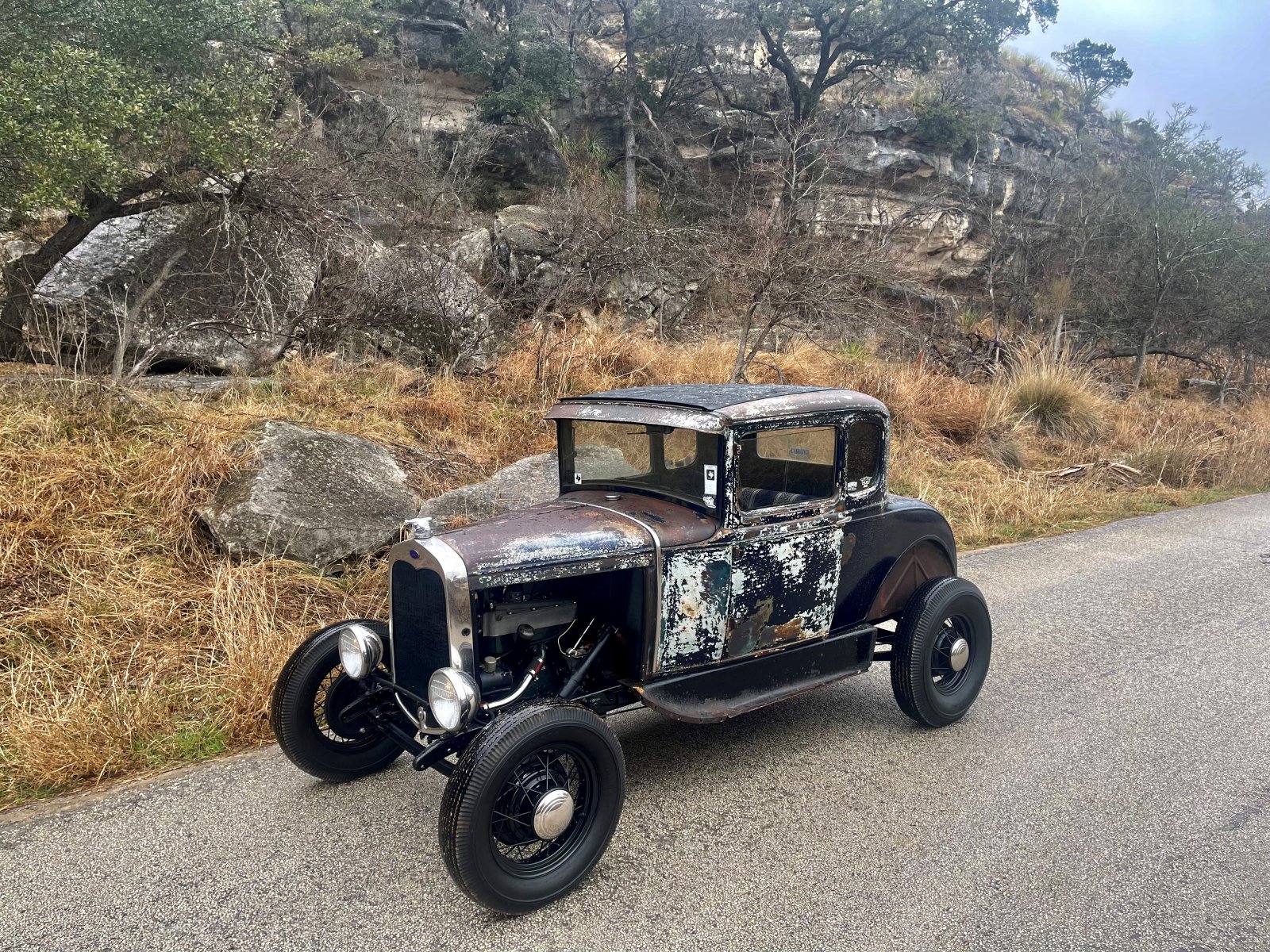

    Here we are, 1 year after buying her, still enjoying for sure.
    So had to drop the pan again to fix the leaks, decided to pull dipper trays and clean the pan out completely. New gasket and were back in business.
    Drove to Deuce days last month, was still a good time and some people there get what Im doing, some think I am nuts.

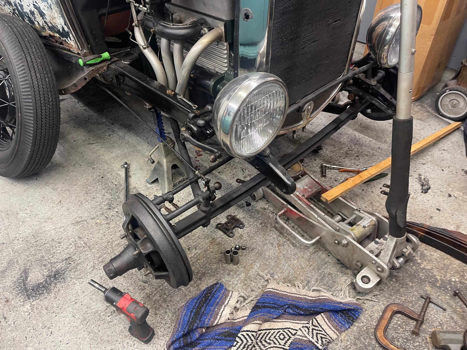

    So today is a cold rainy day, figured it was time to reverse the front spring eyes... Yeah I could have bought a brand new one, but that's no fun and not what this car is about.
    So here we are with the ride height before the flip...
    Springs off and pulled off tension...
    Notice my grandfathers C clamps, love having these things all the way up to 12"

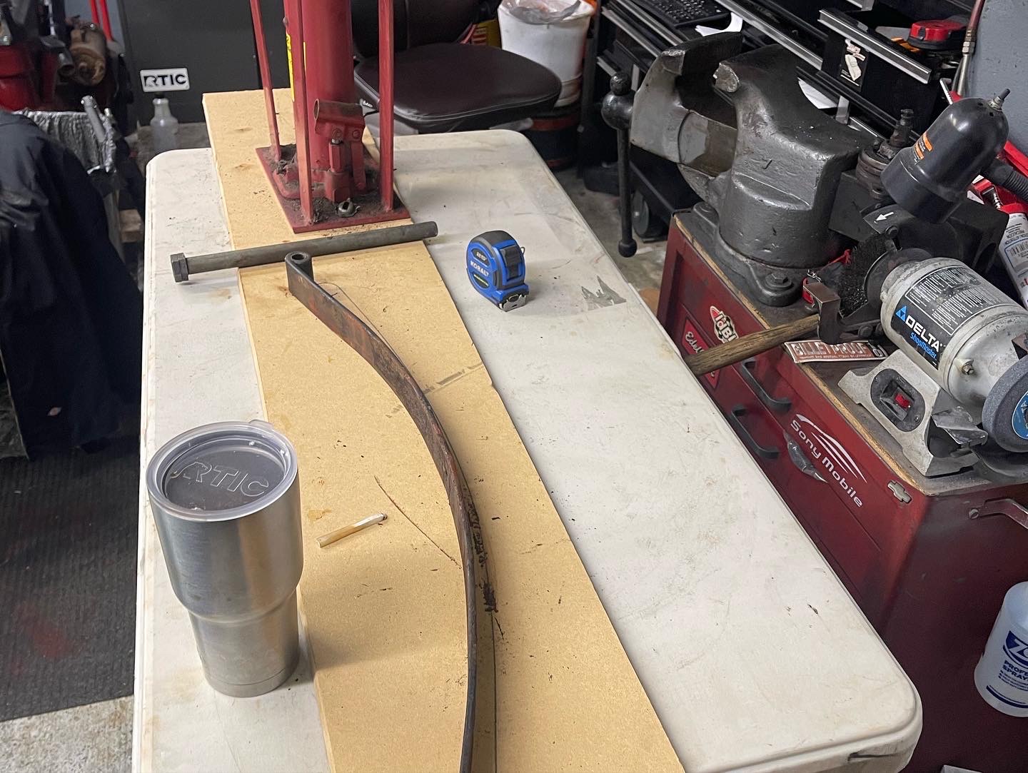

    Here she is stripped down of only the spring, all the bushings were in good shape so reuse till I get the new axle and perches in... I dont know why but I love when I pull my wheels off and see these big brakes, things that make me happy...
    So here is my spring jig, a Norther Tool, heavy wall pipe bender that I have modified a bit...
    Here is the completed spring, I added a little arch in it to ensure the ends were the proper width for the eyes...
    So here is the after Ride height, no spring cycling etc, just bolt on and bam...
    And a little pic of the car with its new at***ude nose down. Amazing what 1" does to looks...

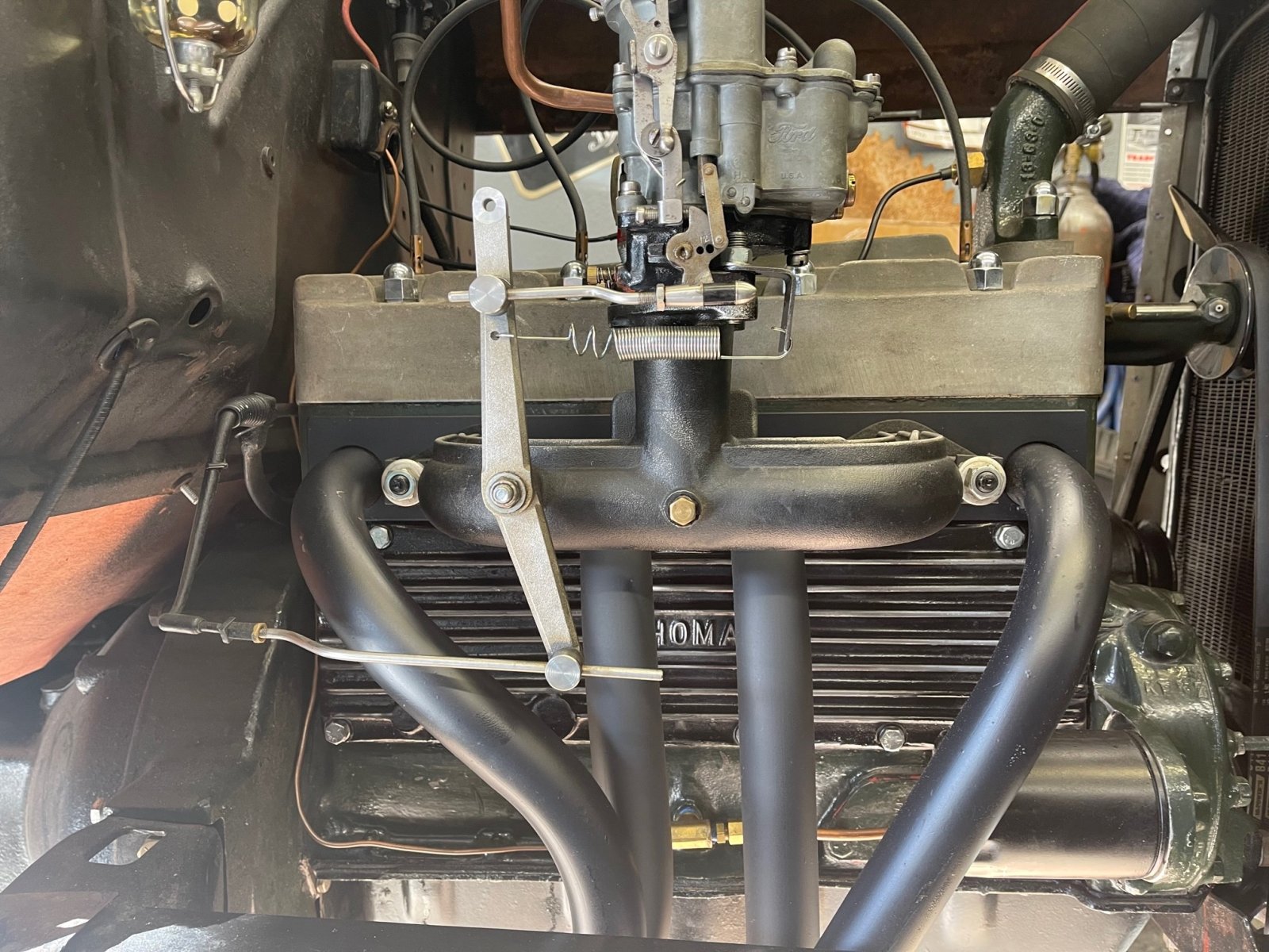

    Few updates... Got my Thomas valve cover on finally. Painted the header while I was at it.
    And an updated shot showing off the rake...

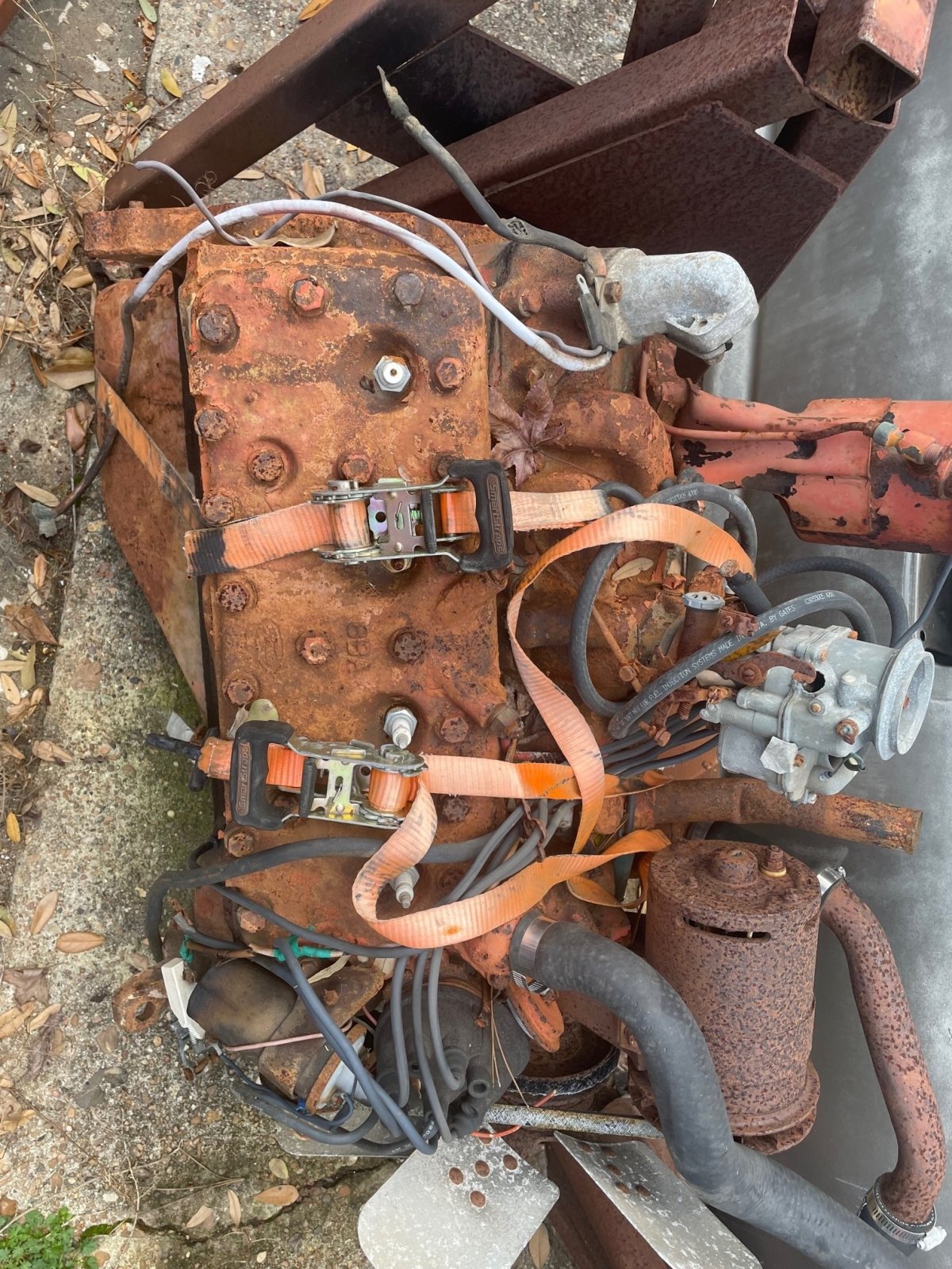

    Well, its been a while, finally got her out yesterday for a good ole lunch cruise. Walking off on regular traffic with ease. Was a good lunch cruise and car ran great.
    Got home and did some things yesterday, had a buddy send me a number and a picture... Turns out a local guy was wanting to get rid of this 8ba and some 35 ford stuff. I took it all... The 8ba had water in it but the cylinders are .080 but are not too bad, so then that got me thinking..... If the block is salvageable, sleeve it, cam it, nice heads, 2x2 intake and maybe swap the banger out. Still love the bangers, but going up to 150 hp from 95 would be a good bump I think. I've had 110 hp and it was ok in the v8 flatty.... This banger is not near as smooth but pulls real good. Both avenues are cool none the less. Just had me thinking.... I could spend the money I would spend building the v8 and do a OHV conversion to the banger and go through it in depth.
    My prior flathead car.

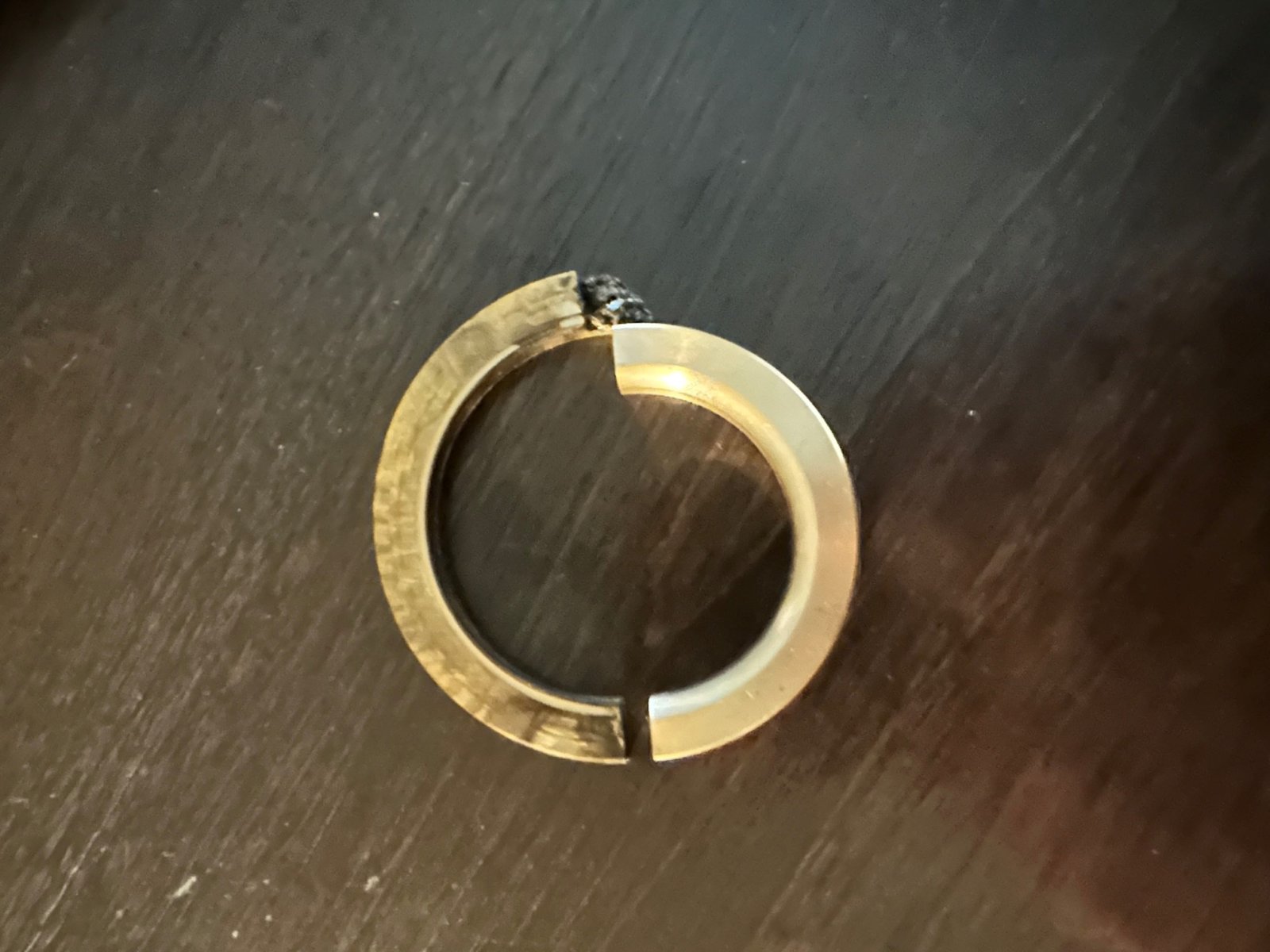

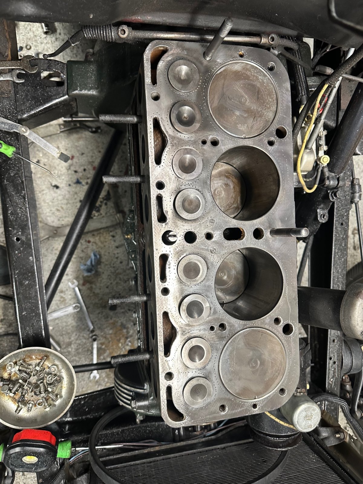

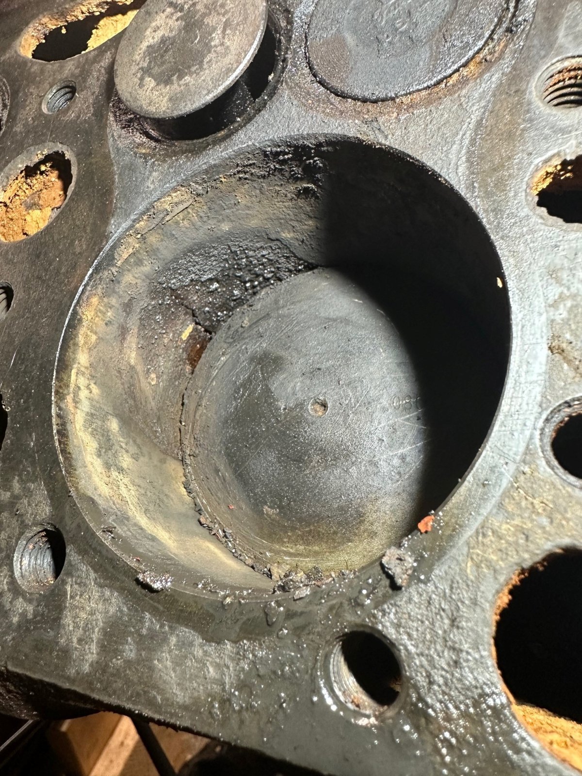

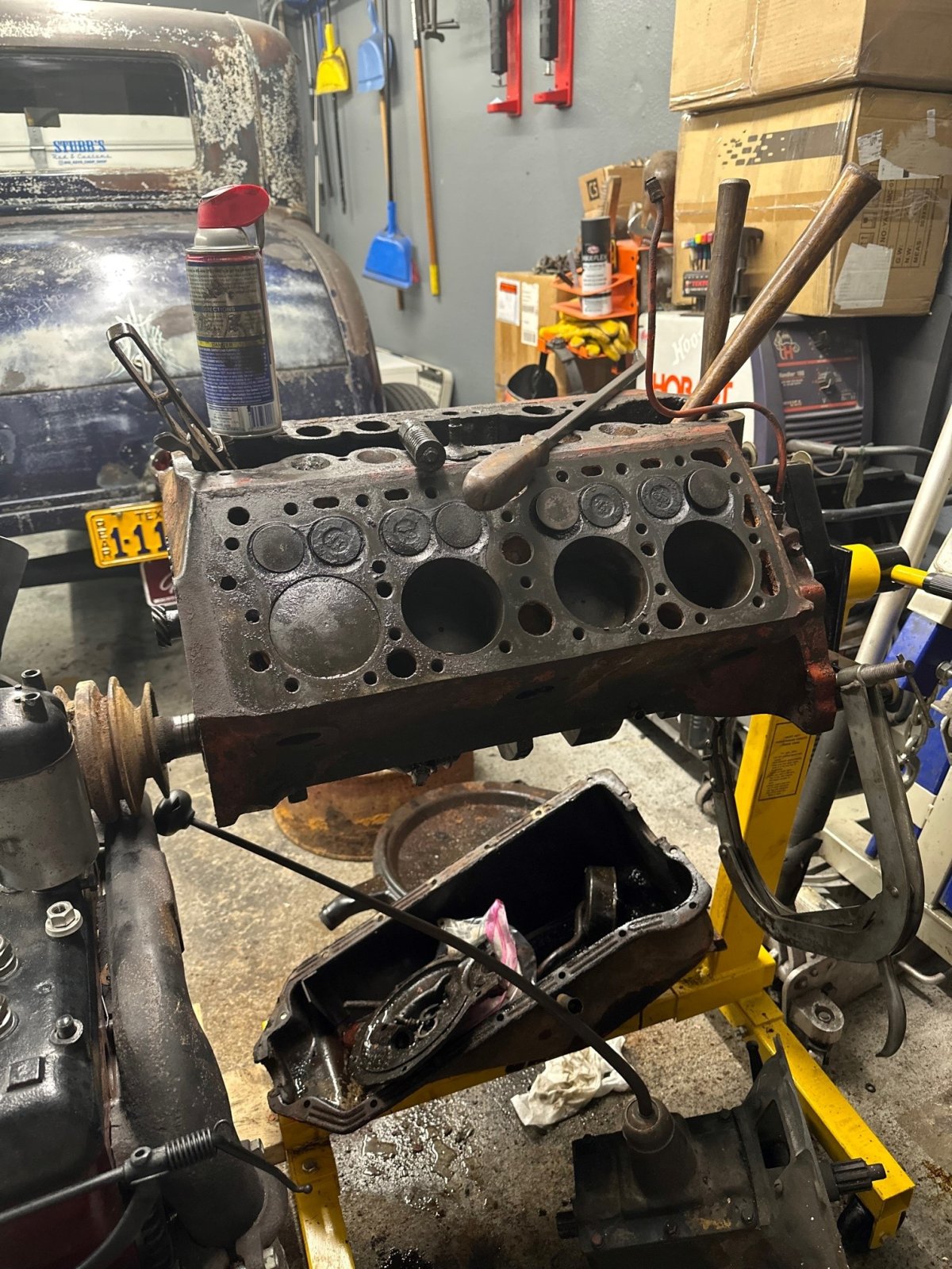

    So I got the motor opened up, got it broke free, had to remove a valve and seat that was frozen and broken... Found this crack in a cylinder... I guess a good shop can cut the bore and sleeve it without much issue hopefully or is it too far gone? Even having water in it somewhat, the wax/gunk saved all the parts from rusting up on the bottom end. The crank and rods look stellar still.
    Here is the hole in question....

    So a machine shop update on the 8ba.
    3 holes required sleeves, a few were worn too far to cut .125 bore so I am having the whole thing sleeved and will set her to the side till I get more parts acquired for her.
    Onto Banger fun...
    So I was noticing some crankshaft thrust issues. Found out the rear thrust washer was worn to hell and back. I screwed up and bought a A set of washers forgetting about the B crank being larger diameter. But this shows how bad torn up the washer was. The thrust washer didnt have a oil groove or bevel cut into the surface so I am pretty sure it was s****ing the oil off and running almost dry.
    So I had 2 cylinders down on compression. 20 lbs lower... So 2 valves not sealing good... Full lap of all the valves to clean and make everything better.
    Here she is all cleaned up on the top end and ready for a new head gasket.

    Last weekend went to Chickasha Pre War swap meet. Not alot of A parts but I bought what I could find that was worth getting.
    Here is the haul of parts. Most are already sold...
    So I decided I wanted to go ahead and pull the motor, I will update on why on the next update when things are getting more ****y. You may notice what's behind the motor on the stand... Or more like why are there 2 shift towers in the air not just 1.
    But I do dig the 2 x 2 intakes... So Here is mock up. Still don't know if I want to run the Burns or The Zepher... Tough call.
    Will hopefully have some new updates soon when some things start coming together if parts arrive in time.

    What's up with the peening around all of the holes on the head gasket surface? Don't think I ever saw that done before. Nice swap meet haul for sure.
    stubbsrodandcustom likes this.
