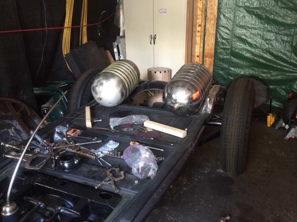

    Well, I was going to wait for a tech week, but I figured to just go ahead and tell you guys what I am up to.

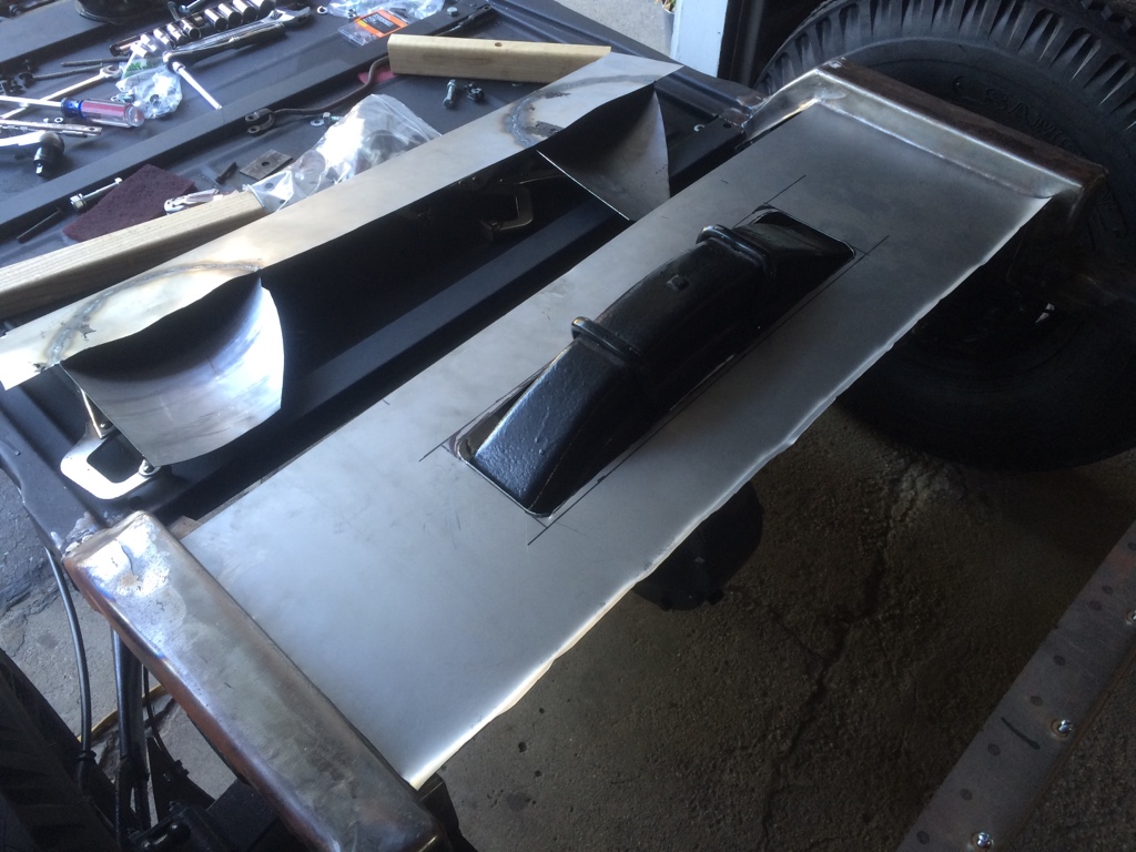

    I sent the body out for blasting, so while it is off, I am working on the floor. My gas tank ended up being pretty roached, so I am going to hollow it out and use a gas tank in the trunk. I made some cardboard cutouts and tried different ideas.

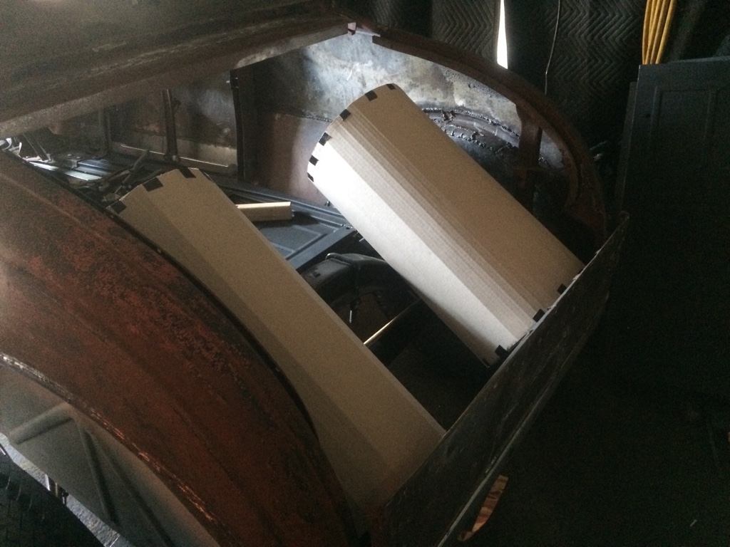

    I was stuck in a choice between the speedway tank and going custom. The speedway tank is plastic and has a vented cap system as well as a plastic bung. It would have had to have been placed behind the rear crossmember. I chose to go custom.
    I first made sure my idea would work by using some cardboard replicas. I had two options.
    Either would have worked, so I went and bought two off of craigslist. Long story short, I'm a huge dummy. I bought two for 100. They do not match, although they are both "from the factory". I shined up the cool one, and then noticed the other didn't match when I was going to shine it up. Called the guy on Craigslist and went to visit him the next day. He had one more but it matched the less cool one. He was going to sell it to me for 20 bucks, but I am an idiot and regretted telling him no on my 40 minute truck ride back to my house. Ugh.
    THEY ARE STAINLESS!!! Don't listen to anyone else! Some people thing they are aluminum because they are not magnetic. Instead, they are truly just non magnetic stainless.
    Anyways, they were painted when I got them, and was able to uncover one layer of paint on the poor looking one at a time. I still have to buff it out however.
    See those cubic inches? Ends up being 9 gallons each (max).
    I chose to go this direction because it is the most safe. The tanks can still easily be filled at the same time.
    Now I have to fabricate the floor so that I can find out where all of the bungs and cap goes! I made one piece with a flange for the front of the z. I then slip rolled some stock larger than the tank diameter. It was trimmed and welded to the front piece. I then made another piece to go over the rear cross section.
    I MESSED UP! I should have made that piece over the cross continue on through the back. It would have been easy to make the tail end of the z in bends. Instead, I just welded it later. ****s, but had to happen.
    Welded and trimmed. I welded it mainly from the bottom.
    So, now I made the hump to go over the rear cross. The stock setup is very stupid! The stock setup requires the body to be taken off in order to replace the rear u bolts! Instead, I just wanted to have a piece the could be taken off in the trunk if I ever had the need.
    In order to do so, I made two sides and then a top piece. The two sides are curved with an inch flange. I then took roughly 5/16 more material after the inch flange and folded it under and hammered the seam flat so that it looked square and flat.
    I finished it off with two sides and softened the corners. Again, weld from the bottom so that there is less to grind!
    Not pictured is the fact that I went around the perimeter every two inches and drilled a 1/4 inch hole. I am using 1/4 20 round head flat head screws with bolts on the bottom to look super period! Will also be able to control which direction the flathead screws face as well.
    Next is straps.

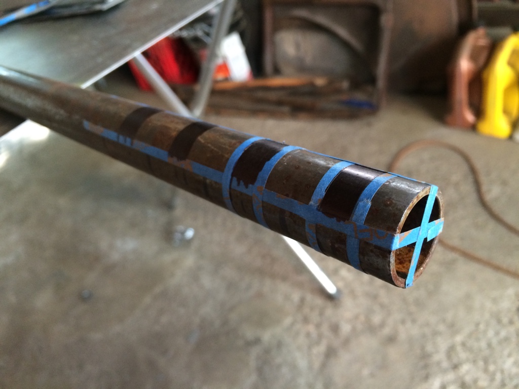

    As a sidebar, the round pipe will capture the heads of the bolt and nut. As a result, one side will be hard to turn. In order to combat this, I made some rectangular washers with a rounded backside to go under the head of the bolt side. Will post pics later.

    Yea.... Looks great, I'm diggin the dual angled tanks.

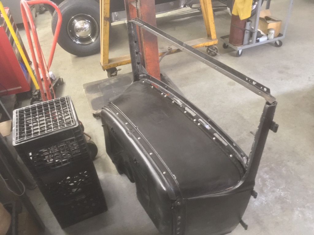

    I started in on my 20 dollar grille shell today.
    I already had patched the top, so I just had to work on the bottom. Luckily there was just enough left at the bottom to have a skeleton to work off of- I knew the contour as well as the size.

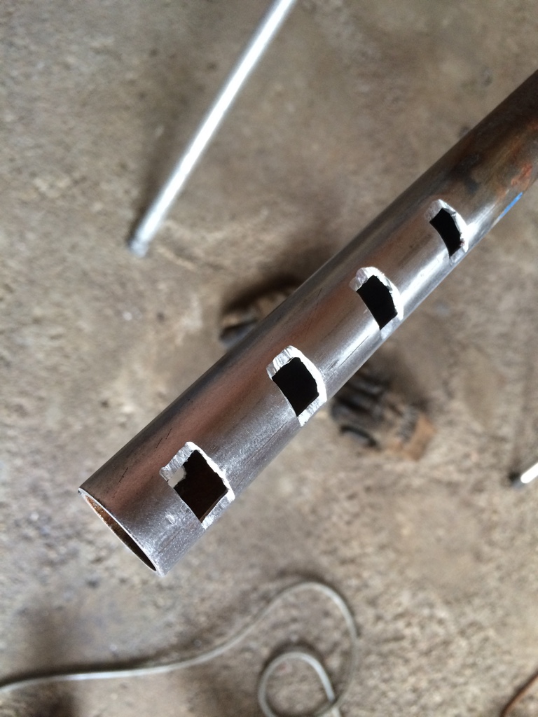

    I started off by forming some handy j channel.
    So how do I get a curve in the j channel? I must have some high tech equipment which shrinks and stretches edges. Or, maybe I just use a 5 gallon pail and my trusty 3 lb hammer.
    I then made a series of cuts with my angle grinder to get a contour. I use the angle grinder just to make flat cuts. It takes away just enough material.
    Welded the seams, reworked it, and welded it into the shell.
    Done!

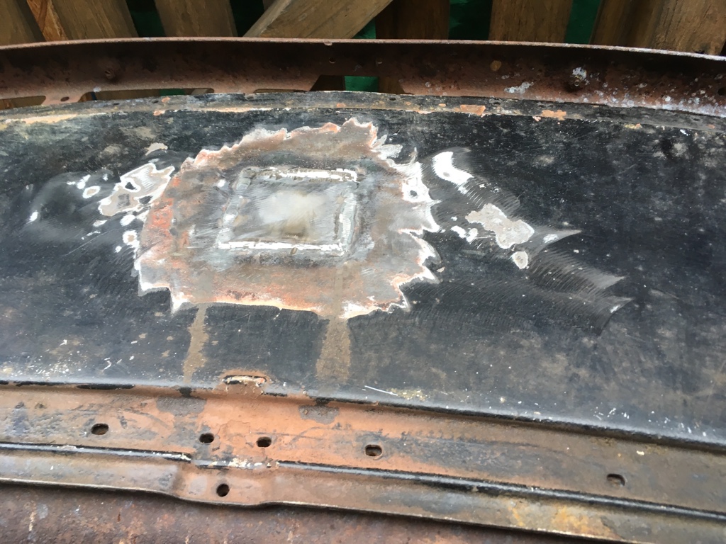

    Anyways, long story short, I acquired a 48 (42-48 I think?) dash. I didn't get anything back for painting yet, so I figured I would work on it using the cut up cowl that I still had as the reference.
    So, first off, I hogged out the gas tank, and replaced the cap section.
    Here is the dash as I got it...
    So, in order to make it work, I needed to make it square. I used tape and painted over the tape so that it left cut lines.
    Slice, dice, etc. I also had to fill the plastic using quick set jb weld.
    I then patched the center
    Sanded it all shut...
    Here it is with the plastics.
    And here it is painted. That's all i got.
