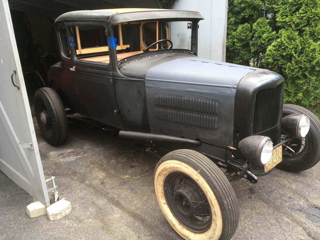

    Thanks! I am not going to TROG- running low on funds and time. A lot of people from around me are though- a large New England presence will be there!
    I got back to working on my car this weekend, and needed to tackle the seat mount. I am pretty short and wanted to have it be semi- adjustable (as in you can adjust it, but it takes time). I am using the old dodge caravan seat trick you all hear about. Here is what I came up with.
    Uprights- drilled 1/2 inch holes on 1x3 box and they hammer on tight to some protruding prongs on the base of the seat. I wanted it to be removeable, so they bolt to the side of the mount on each end.
    Top half- has holes to mount rear of seat as well as uprights. Rear seat bolts are metric and factory. The frame is mainly 1x1 box and then 1x3 because I ran out of 1x1. The 1x1 was then drilled with one inch spacing with 3/8 drill bit down the length of the middle struts.
    Bottom half- I welded the main frame in place in the floor and then welded the 1x3 box on top of it. The 1x3 is drilled every 3" with 1/2" clearance holes. This allows for 5/16 hardened bolts to be used as pegs for someone to set the seat where they want it. I also drilled the front and rear of the piece for mounting. Mounting was done with fender washers. Rear mounts also hold seat belt down.
    Going to work on floor tomorrow.

    So while everyone was hanging out at a beach, I stuck around my carport and got a lot of stuff done...
    (Follow the link- hopefully it works!)
    https://www.instagram.com/p/BVOF1r8hNTD/
    I mounted the gas pedal, floors, and choke cables, and mounted the Mike bowling approved brake light switch.
    I then wired the whole car (except for the horn so far). It was tough because none of my terminals were labeled, so I had to do hours of contradicting research. I added lead subs***ute to a fuel jug and filled the tanks, installed a temporary boat hand fuel pump and filled the actual fuel pump and some of the line to the carb up with fuel, then removed the temporary part. Finally, I added a helper spring on the intake bolt to the accelerator arm in order to ensure the throttle returns.
    Then it ran. If you followed the link. It runs rough, and I am currently fixing some of my wiring to make it better.
    Still a lot of work before the street, but it feels good to hear it finally.

    I worked a lot on the car over the last week-
    Worked on the rear end again but only shimmed it; didn't come completely apart.
    I also found a problem with my carburetor.
    That bar is from a three barrel Holley and a longer bar is required in order to seal the surface correctly. I replaced that bar with the right one and now it runs a lot better.
    I thought there was a vacuum leak because I removed the carburetor a few times and reused a lot of the gaskets. As a result, I took it all back apart and put a little bearing grease on the surfaces to ensure a good seal- just enough to change the color of the gasket.
    Sadly, it didn't help. I currently cannot get the car to idle, as I have to have my foot on the pedal at all times. I am going to investigate the p***ages to the primary jets and the idle p***ages, as it seems like the car only operates on the secondary jets (i.e., small throttle). Just hard because I have to sit in the driver's seat to start it and can't see anything. Really want to get on the road for the Fourth of July.
    Stay tuned because I scored a Hudson Es*** hood at the swaps today and am going to use it to make a hood.

    Small update...
    Lengthened the hood with 20 ga but it is too light. Going to have to replace it with 18 gauge. Also need to find a rear hold down mount, but that should be easy.
    Located shocks- Monroe 5752 for rear and speedway black shorties for the front.
    Found a trunk lid- since I piece mealed my car together, it was too long, so I had to unbend the top flange and rebend it 1/2 inches shorter. Love the look though- and the primer looks good.
    But here is why I haven't made much progress-
    Engine needs to come out. Peeing oil out the hole in the bell housing when warm. Huge puddles.
    Rear end is tight- can't spin well. This happened after I torqued it to 130 ft lbs on each side. Also still makes noise. As a result, I cannot drive it and need to figure it out. Probably due to rust putting on the carrier/ pinion.
    Current plan is to find a better banjo. I then need to replace the torque tube, brakes, and wishbones with the ones I already have. Hopefully I can find a later one, but this means I will have to weld on the top spring mount because of my ch***is.
    Sadly, the way I put everything together the first time was really the only way because I don't have space to blow it all apart for more than a day. I am currently trying to figure a way out of that too.
    Not good.

    I ended up taking the rear end out. Once I had it out, I pulled the drums off to find that the dragging was actually due to the new aftermarket shoes I have. I consulted the experts and they said a 0.012 shim wrapped around the axle taper would push the drum out far enough to clear- and it worked. Reinstalled, and turned the car around to work on the engine.
    I then took the engine out.
    Good news is that the rear seal is a cork seal, so no slinger. Also, the bottom half is all mashed near the halfway point, so replacing should do the trick. You can also see how the oil flowed though the seal and onto the flywheel while I was removing the engine.
    I then loaded it in my truck. It should be an easy fix, but I wanted the local expert- @flatheadtommy- to check it before re installation. Hopefully next weekend I will be all set.
