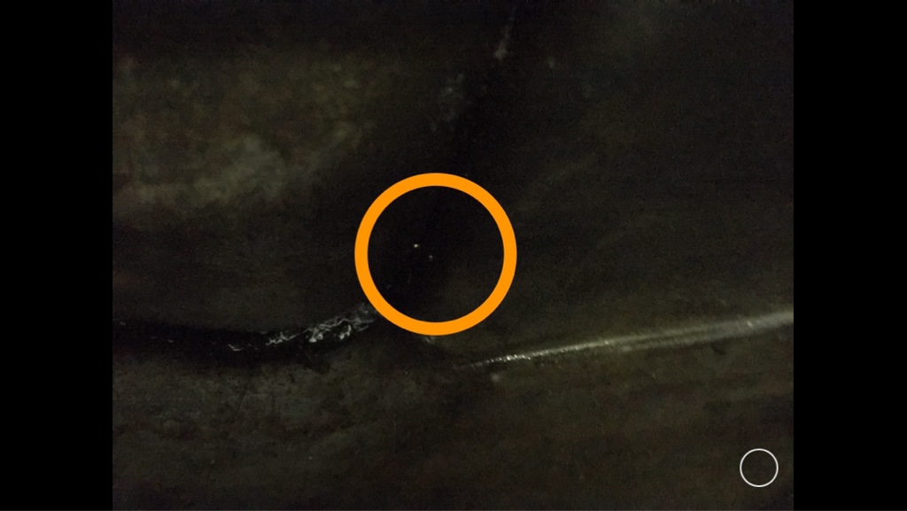

    Unsure or what the problem was, I started to clean the oil pan for re***embly when I saw this
    I took a flashlight and looked on the bellhousing side to see this:
    The spot weld had rusted and caused oil to drain through a pin hole and into the bellhousing! When I heated the motor up, the oil just flowed more easily. I just filled the hole with jb weld and I should be good to go!

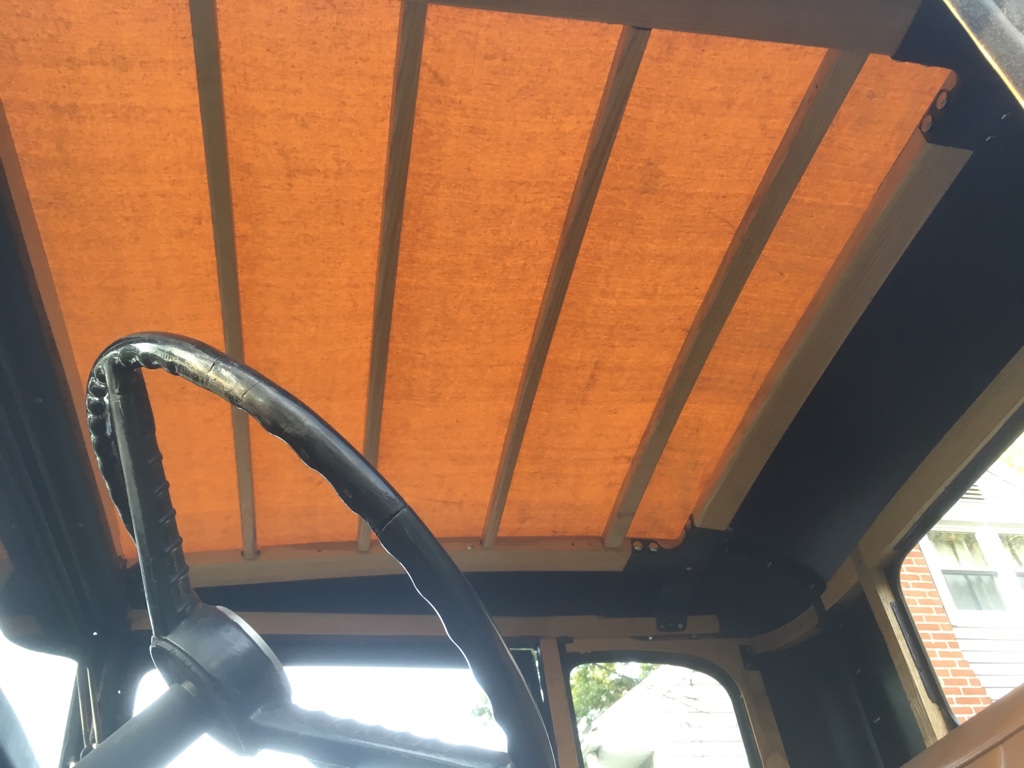

    I then made a canvas top for my car while it was too rainy to reinstall the motor. If anyone wants, I can explain it, but it was very simple. ****ons down and is removeable. Cheap too.

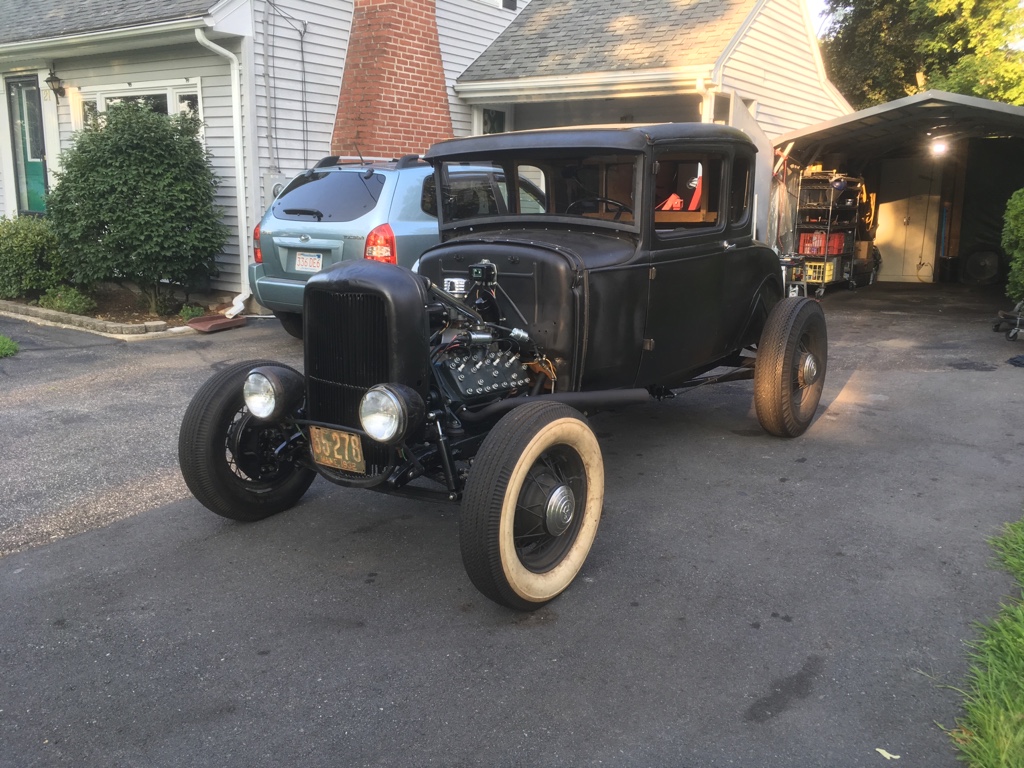

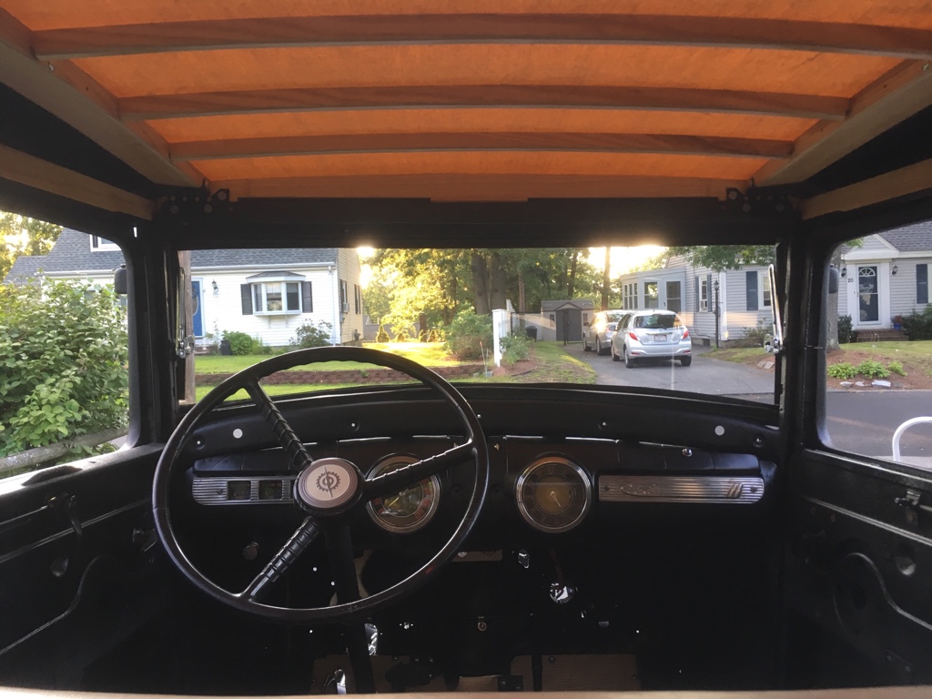

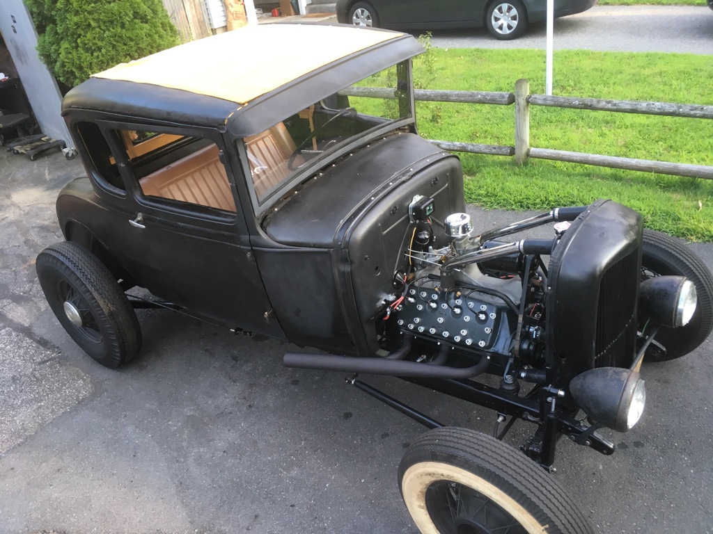

    I then reinstalled the motor. Fixed a couple of things while I was at it. I used hockey tape (3m friction tape) as loom to protect everything.
    My new favorite picture...

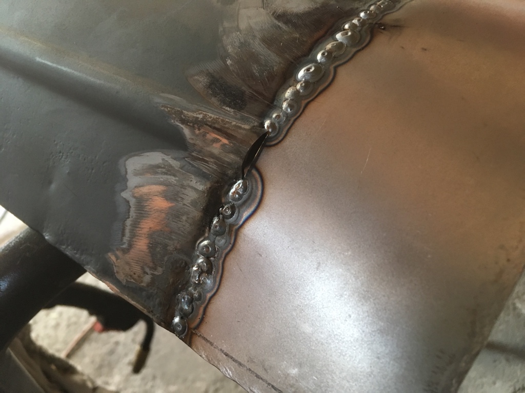

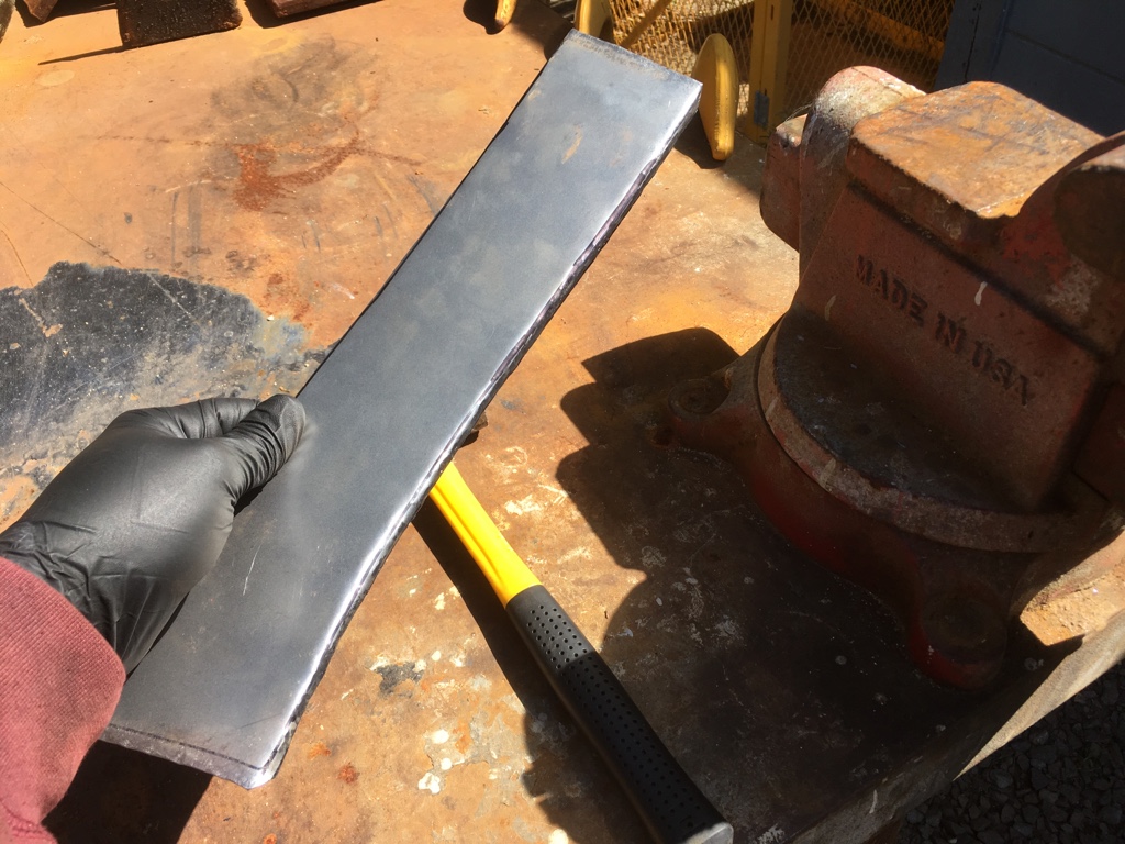

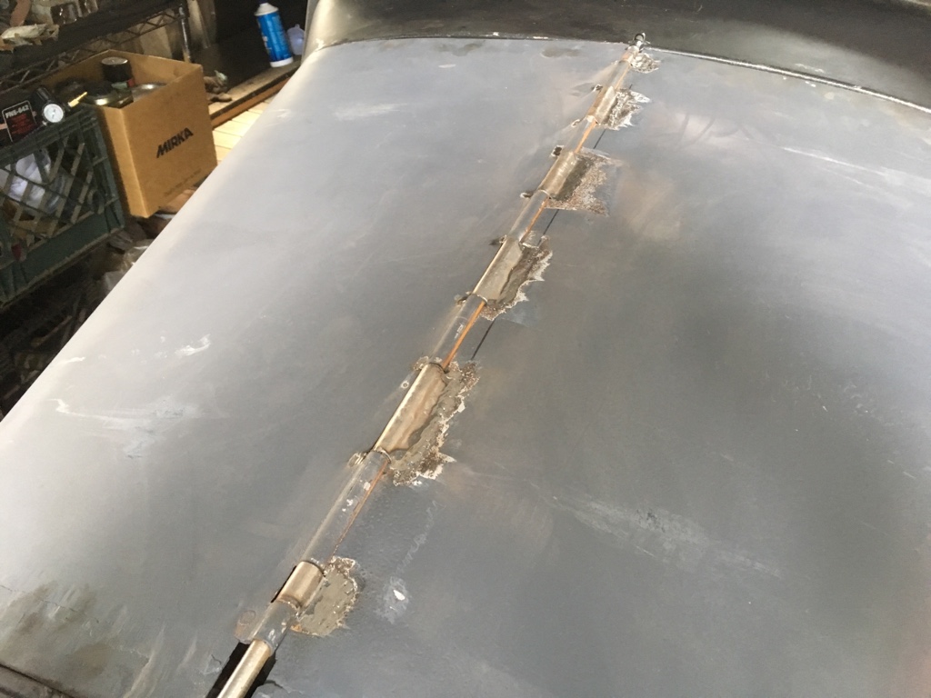

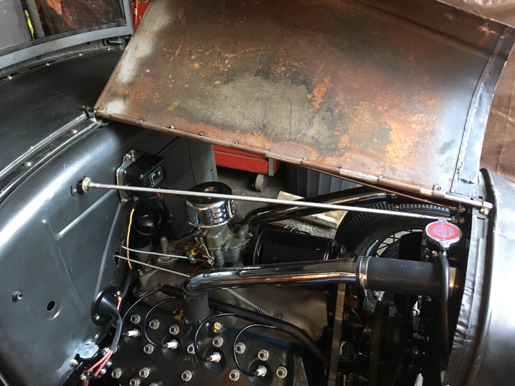

    While I wait for parts, I wanted to work on the hood again. There was a crazed in repair that was done to one of the halves that I wanted to get rid of. I figured some people also have hinge issues, so maybe they can see how I did it...
    I formed these flags by hammering sheet around a 3/8 rod on a vise.
    I then mounted the hood, and found out kinda what I already knew. The grille is too high and needs to be lowered. I have a tab that mounts off the front cross that already moved the radiator out three inches, I figure putting in a one inch drop will fix the issue.

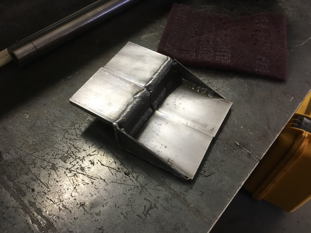

    Here is the new bracket.

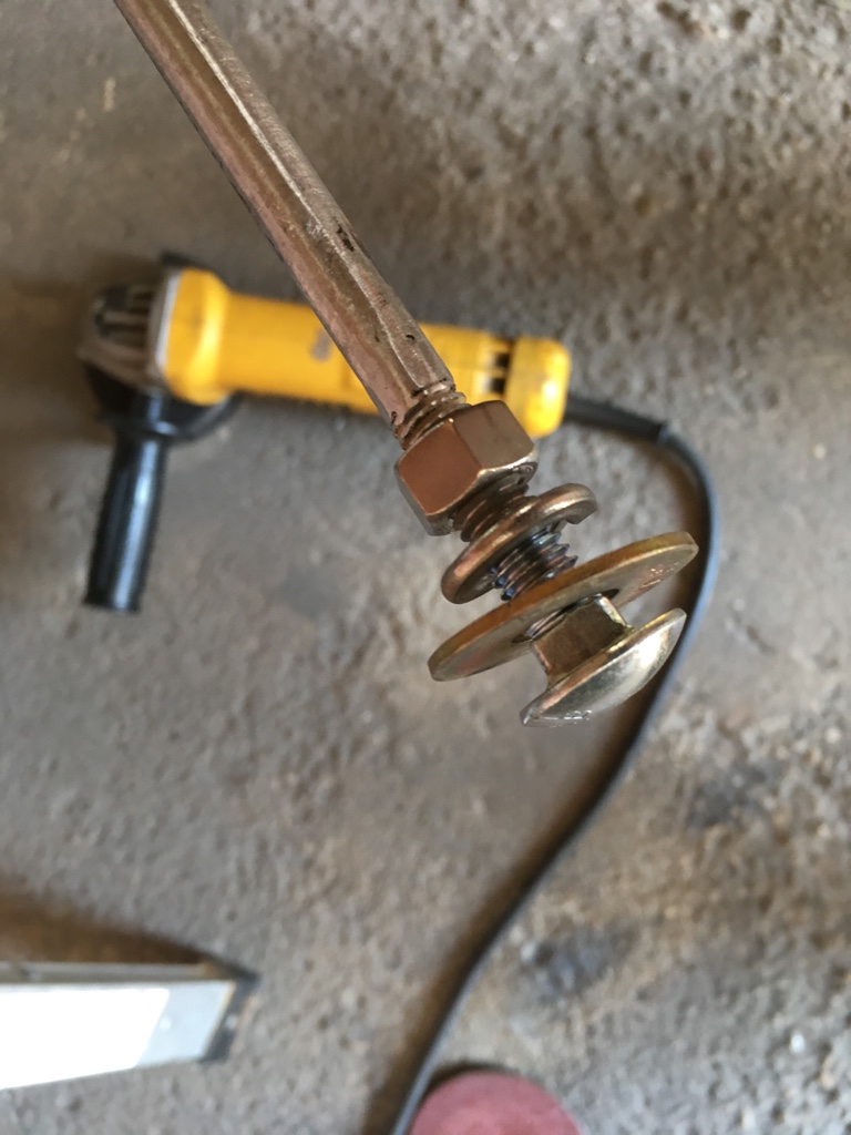

    With that finally figured out, I finalized the radiator support rods. They don't make the size I needed, so I bought 2 3/8 x 1 carriage bolts, 3/8 solid steel rod, and 2 5/16 x 2.5 bolts. The real deal used 5/16 solid rod, but home cheapo only sells 3/8.
    I welded the carriage bolts on first. If you want to do the same, just make sure you ***emble all of the hardware onto it before you weld it. It is stuck afterwards. In order to clear the square of the bolt when tightening, I used 7/16 washer and lock. I then dressed the weld afterwards.
    Same deal on the front, but no pre***embled hardware necessary. I cut it an inch short so that you have the ability to thread in or out.
    Plan is to cover it with gloss black enamel to finish it. Turned out well for the price I think.

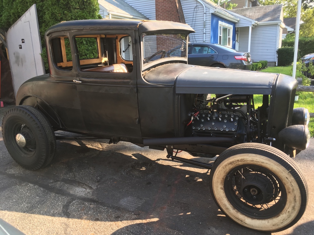

    I tried to take it for a drive Friday but broke down- once warm it started to miss and got progressively worse until it would miss anything above idle. I narrowed it down to the coil and hopefully a replacement comes in the mail.
    I did however get to work more on my hood. I was able to fix the extension to my liking, adding a hood center hinge. I then was able to work on the sides, using the same custom rolled hinges, because the piano hinge used before was not separable.

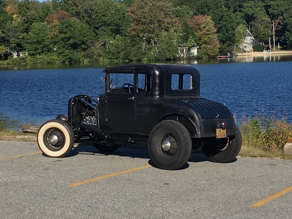

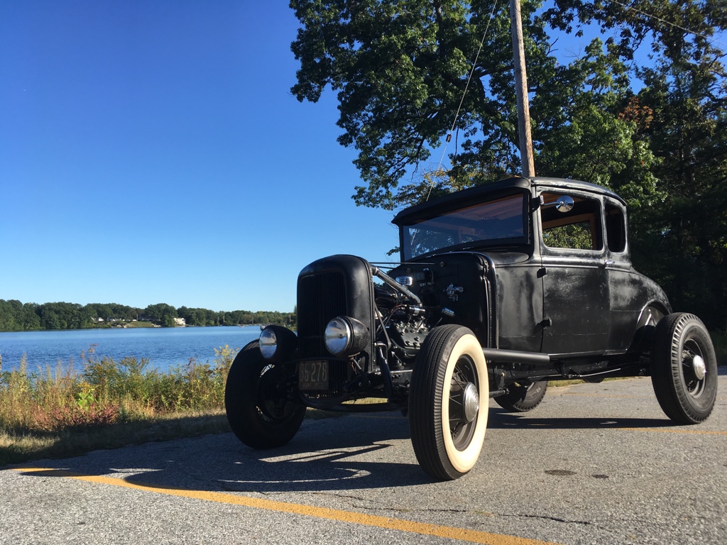

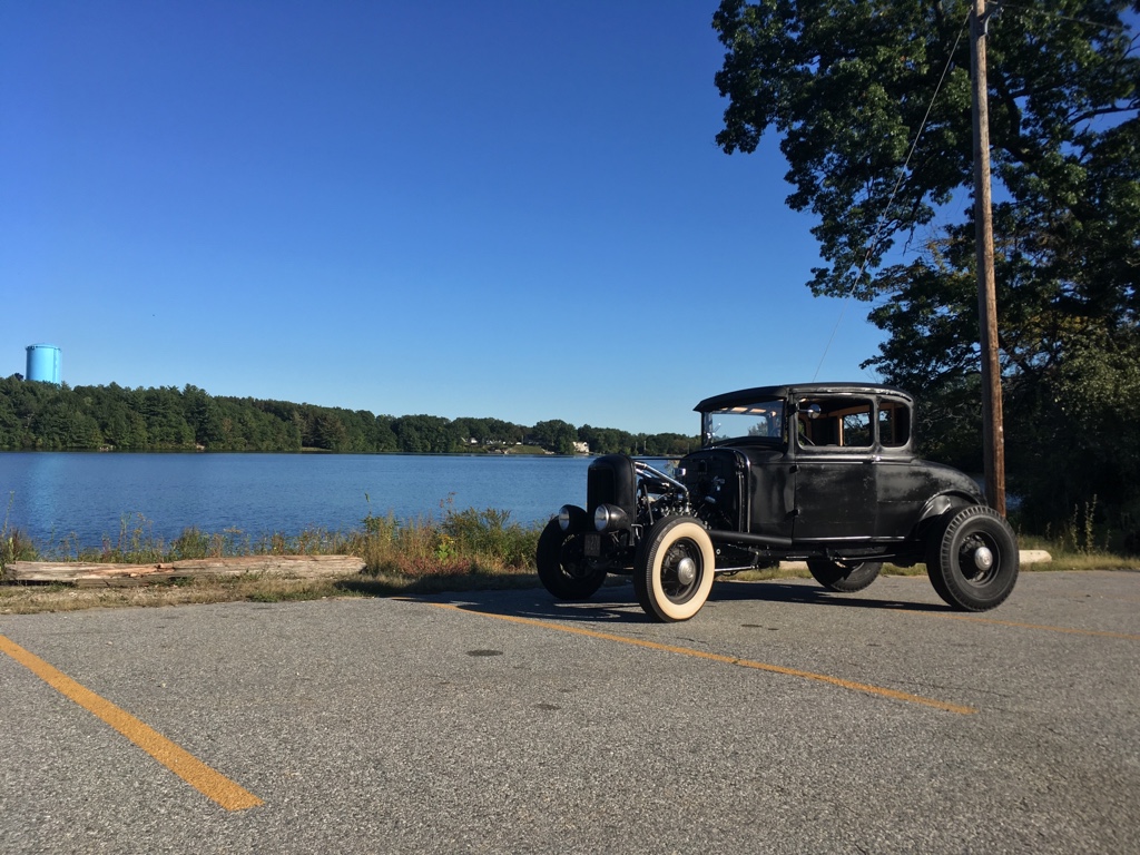

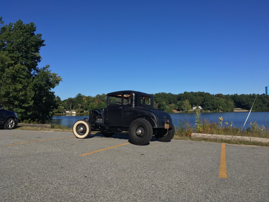

    It took multiple days of troubleshooting, but mr. wheeldog was right! I swapped in a new-new condenser and it runs flawlessly!

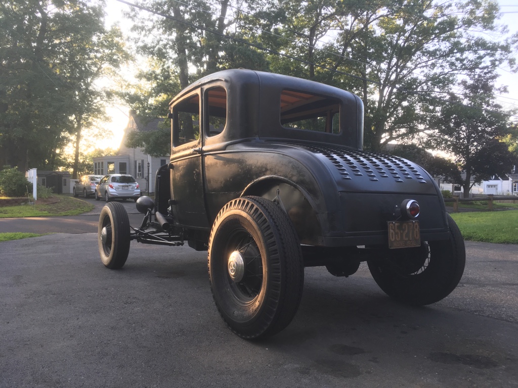

    I was able to make it around the neighborhood so I started to venture out. I was able to make it to flatheadtommy's place and also took it to the lake for the obligatory lakeside pictures. Canvas on and canvas off.

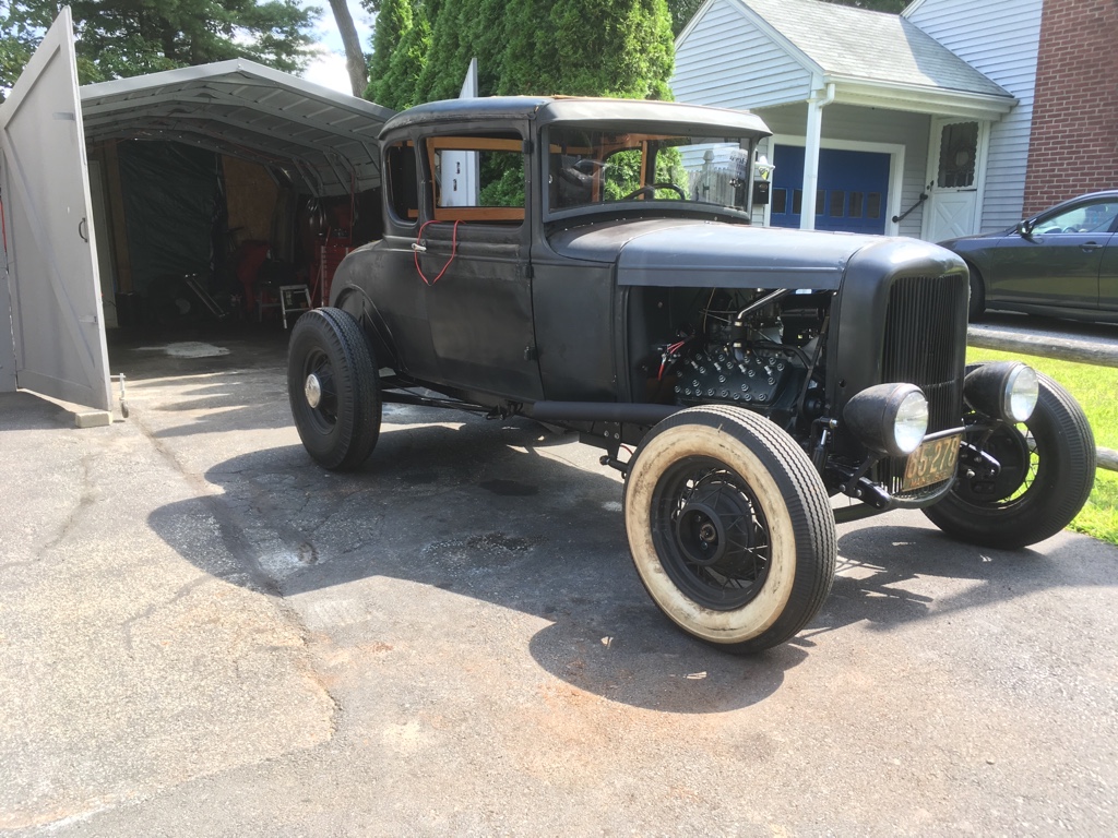

    Just a quick update-
    I added plexi to the sides so that I can now “lock” the car up. I also bought some ceramic insulation on eBay at 12 bucks shipped and put it around the baffles in my headers. Worked incredibly well! Much more tolerable, and now driving is a lot more fun!
    After the tune up, I was actually able to drive down the the gathering of the faithful meetup. I left early due to rain and how open all of my car is (and not painted!). Since I live in Lowell, I had ~150 trouble free miles under my belt by the end of the trek. On the highway, I was able to get up to 65ish, with normal cruising speed of roughly 55. Very impressed with how the car did.
