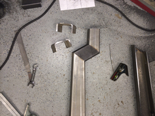

    Now, I already shared this with Pat Manta, but this is what I am thinking. Overall process will cost me about 550 I believe, but this is what I am thinking for the frame. Also, what do people do when boxing with the middle cross member? I want to make sure no moisture can get into the inside of the frame; unless I should be making weep holes... Anywho, take a look.
    Now that I have your attention, what is the best way to go around making the holes? Right now the holes look good at 2.5 inches; but the die is 3.9 inches dia, and I don't know if it would fit in between the rails. I was just thinking of using bimetal hole saw bits, but I don't know how long they would last. Any tips would be appreciated.

    If your dimple die won't fit inside the rail, I'd be inclined to settle for drilling it rather than altering and potentially ruining my tool (those things are expensive). Save the idea for another build another time. If you obsess over this one detail, you'll find that you've spent too much time and thought on it when there are many other things you could have gotten done with that time.
    When it comes to drill bits of any kind, I've learned the hard way to always buy 2. Otherwise WHEN you break one, you're stuck until after you stop what you're doing and blow an hour of your working time going to the hardware store.
    I'd hit overlapping surfaces that are going to be welded on/near with some weld-thru primer then clean the exposed surfaces that are going to get the weld put to them.
