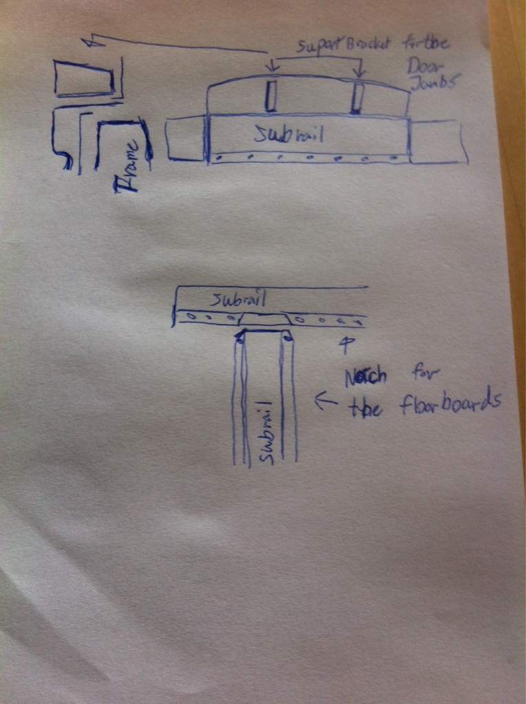

    I would do the subrails like this: ImageUploadedByH.A.M.B.1430827840.088254.jpg
    I would do them in regular sheet metal, 1.2 or 1 mm. That would be something like 16 or 18 gauge. Bend them up in the brake, and do them as long as your brake is.
    Make sure yah the joints in the upper part don't overlap.
    Make holes in the upper part, a good 2 inches a apart. All the way along the sides, and weld them up so they look like rivets.
    Make the curve in the outer edge the same shape as you body.
    I'm not a fan of the square tubing for sub rails. It looks to modern to me. But to each his own.
    If this doesn't make sense, feel free to ask!

    Looks good Ben.... the body of my A was a little worse than yours, but since the body on mine was chopped when I got it there wouldn't be much headroom if I channeled it... heck my head hits the roof when I hit big bumps now with it being un-channeled!
    If you do plan to keep the body on top of the frame the subrails help keep everything in line and make a great foundation...

    Question: since I have everything off and my body all apart (going to have to re square) can I just start playing with metal for the length of the frame, and just leave excess all around to later trim to the shape of the body?
    Although tubing might be popular, I like the idea of the sheet metal more, as it looks more factory correct and professional. For something that is going to be there a while, it should be done right imho.

    I've been spending a long time in my head, to come up with that subrail design. Not that it is very complecated, more because there is more then one way to skin a cat, and this is how I like it the best.
    I would measure up the length of the body from cowl to center of rear axle, thats the length the subrails needs to be (make extra). you will also need the piece for the toe boards, and for the cross sections.
    But make the pieces up as you go, and start with the cowl.
    Everything is adaptable, , and measuere everythinh a couple of time, also on the square.
