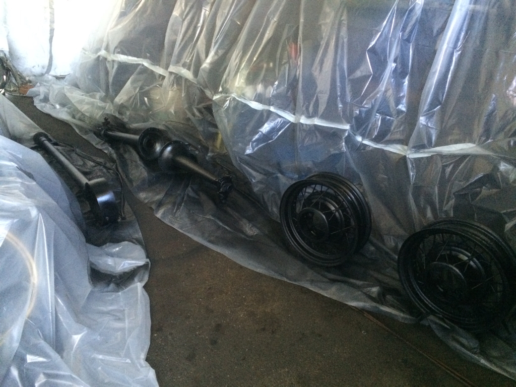

    Ppg dp90lf with the 401 activator and medium temp reducer along with hf spray gun tomorrow morning once I set up my 'booth'
    Edit:
    Set up my booth and it came out great. But now it is already too hot for my reducer. Paint tomorrow morning.

    Anyway, laid paint this morning. IMHO, the wheels look really cool after the paint. Everything else also looks nice...

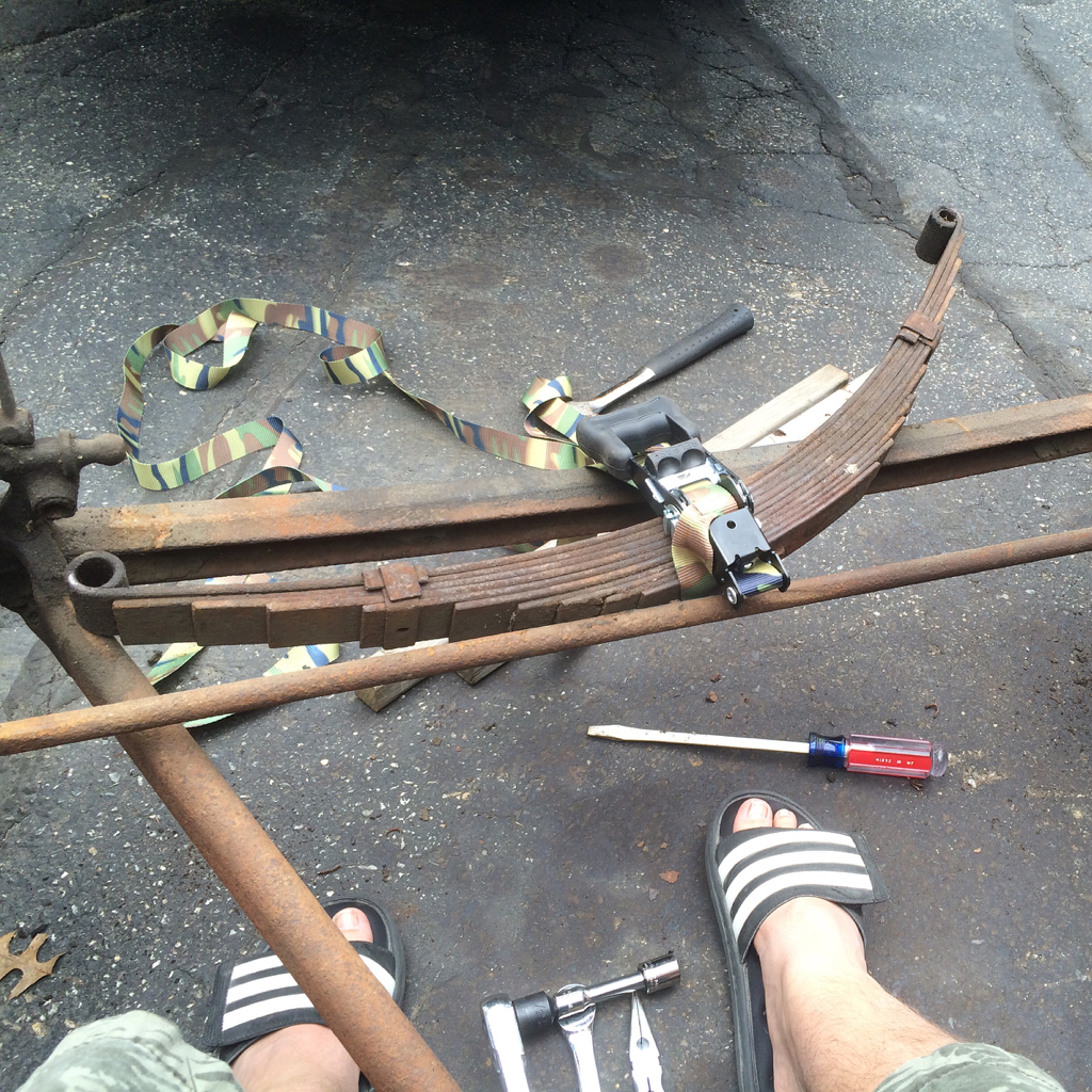

    The front spring was super easy. Too easy. Put on my flip flops after...
    Now these are tough! One came out good. I smashed the threads on the other one, but I had the c***elated nut on there and it was ripping threads off! Decided I had to save at least one part, so I will try to straighten the threads soon. Definitely makes you feel tough after you take these out!

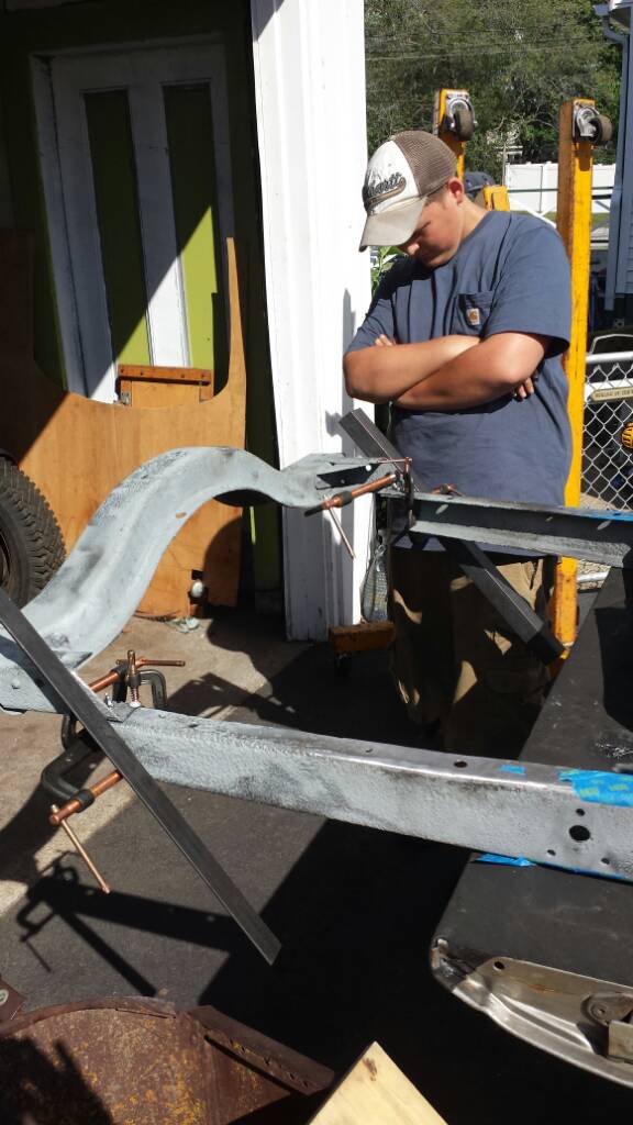

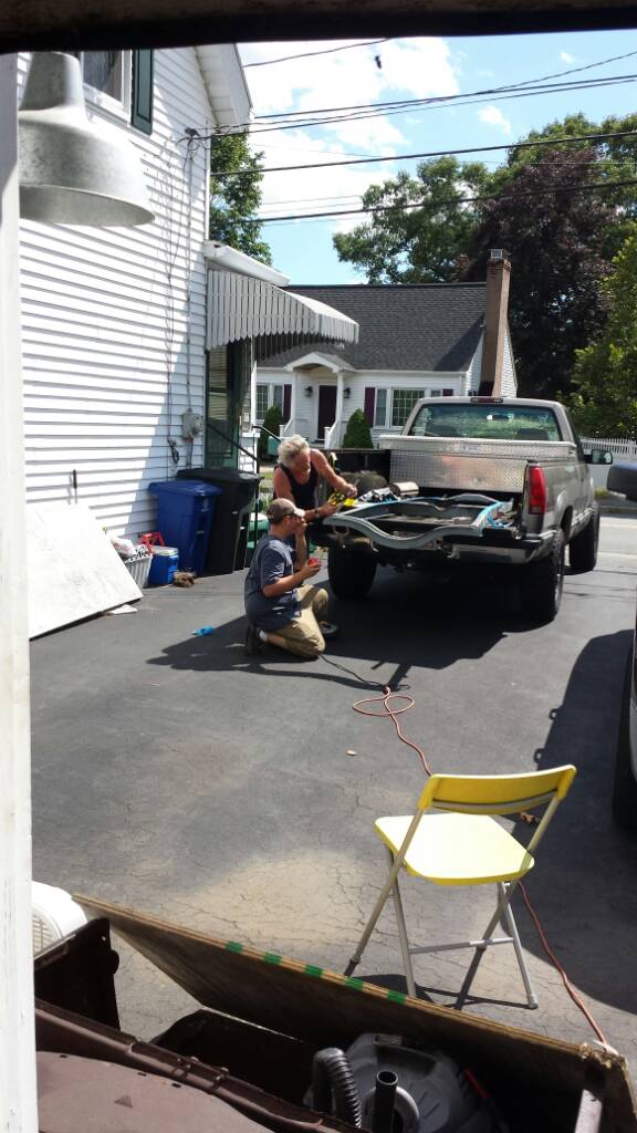

    I was only at pat's house for a quick look at each other's project and then this happened...

    Yeah, grabbed my neighbor, Paul and had at it today!

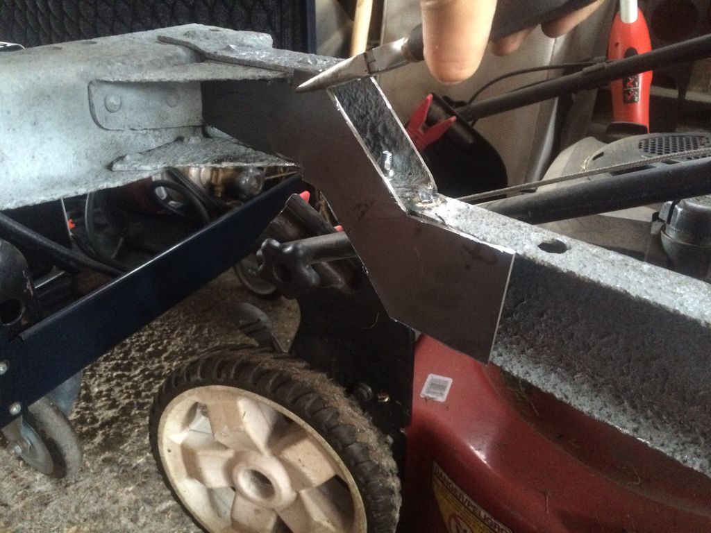

    Well, it has some meat on it in some spots, and it will definitely work with my boxing plates; no need to run 504 plates. He did the kickup with his portaband, as I only have an angle grinder and the portaband gives a great finish. We marked it out to be 4 inches in so that hopefully body mounts will remain the same-ish.
    Look at what I made this morning for it...
    norms30a, patmanta and volvobrynk like this.

    We checked it laterally from the center crossmember and diagonally once we found good holes. The first ones we tried were a quarter off from each other!
    I only put 2 tacks on there so it'll be easier to move if need be.
