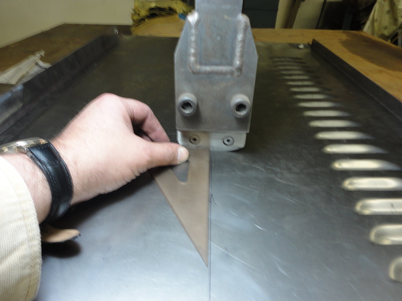

    Sheesh Heath you make it hard to be humble:eek:. As far as "shrinkage" hey man the waters cold! But no never really a problem with shrinking. On a hood like Heath's if you get close to the outside edge of the hood with a row of louvers it can tend to open up and mess with the fit of the hood, the braces on this hood will definitely help. Typically this can be corrected with a bit of "body English". When I'm punching I try to punch "static" ie: the hood is not d****d over the bottom [female] die with the weight of the hood resting on the die nor is there a big air gap between the bottom die and the hood. Not really technical stuff, just common sense stuff.

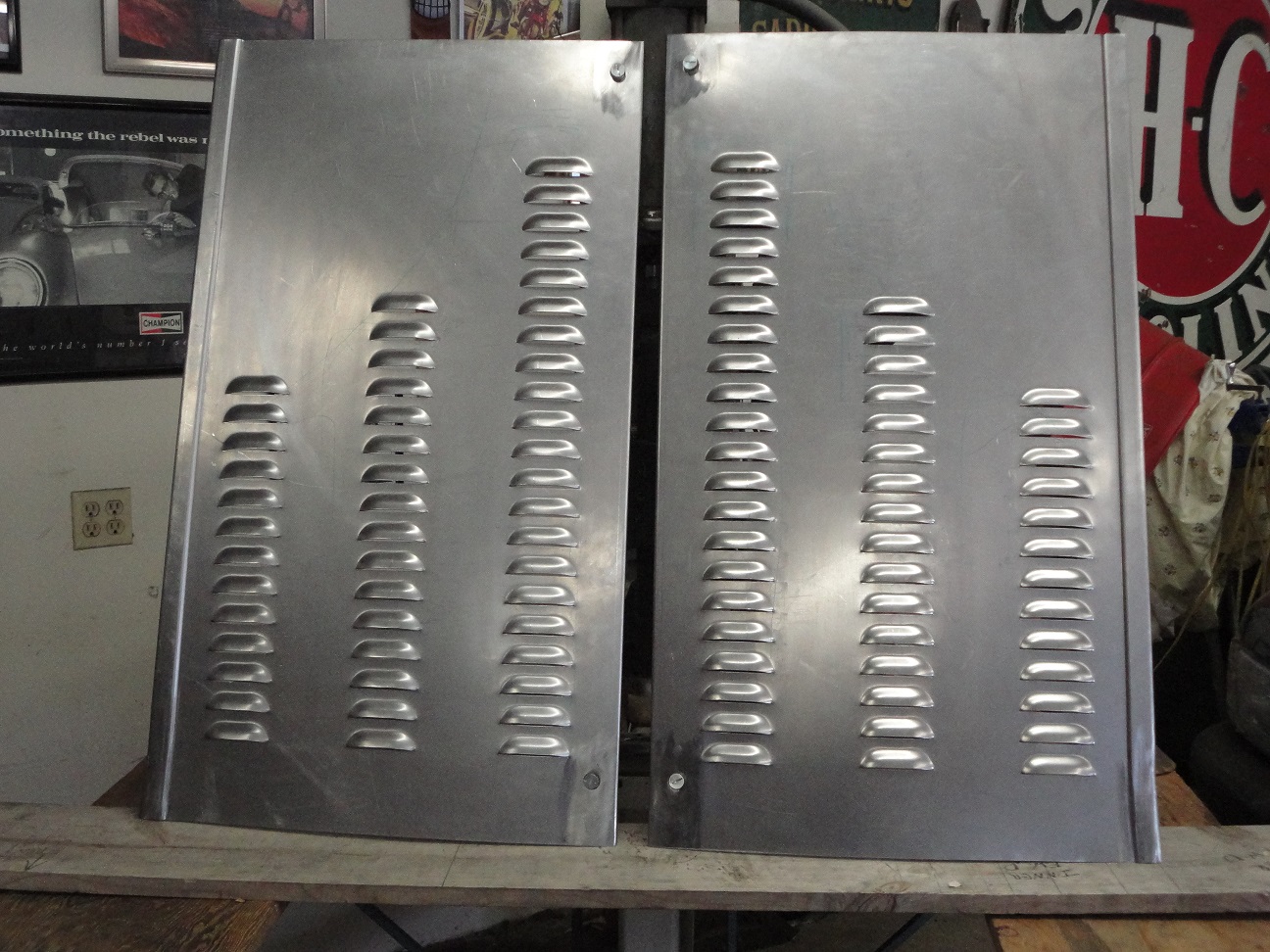

    Johnny99 stopped by today and took a look at my coupe. I handed off my hood sides to him for louvers. Still deciding whether or not to louver the top, so I will wait and see what it looks like when the sides are done and go from there. THANKS JOHN!

  18. Johnny99
    Joined: Nov 5, 2006
    Posts: 1,167
    Johnny99
    ta duh!

    Nice louvers!

    Thanks John!
    They are exactly as I envisioned them... Perfect number and odd numbers to offset the rows!

    Thanks to everybody for all of the nice comments... stay tuned... will be getting back on it soon. Picked up my louvered hood sides from John today and they look great! Will be posting some pics of them installed on the car in next couple of days...
